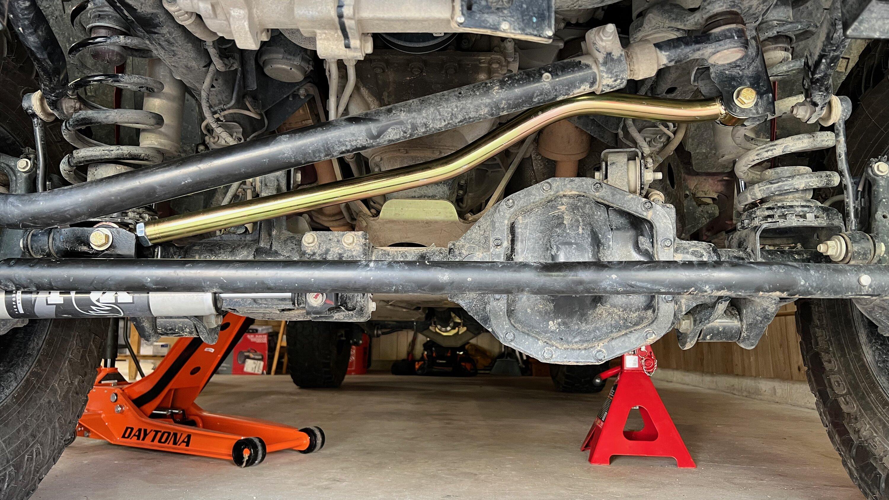

Upgraded to the MetalCloak front track bar ... phase one of replacing the front diff cover with their more beefy model.
For this install you have to grind some metal away from the frame-side mounting bracket, which is a pain when you can't find the collet for your die grinder. :giggle:

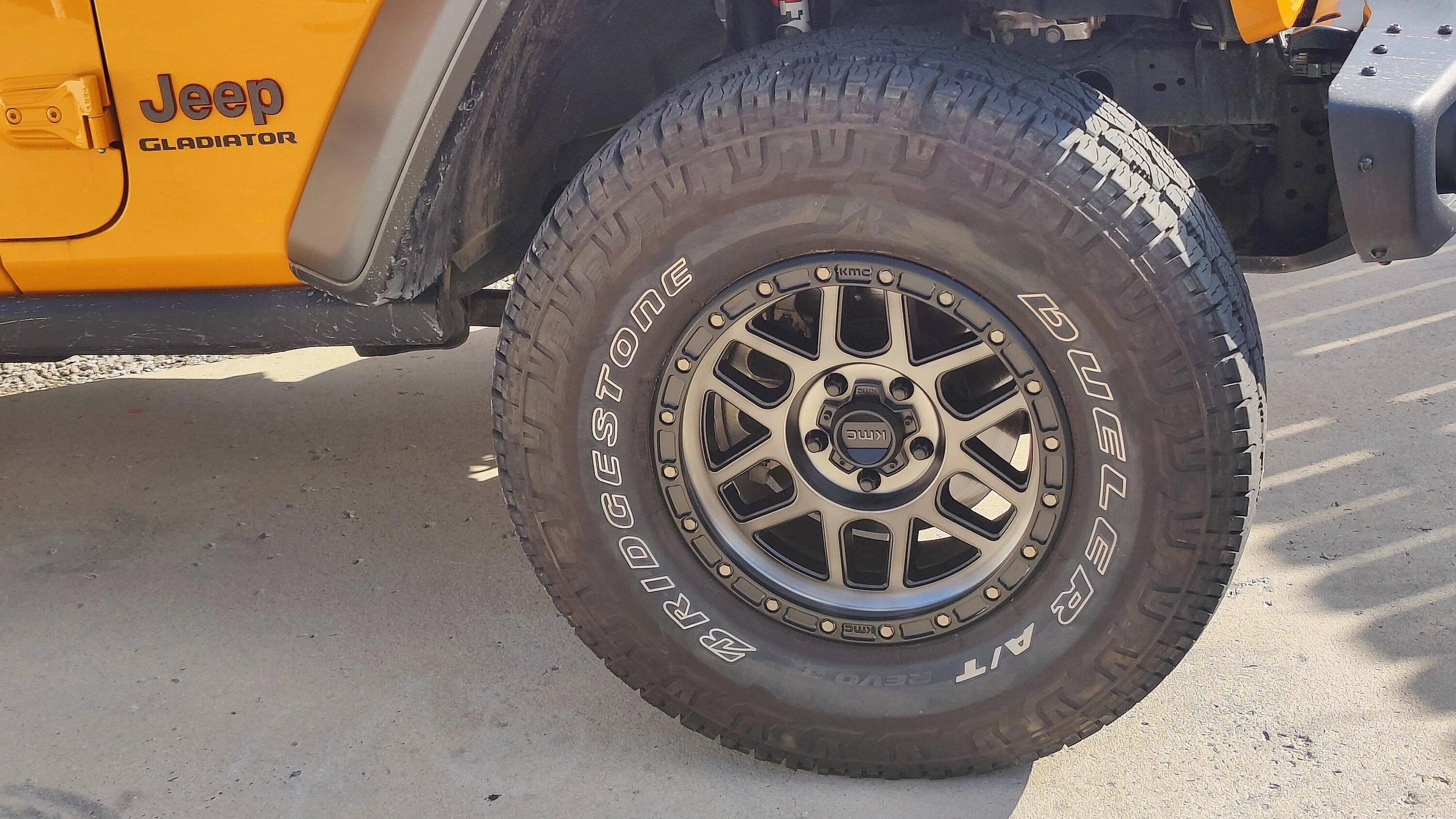

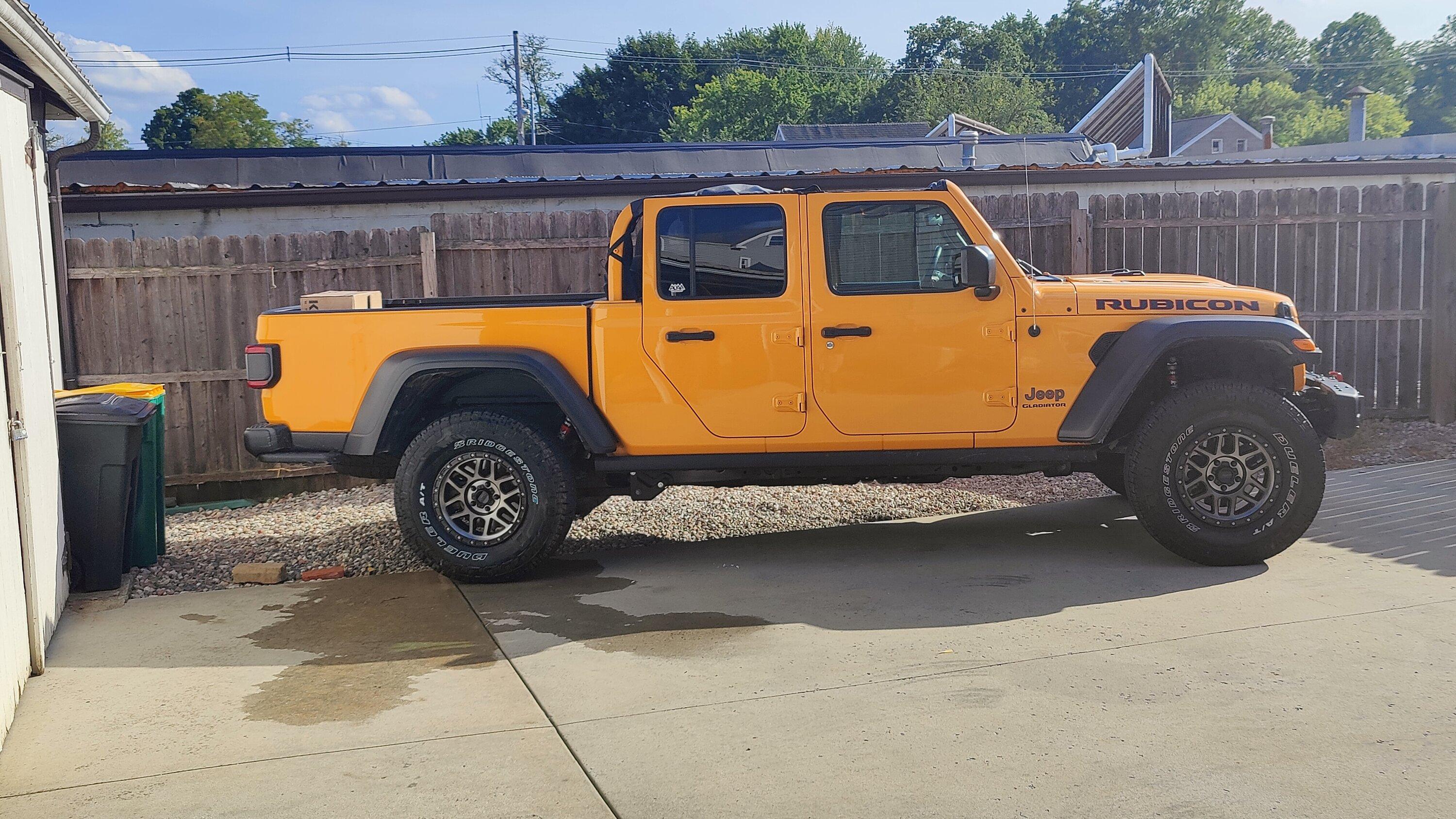

New wheels, same tires I've been running. Now I think I need some flare extensions. Either XR or EZ flares. These are 0 offset 17x8.5 KMC 544's. Tires are 315/70/17s
Did you have to correct alignment of the wheels right or left after installation of a lift?

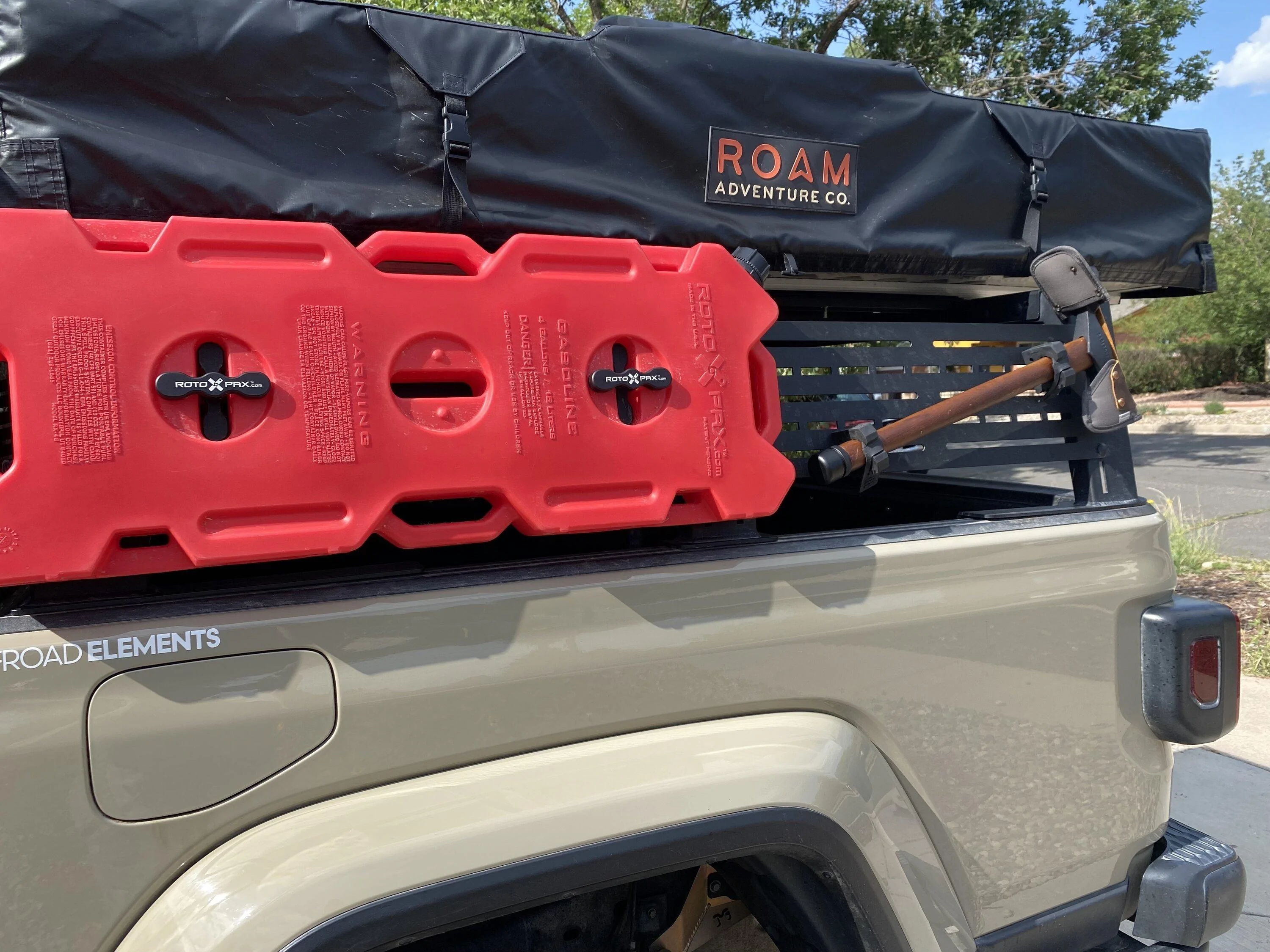

Simple thing...but put on some clamps for more camping and overlanding things.
Looking at a half rack as well and that exact tent. How much higher than the roof line does it stick up?

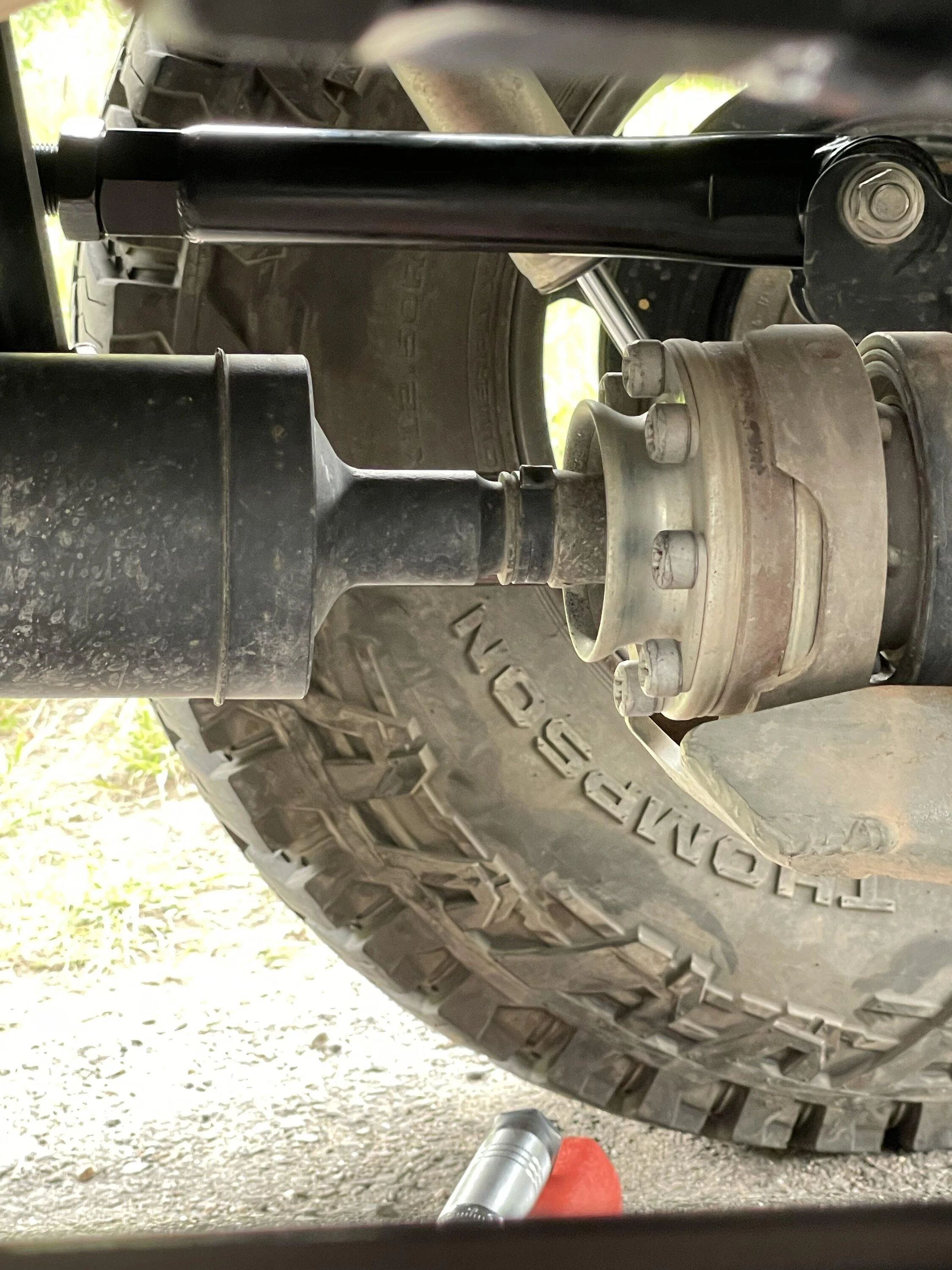

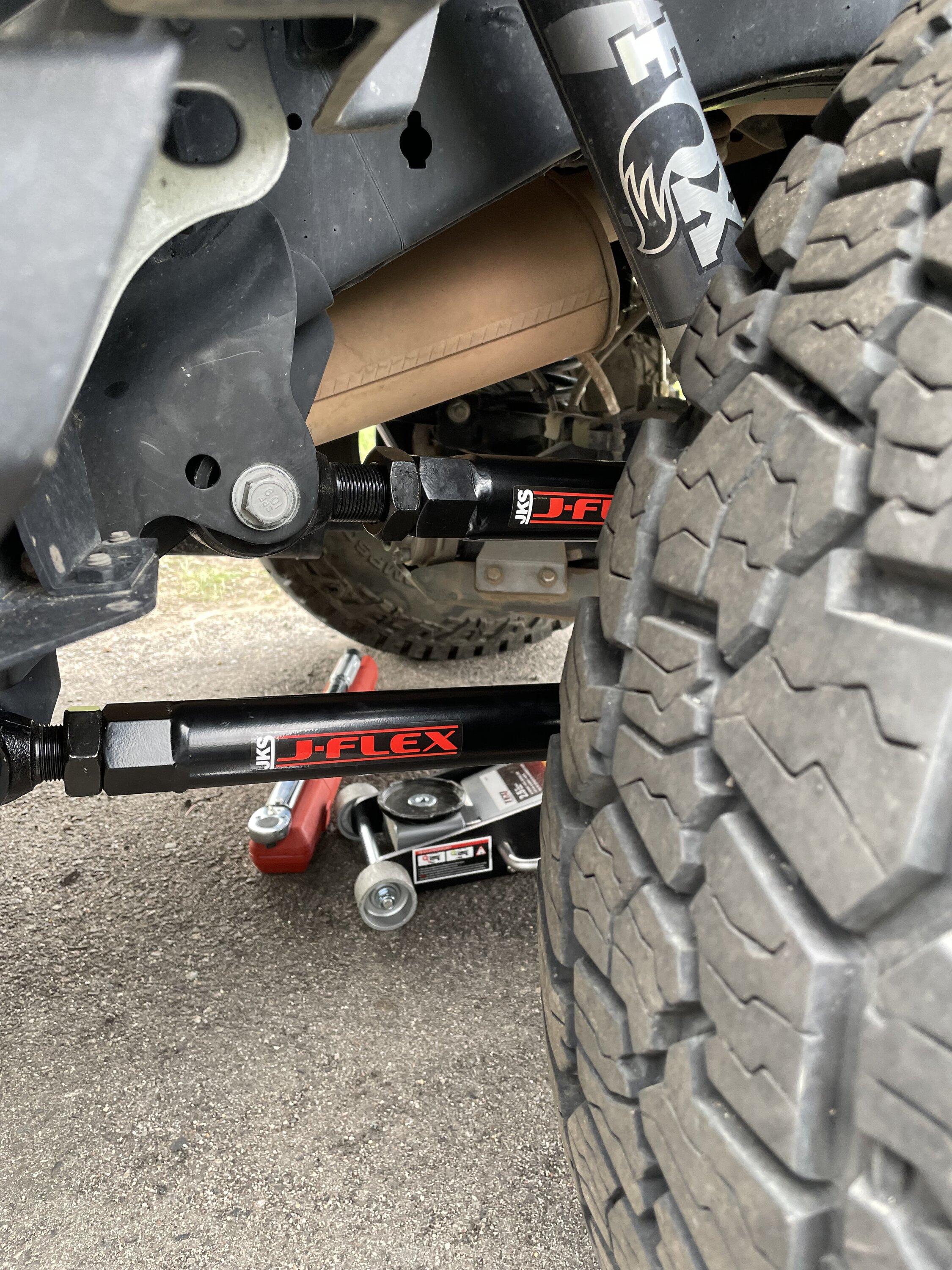

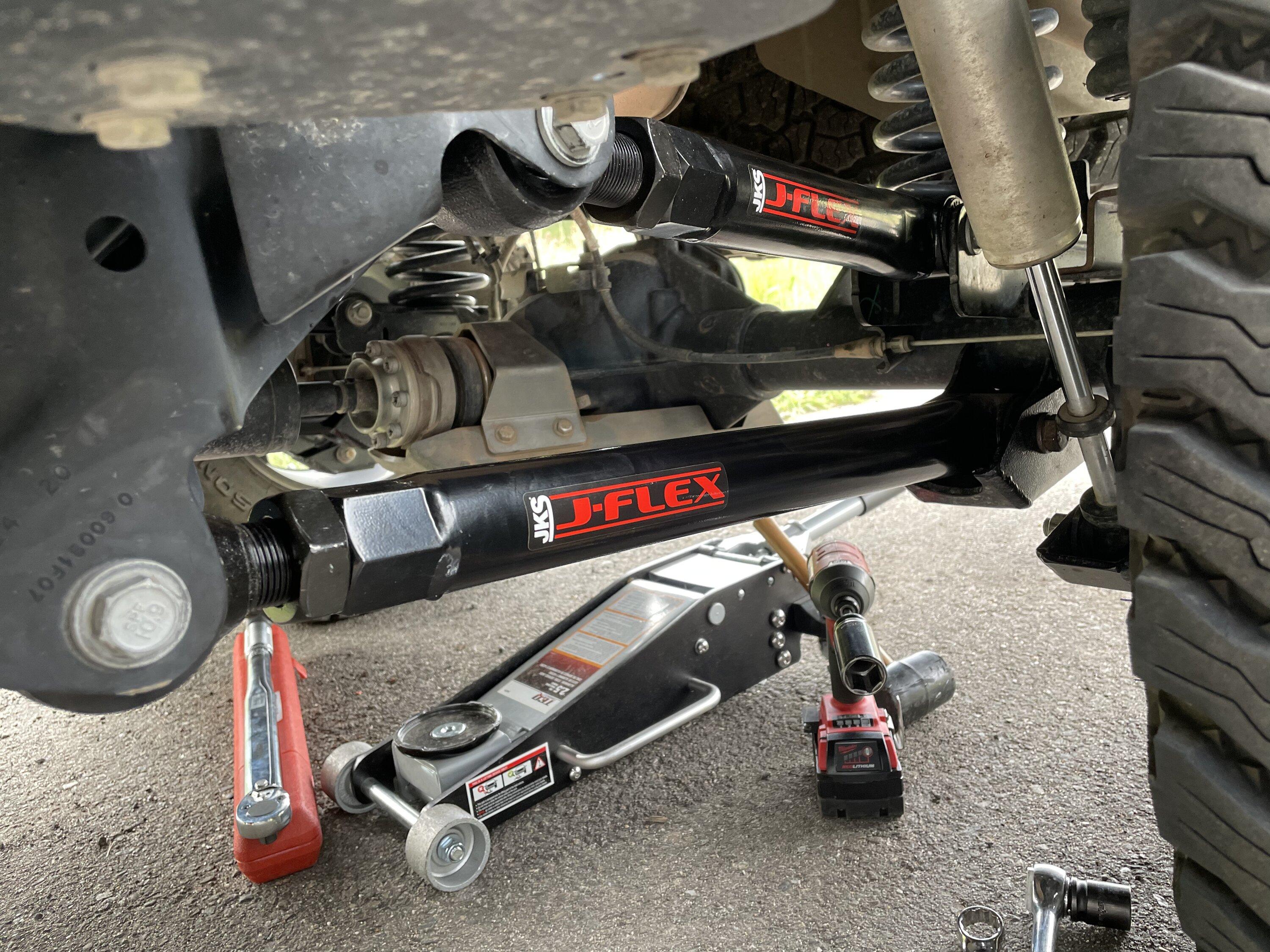

Installed rear upper and lower adjustable control arms to fix the pinion angle after the lift. Ultimately so I can install the 1350 driveshaft in my garage. Also installed the armor skids for my RSE step sliders.
Is that for the Mopar 2" lift. I just installed that lift, and it seems the same dimensions (measurements) on both sides. I did some pretty heavy wheeling today (waterfalls, large rocks, steps) and it seems fine (Mopar lift, Kanati 315/70R17), and drove to the trailhead on the fwy at 75 mph. Just trying to see if I need to replace my OEM track bar with an adjustable. Since we're in the SW (CO and NM), I thought the requirements for off-road might be similar.

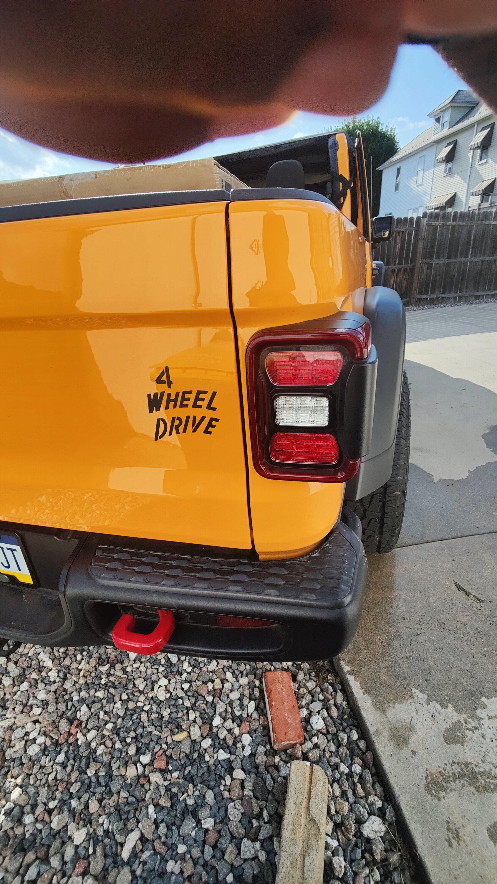

New wheels, same tires. Now I think I need some flare extensions. Either XR or EZ flares. These are 0 offset 17x8.5 KMC 544's. Tires are 315/70/17s
Yeah, me too, although not required in NM. Here are my images with the same size tires and wheel specs. Note the 4 wheel drive on the tailgate, an idea I got from you. You gotta come out west and we'll do some rock work. Wheels: Ion 715 17/9", Kanati Trail Hogs 315/70R17. I'm using 35 psi, and 18-20 psi off-road, stairs and waterfall rocks mostly.
I’m lifted 3” in front and 4.5ish in the rear. So my pinion angle was a bit low in the rear. I was getting away with it with the stock CV driveshaft connection at the axle, but the new driveshaft I’m installing has a 1350 U joint at the axle, and the angle needed to be as close to zero as possible. This did that quite well. Now I just need to throw the drive shaft on this weekend.
Yeah, makes sense. With only 2" my angle seems fine. Did some stairs and waterfalls today on a nearby trail in the Sandias and it seemed fine. No binding I could feel. At 3-4" I think it would be a different story. If I get north up your way, I'll give you a jingle. I have a couple of former students at U Denver, and get up there a couple times a year. Conversely, if you’re ever down to ABQ, let me know.
