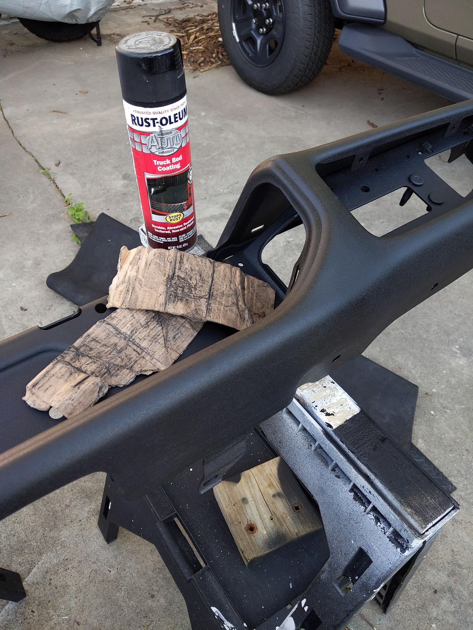

I just did this on a rear bumper. After letting it dry for a few days, I went over it with some flimsy card board (paper bag would also work) to knock down the course scratchy surface and give it a smooth feel. Still looks the same, just feels smooth instead of rough.

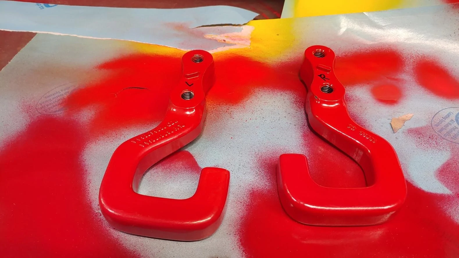

I got a pair of rear tow hooks. Was looking for a single so I could add one to the right side of my Overland but ended up with a red pair. Each had some dings - one had a fair sized chip, the other a smaller chip. I didn't want to strip and repaint or powder coat the whole things as I'm trying to get back to work I'm doing for others. Gee, I need to find a red that matches so I can just touch them up.
I had several cans of various reds I use for other things and among them was the 1982 AMC color Oriental Red - the color on my 1982 SX4 and guess which color was a great match.........
Yeah, the Jeep tow hooks are 1982 AMC Oriental Red if you ever need to touch them up.

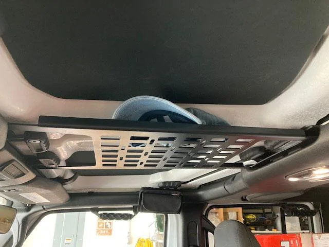

How much room is there for that overhead panel? Can you fit a purse up there? Tired of my wife putting her purse on the cup holders.

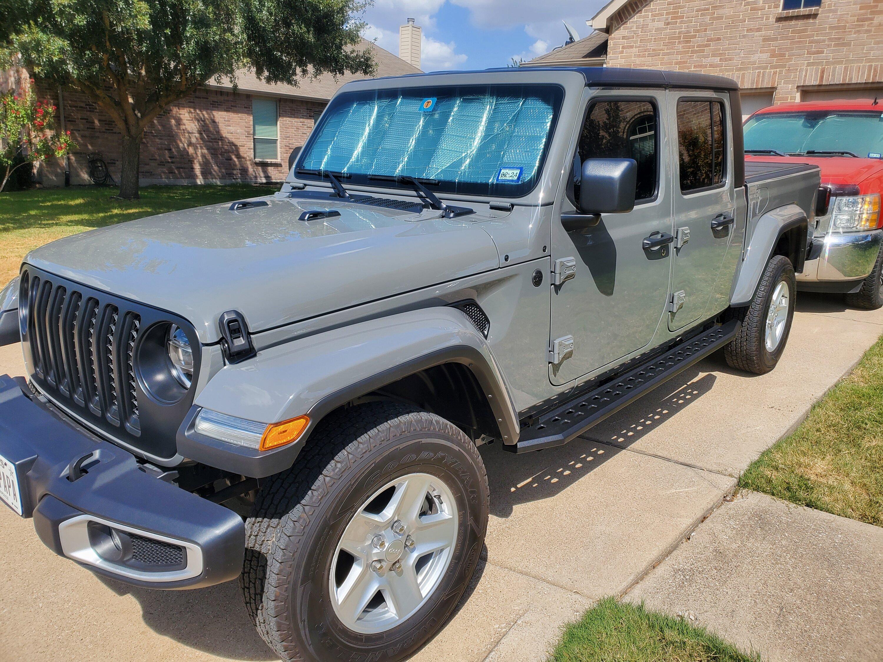

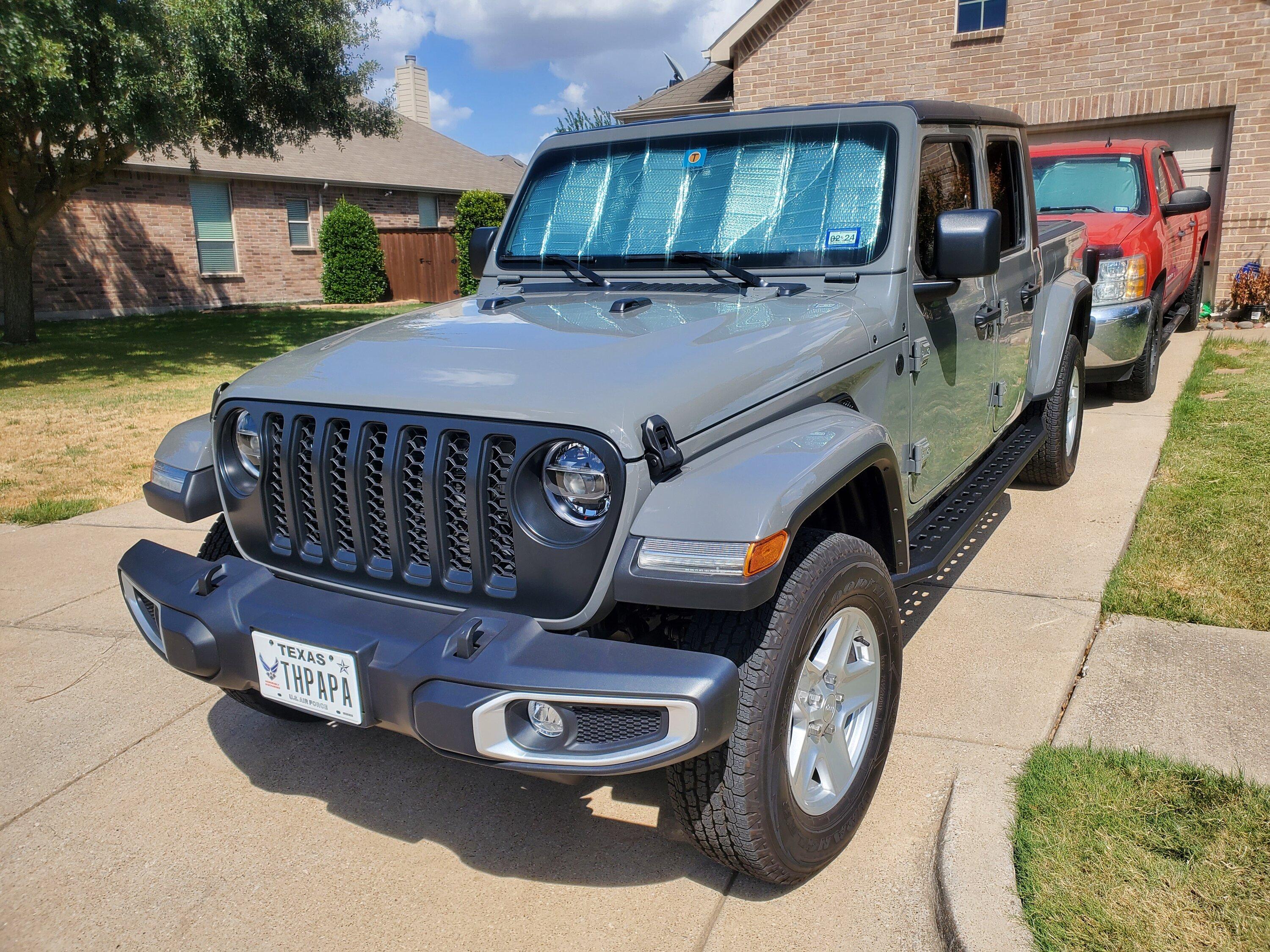

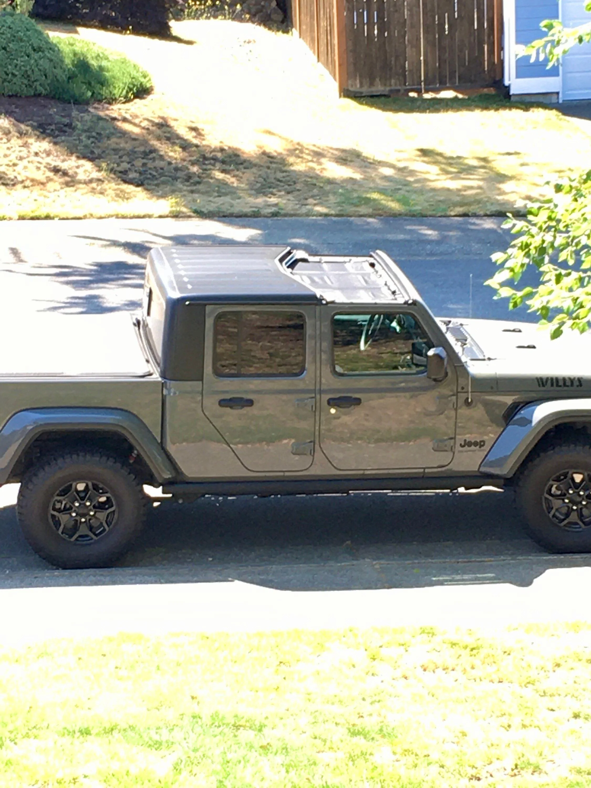

Today I installed an Alien sunshade to my pickup. It fit well, the bungies are really tight. Hopefully I can leave it inplace when I reinstall the Freedom Panels.
Good stuff here everybody, damn cool upgrades shown here. Mine is not overly cool...the cool stuff goes on the trail Jeep!
Depends how thick it is. My wife said no for most women. You could use a strap and strap it up, but not sure that would go over well.

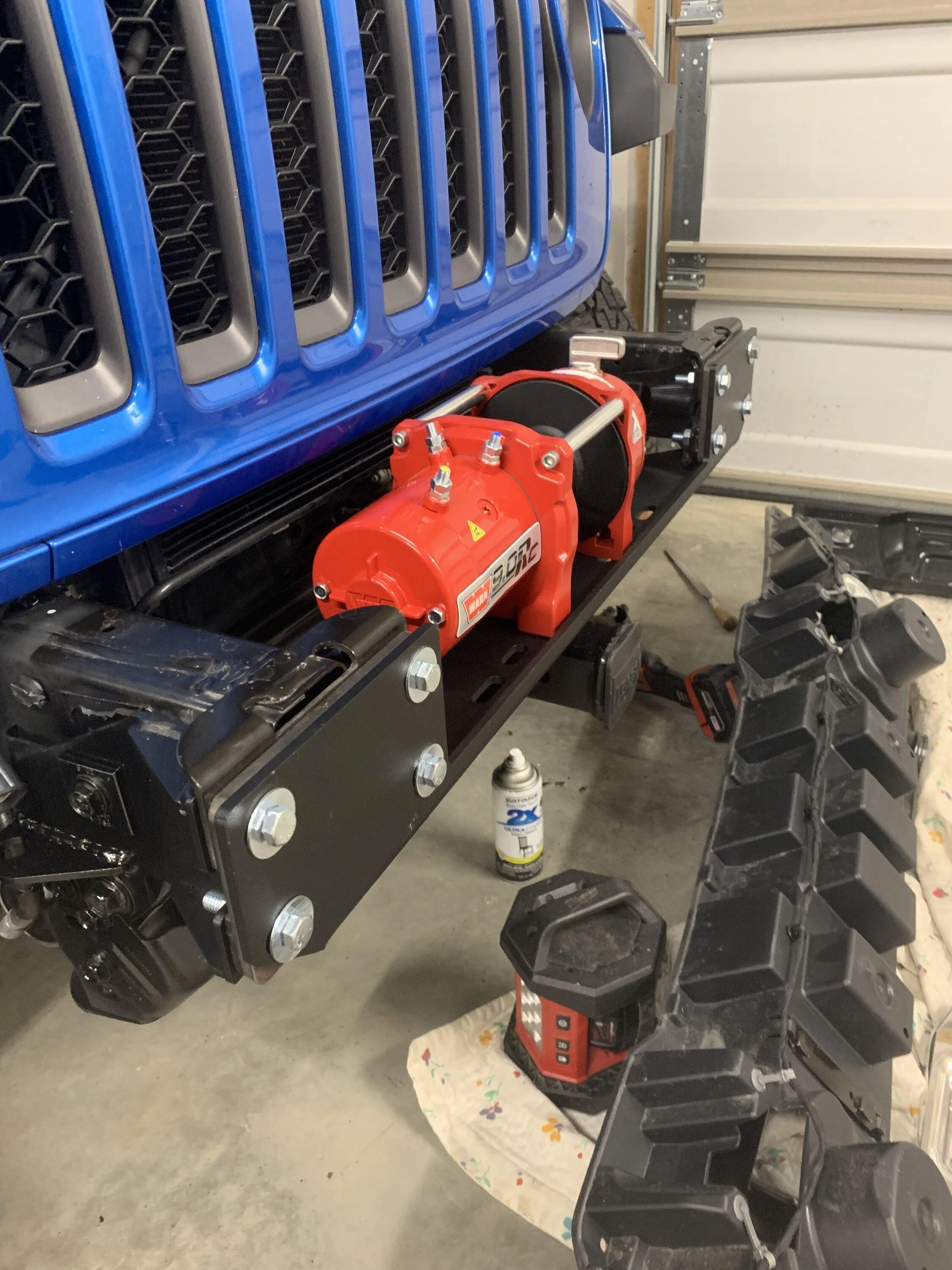

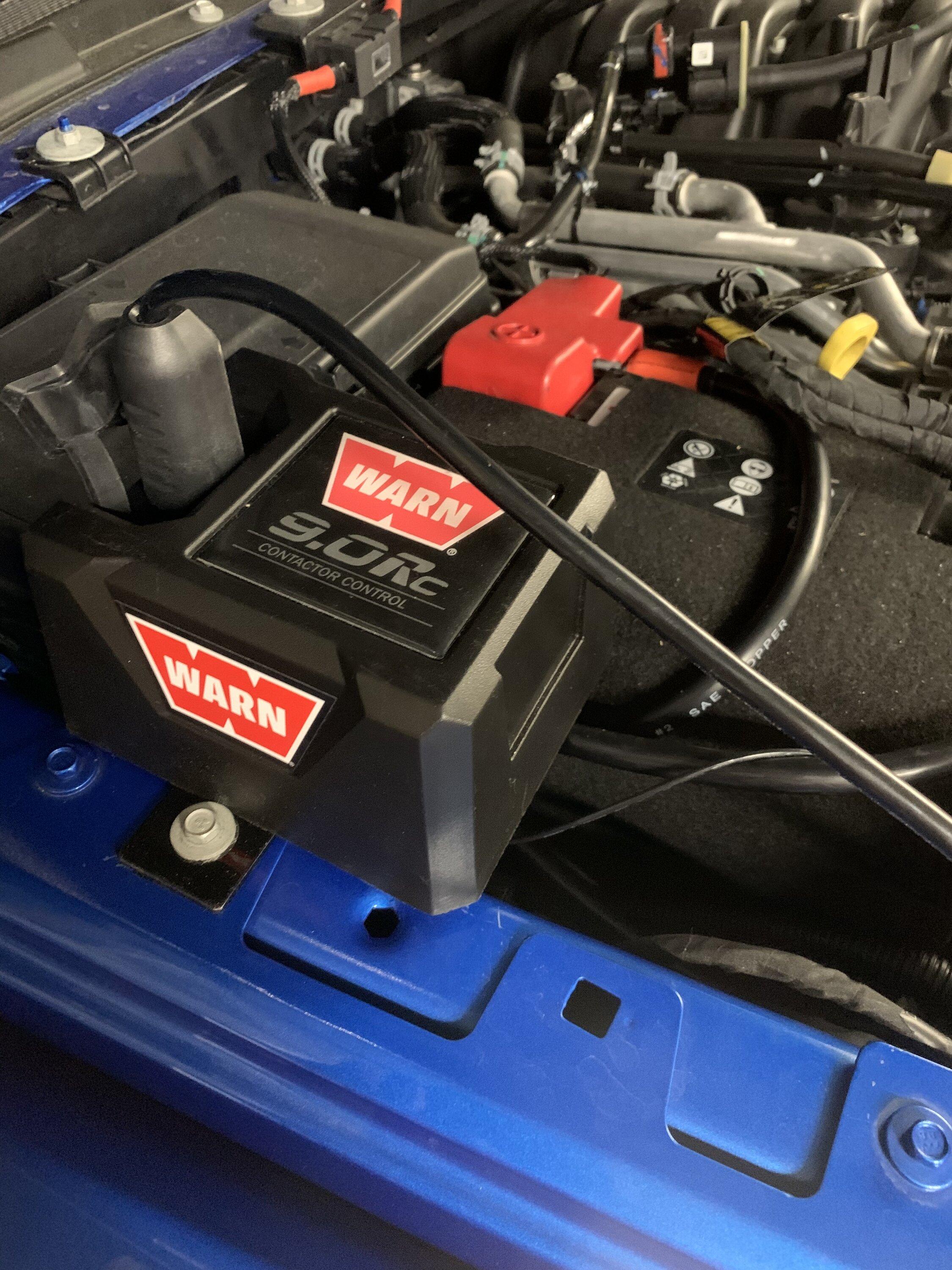

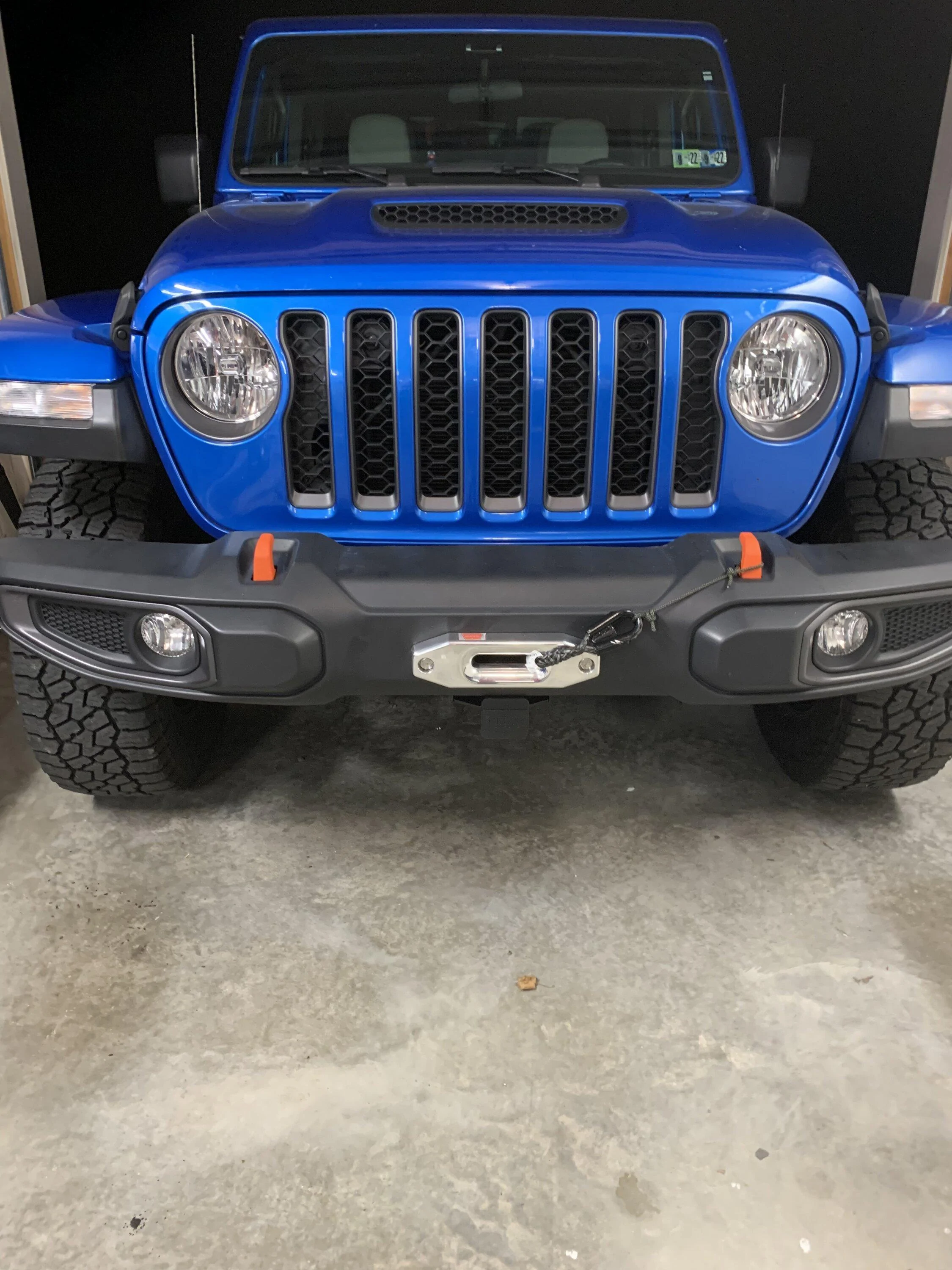

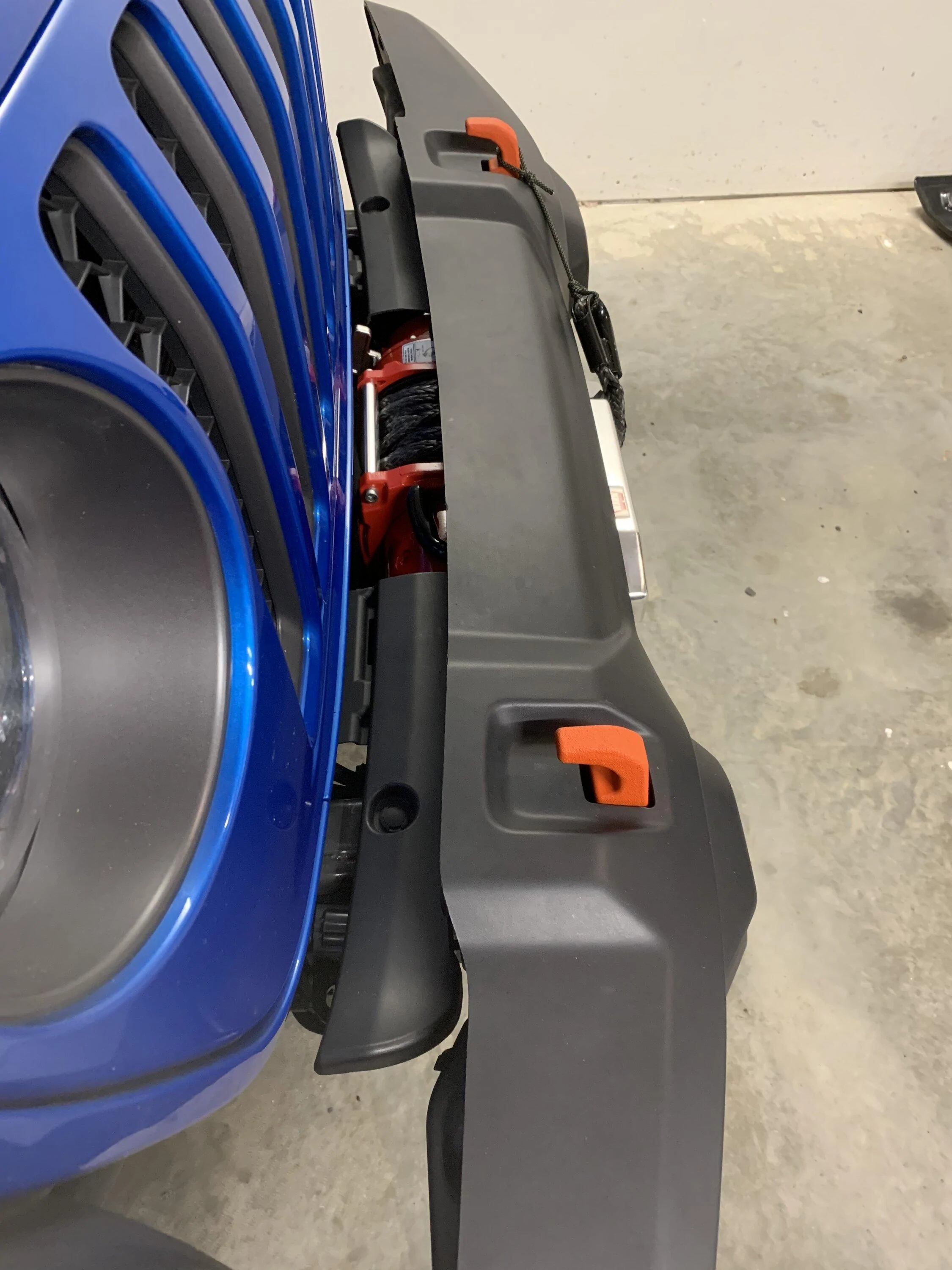

Only way to put a winch on without out cutting top of plastic bumper is to go with the basic old school designs without the decorative designed housings, and also relocate the control box, Mojave has a high hood so mine fit but need hood open to plug in until I put a remote connection in, also need to spin the clutch lever towards rear…..Jack
