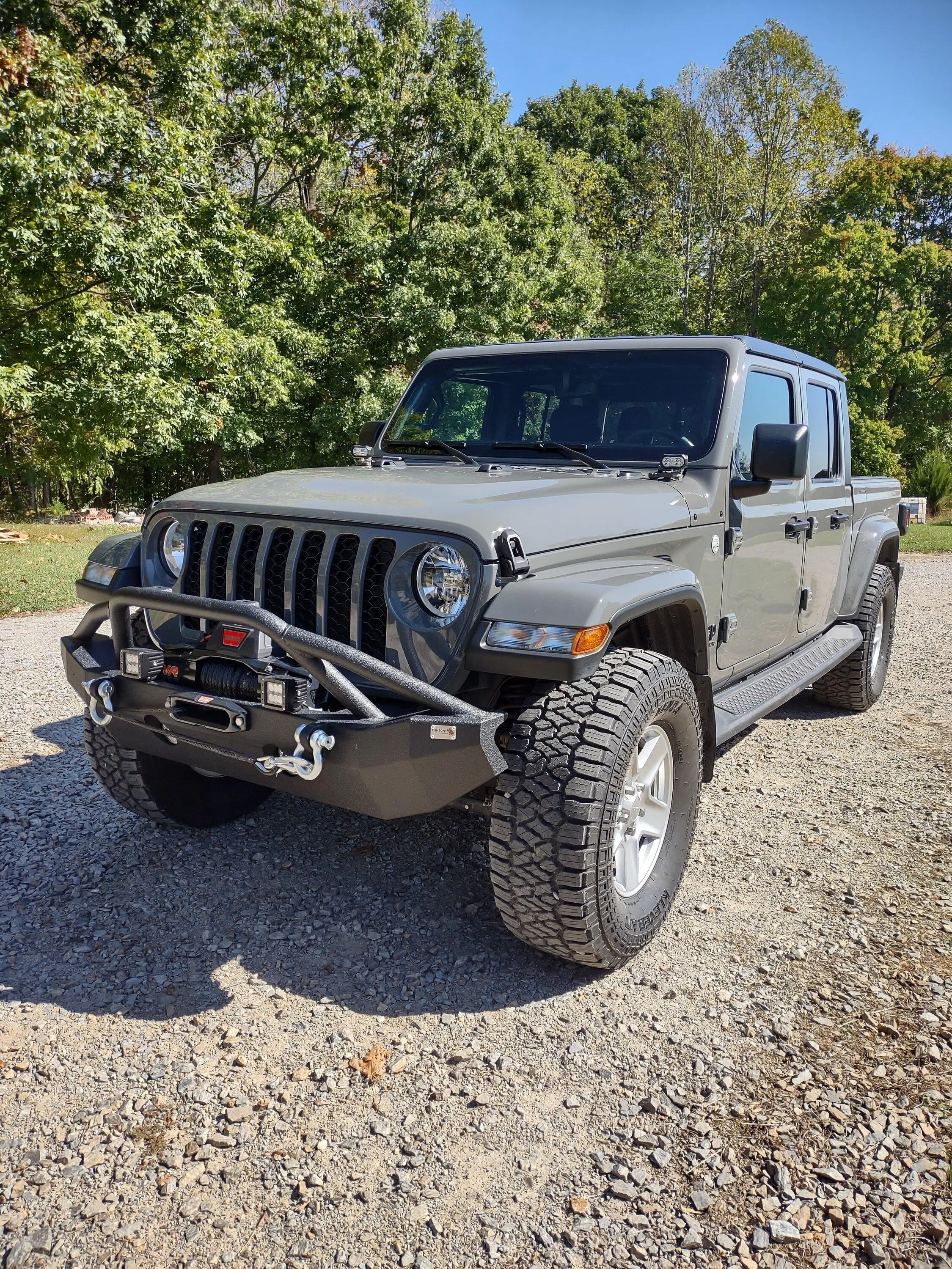

The opportunity finally came to get my $85 Walmart Kenda's installed. They fit on the factory wheels and seem ok so far, though the set up is like. The tires are my belly and the wheels are my pants, enough said. The spare did fit under the bed, again a tight fit. Hopefully some great Black Friday and Cyber Monday deals to be had on some wheel upgrades.
Y'all might as well check out the Fishbone bumper and Warn winch. Installed those about 2 weeks ago. Need to install an isolation relay for the winch, not a lot to choose from in that 400 amp plus continuous duty range.
The truck is a Sport S, diesel with 1.5" Teraflex in front and .75" Daystar in the rear. I've already experienced some inner finder contact, so pretty sure a better lift is not far away either.

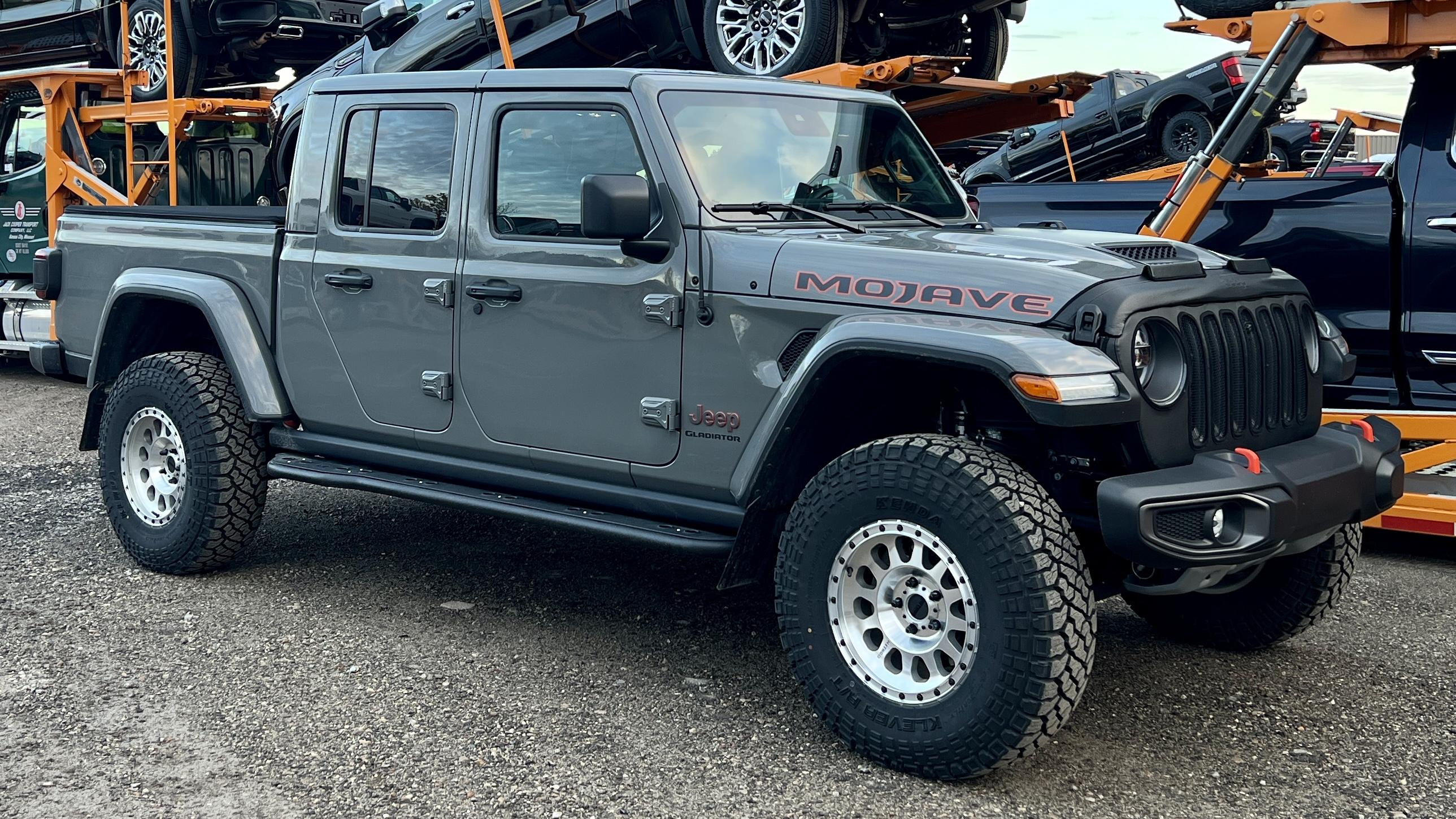

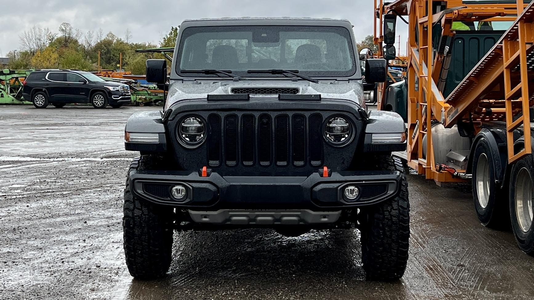

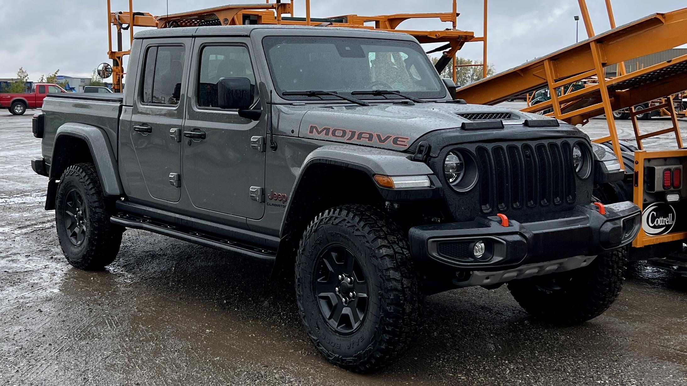

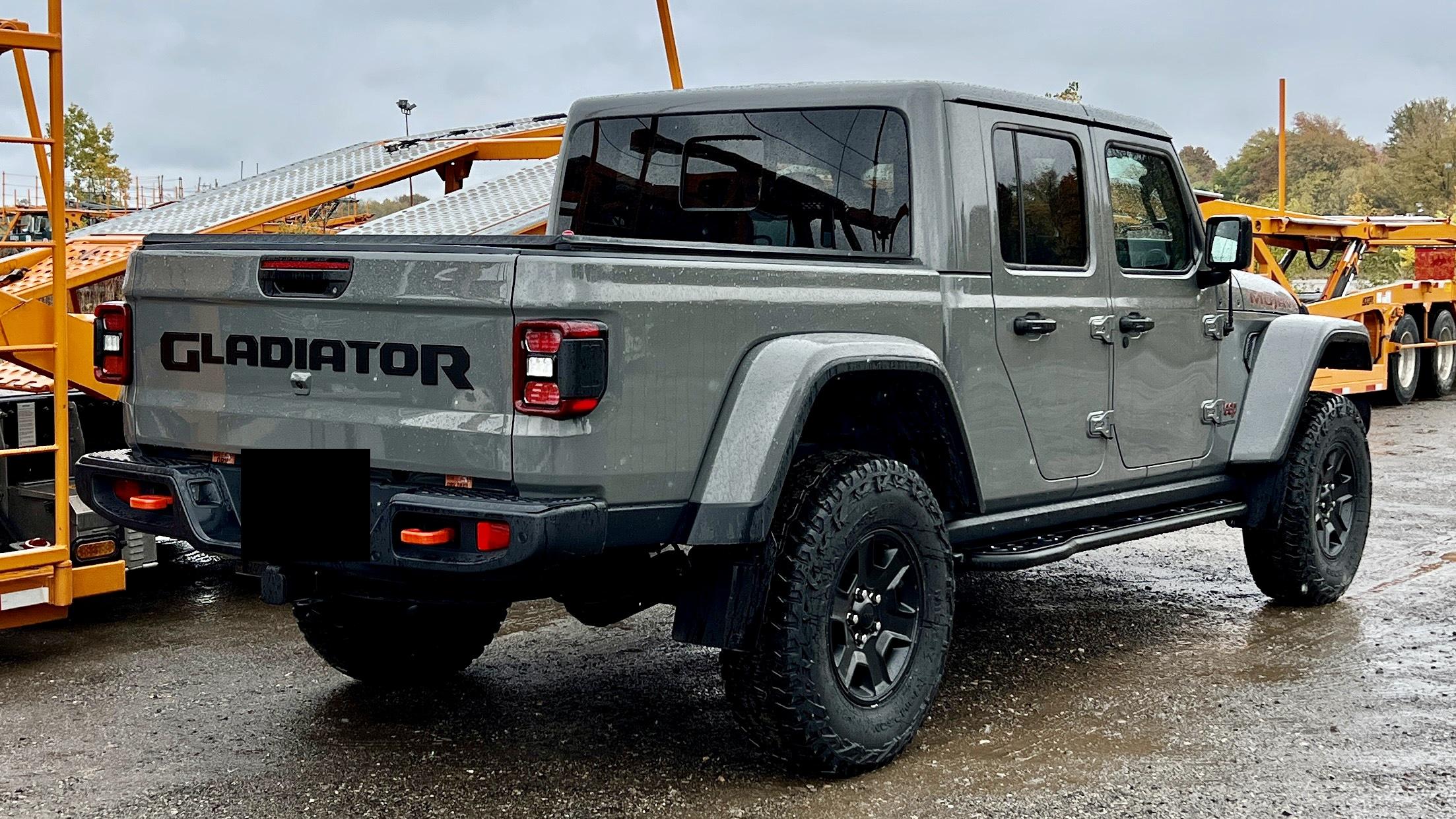

Put on a dedicated winter set of tires/wheels. Stock base Mojave wheels (7.5” wide) Mickey Thompson Baja Boss AT 255/85R17 (35x10x17).
I thought these tires on stock wheels would be just too “tucked,” but I am perfectly OK with where they sit. Especially for Michigan winters.
Also, I wanted these Mickeys from the get-go and was told by 2 Belle Tire stores and my chosen Jeep speciality shop, that they absolutely would mount them on the 8.5” wide Method wheels (mentioned/pictured) below). I think at the time (May), said tires were still on a national backorder, hence the Kendas also mentioned below.
Side note… 1” wheel spacers do not work without cutting the OEM studs & chose to NOT use them.
I have had 3 Toyotas all with their own set of 1” wheel spacers. Each one of those vehicles’s OEM wheels all worked with 1” wheel spacers.
Not the greatest of pictures and the head-on one looks worse in picture, than actual, but I am really liking this narrow tire thing. I personally (for myself) could not be more over wide/WIDE tires, but hey… we all like something different.
Dedicated summer set are Method 315 wheels that are 17x8.5” and 0 offset.
Tires are Kenda Klever R/T 35x10.5x17

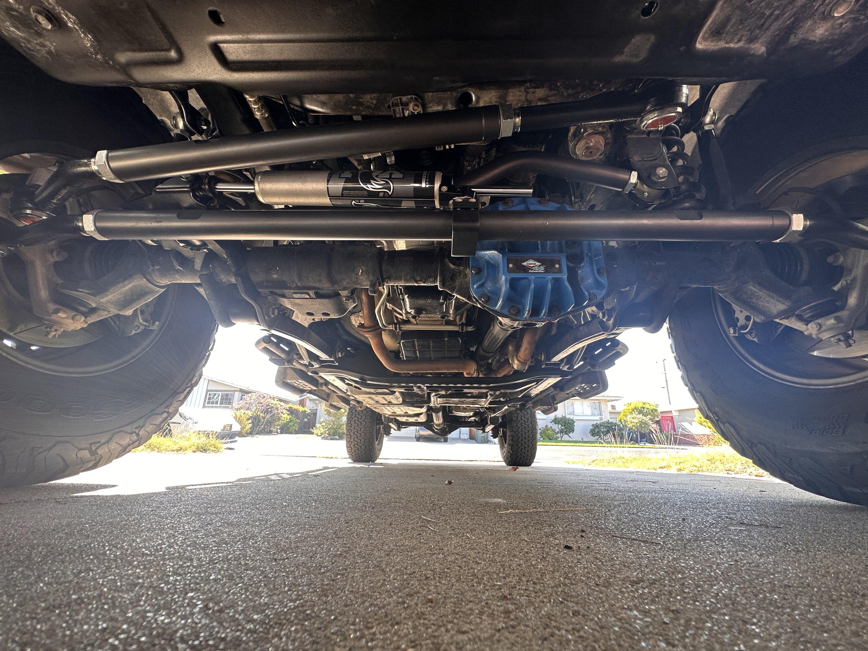

Finally got tie rod, drag link, and track bar in. Ended up extending the track bar quite a bit over stock, but that seemed to be necessary to center the axle. Seems to veer slightly to the left, though. I may just have a shop do a once-over and alignment.

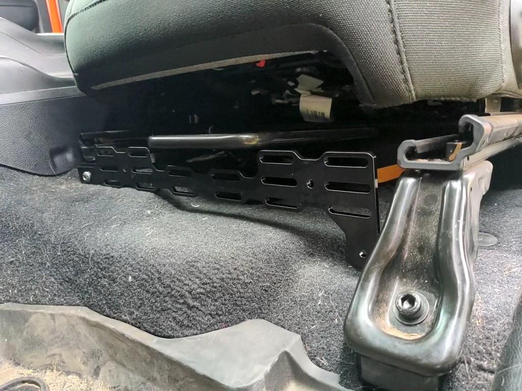

Dessert does it seat jacker and molle panel. I didn't find the seats to be very uncomfortable before but after feeling the difference these make, wow! I'm 6'2 and should have installed this on day one! Price always held me back but I thinks it's worth to make the cabin more comfortable.

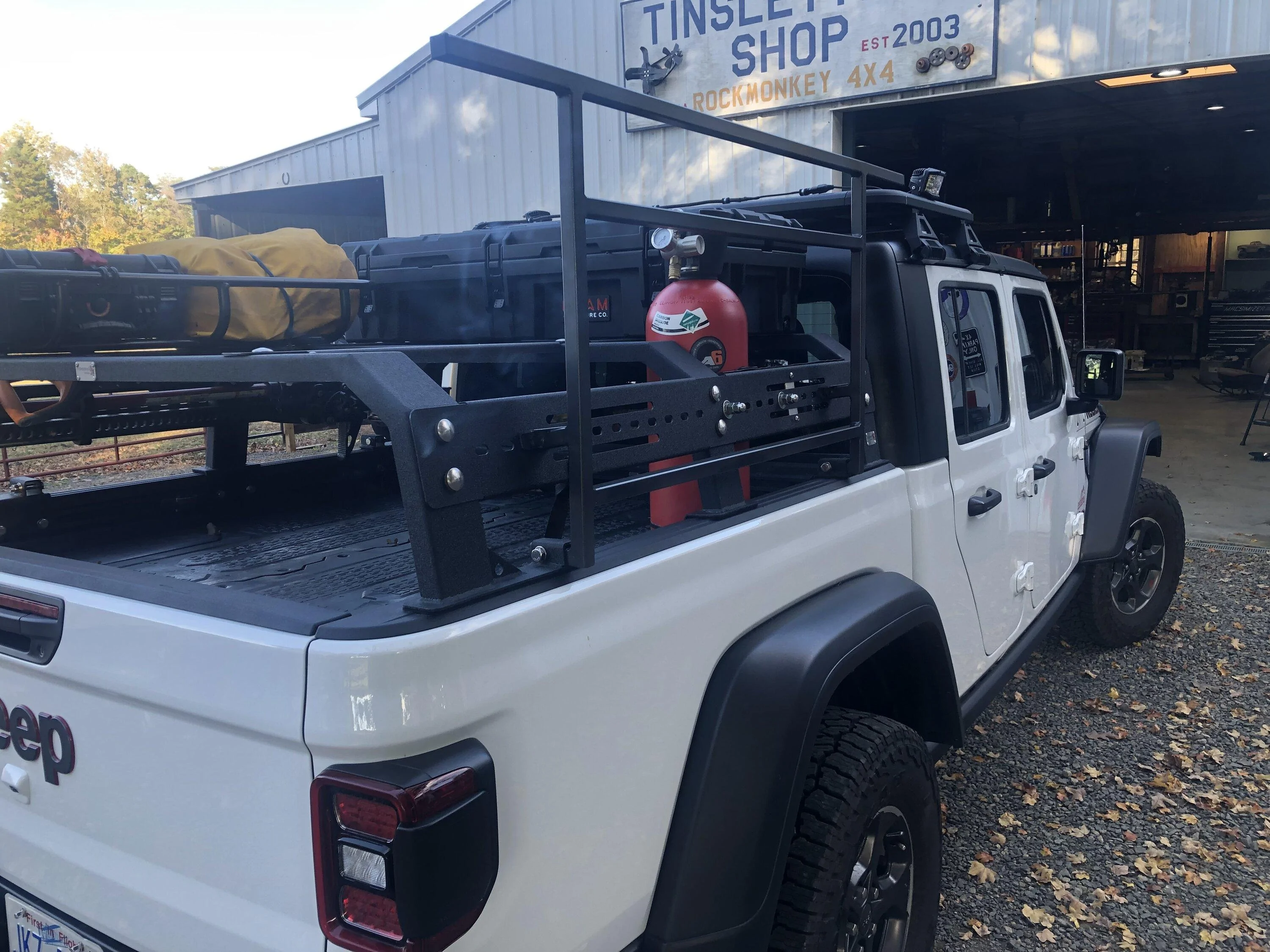

Build a bracket for ultimately adding a nomadic 270 LTE pass side 270 degree awning it’s attached to my half Fishbone

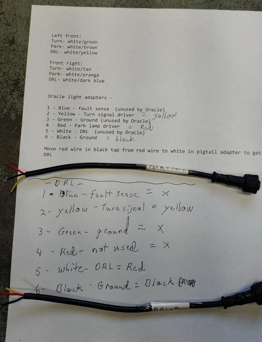

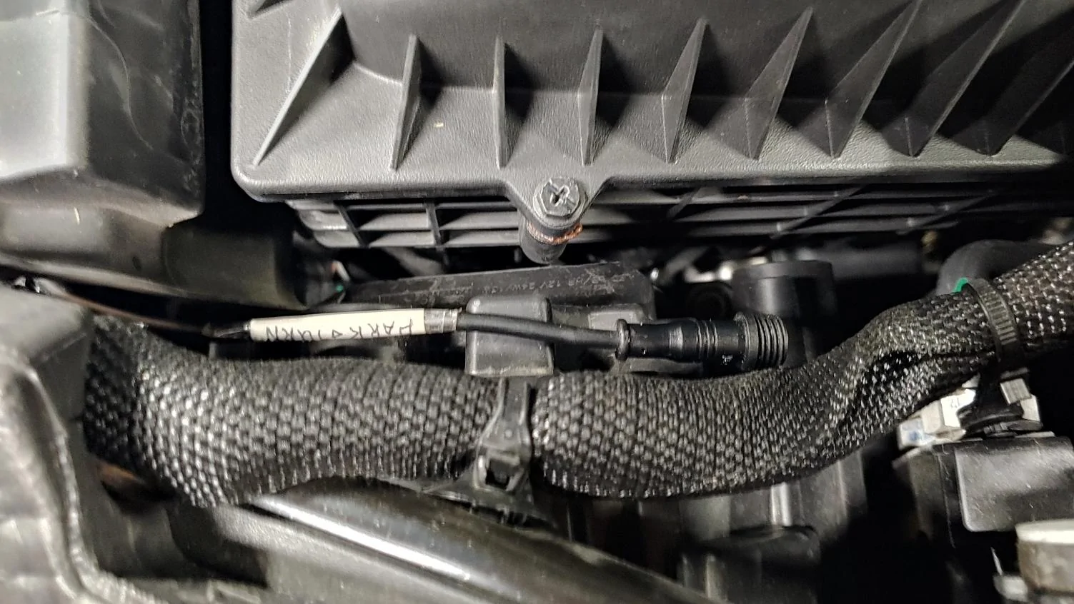

Modified and installed the harnesses to give me "triggers" for left turn, right turn, park and DRL lights to operate the snow plow lighting.
No factory wiring was cut in this process.
Right side harness will trigger the plow's right turn and park lights.
Jeep Gladiator What did you do TO your Gladiator today? [ADMIN WARNING: NO POLITICS, NO GUN TALK] 20221020_161945_HDR

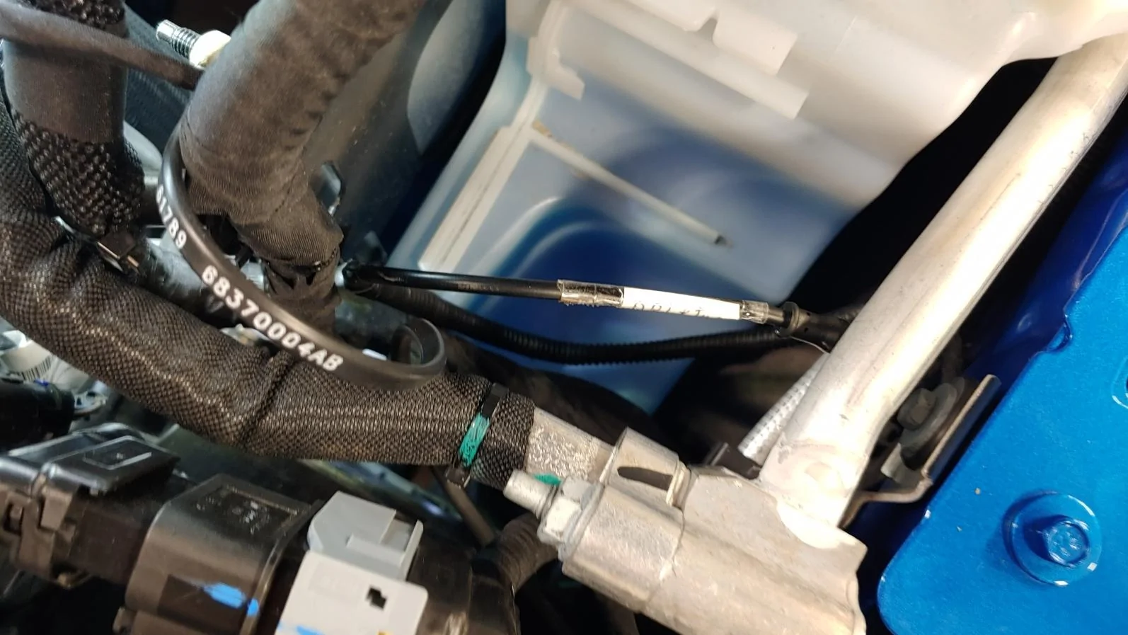

Left side harness will trigger the left turn and DRL -
Jeep Gladiator What did you do TO your Gladiator today? [ADMIN WARNING: NO POLITICS, NO GUN TALK] 20221020_162013
These will get wired to the snow plow lighting systems harness and plug into what you see above -
Jeep Gladiator What did you do TO your Gladiator today? [ADMIN WARNING: NO POLITICS, NO GUN TALK] 20221020_164237

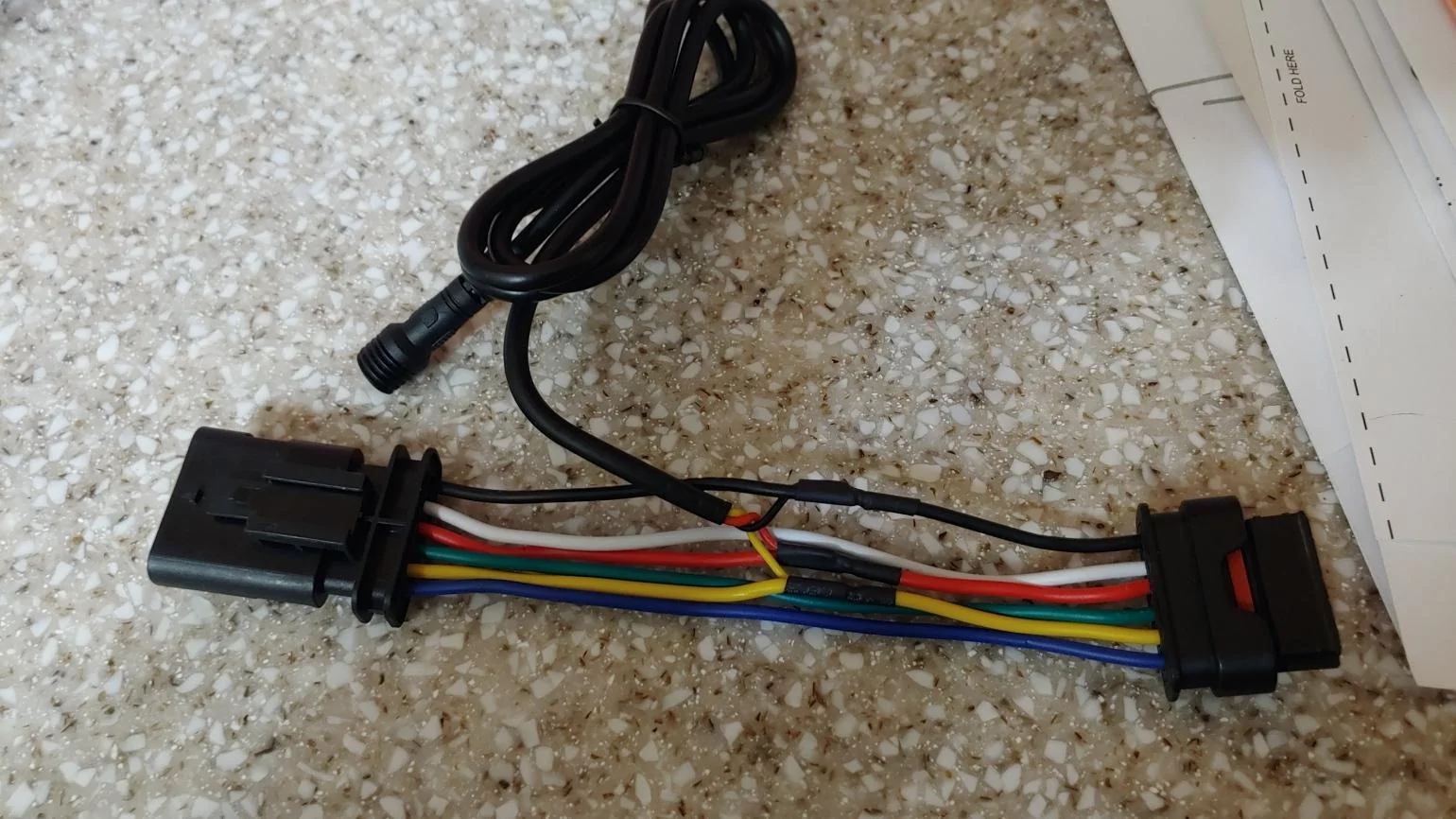

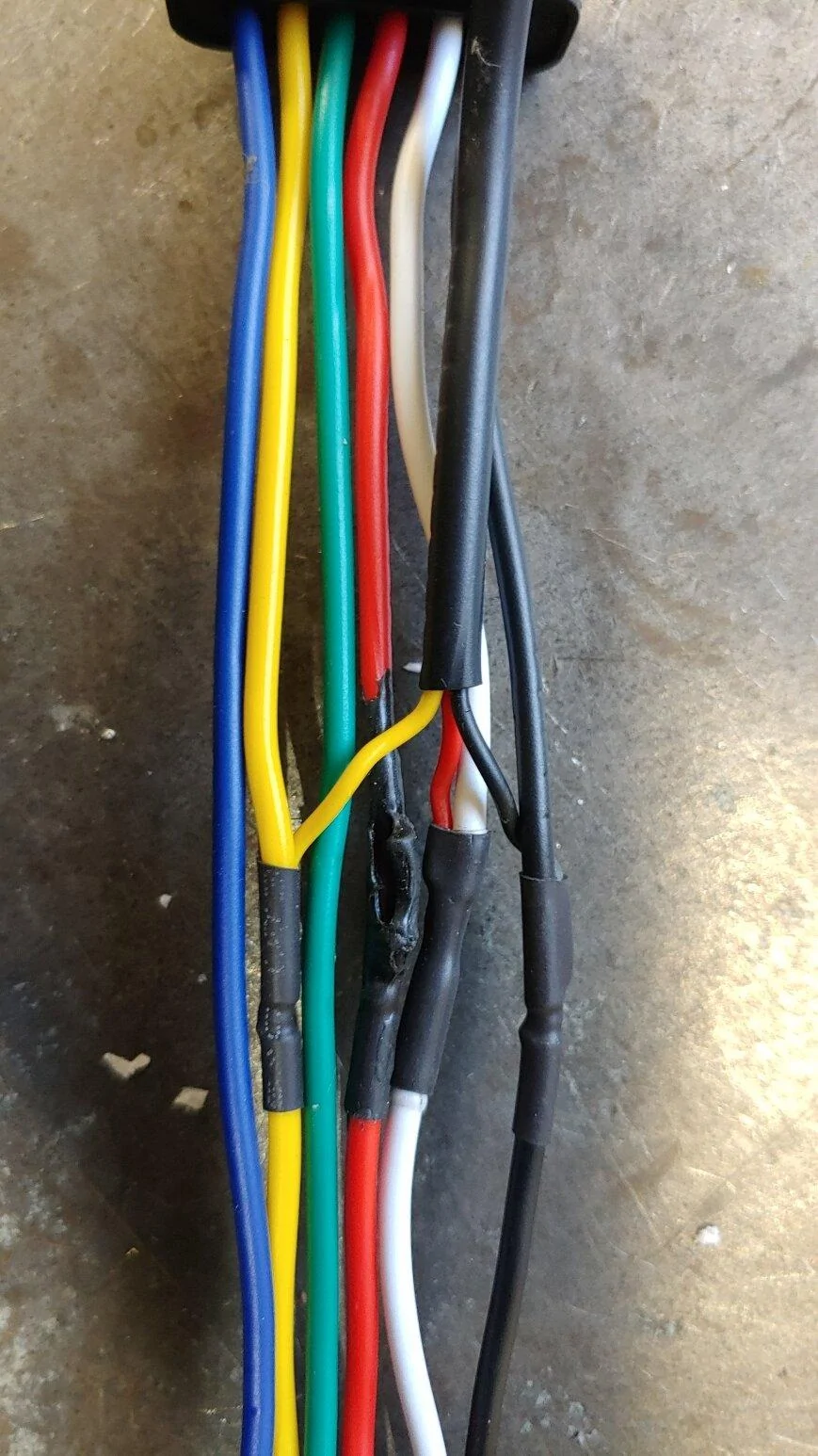

These are the short harnesses that allowed me to tap into the truck's wiring without cutting anything -
They had a weird non-standard soft shelled threaded fitting on the end. My fittings didn't work so I did have to replace the screw-together ends on the black leads.
Jeep Gladiator What did you do TO your Gladiator today? [ADMIN WARNING: NO POLITICS, NO GUN TALK] 20221019_221735

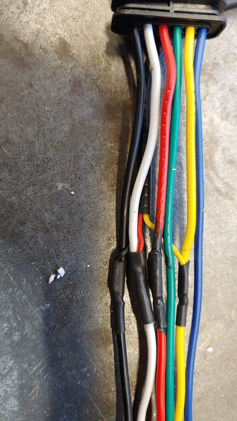

On the harness for one side I had to move a lead from the red wire to the white wire. Both were set for turn and park, I needed one of them to be DRL -

What are folks attaching to the molle panel? I'm interested, just not sure of what I'd put there or how "useable" it would be.

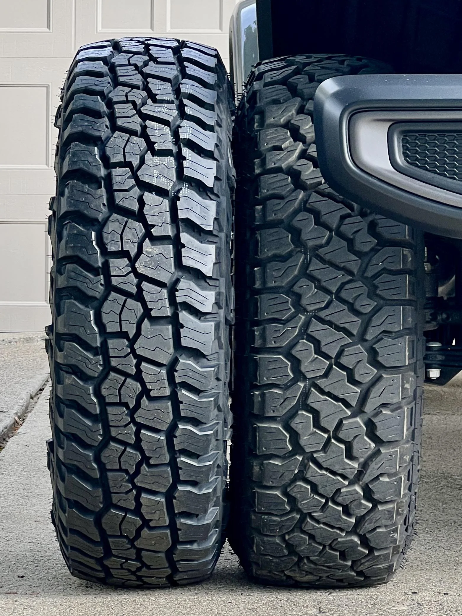

Those Baja’s look amazing! Now I want some. They seem to be the most aggressive A/T’s out there, so they should be good in occasional mud. And I like pizza cutters ??
Here’s a much better picture of the two…
Mickeys on the left.
10” wide tires on 7.5” wide wheels
vs.
10.5” wide tires on 8.5” wide wheels
Oddly… you can see more of the right side (actually the outside) of the Mickey’s sidewall. Must have been the bottom of a 5 tire stack in shipping.

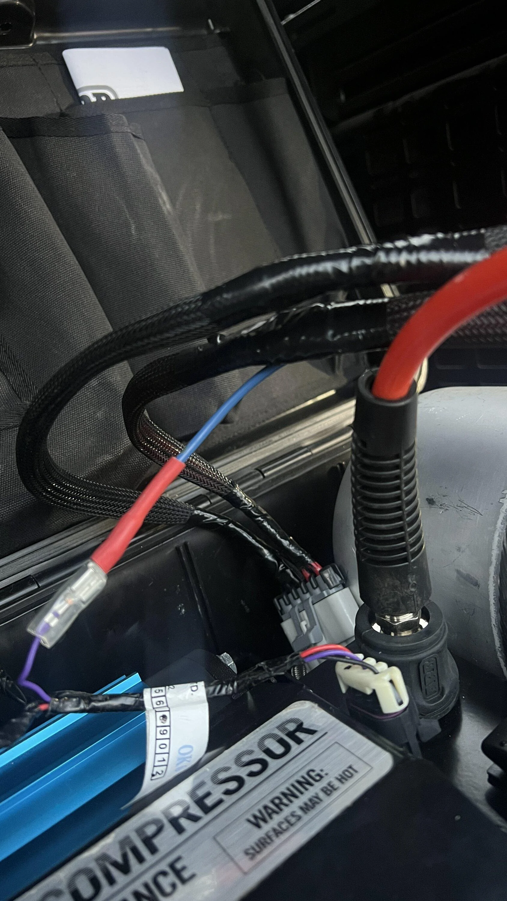

just about finished the wiring for the OBA. had to hook it up to test and air out the sprinklers with an approaching storm. Just need to clean it up, and mount to the molle panel. Pretty happy with it so far.
