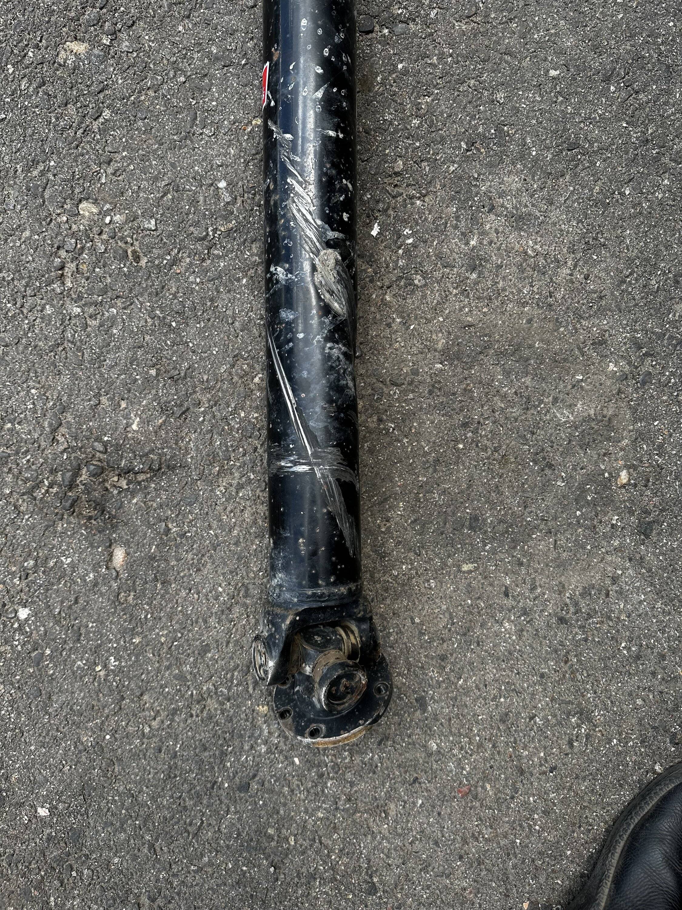

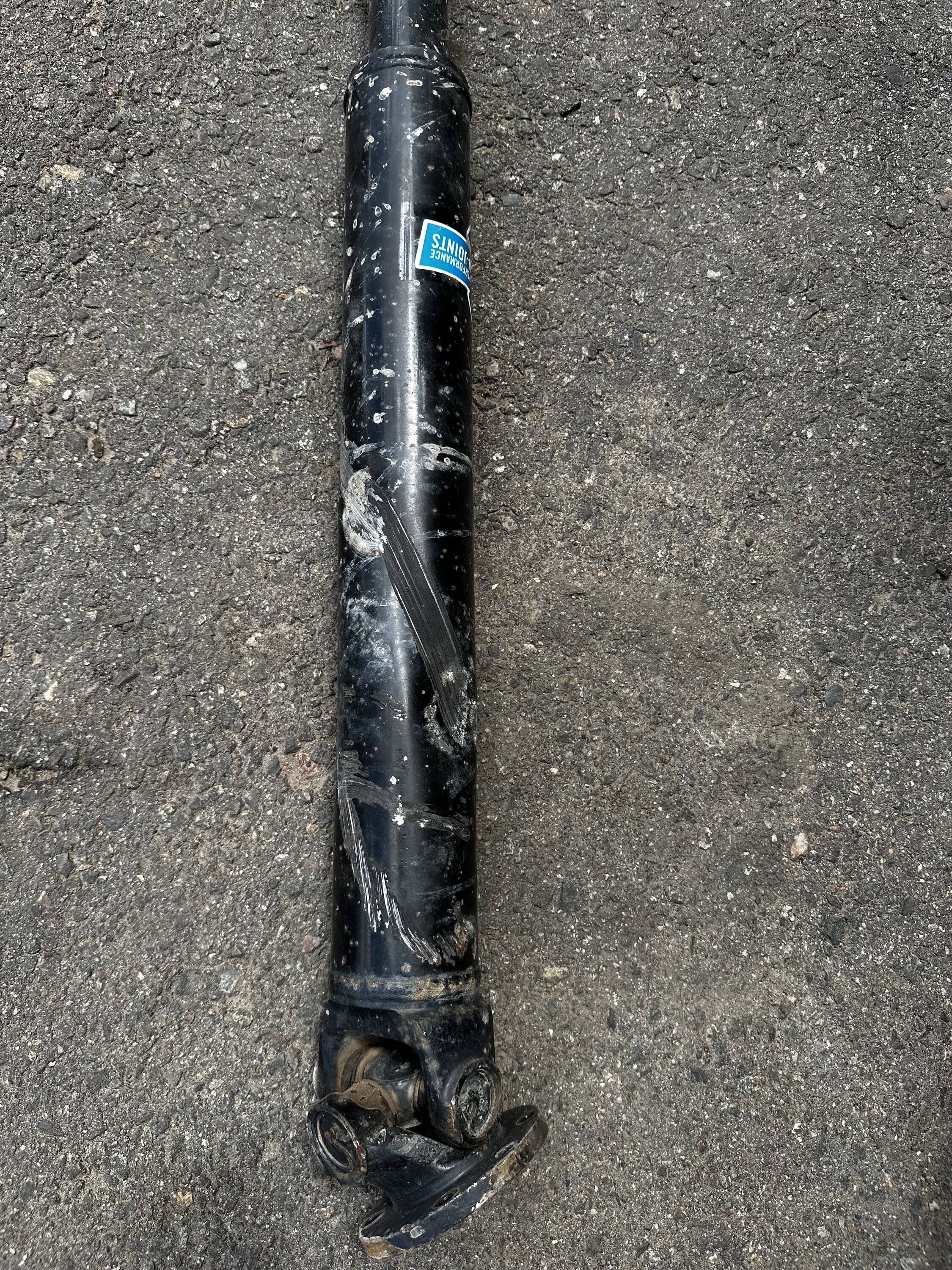

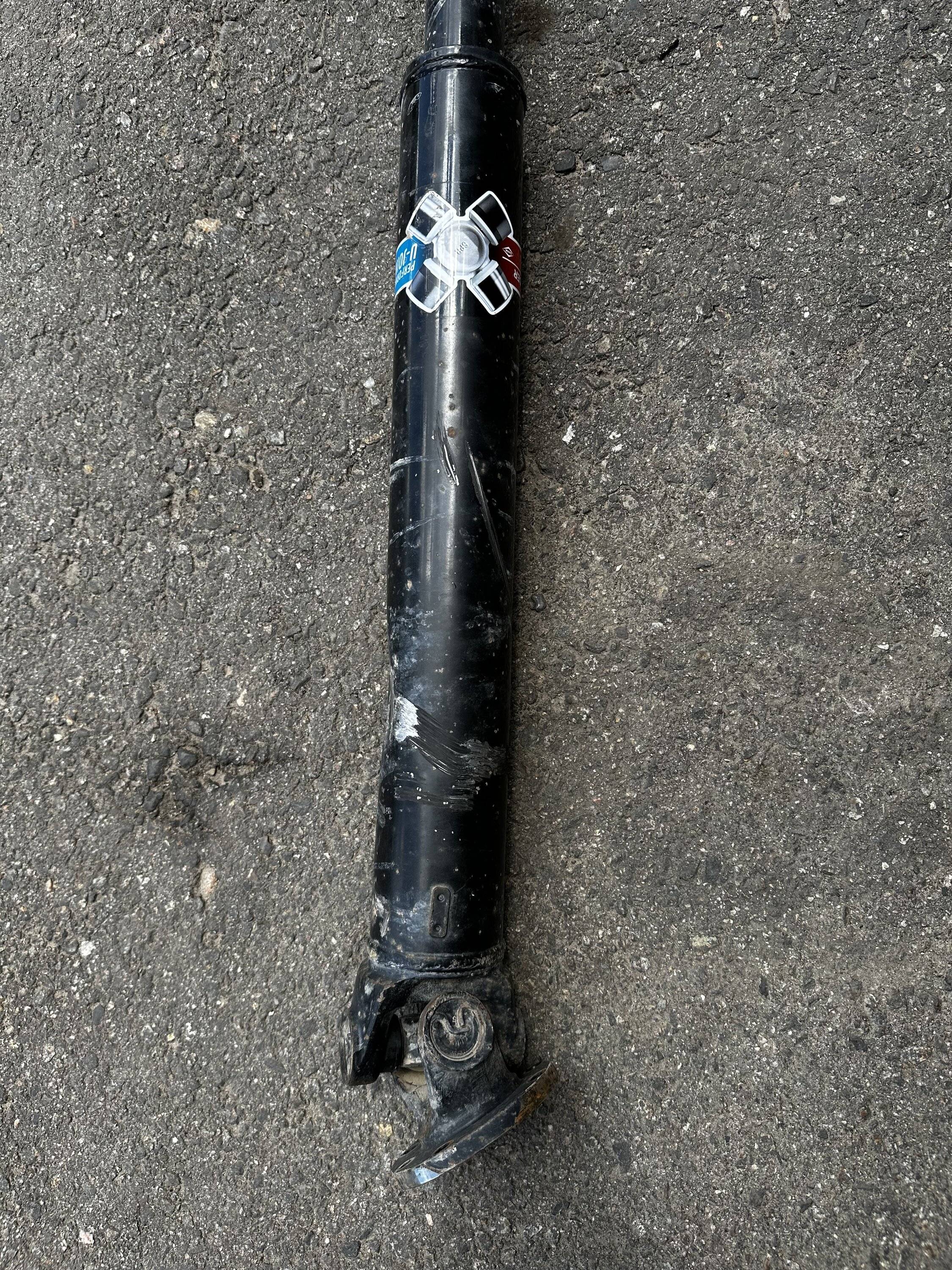

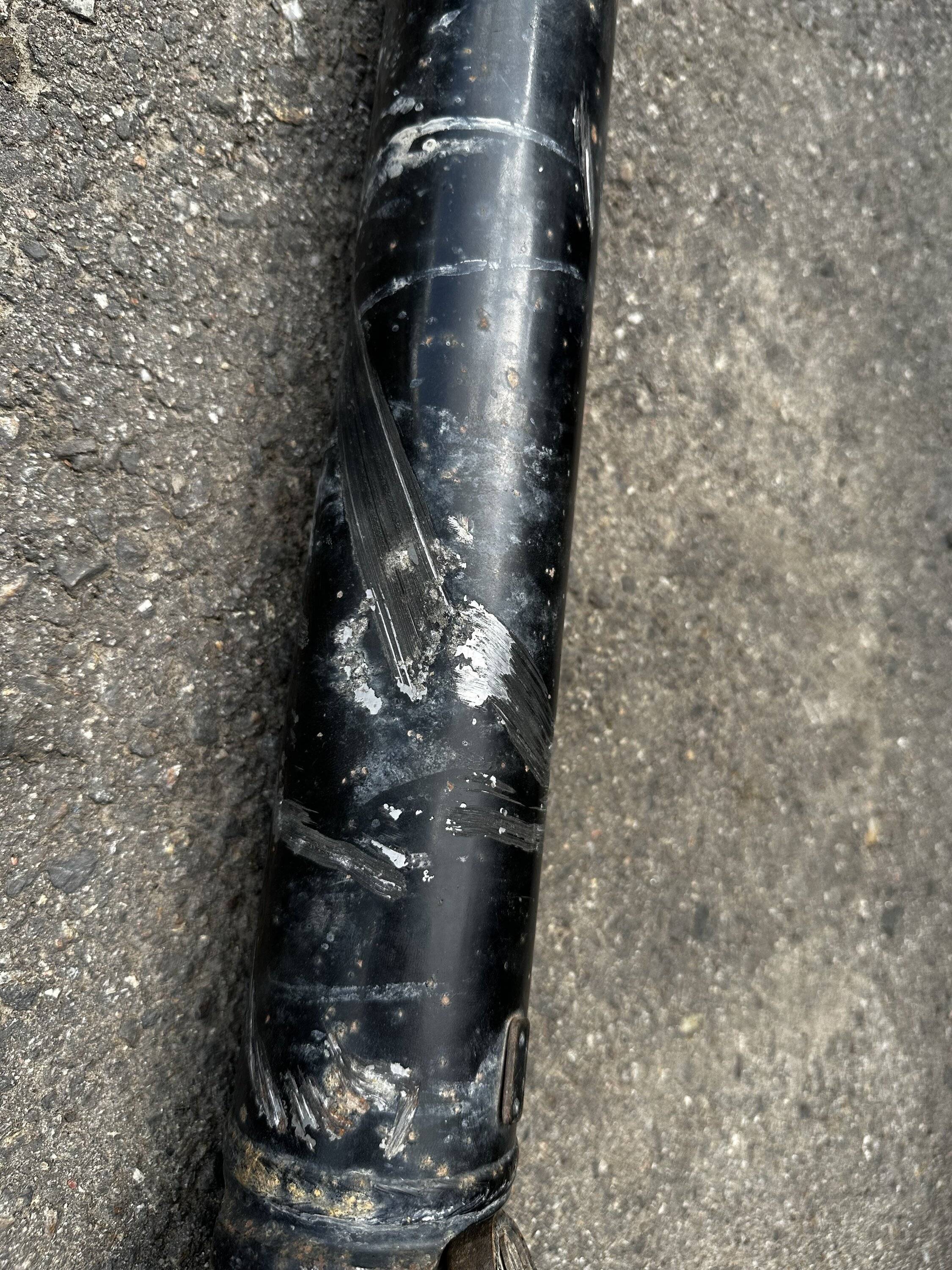

Swapped out a damaged driveshaft after running Holy Cross yesterday. Slipped off of a boulder and it was in the wrong spot. Temporarily running the old Oem spare until it’s sorted out. Runs great after getting rid of the dented one.

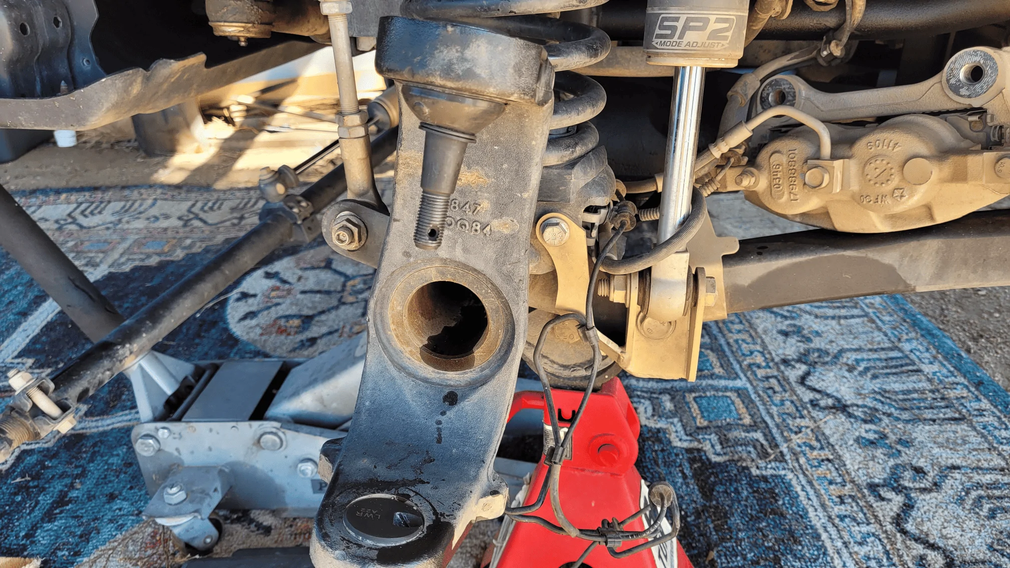

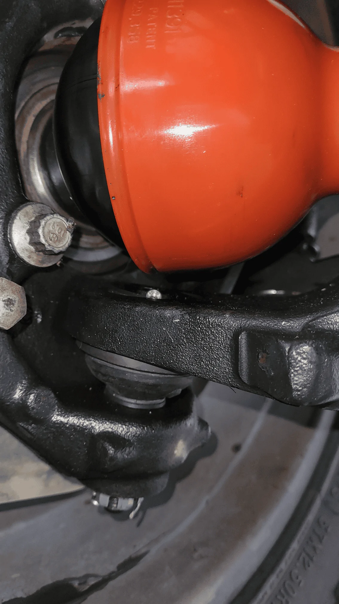

Who’s ball joint? Did you have one fail?
Ball joints are from Synergy. From what I've read OEM ball joints are steel ball with plastic/nylon cup that wears faster with larger tires. My JTRD has nearly 50k miles on it and I didn't want to give the OEM ball joints the opportunity to fail.

Preventative is always best in my opinion as well.

That will make a nice piece of shop art on the wall.

Did you try to buff it out?

Actually I’m having it rebuilt. Dropped it off at a driveline shop today. They’re replacing the rear tube and 1350 joint, and rebalancing. It’ll cost a fraction of a full replacement, and I’ll have it back this week more than likely.

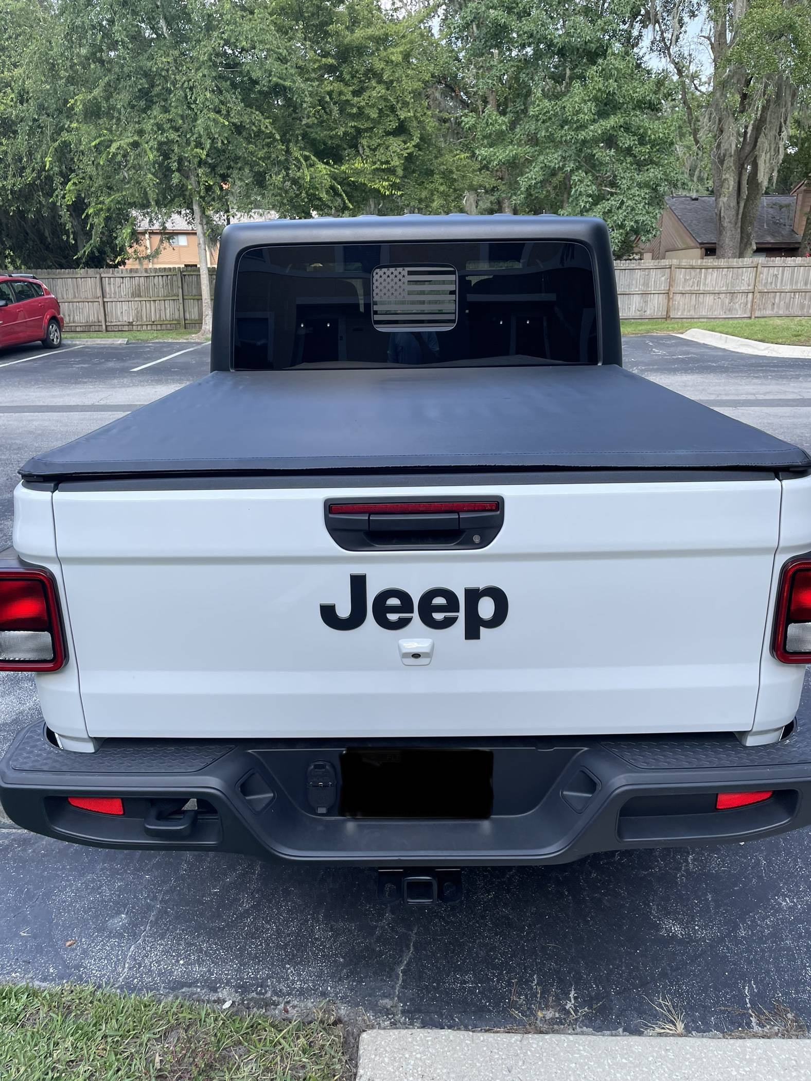

Very happy with my tonneau cover I put on this afternoon. ??
I really like that flag decal on the rear window slider. Can you tell us where you got that? Thanks
