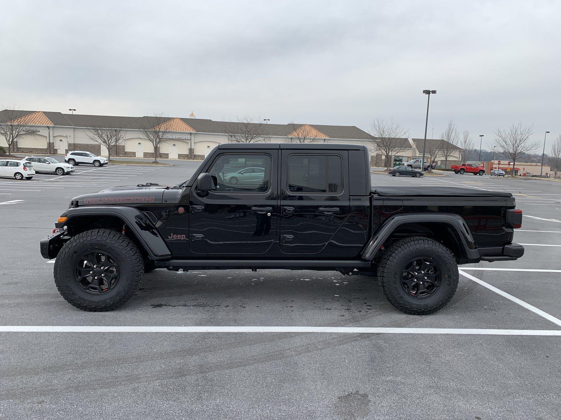

Looking good! Are u going to paint the Hauk gladiator silver to match like the factory Jeep?
I have a Hauk gladiator and was going to do the black wrap trimmed in red then paint the gladiator silver when I paint the front bumper. Also going to trim the gladiator out in red like the factory Jeep emblem
Thanks! I considered both the options you mentioned but after mocking up the Hauk emblem I like it in black.
I've been too busy the last few days to finish the tailight surround, but I'll likely do it today and take a few pics.

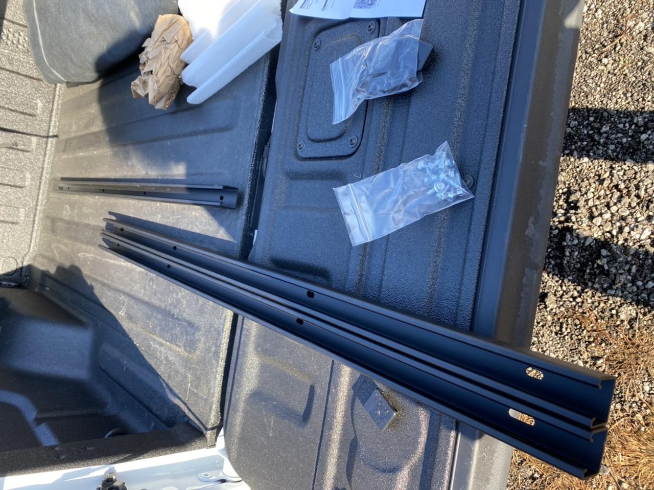

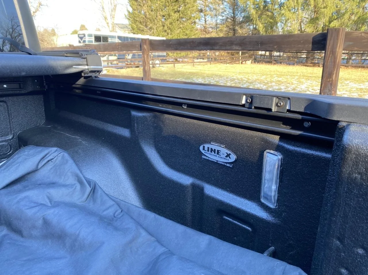

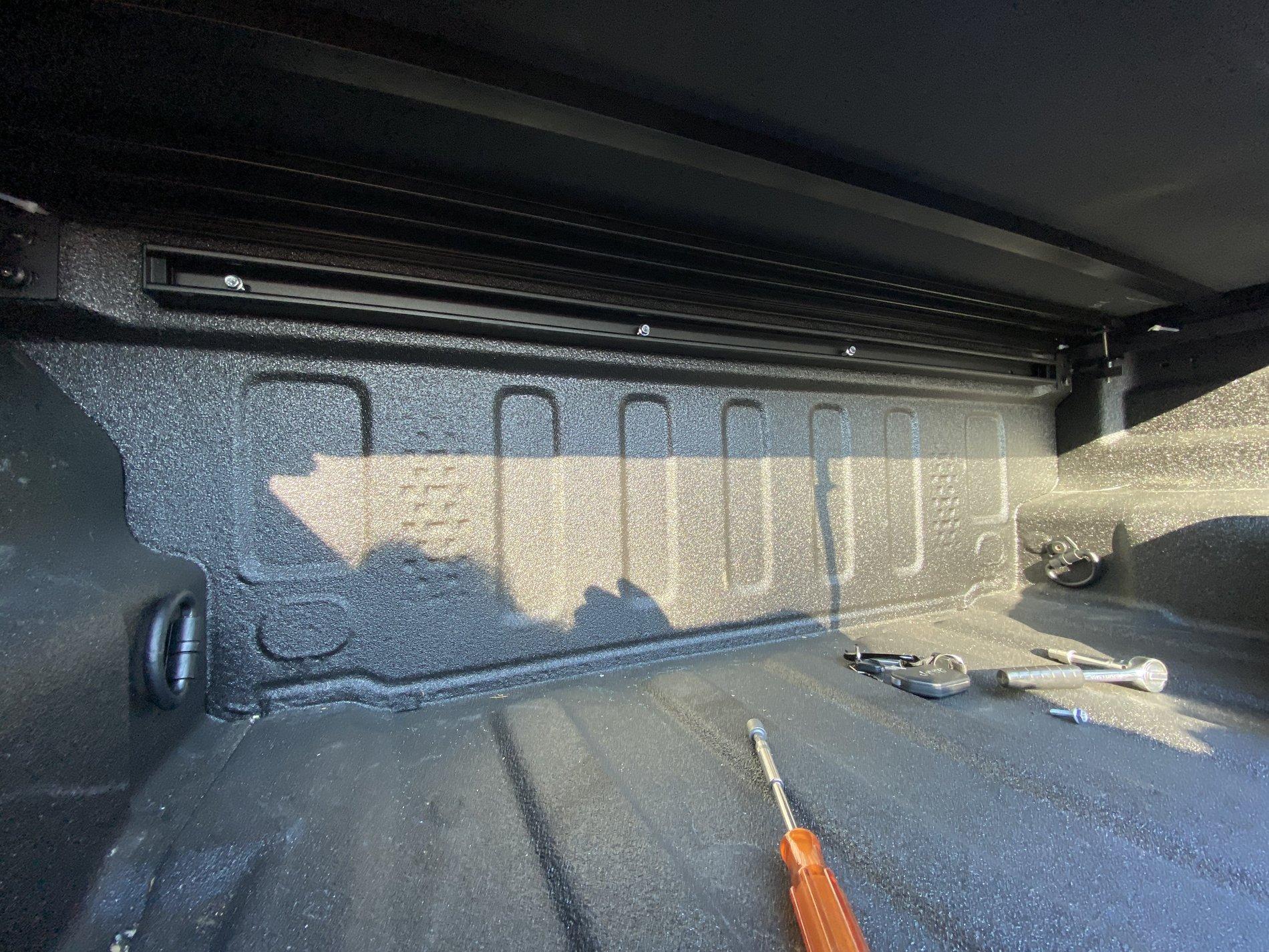

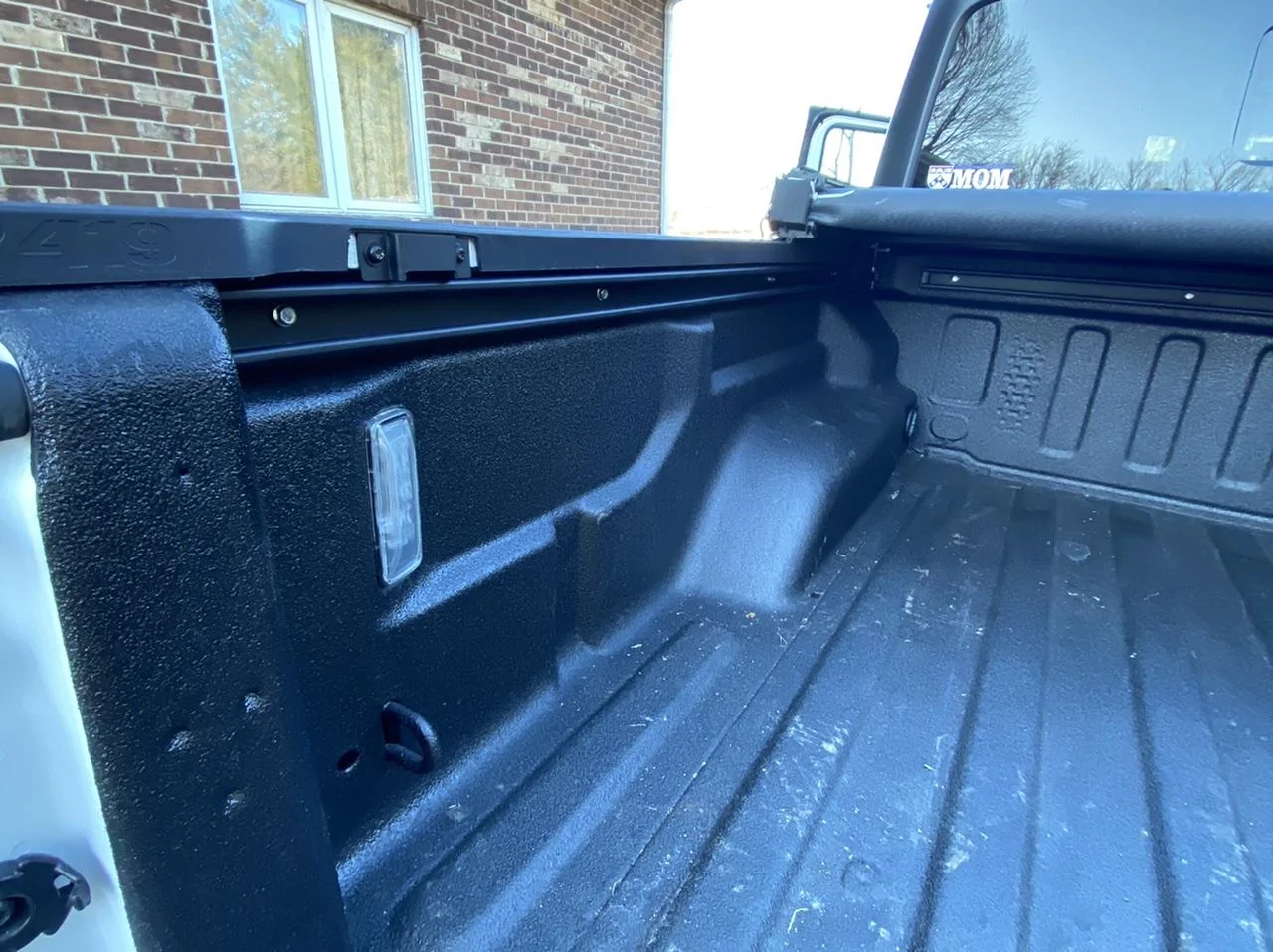

After having it for over a week, we finally installed my BuiltRight Utility Rail System. We had to fight with the Line-X though as it was sprayed over the holes.

Easy as pie, I used a 24" breaker bar to start and then a 1/2 ratchet did the rest.
Watch the Ace video dedicated to the JT and you can't go wrong.....
I used two 5 gallon buckets to hold the rail and slide under truck to install, blue lock tight, torqued to 82 ft lbs n I was good.
Just curious if while loosening the bolts if it felt like any of the the nut was loose. I heard 2 pops as I started loosening mine with a breaker bar, I was able to loosen the bolt but then at the end it just spins and won’t come out. I can tighten it back up so not sure what’s happening.

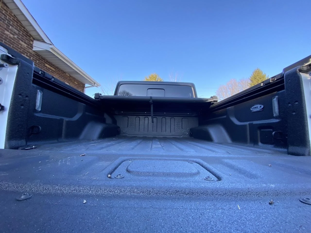

Did the same with mine today. No line-ex but the paint also did cause some tough threading. Tips for those going to install the BuiltRight rails:
- put the end caps on before install - the rear end cap will butt up against the bed.
- test fit the bolts to ensure the threads are clean.
- the long slot goes to the front of the truck, otherwise all the holes won’t line up.
- it’s a 1 man job, but extra hands are helpful as the rails are heavy.
- I used a spring loaded shower rod to hold up the loose end while I threaded in the first bolt.
- on the front rail I set one end on a milk crate while threading the first bolt.

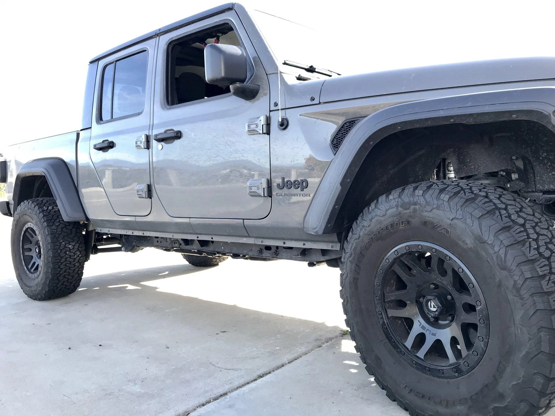

Gave it a bath to get the salt off and checkout my freshly mounted 35’s. Also checked the speedo after adjusting with the Tazer, looks like I got it set right on.

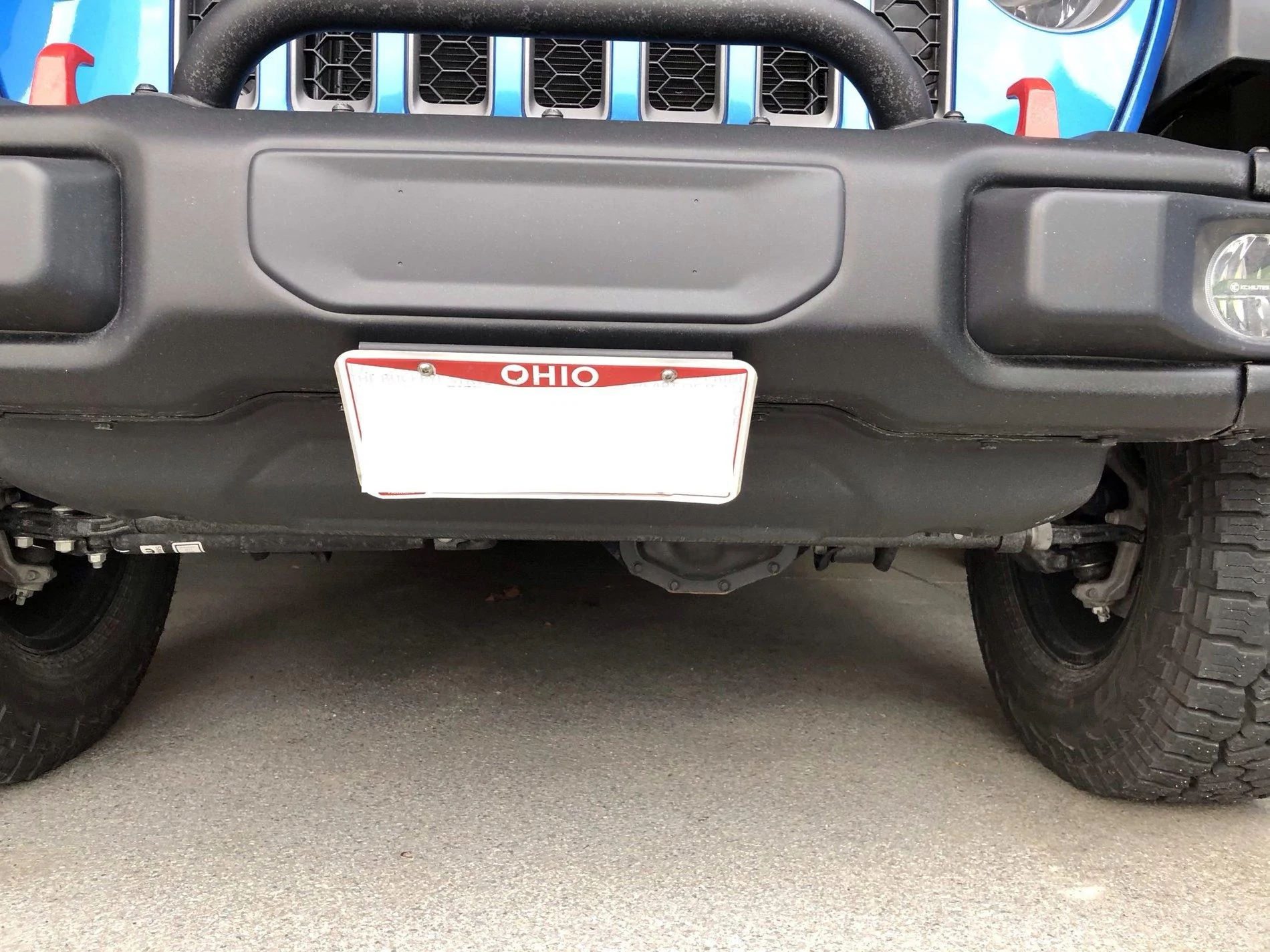

Another big mod, installed the Maximus-3 stealth license plate bracket
I had that happen today as well. We determined it was the Loctite breaking loose. Scared the crap out of me on the first bolt... did not want to have to deal with a broke bolt!
