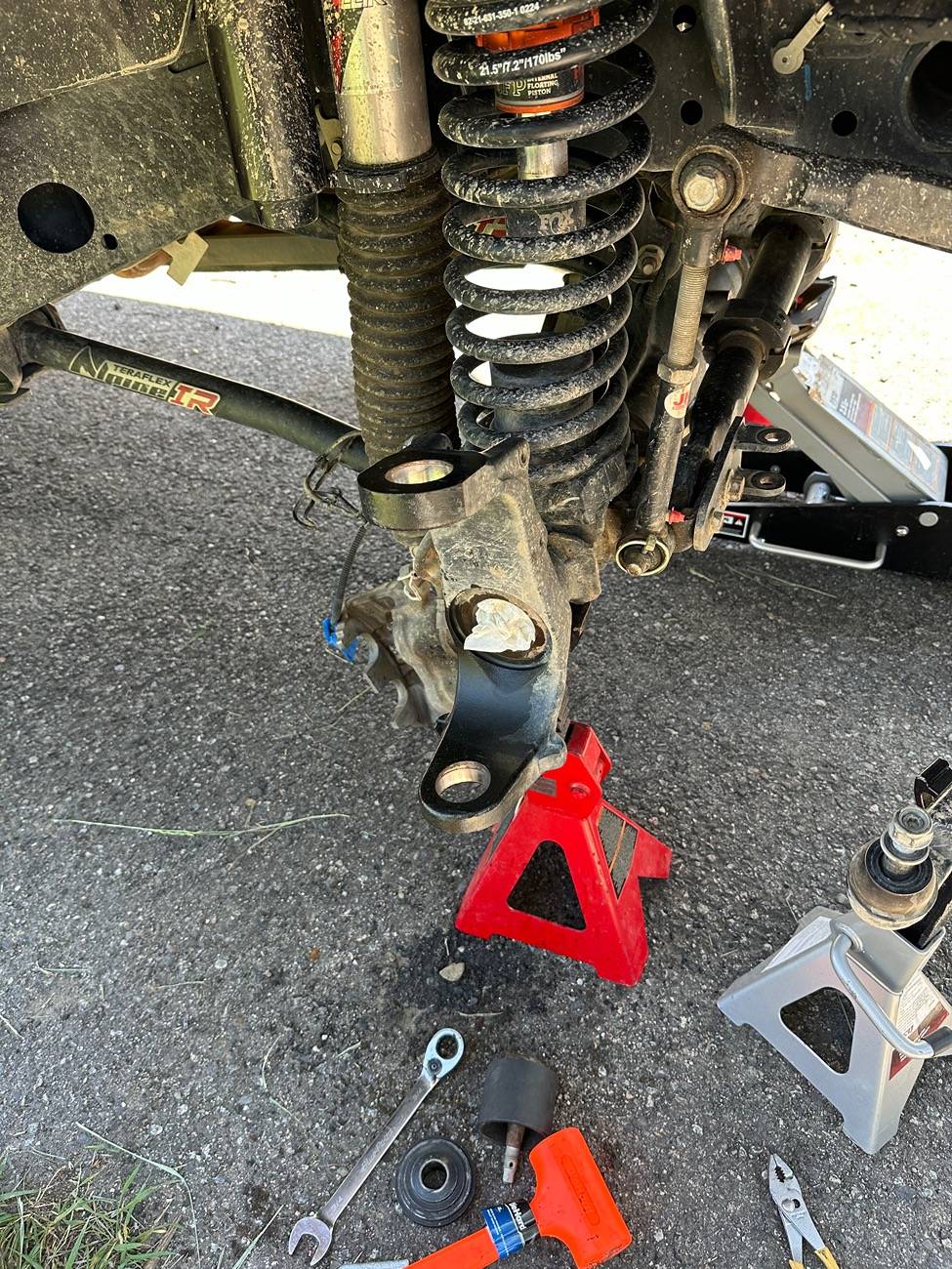

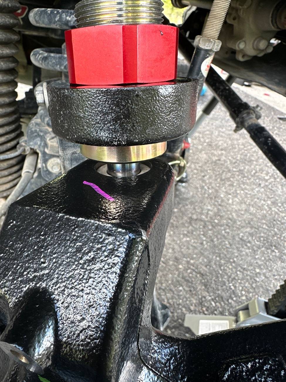

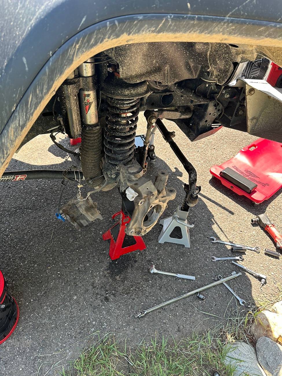

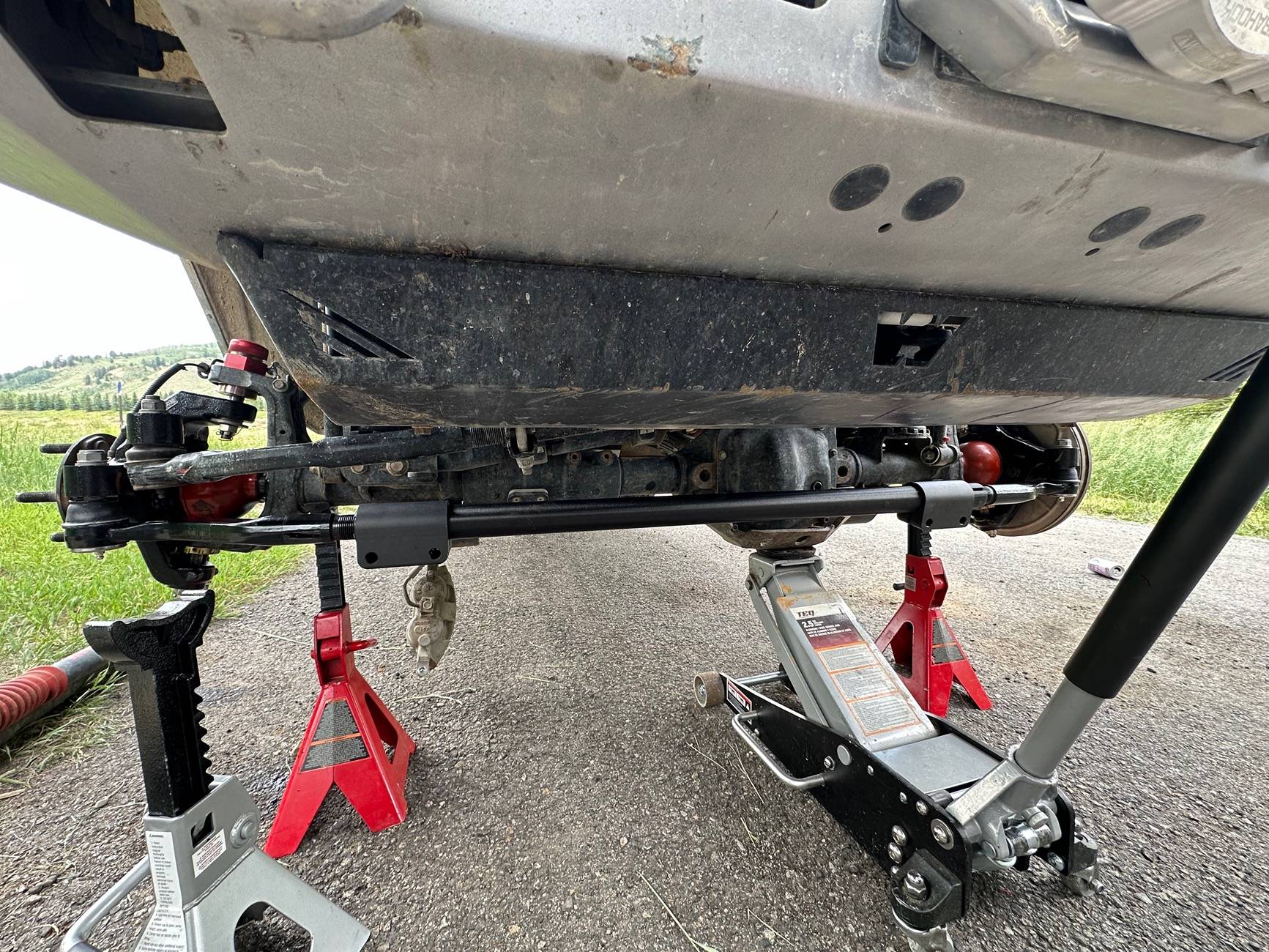

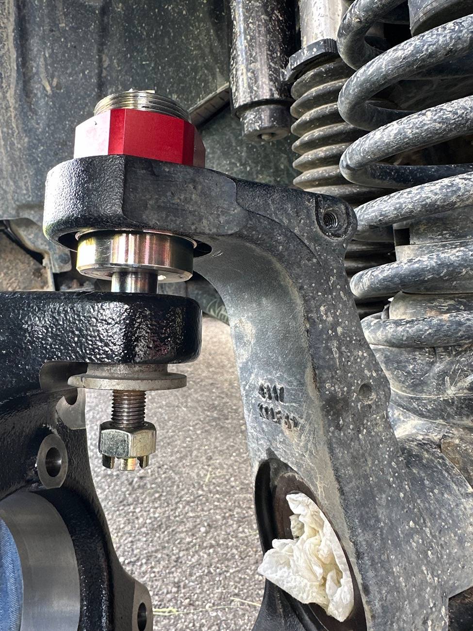

This was all done a few weekends ago but just now getting around to sharing. Went from the 3" Rock Krawler pro x to the 4.5", Rock Krawler aluminum tie rod and drag link flip and the Reid Racking knuckles.

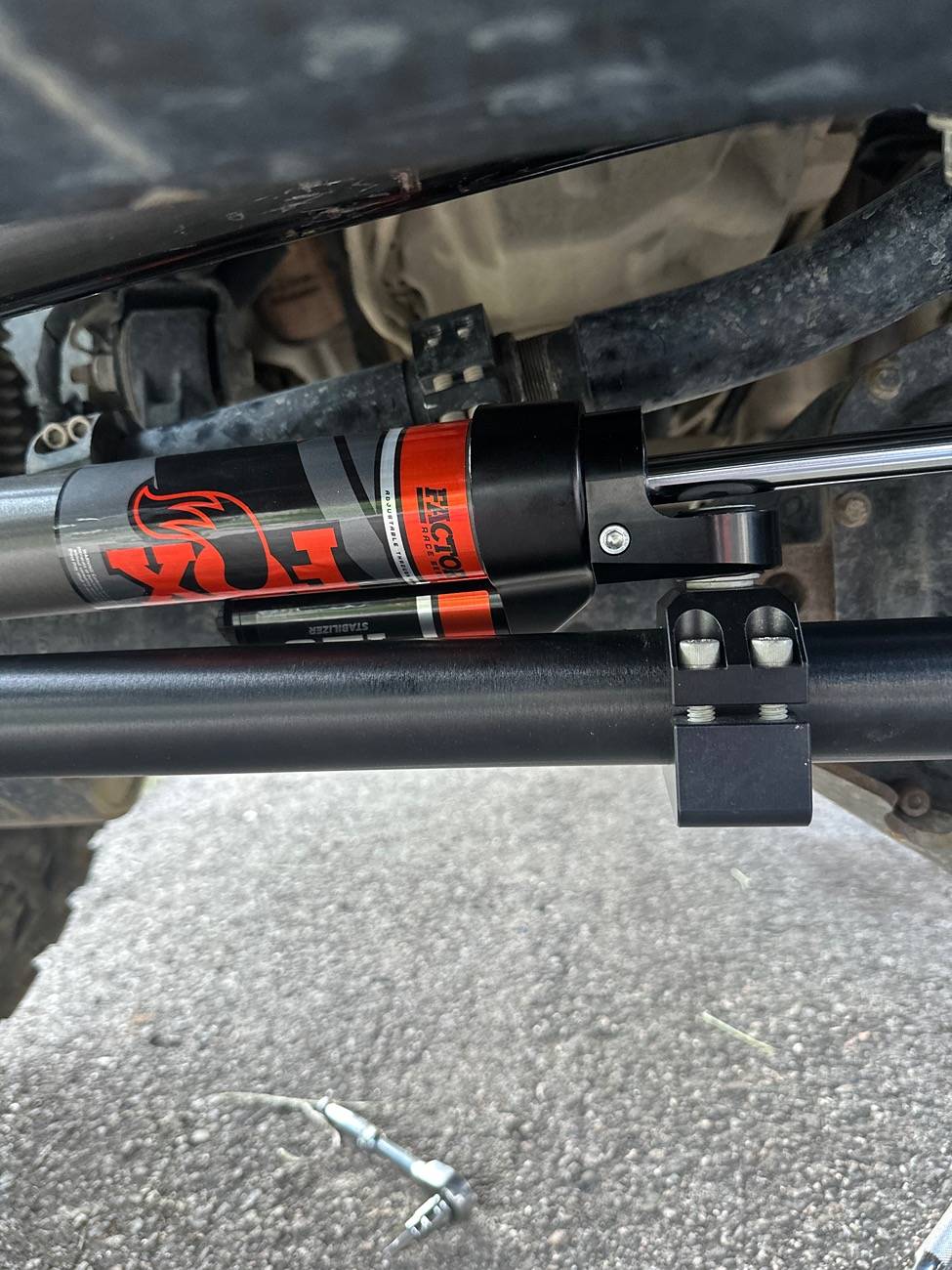

Lots of work. Great job. Did you do ball joints at the same time? Whose stabilizer is that? I don’t think I’ve seen that one.
OUPS forgot to mention that one even though it also put a nice dent in my wallet:LOL:. It is Rock Krawler pass through stabilizer

Nice. I just installed the Fox adjustable pass-through. I haven’t used it off road, but it’s great on road. Next weekend it’ll get tested.

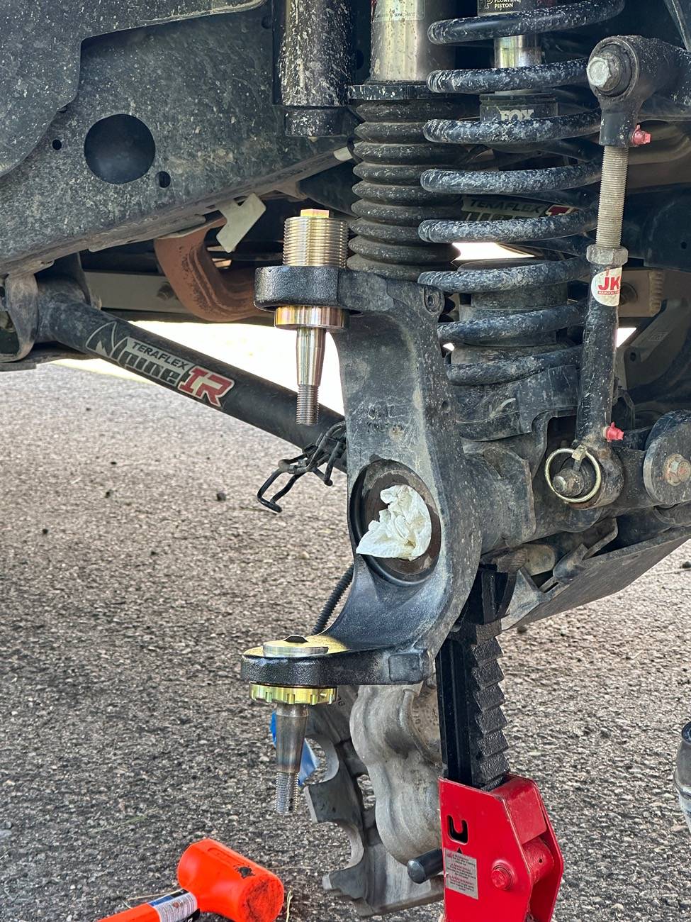

I did the ball joints when I did the RCV's a few mounts ago. I went with the Dynatrac HD.

I started with those, but the failing snap rings left a confidence problem for me. So I went with metalcloak. I already had RCV’s. But I upgraded to mopar cast iron knuckles so I could retain the adjustable steering stop. I actually just added a flat and a lock washer to them today to try to resolve an extremely minor running problem at full articulation with the sway bar disconnected.

Mostly got the passenger side done. It was a fight. I’m hoping I didn’t damage the axle seal. It was listing to passenger during the project due to driveway angle. So some gear lube came out during, but I slowed it with paper towel. I assumed it was the angle. I ran out of time so haven’t topped off the diff yet. I’m really hoping the little bit that came out after the shaft was back on was already in the tube past the seal. If not, I’ll need to pull them again and figure out how to replace the seal. Dammit. Oh well. I roughed in the new tie rod. Didn’t adjust it or clamp it yet. But it’s torqued on the knuckles.

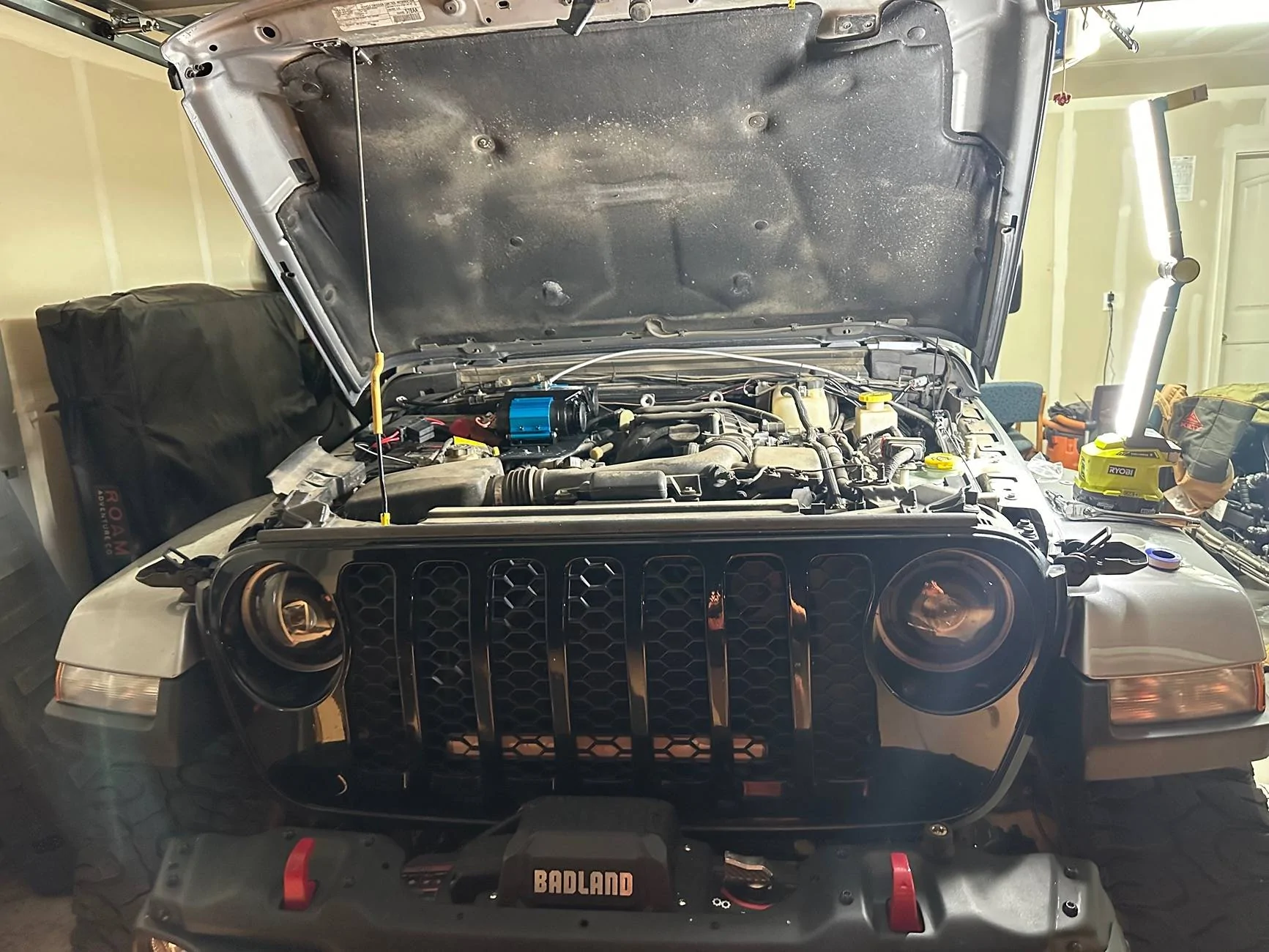

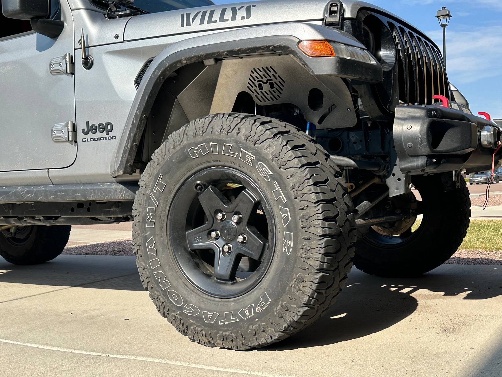

This past weekend installed metalcloak inner fenders and bump stops. Also threw in arb dual compressor with 813 fab mount and routed the chuck to the bumper. All wired to factory switch. Also added 1 inch spacer to the front.
