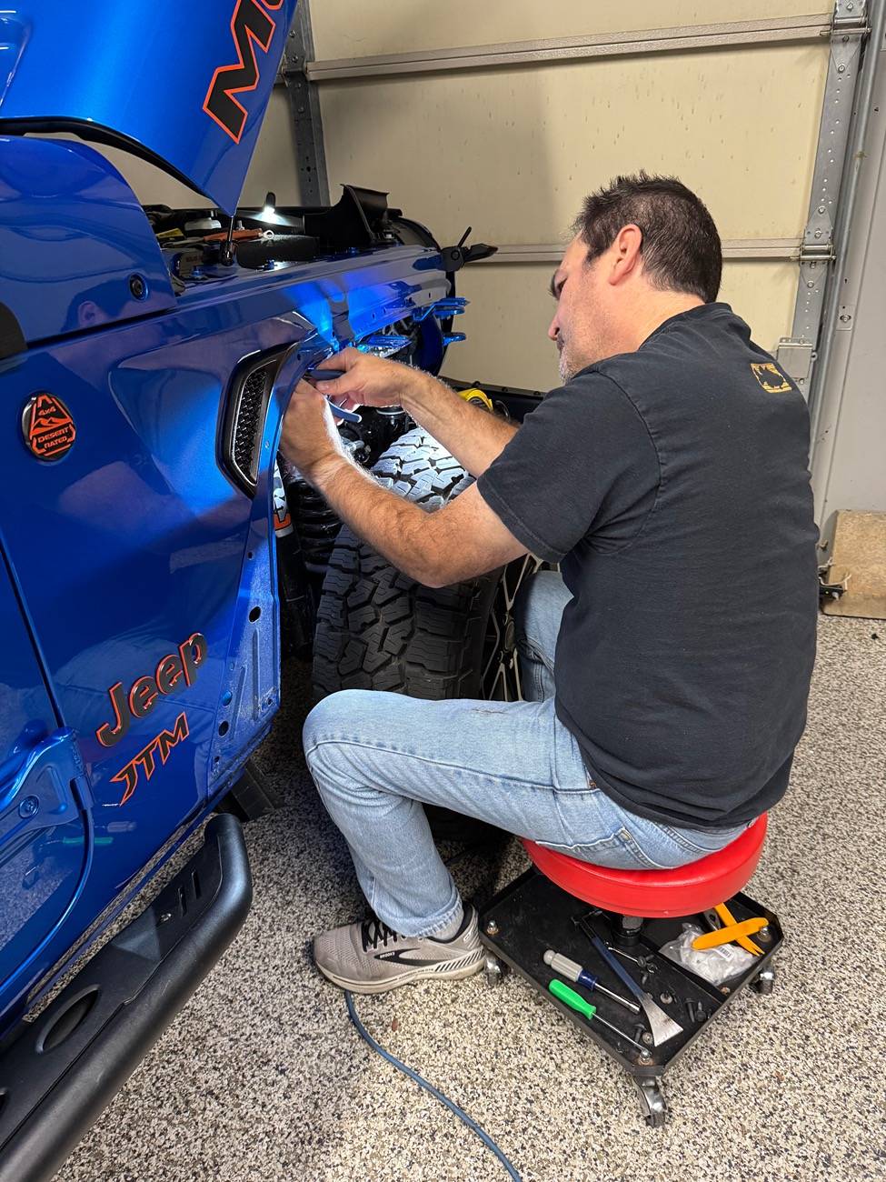

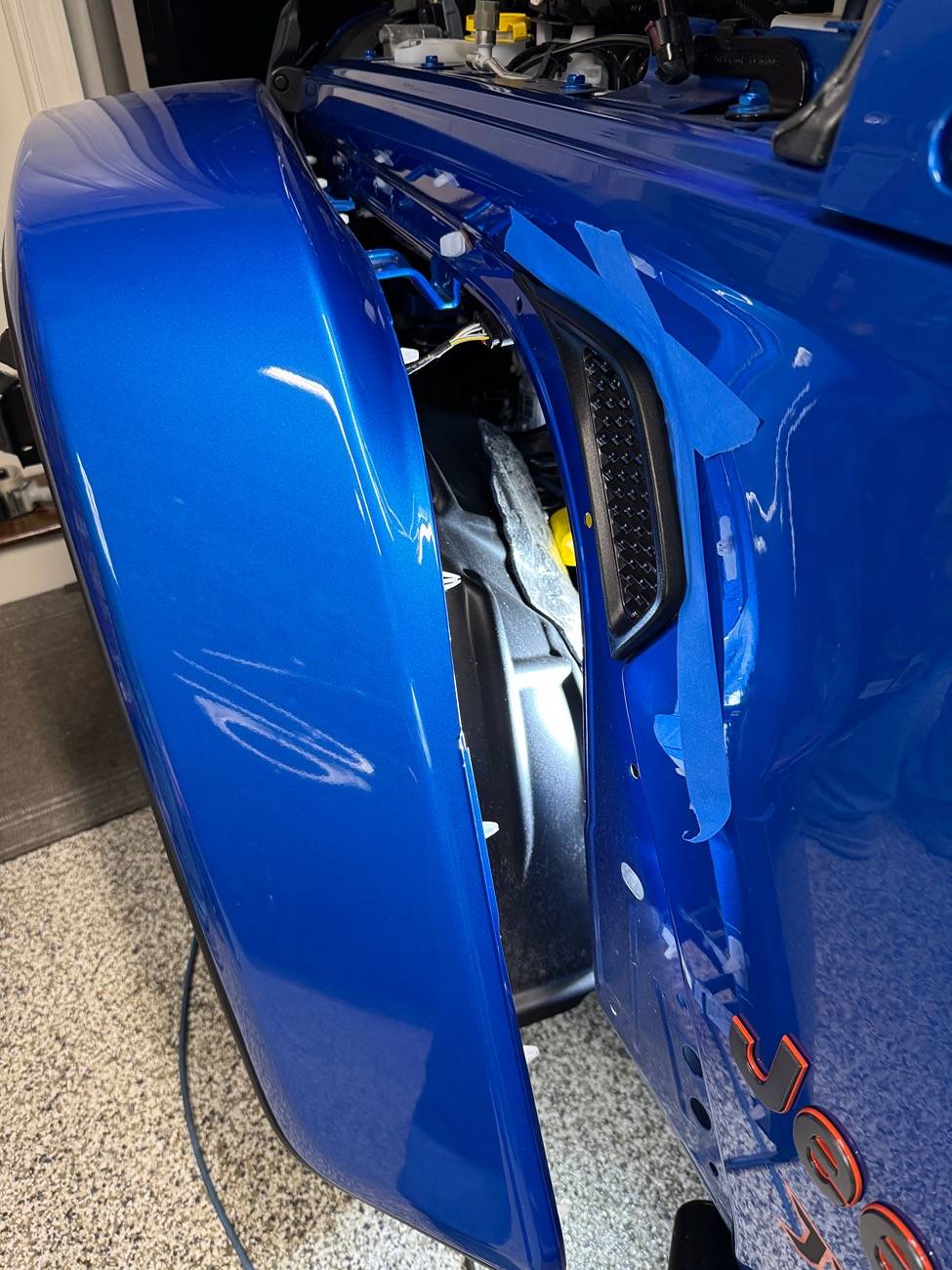

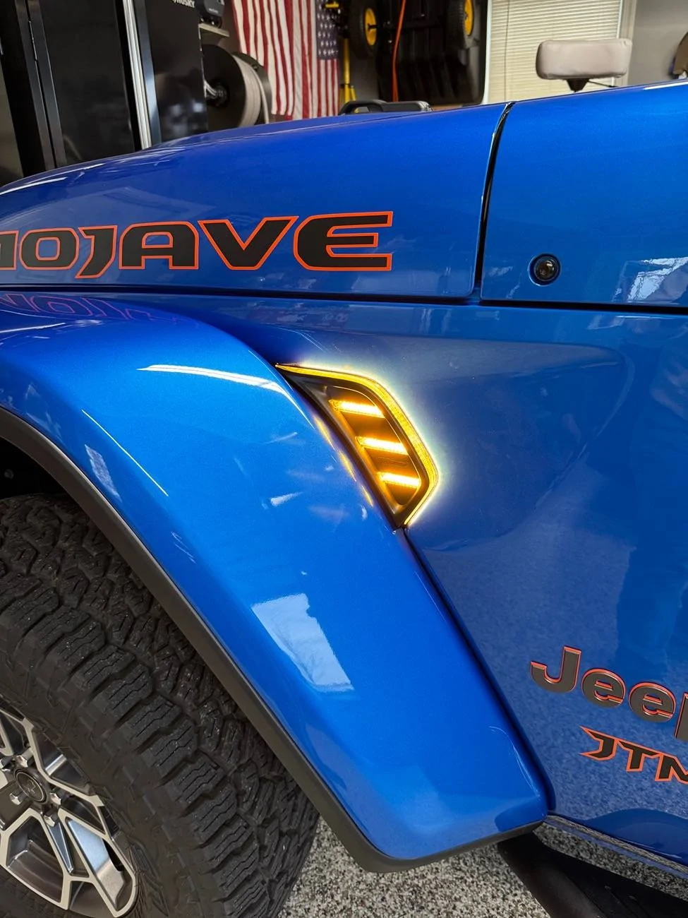

Last weekend, we thought we‘d install the XKGlow Vent lights but realized…. the install wasn’t nearly as easy as all the videos and information let you to believe.
Last week… I ordered 2 packs of white clips and 1 pak of Christmas tree clips.
We used to wrench all the time when we were younger. As you age, I think you lose patience and motivation. Not only that, but working on a new vehicles (2024 Mojave) is intimidating. We were so afraid to break, bend, or ruin anything.

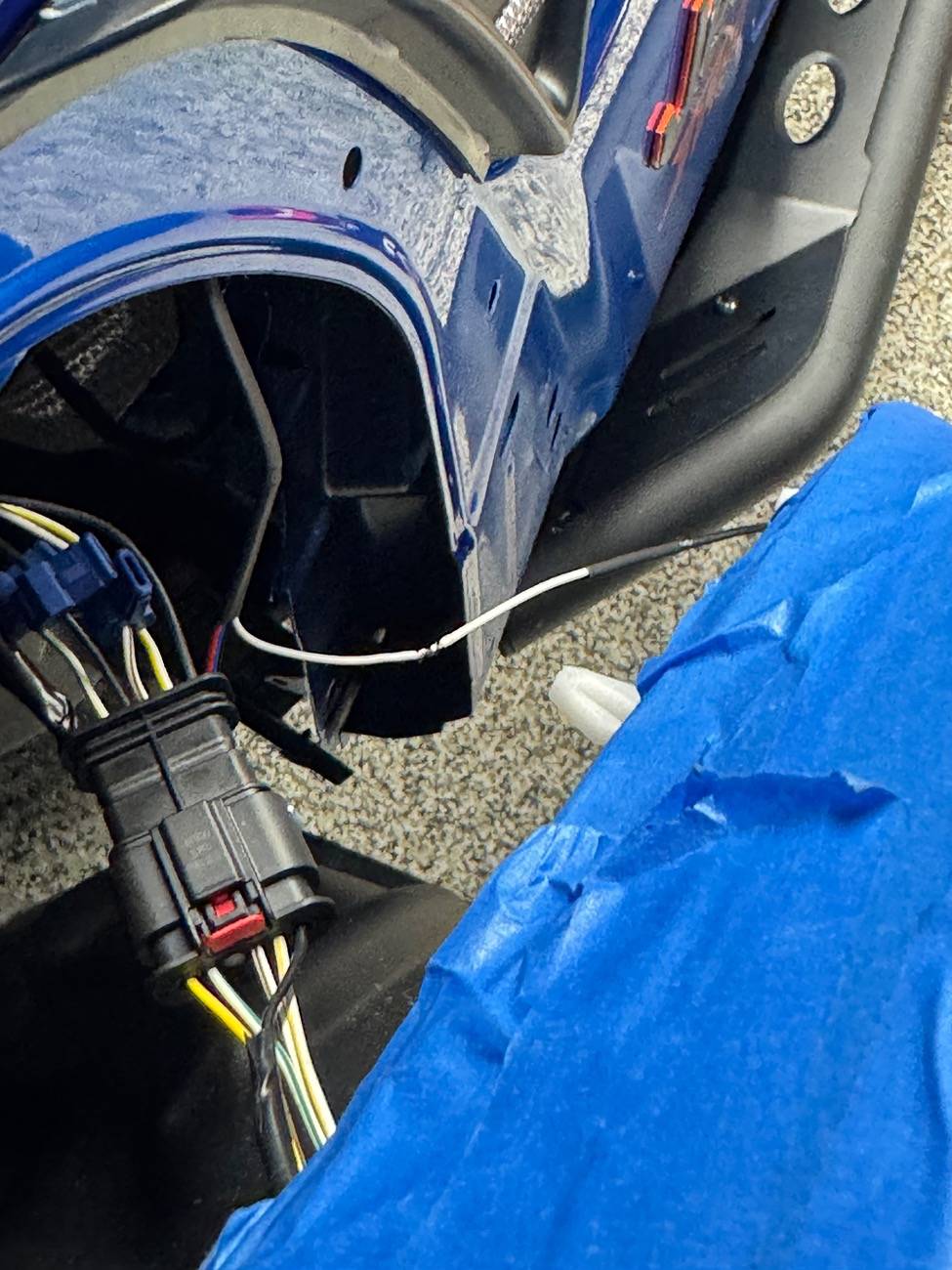

We decided to drop as much of the inner fender that we could. We did not remove any rivots…. Removed all the Christmas Tree cLips. We were able to peel back the inner fender enough to get behind the white clips and use a needle nose to pop them loose. Believe it or not…we only broke ONE white clip (on the front passenger side). ☺
It took a bit to understand the wiring… as the instructions aren’t very good. The hubby had a volt meter and he ran ‘temporary’ wiring just to run TESTS to make sure he understood the wiring.
Everything looks good … My husband routed the wiring to the battery with a fuse - tucked everything away so everything was clean.
The bad thing is……We did put a big scratch on the fender when it was pulled down. That has nothing to do with the install…just shit happens (Did I mention, we‘re afraid to break stuff)?😳
Very nice and I agree the directions are not the best. I ended up getting a wiring harness for mine. Plugs right in to the factory wiring harness plug and has the 3 wires to attach to the lights without tapping in to the factory harness. Very easy. I pulled my fenders off instead of removing part of the liner. Was worried about breaking something but with the support of @WILDHOBO I got through it with no issues. Broke a few clips but bought extras before I started the project. Love mine.
