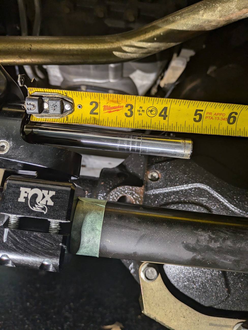

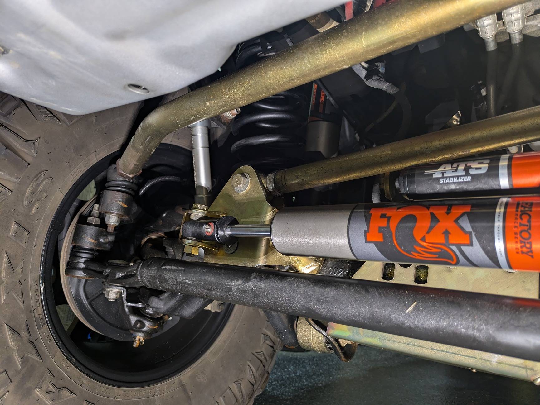

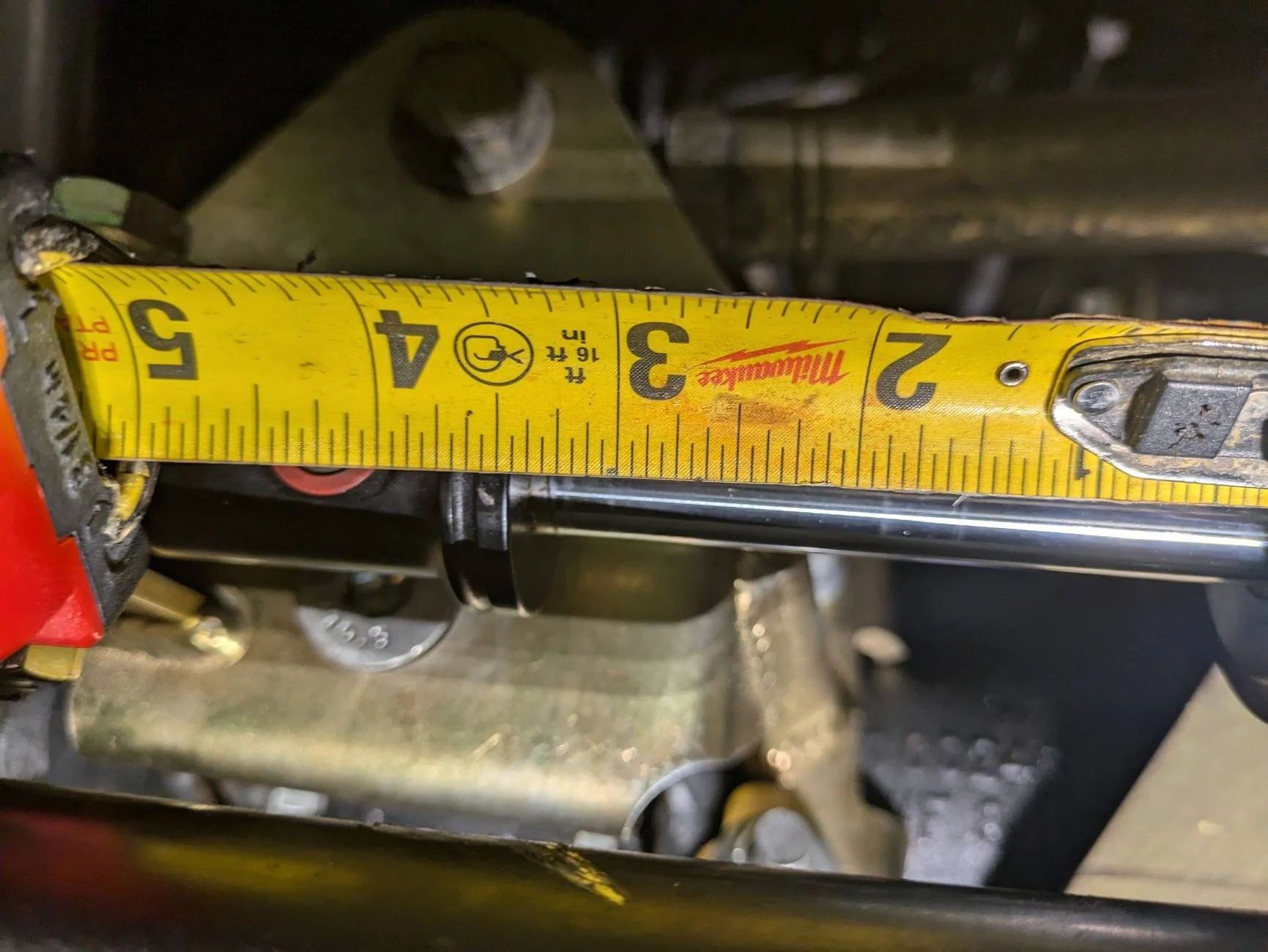

Ok, so prior to my steering stabilizer relocation it was mounted to the OEM stabilizer mounting points.....aka, can't fuck it up.
I just centered the steering wheel and measured again and there is an offset in the new location. See pictures below. Would this much of an offer from passenger side to driver side cause an issue?
I'm a GM guys and can do those suspensions and build an LS motor with my eyes closed. This is the deepest I've gone with a Jeep suspension.......so pride aside and looking to learn.
Picture 1 - post draglink flip
Picture 2 - driver side ATS stabilizer shaft measurement
Picture 3 - passenger side ATS stabilizer shaft measurement

So drivers side measured out at 4 3/4" and the passenger side measured out at 3 1/2"
So an 1 1/4" is a big difference in any suspension
Turn your steering wheel full passager and use a ratchet strap to hold it in place. Compress steering damper till it's about 3/8s from bottoming out. That is the proper way to set per fox.
Great information, thanks brother
