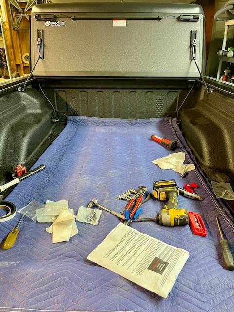

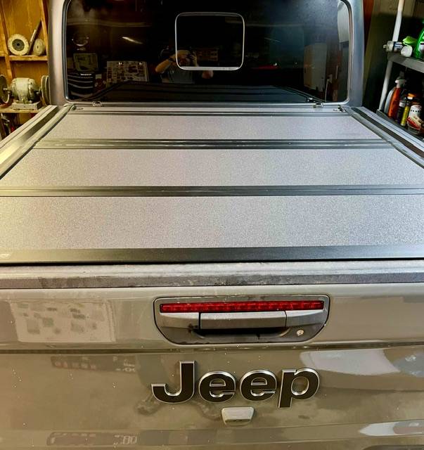

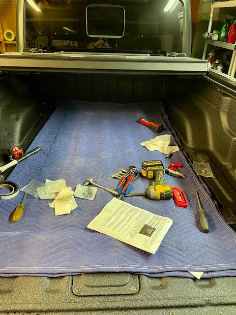

I finally got it back from the body shop today (old comprehensive claim). It was only two weeks without my Jeep, but it felt like forever. I got my new bed cover on tonight. Bakflip MX4. Soon, I’ll be installing my new bumpers, winch, and aux lights. My Jeep got a fresh Line-X while it was away too. It got damaged in the claim and old Line-X was looking rough from all the loads of rock I’ve hauled in it. I’m glad they redid all of it. I recruited a helper to install my new bed cover. The girlfriend helped me out. It’s easier with two people and she helped with those tedious back bolts.

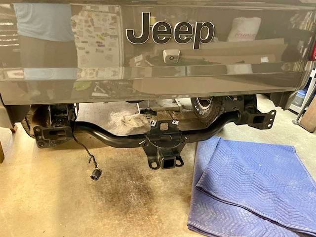

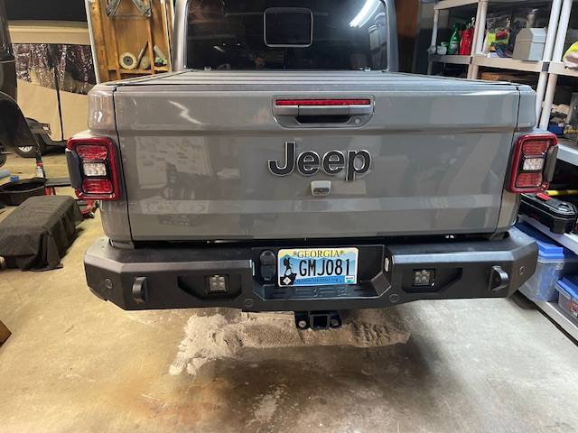

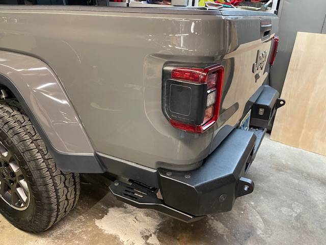

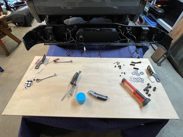

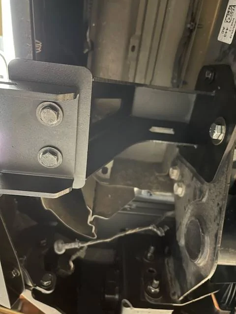

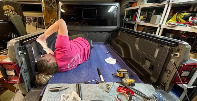

New rear bumper and bed steps/bed sliders. Everything is super beefy. I feel bad for anyone who hits my bumper next time. It would be a much easier job if I didn’t have rear parking sensors. My overland plastic bumper was a pain to disable the parking sensors and wiring harness. My adjustable height saw horses were clutch for assembly and installation. I also took the time to clean everything up good. The last pic is the embed step/sliders bracket. It’s super solid and also bolts into the rear bumper and has another brackets to reinforce where it attaches.
It’s the body armor brand. I wasn’t familiar, but it’s good quality and looks nice. Next up is installing my new front bumper and winch and install my new aux lights.

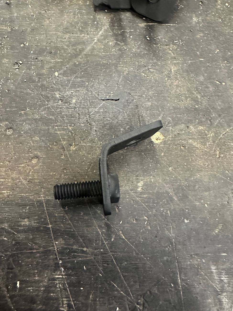

DIY Rock Lights:
installed 4 Harbor Freight flood 3 inch cube lights under each side of the jeep pointing forward and backwards for better visibility to the sides driving at night, especially in spicy terrain. I’ve used this same method on my Jeeps for over a decade, and they have survived the Rubicon, multiple weeks spent in Moab each year, gravel roads and everything else I have thrown at them, and I’ve never had to replace a light. For less than $20 per light, this is a low budget alternative that puts out great light.

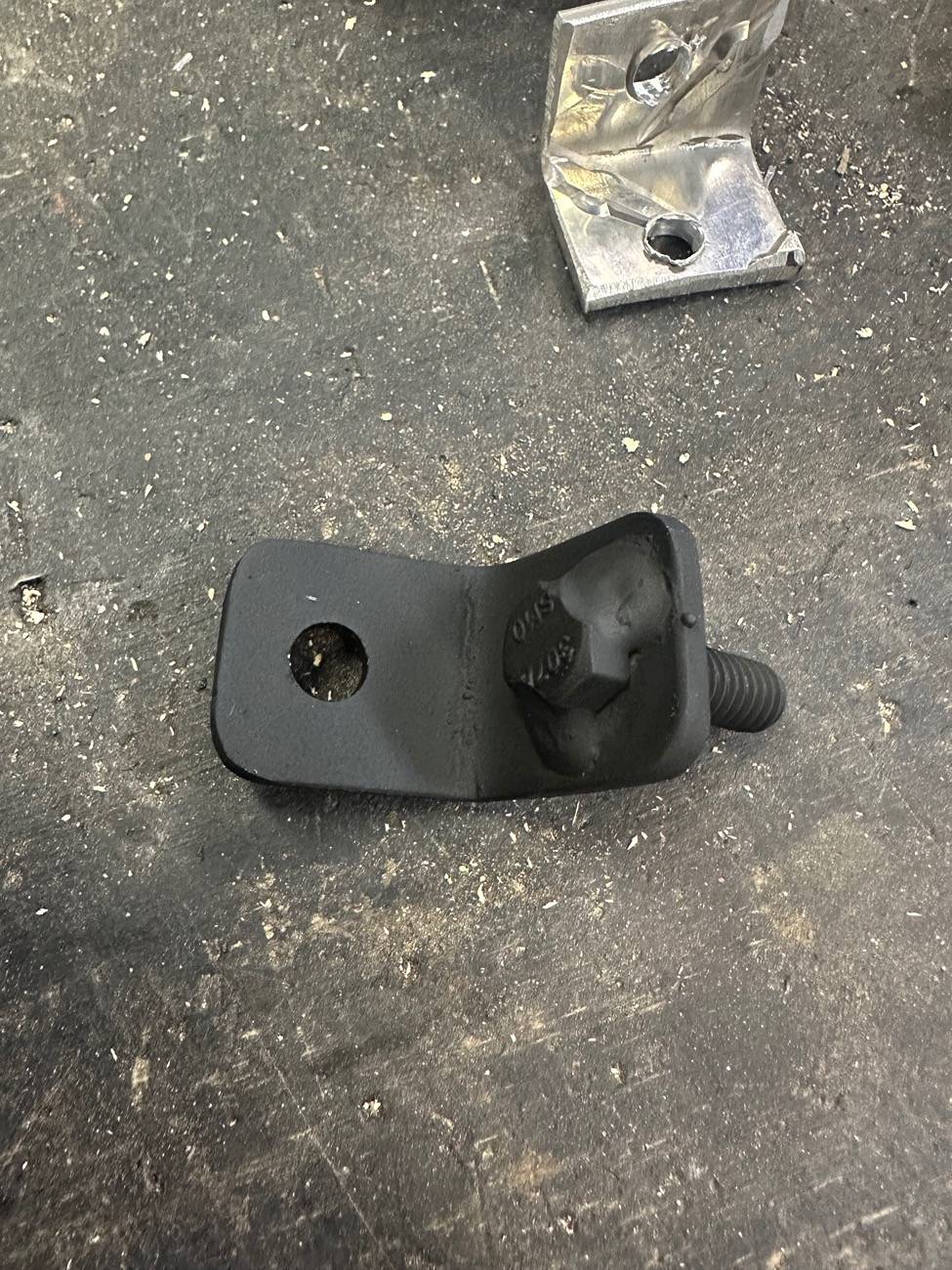

First up was to find a suitable location that didn’t require drilling the frame. The center body mount has a gusset on the front and the rear that has a hole, so I started playing with mounting ideas. I came up with this little bracket. The aluminum bracket was my concept test bracket.

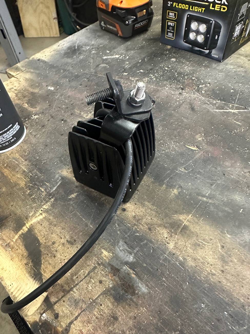

Next, I attached a 3 inch flood cube light to the bracket and played with mounting positions to the center body mount gussets. This is what the light looks like mounted to the first bracket to face forward.

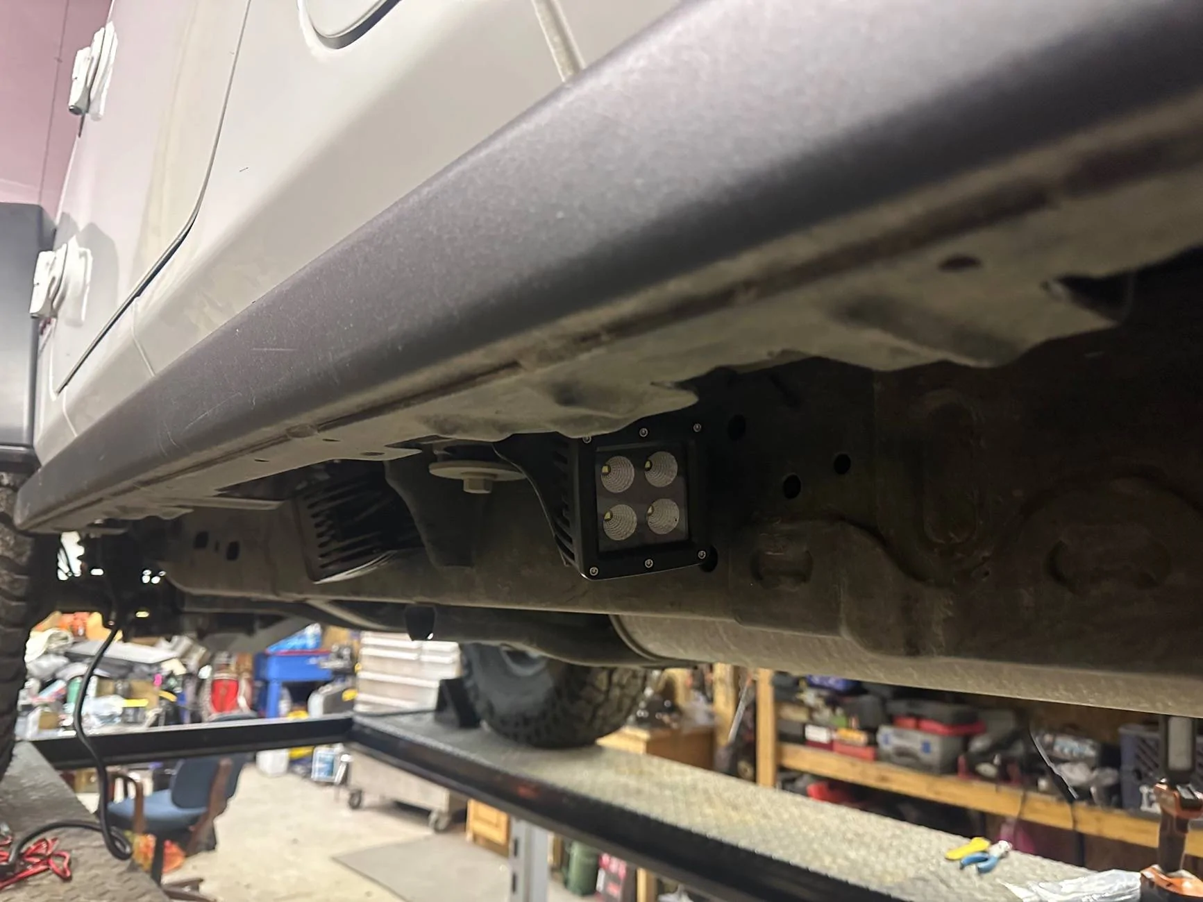

Here is picture of both lights mounted, and I built a little wiring harness that routed each side to the aux switch wires.

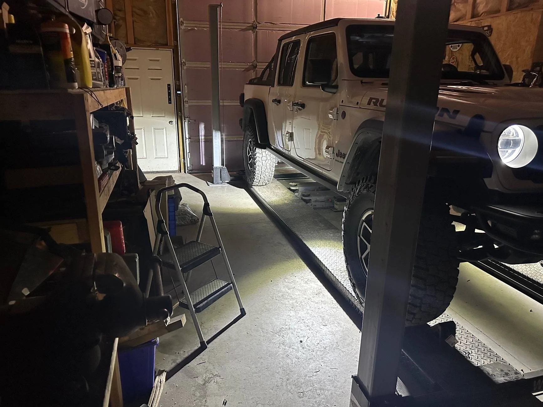

Finally, a picture in the shop of the new rock lights. I pulled outside after dark and activated my rock lights, 20 inch light bar in the bumper, cube lights in the bumper and headlights, and my wife commented that it was daylight…my objective. Of course, these can‘t be used on the street, but we spend so much time off pavement that this is a worthwhile upgrade…but not for everyone.
Jeep Gladiator What did you do TO your Gladiator today? [ADMIN WARNING: NO POLITICS, NO GUN TALK] IMG_1991
I also live a few miles down a dirt road, and my rock lights are always on driving to/from as this helps me spot the many forest creatures wanting to jump out of the woods and attack my Jeep
Not a huge project, just something I like to add to my jeeps for better visibility to the side that might give others an idea of something they might want to consider. I really didn’t need to weld the bolt to the bracket, I’m just lazy and didn’t want to have to hold the head of the bolt in an awkward position.

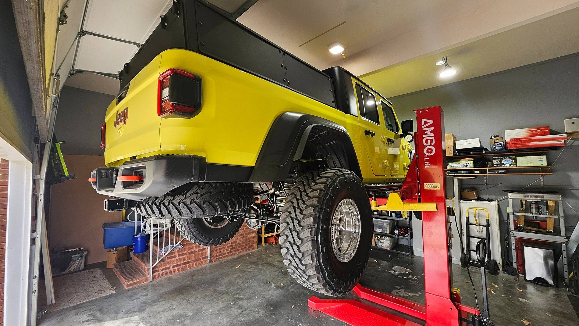

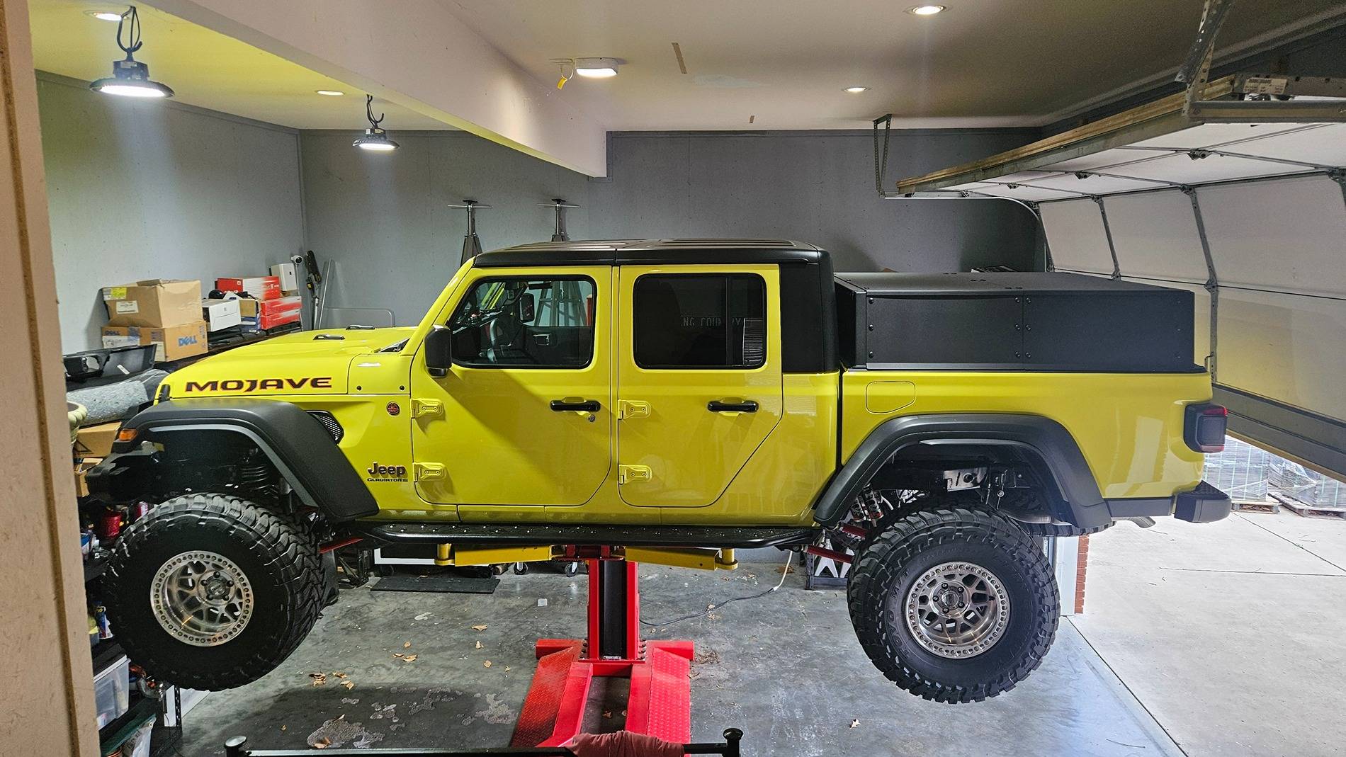

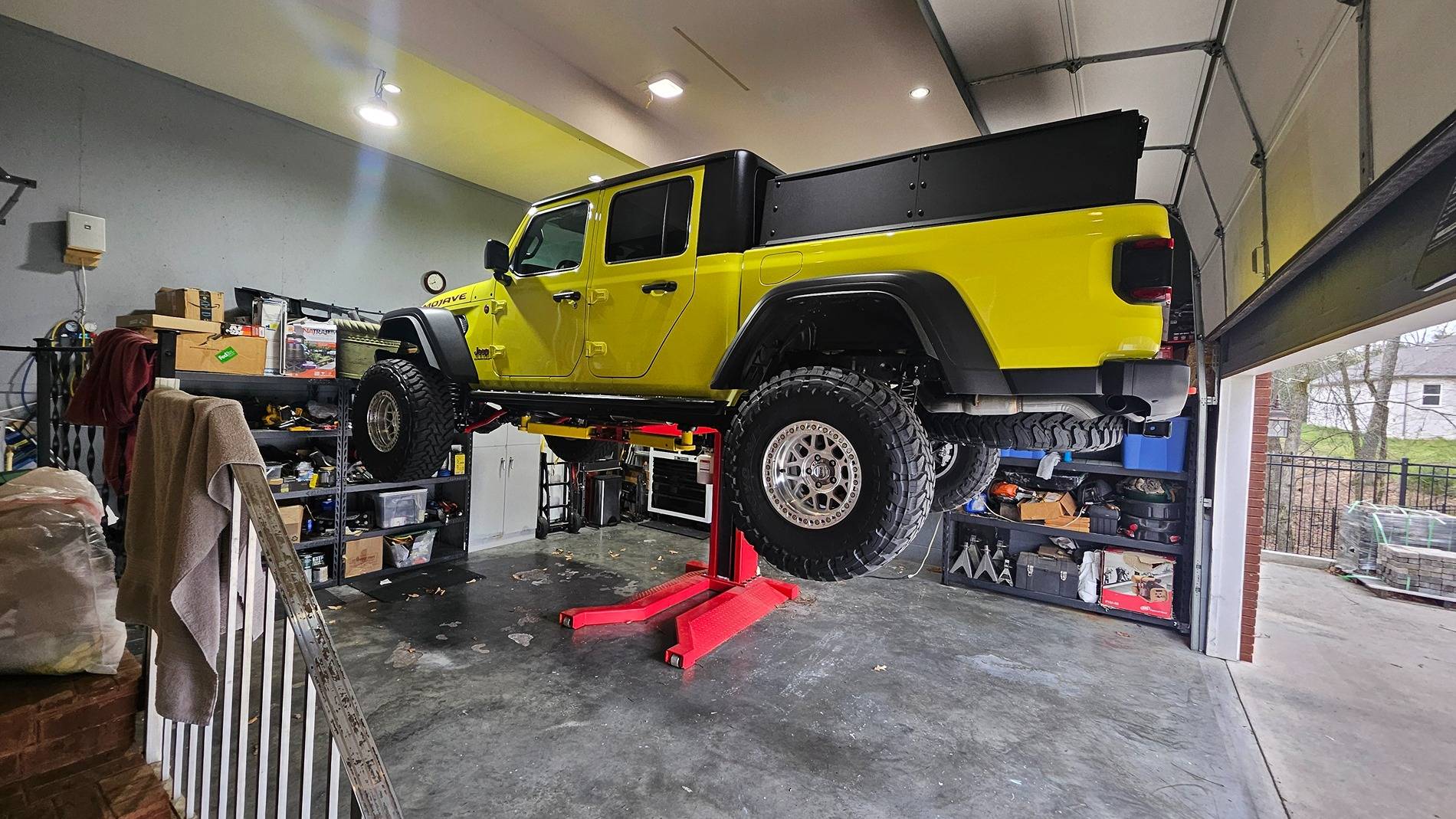

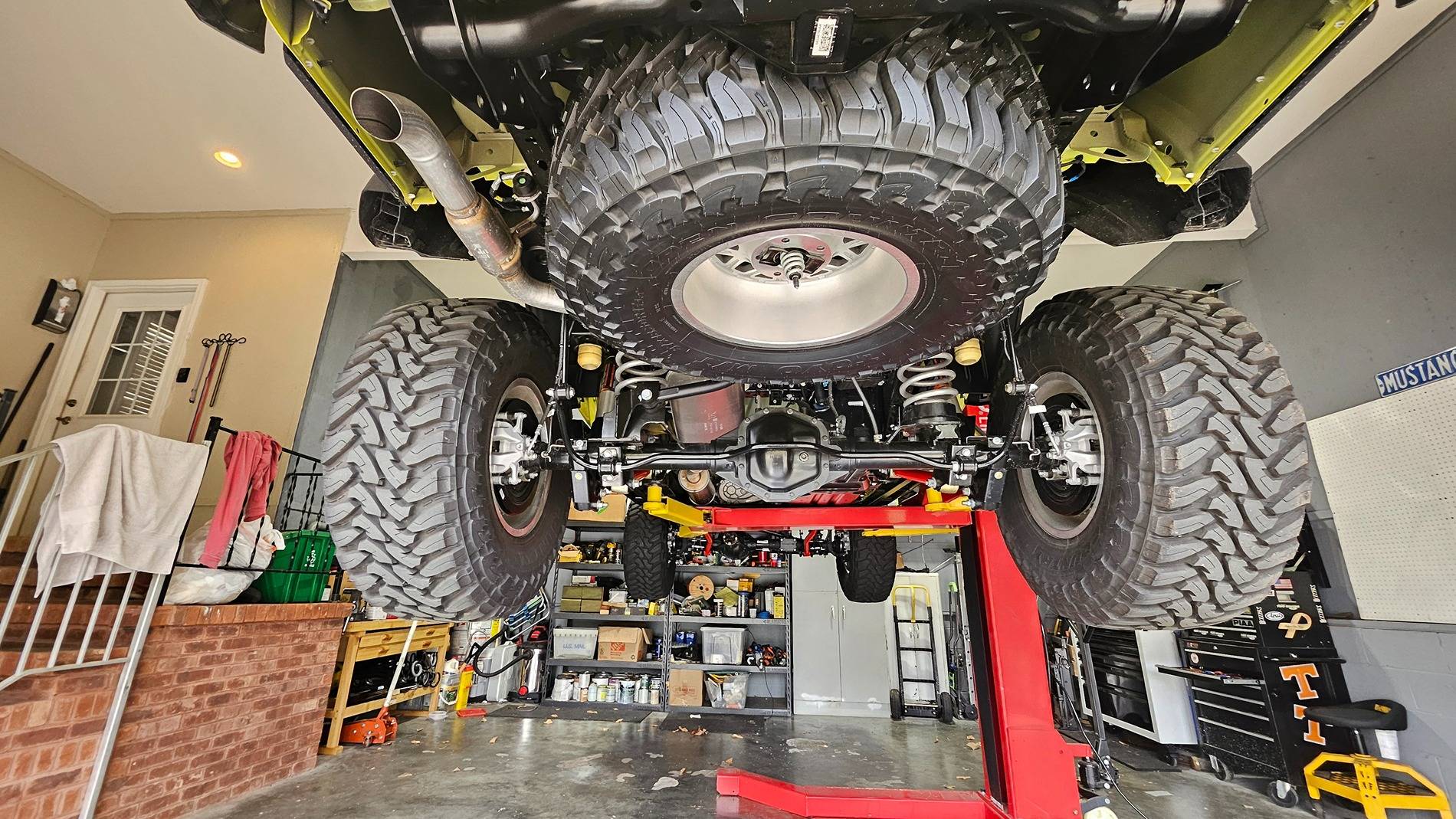

Installed a K&N drop in filter. Tested my 6000 pound single post lift. It held really well, but I will definitely place the two under body stands under the far side when I do any wrenching on it.
Long day already - at first I thought you meant you needed the lift for the filter install.
The Chinese-made lift is rated for 6000 pounds. I was not sure how it would handle the Gladiator. I may have to invest in a couple more under hoist stands. Most lifts are rated at half of what they can lift, but I don't trust this one.
