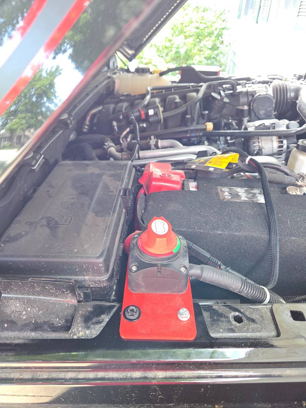

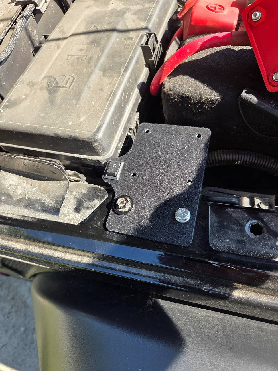

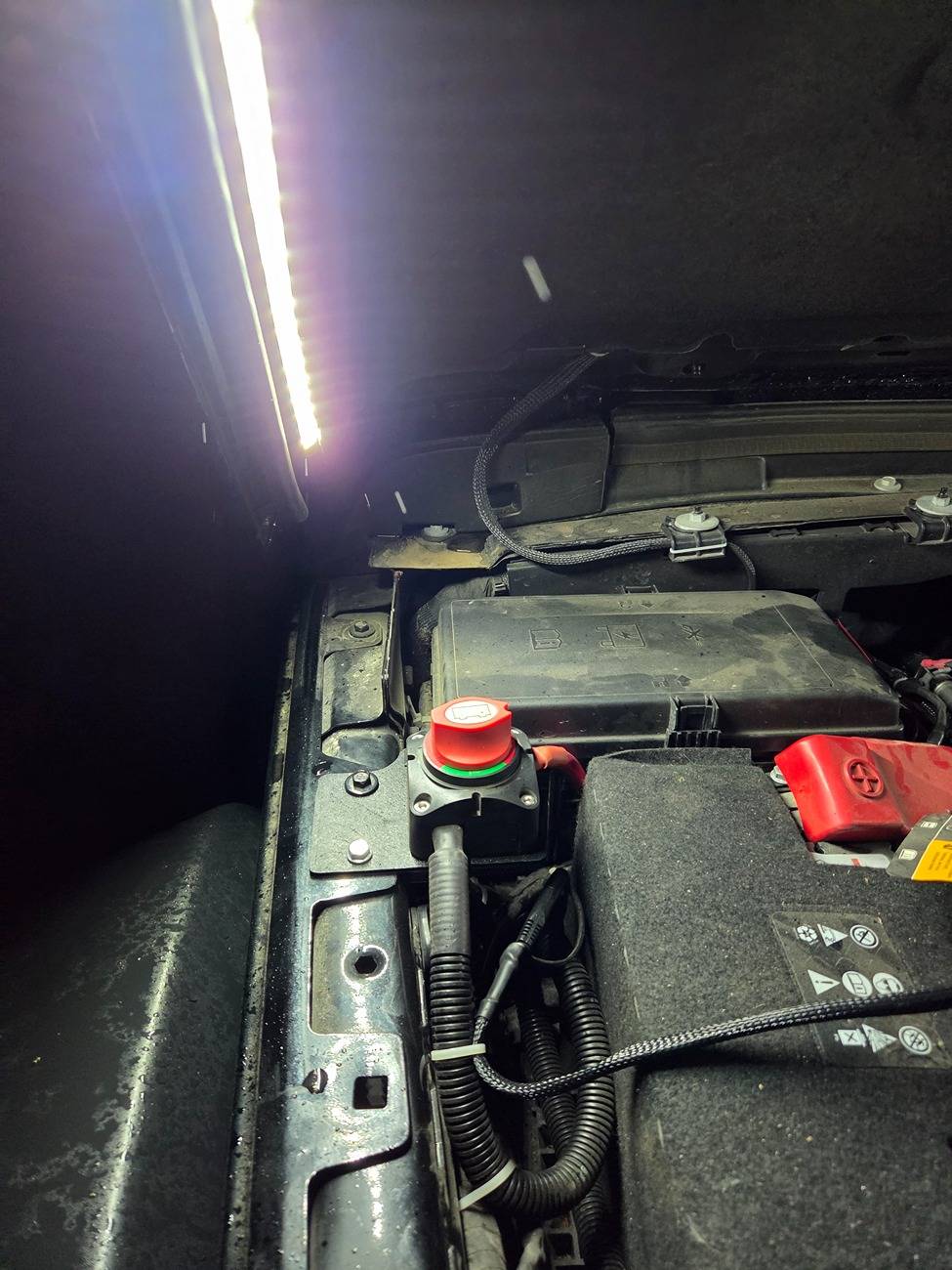

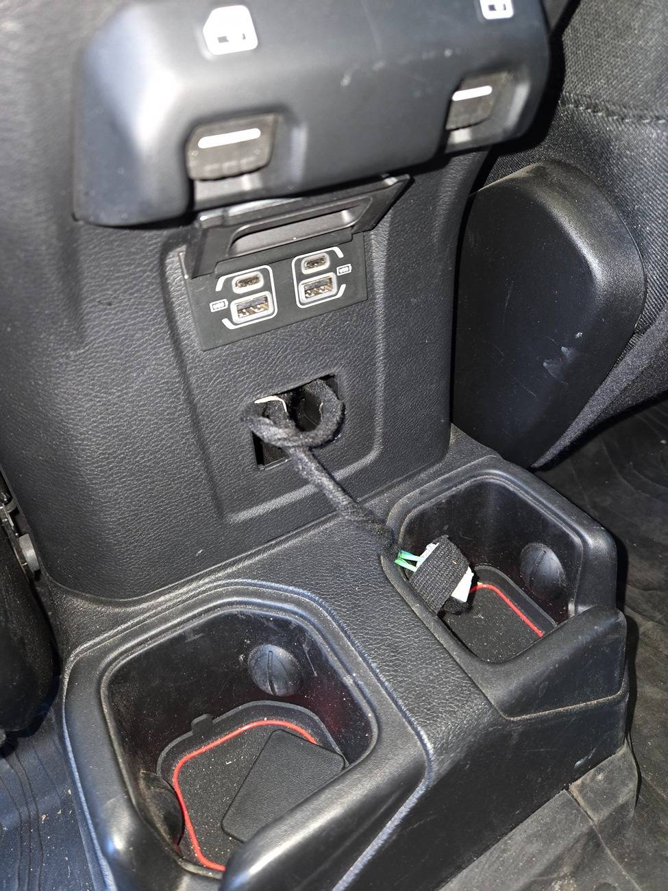

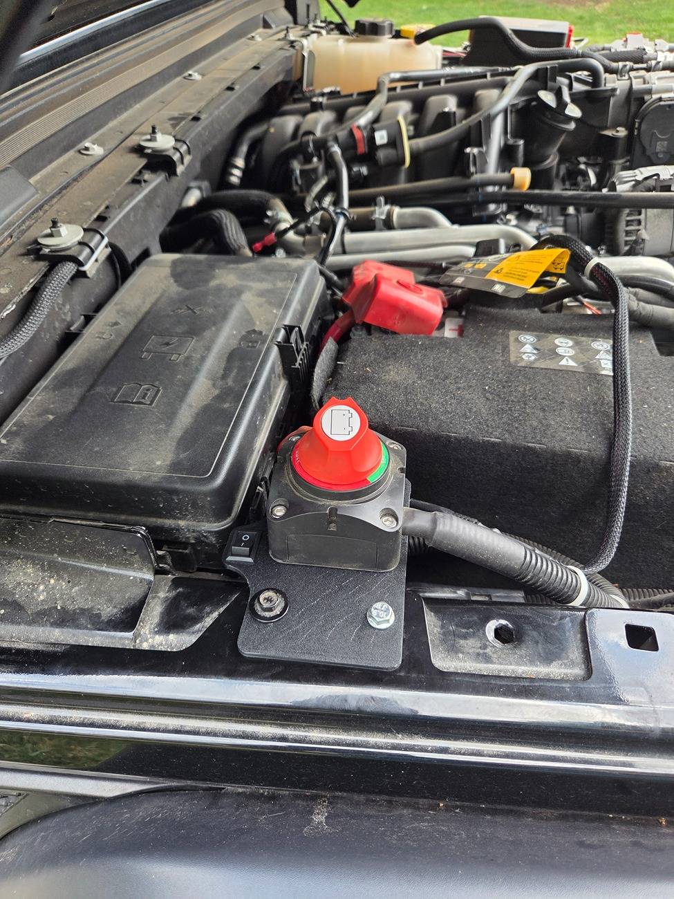

Did a couple mods today/yesterday. Printed an updated version of my winch cutoff mount to add a switch for underhood lights. Would make some for other people if they're interested. Also finished installing my factory inverter (chip shortage deleted mine) and got that programmed with Alfaobd. I couldn't find much information on the inverter delete install so might do a writeup on it.

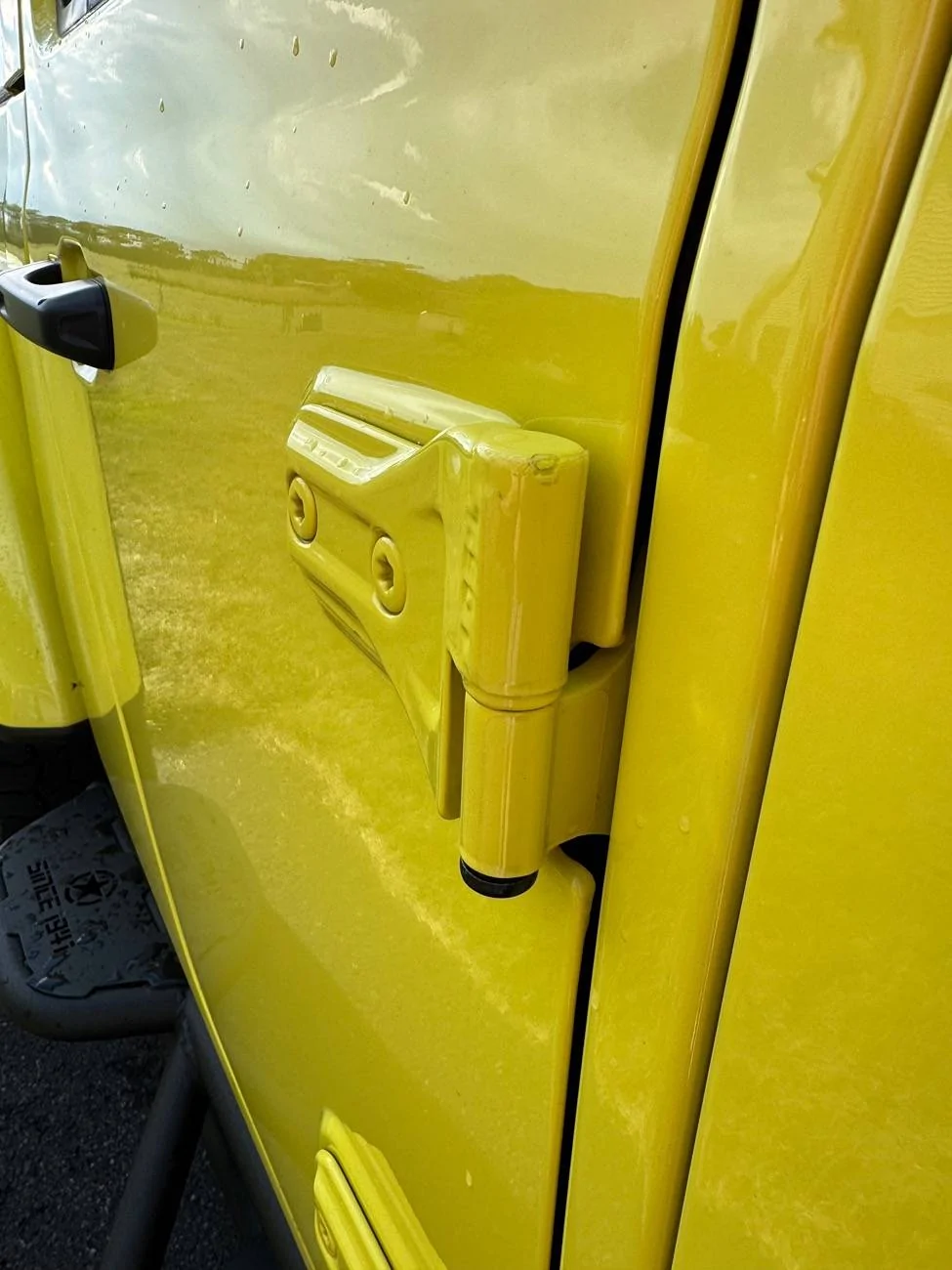

Used touch up paint on a couple chips on my hinges yesterday and installed Rock Stopperz today. I wish I had installed them the day I brought the Jeep home.
Yeah I installed them w/i the first week. I learned of the product from the DRC YouTube channel

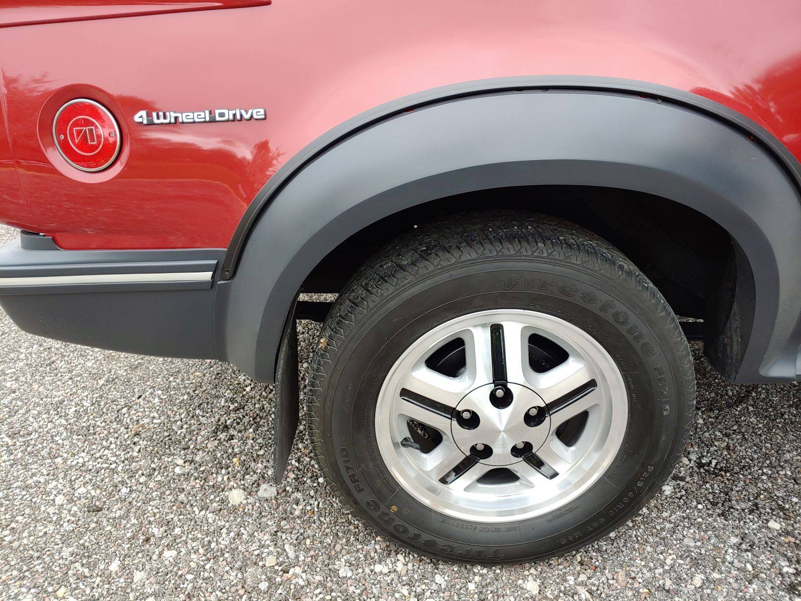

May take a 6th set of eyes. With my car's vibration - a pro axle shop, 2 tire and wheel shops, a dealership, and others failed to find the cause.
Even I failed to find the detailed reason, but I did figure out it was a wheel. But I was looking for lateral runout - a dial indicator on the rim of the wheel barely moved, so the wheel was true in that respect. Similar for the tire - no runout.
What I didn't check for was out of round. A restoration shop I took the wheels to put that one in question on their CNC machine and the guy said he knew the instant he was running the setup there was a problem. EGG shaped. I guess doing whoopdy-doos and smacking down hard into a hole can do that. I wonder if that's the reason the inner end of the axle lost a piece as well.
