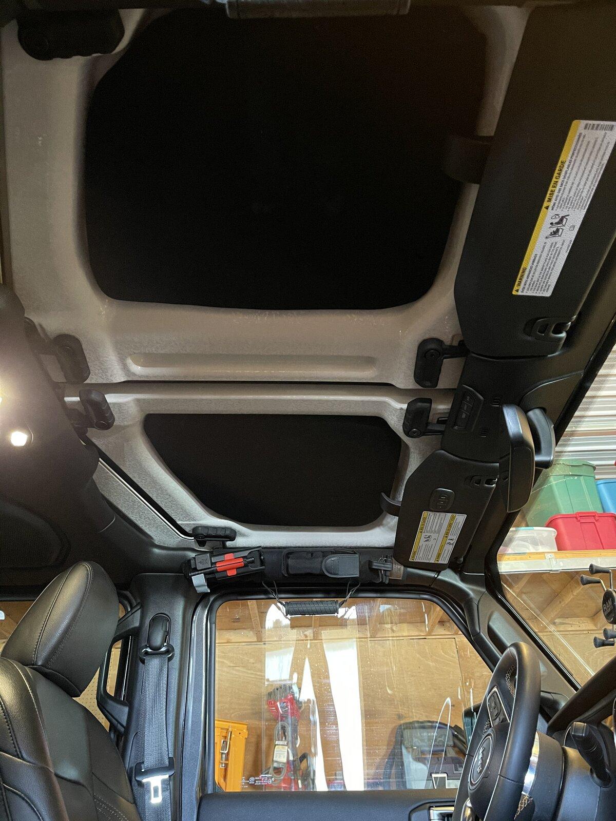

Went ahead and finished installing my homemade headliners in the front. I’ll tackle the rear at another time, but pleased with how they turned out. Hopefully, makes a bit of difference with cabin noise and mild insulation benefits.
