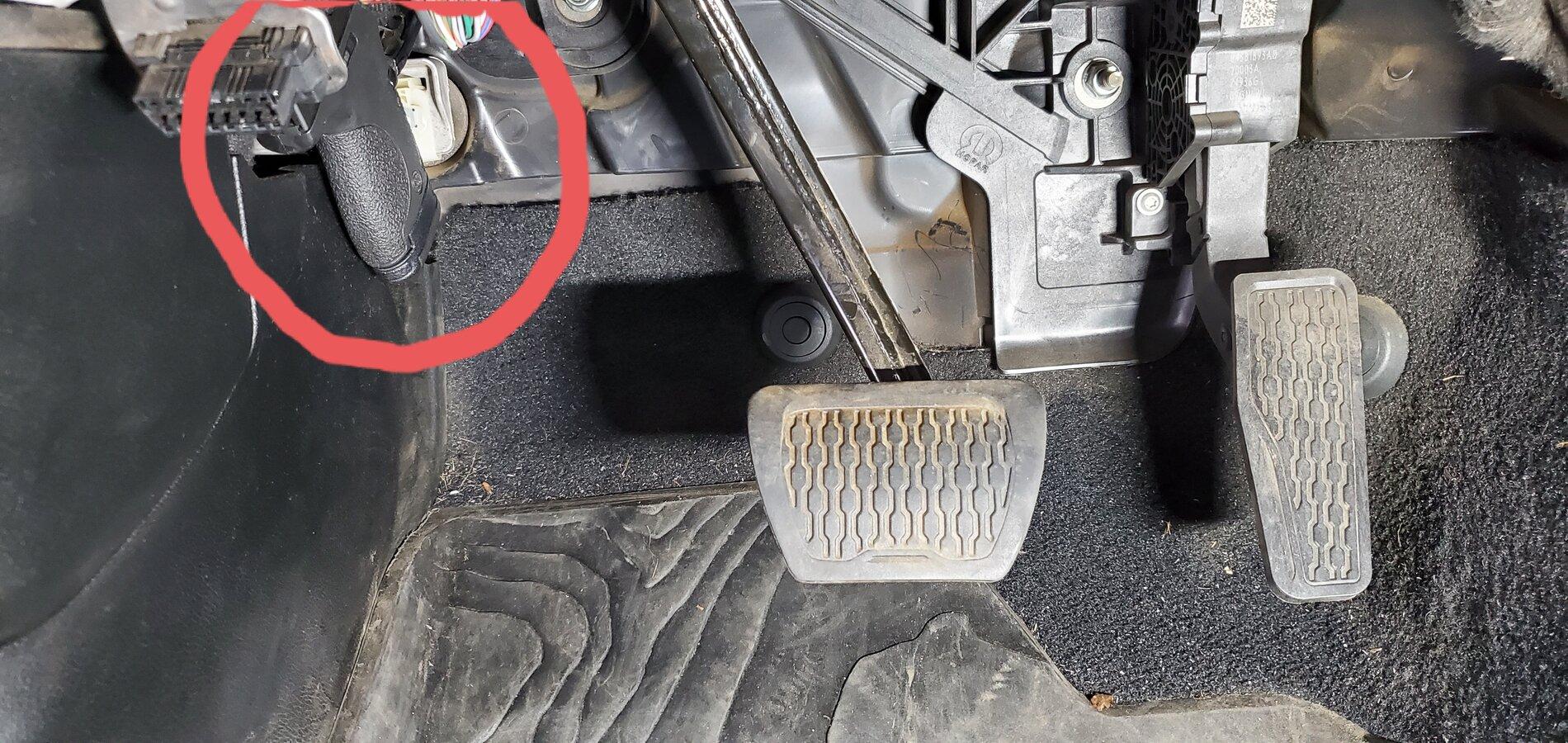

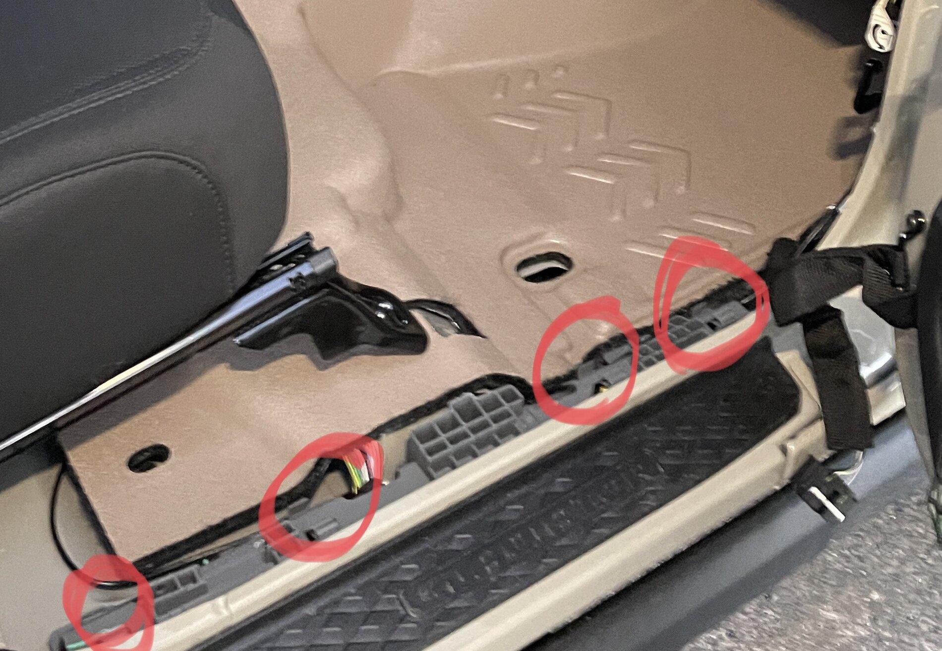

Did you need a trim tool? Im about to do mine
I have one but it’s not need to remove or reinstall the footwell trim. The real issue is where you’re pulling from. It’s more pull in along the floor toward the center. I’ve highlighted the photo below where the clips are locate ( they look like the letter C and hold the trim with a round tab.

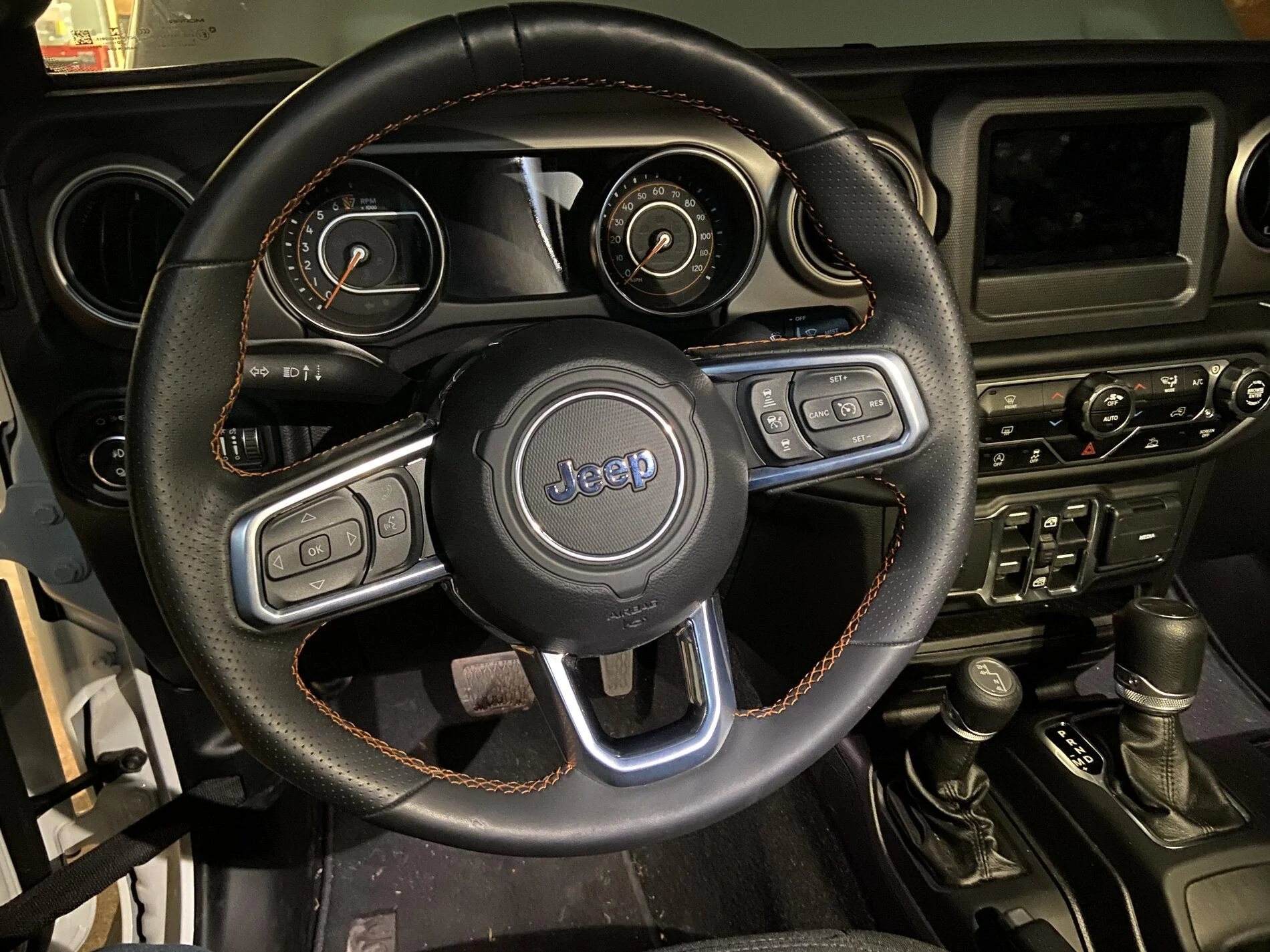

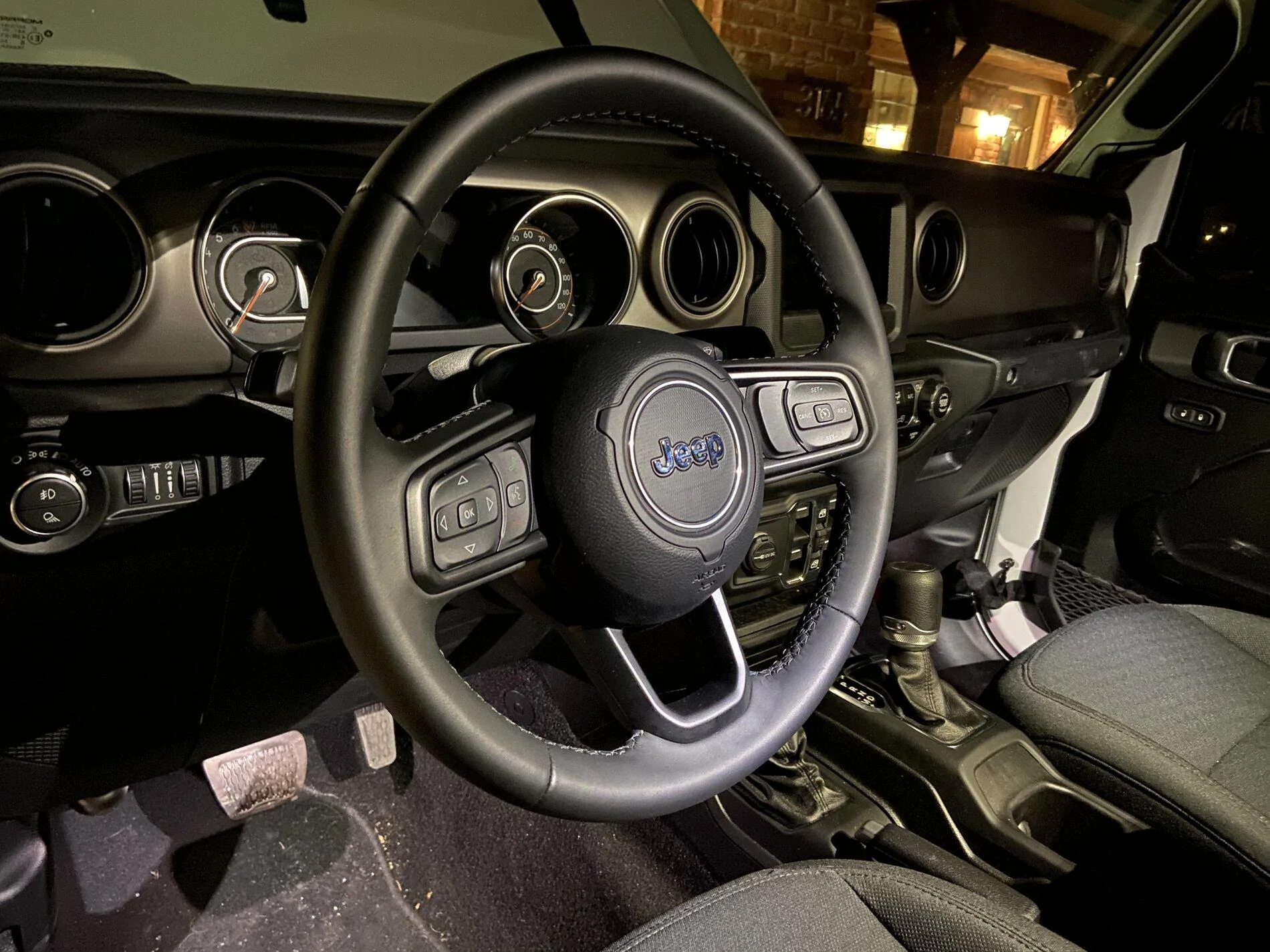

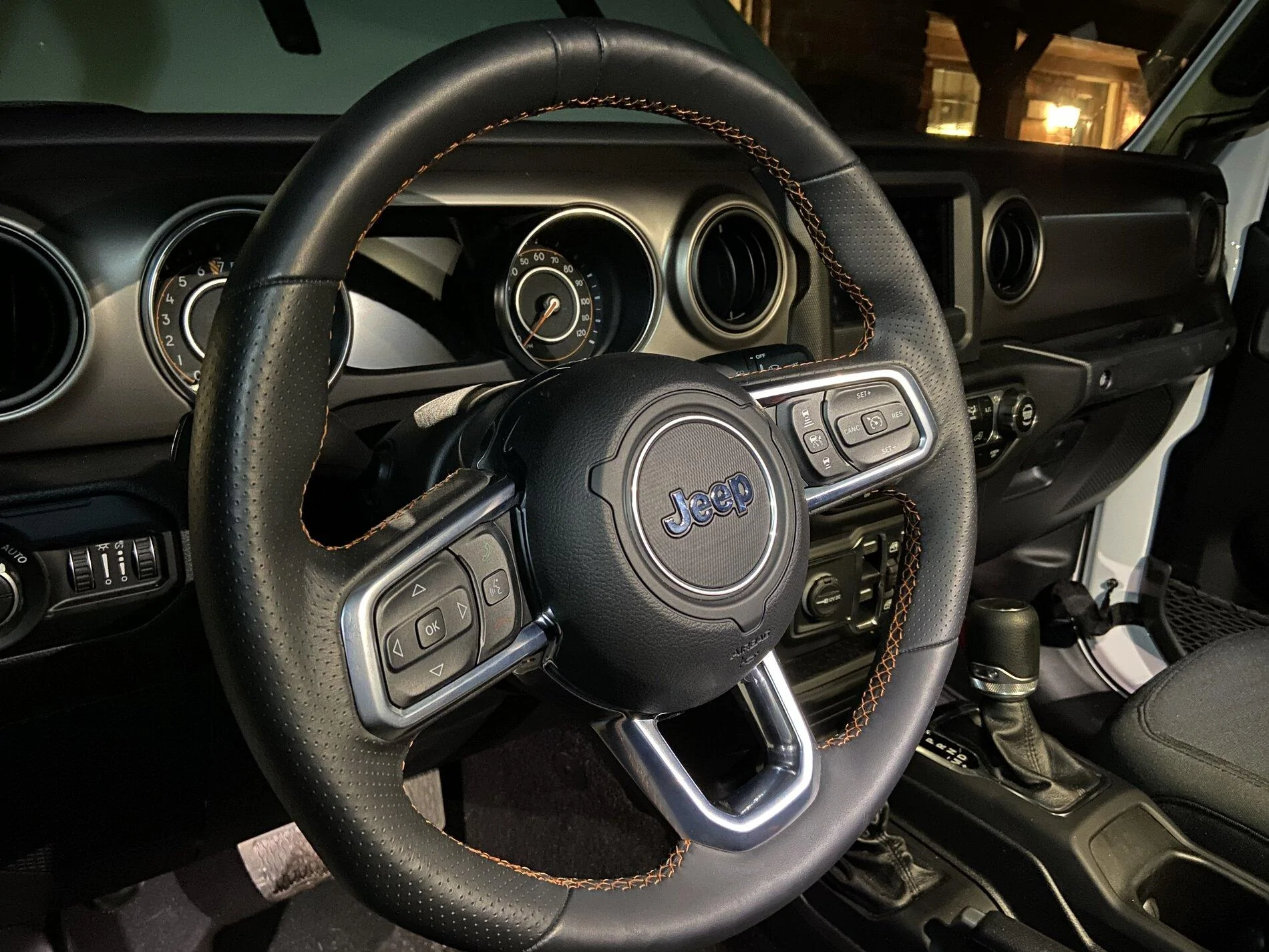

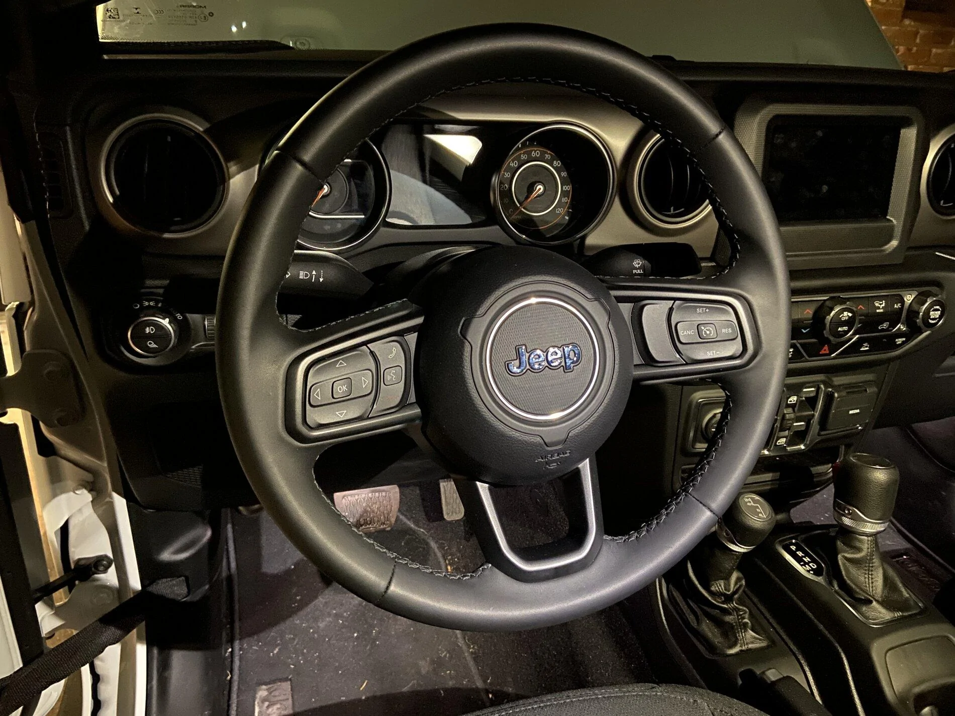

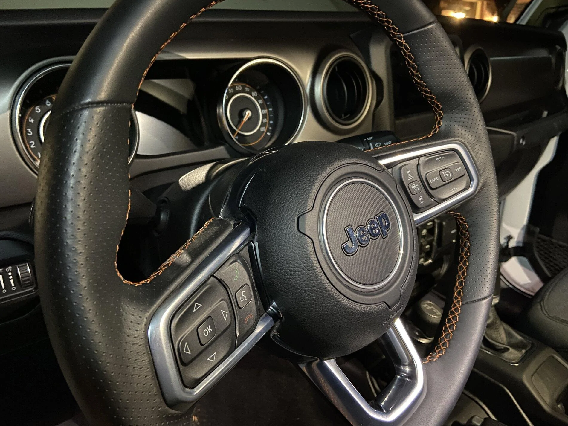

Bought a Mojave steering wheel and installed it tonight in my Sport S. I love the shape of the wheel and the perforated leather. Pretty simple install. I thought it turned out nice.

Got a part number? How hard was this to do?

Oh dang. Didn’t think about getting a part number before I installed. Bought from a salvage yard.
It was easy. Just make sure you disconnect both batteries and wait about 20 mins. Just need to make sure and be safe when dealing with airbag. Took me about 10-15 mins.
