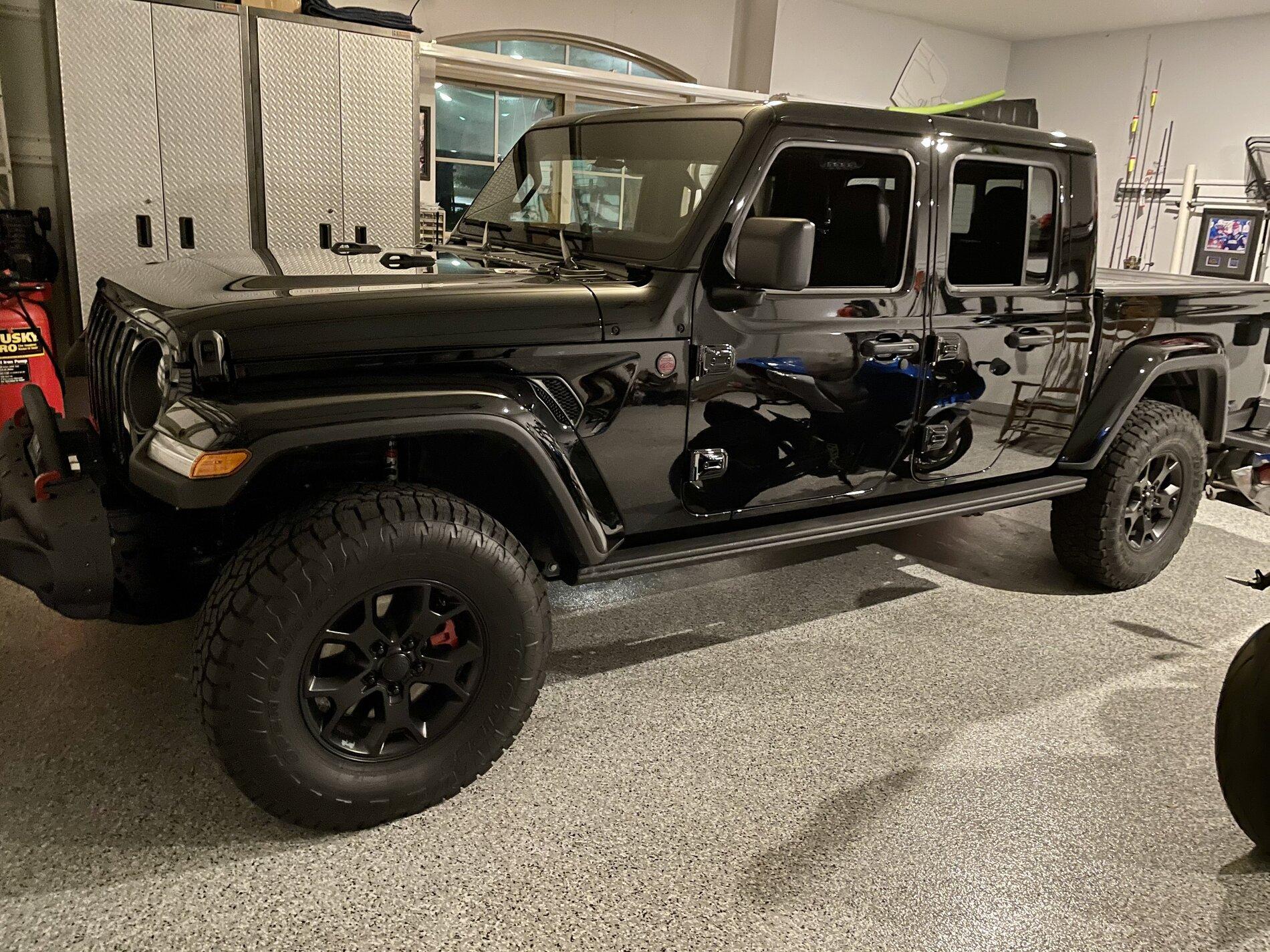

Removed the 1 1/2” Teraflex front spacer and installed their 2 1/2” springs. I added the 1/2” spacer in the front and a 1/2” spacer in the rear. My JKS quick disconnects still work and the kit came with longer rear swaybar links and bumpstops on all corners. I also added Rusty’s shock extensions due to me still running the Rubicon shocks.
It gave me another 1 1/2” lift compared to just the front spacer. I’m waiting for the longer Mopar front lower control arms to add some caster but I really didn’t notice any difference in how it drives other than it seems smoother than before.
I also think the 34’s look good on this. I now have a 1/2” rake which is perfect

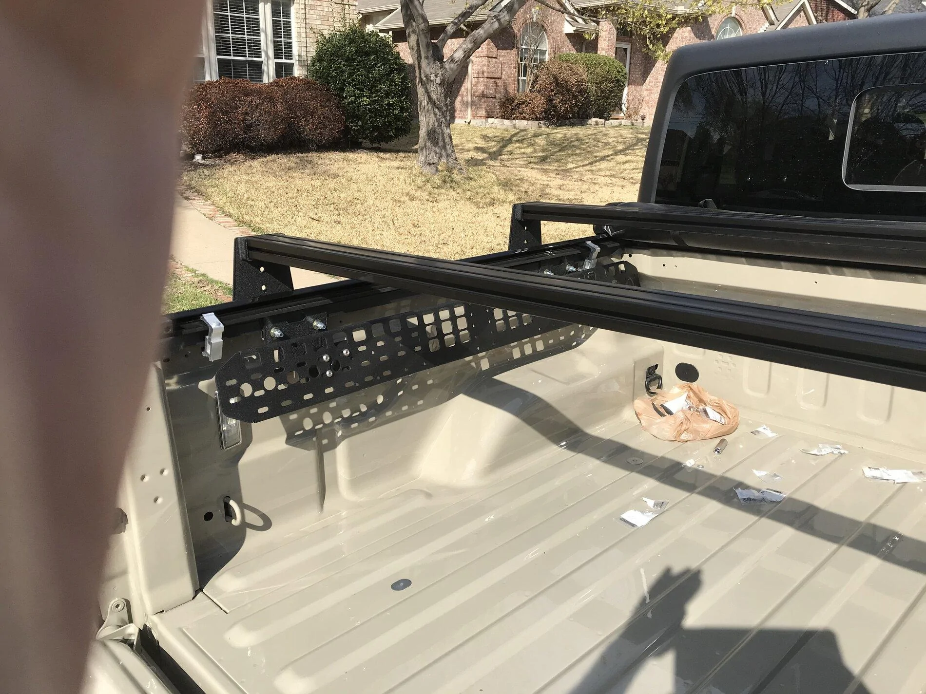

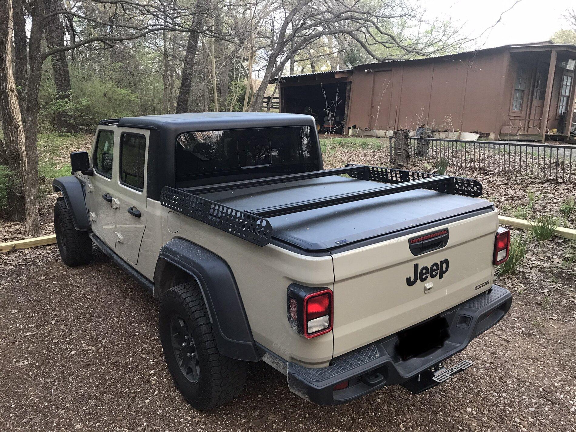

Got the @BillieBars on a few days ago. Definitely a high-quality product. The molle panels stick out further than I expected so I may still relocate them. Or perhaps remove the angle brackets that stand them off from the crossbars (though that would require drilling into them). But they’re not that bad when they’re not loaded down. And they provide a bit of tamper resistance to the soft tonneau cover - especially once the basket goes on.
*DISCLAIMER* This isn’t a knock on the product so much as a matter of personal preference.
The tonneau cover I picked (mostly because it was cheap) has a bit of an upward bow and it sits above the bed rails so there’s not a lot of clearance under the bars, but it does open / close completely if you do it methodically. Practice helps.
I’ve got a @JcrOffroad basket on order for the top of the bars, but it may not arrive for a while.

Got the @BillieBars on a few days ago. Definitely a high-quality product. The molle panels stick out further than I expected so I may still relocate them. Or perhaps remove the angle brackets that stand them off from the crossbars (though that would require drilling into them). But they’re not that bad when they’re not loaded down. And they provide a bit of tamper resistance to the soft tonneau.
The tonneau cover has a bit of an upward bow and it sits above the bed rails so there’s not a lot of clearance under the bars, but it does fit if you do it methodically. Practice helps.
This is what relocating to the inside looks like. And there’s nothing stopping me from moving them back and forth as needed. Keeping them secure under the cover when I’m not needing them and then spending about 15 minutes to move them back to the outside when I’m headed out.

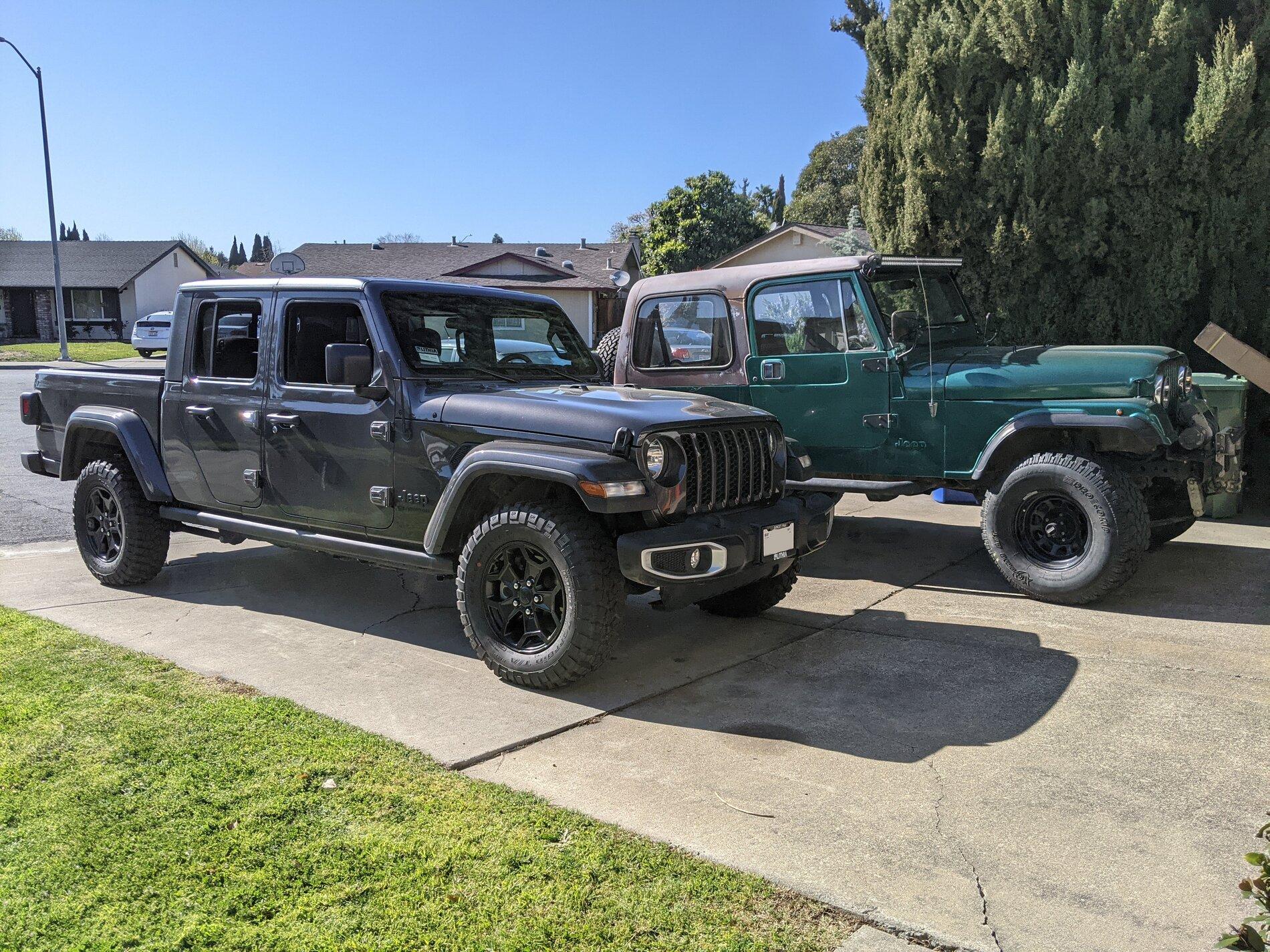

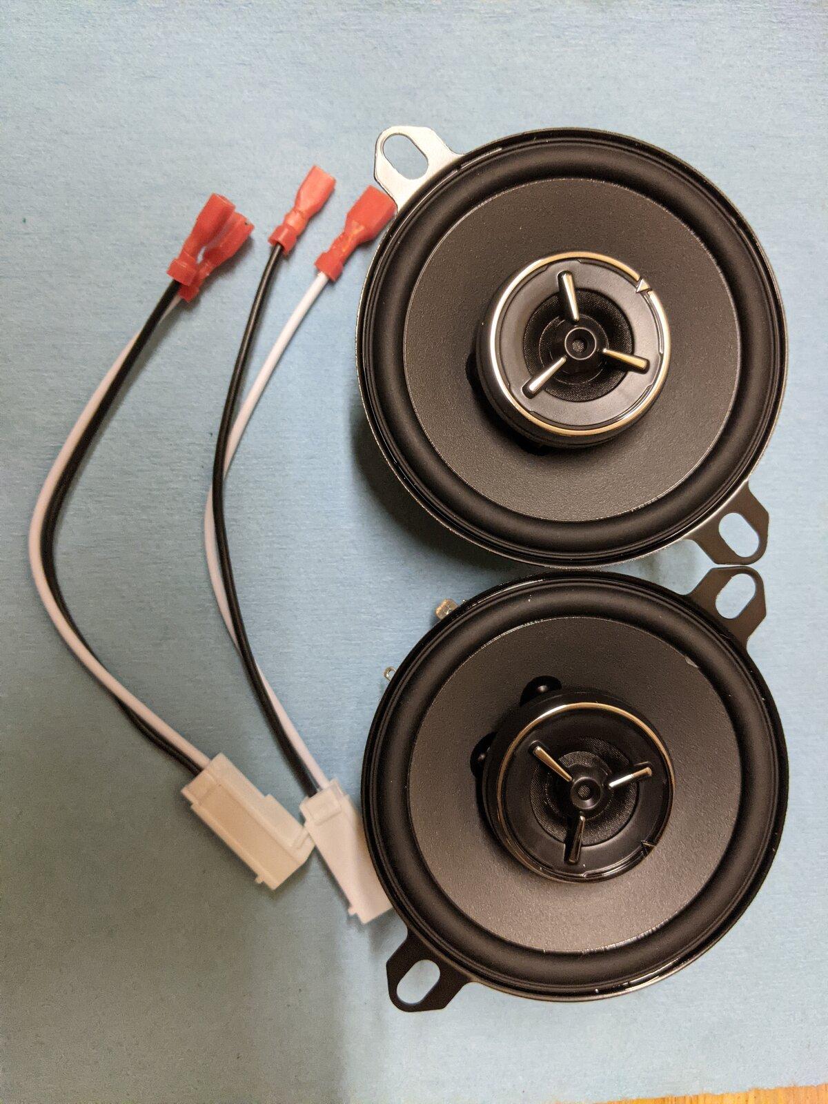

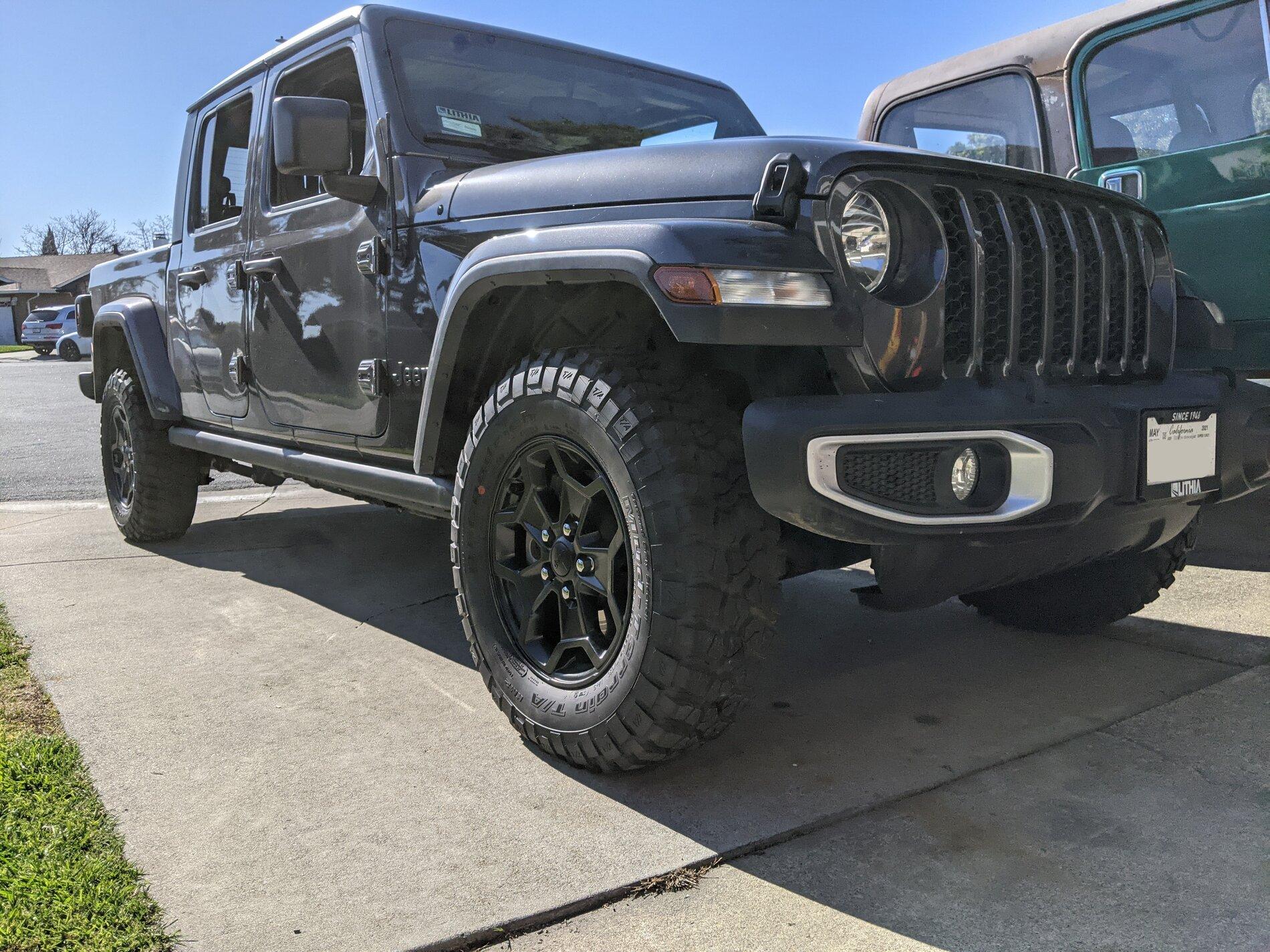

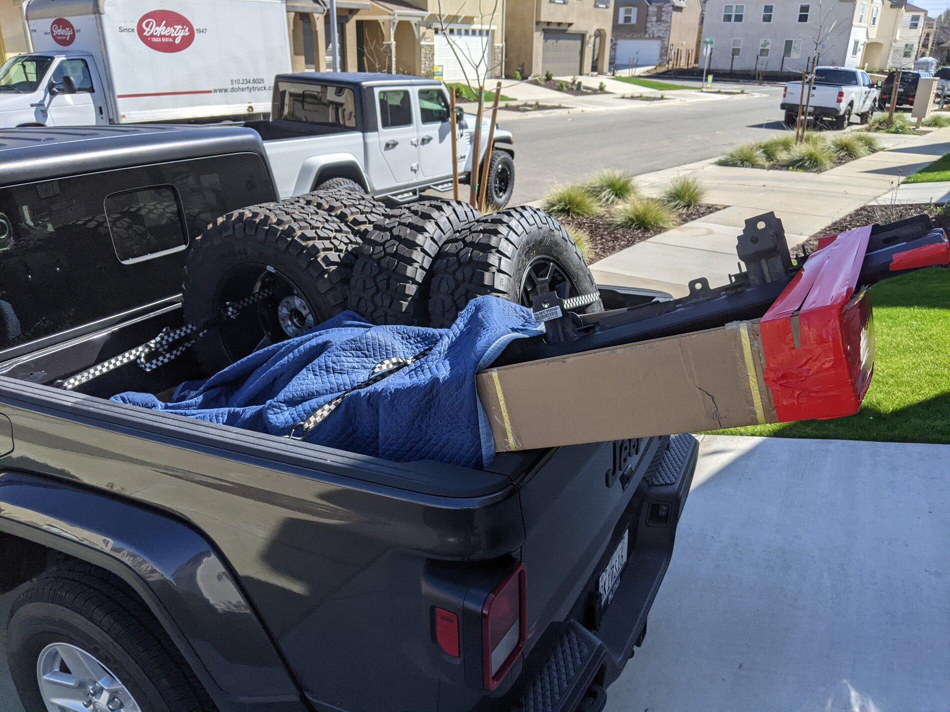

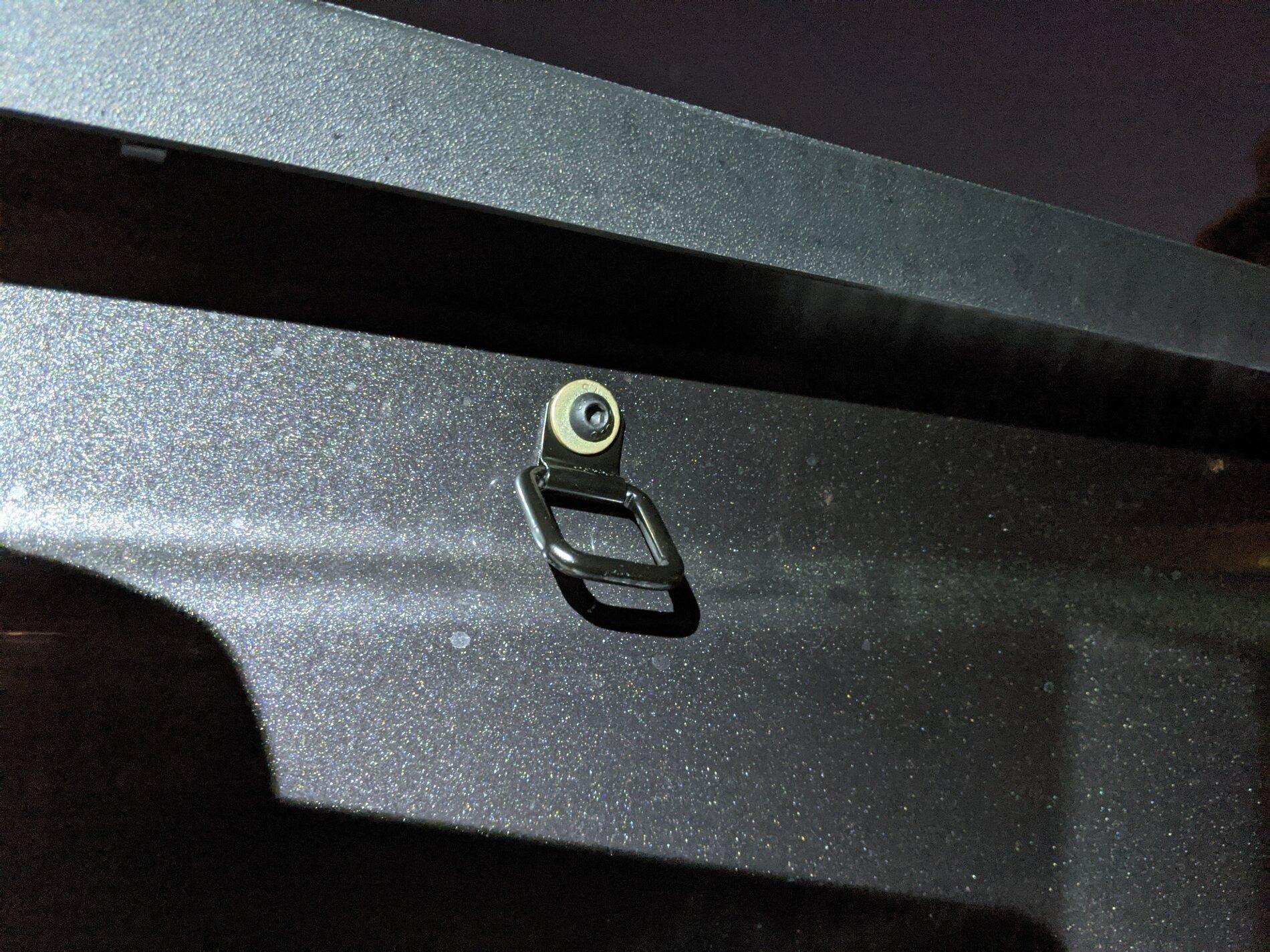

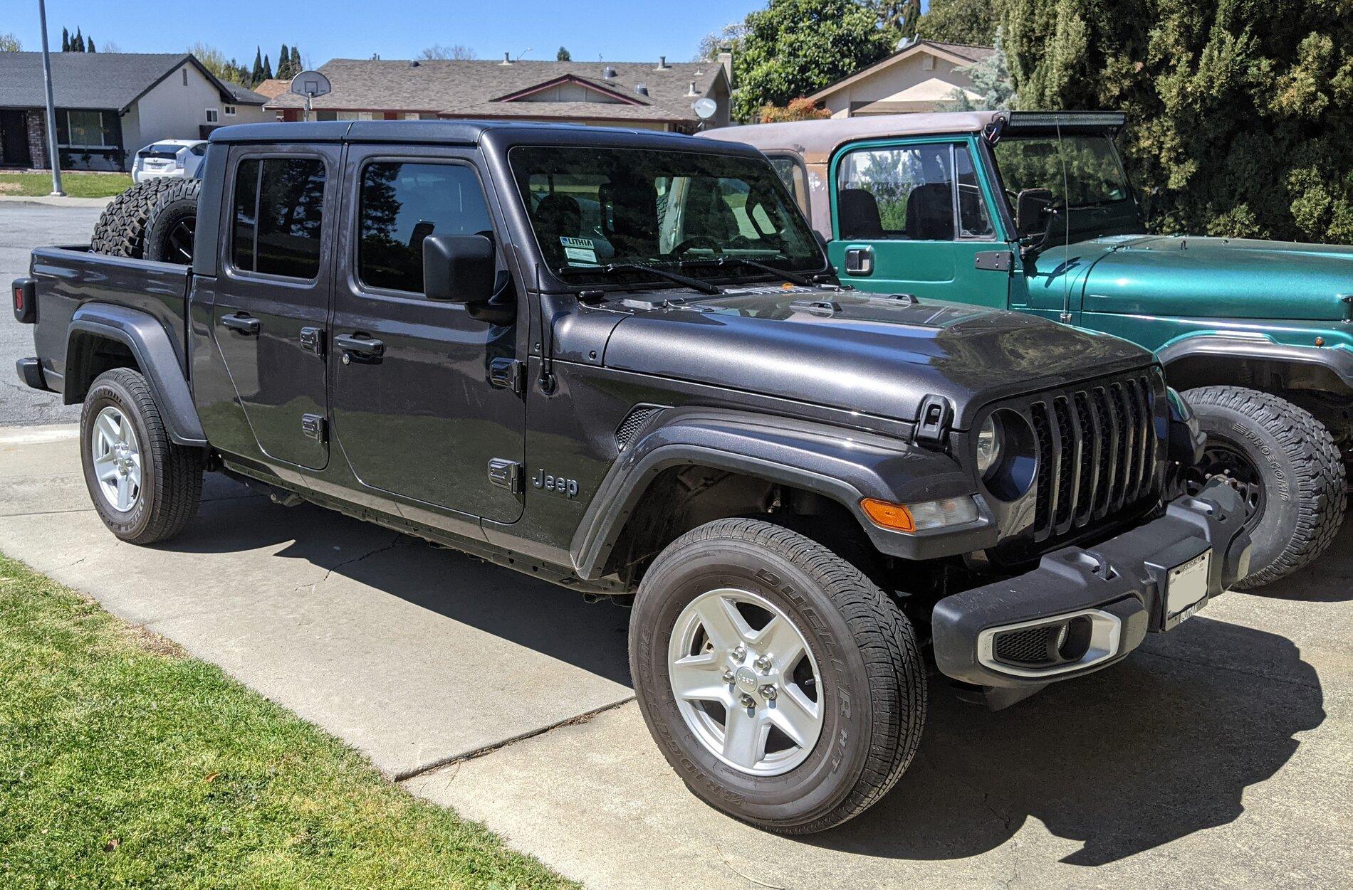

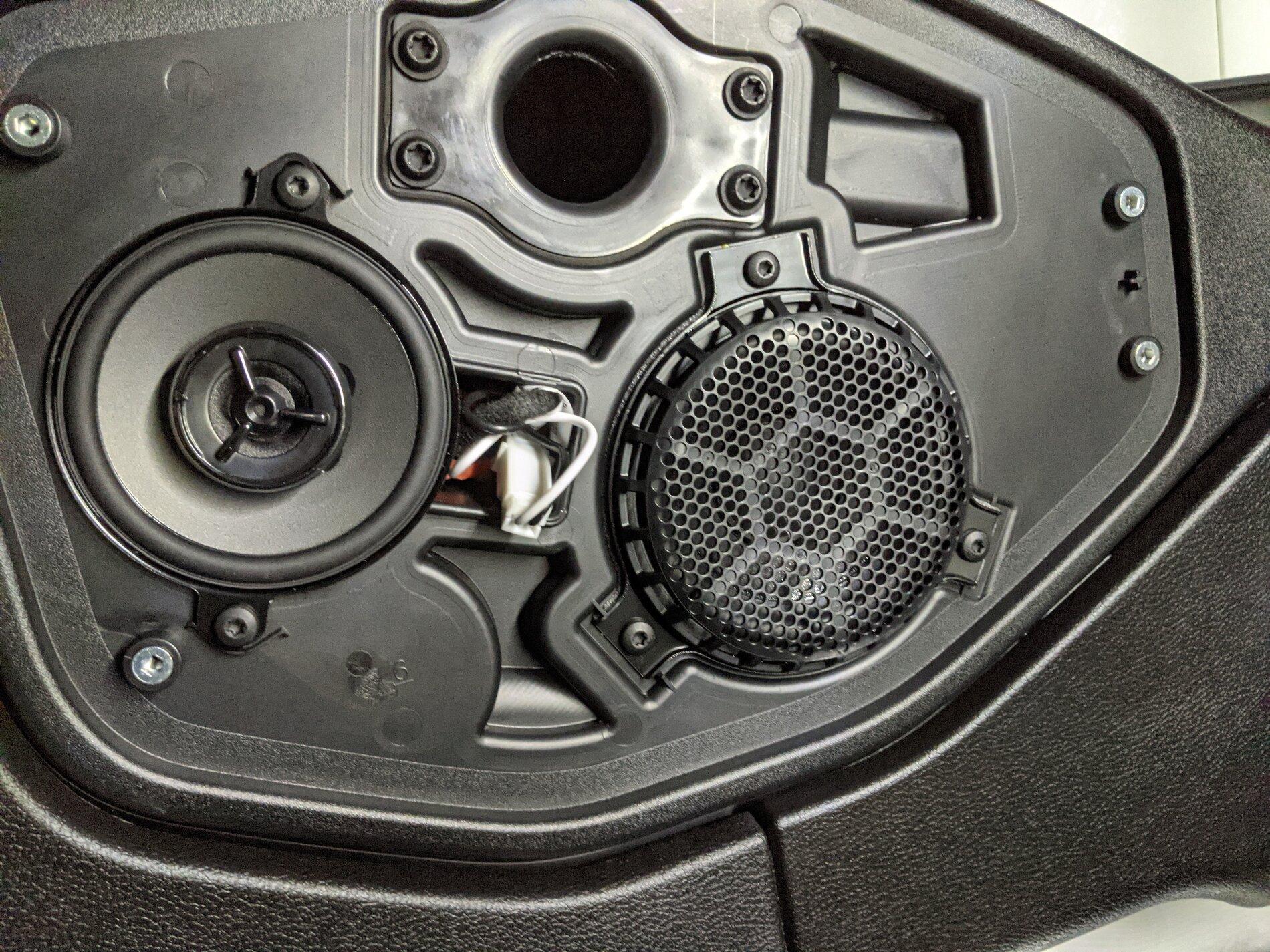

Technically not all today. But got a Sport S a few weeks ago, and today I picked up Willys wheels/tires and rock sliders today. Last night installed the hooks so I could strap down the tires. Last week I installed Kenwood eXcelon KFC-X3C 3.5".
Settle but much better than the stock Sport S wheels.

That bed full of goodies looks like Santa's sleigh ?

how was the sound improvement? I have the premium speakers but noticed that they were a little hard to hear the other day while riding with the doors off.

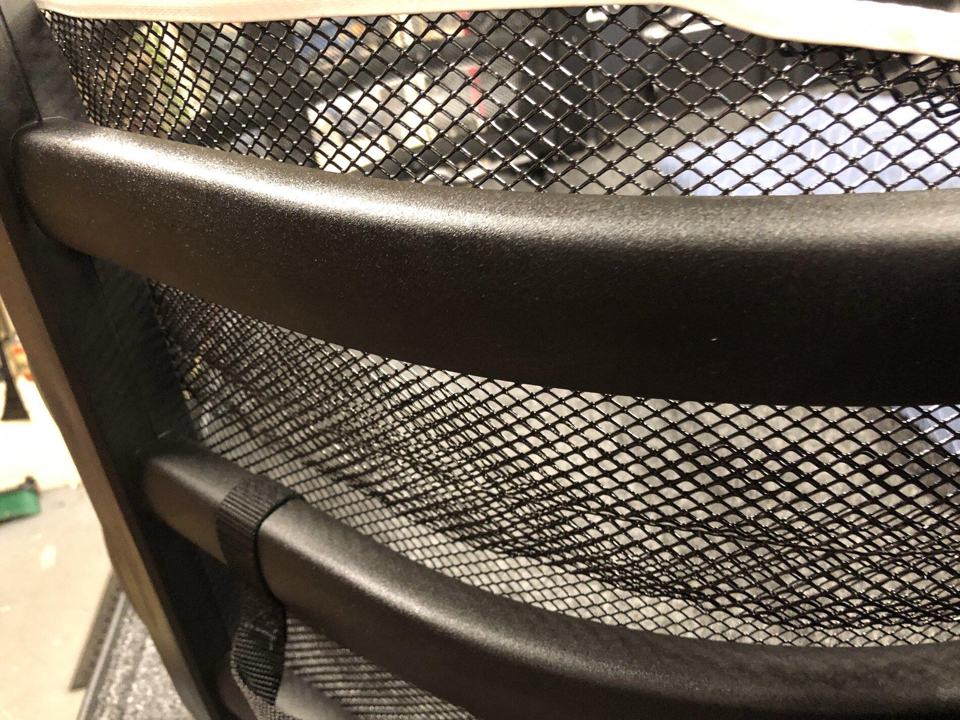

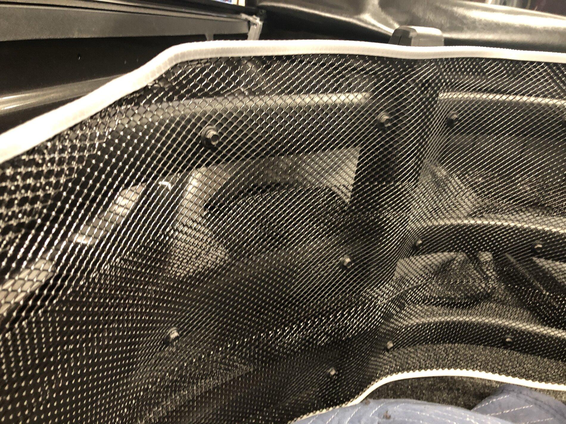

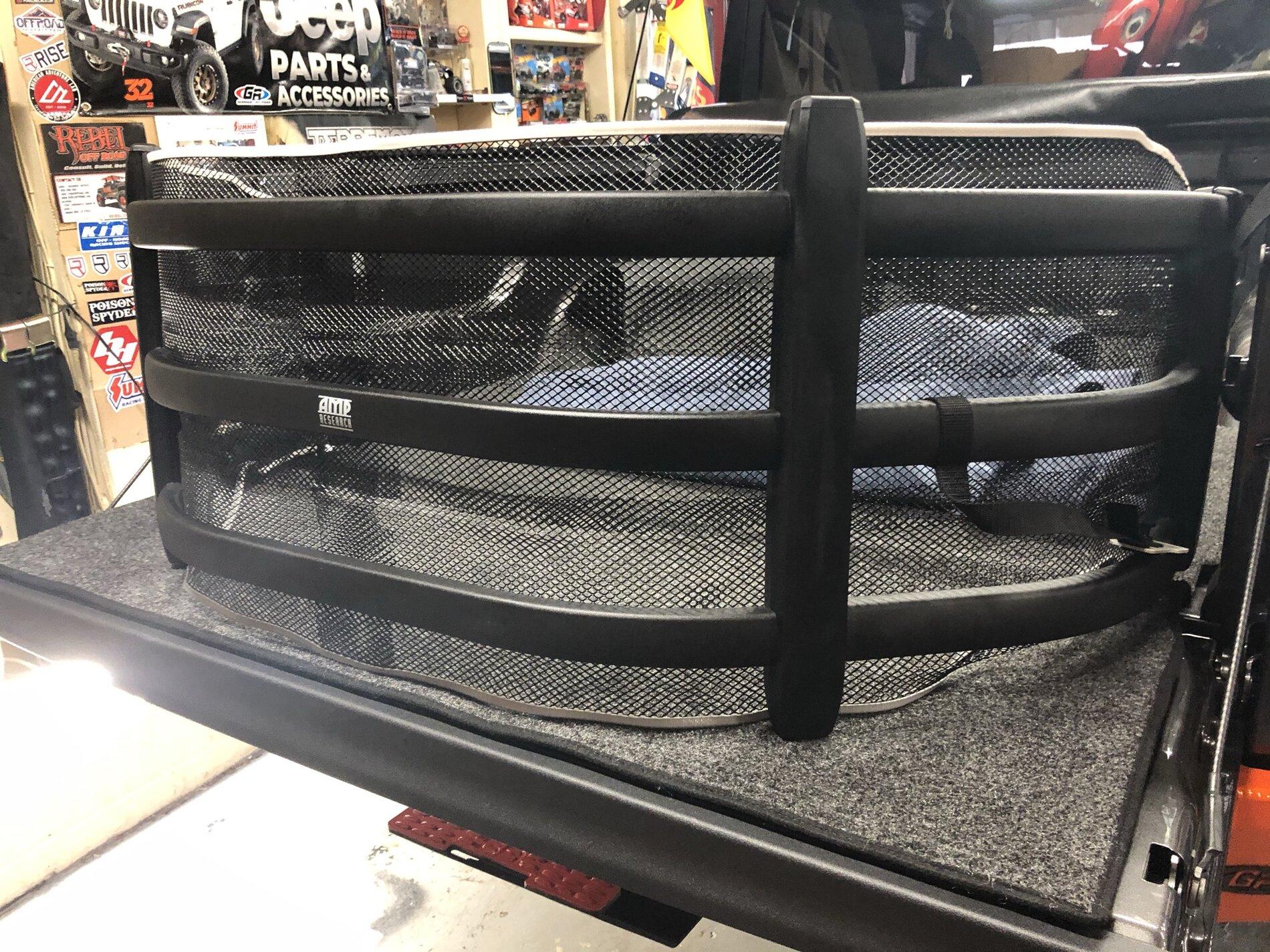

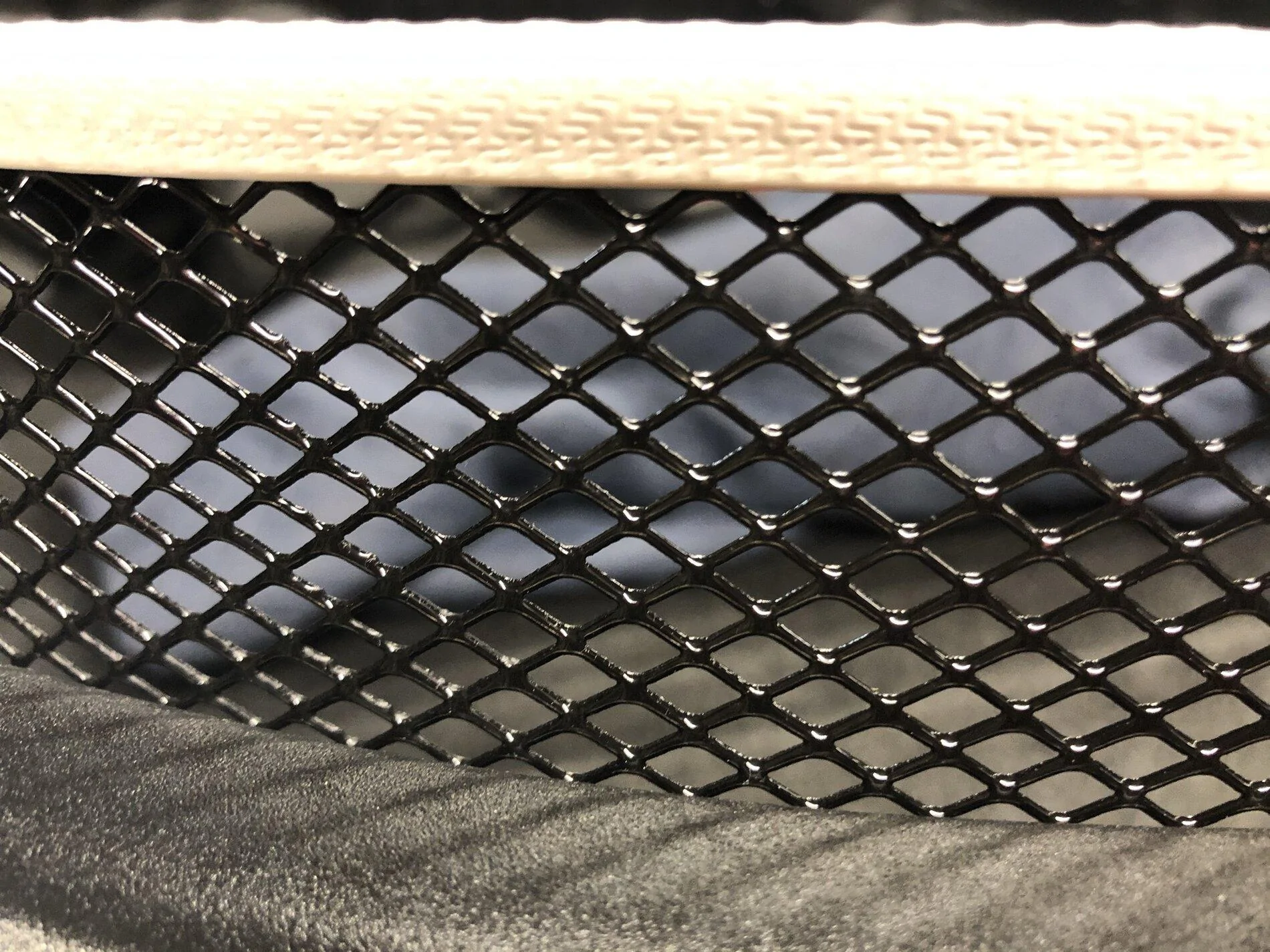

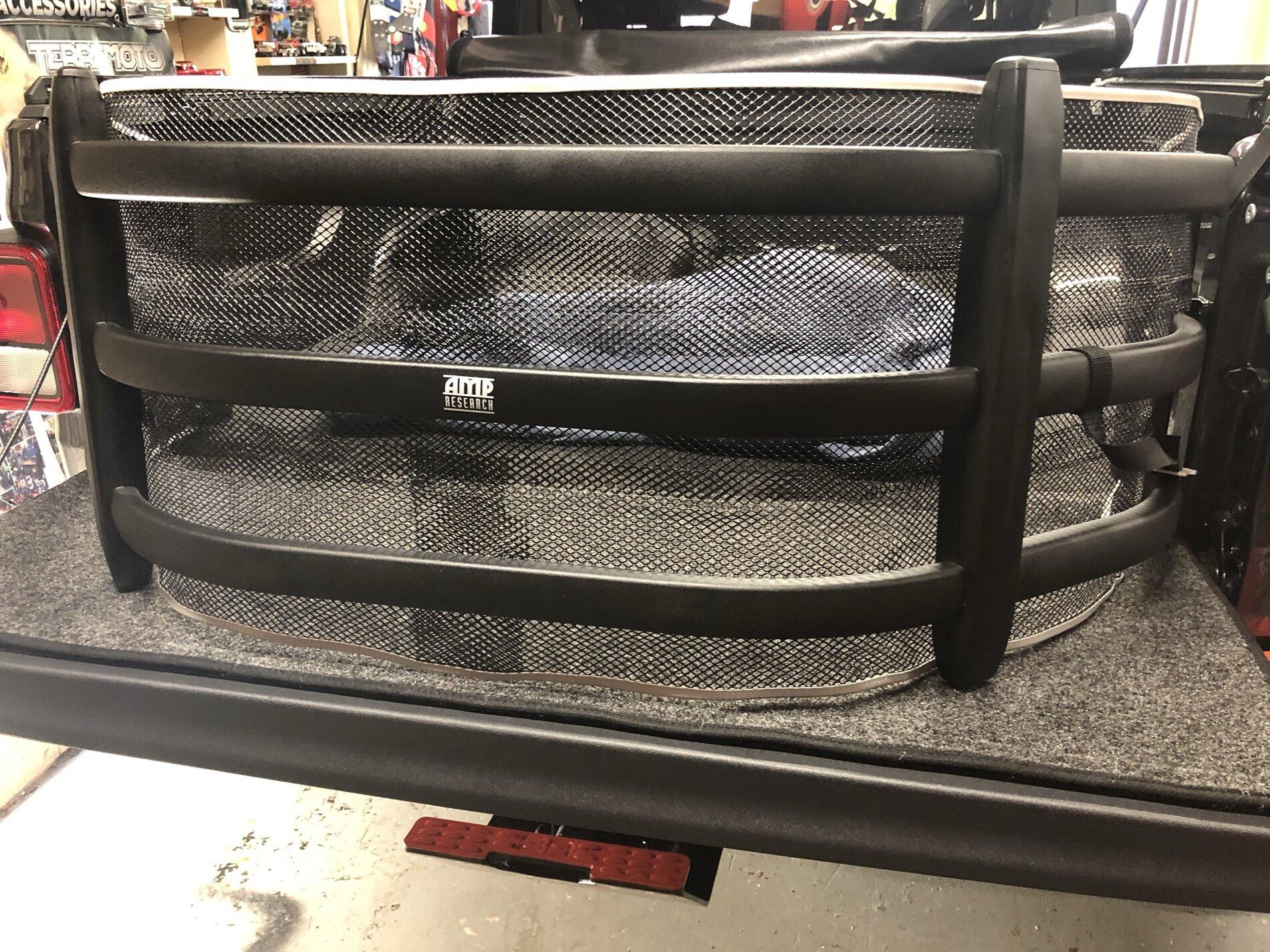

Installed some aluminum gutter mesh and some trim edging on the AMP bed extender . I don’t run it regularly but when I need it I don’t have to worry about anything sliding underneath the bars.
Are you able to close your bed cover with that bed extender?

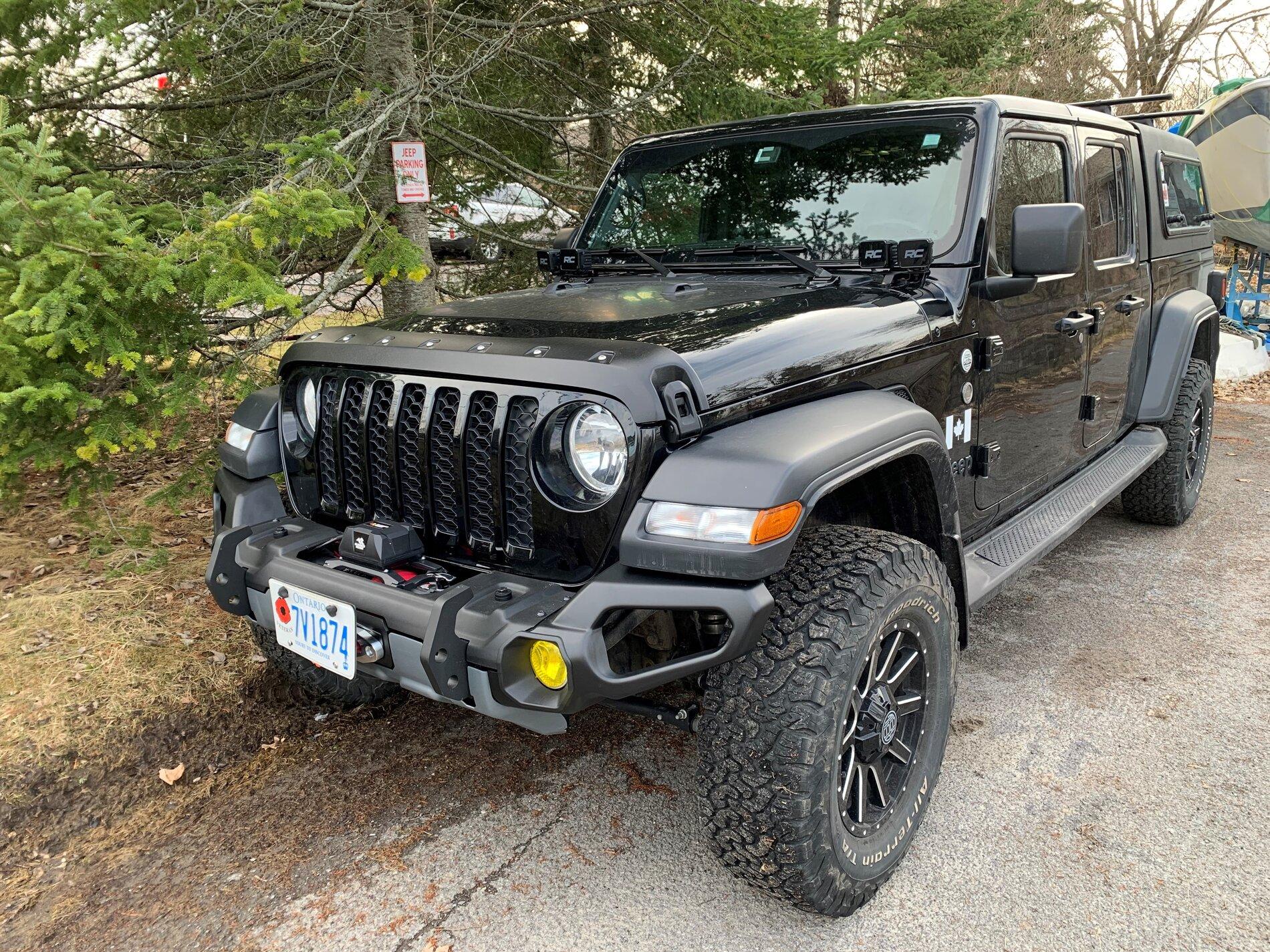

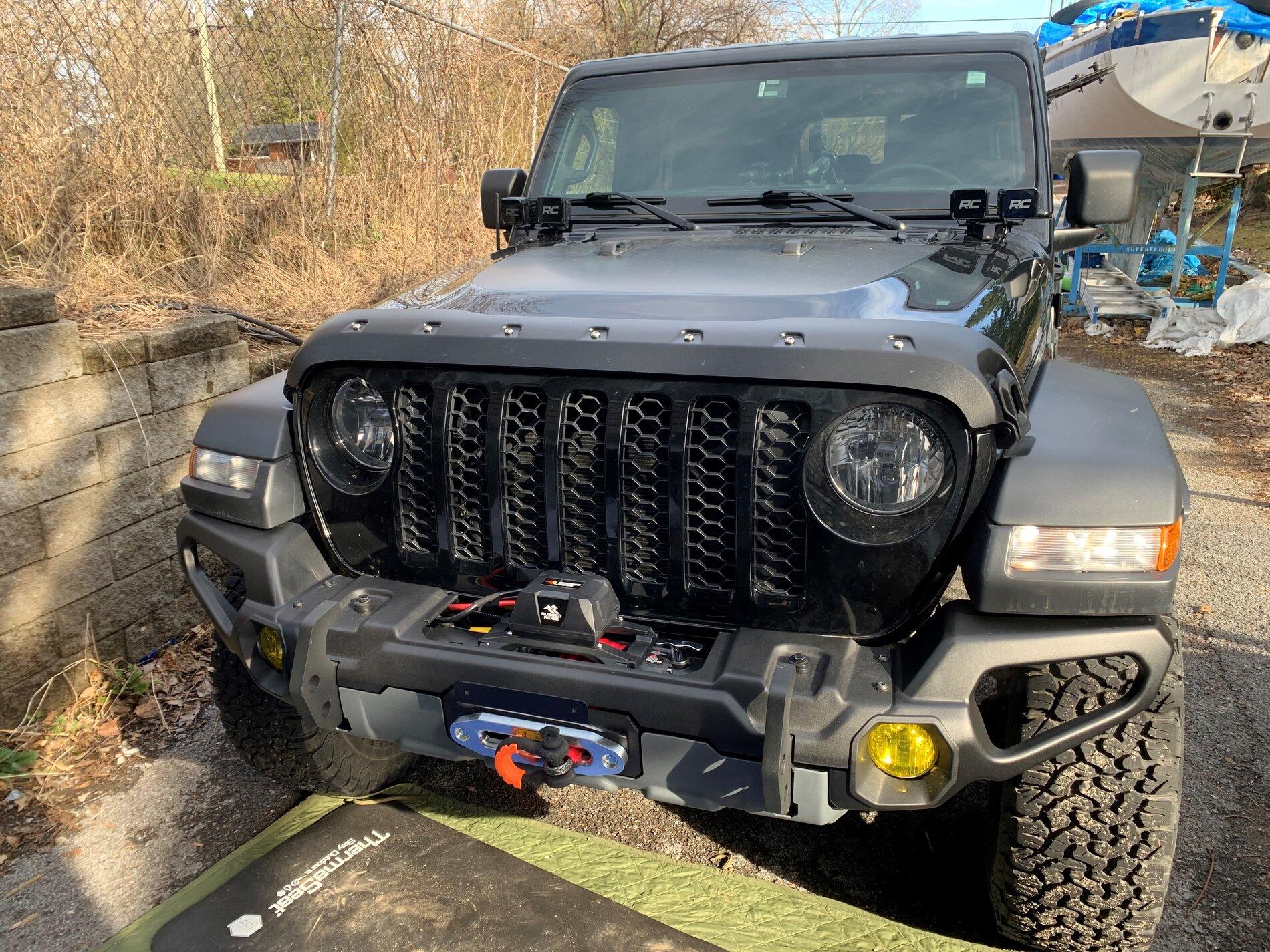

Installed my Rugged Ridge Venator bumper and Trekker 10k winch. Now I'm ready to get stuck, or help others... It also looks good I think!
I Believe that would be My Bumper of Choice
