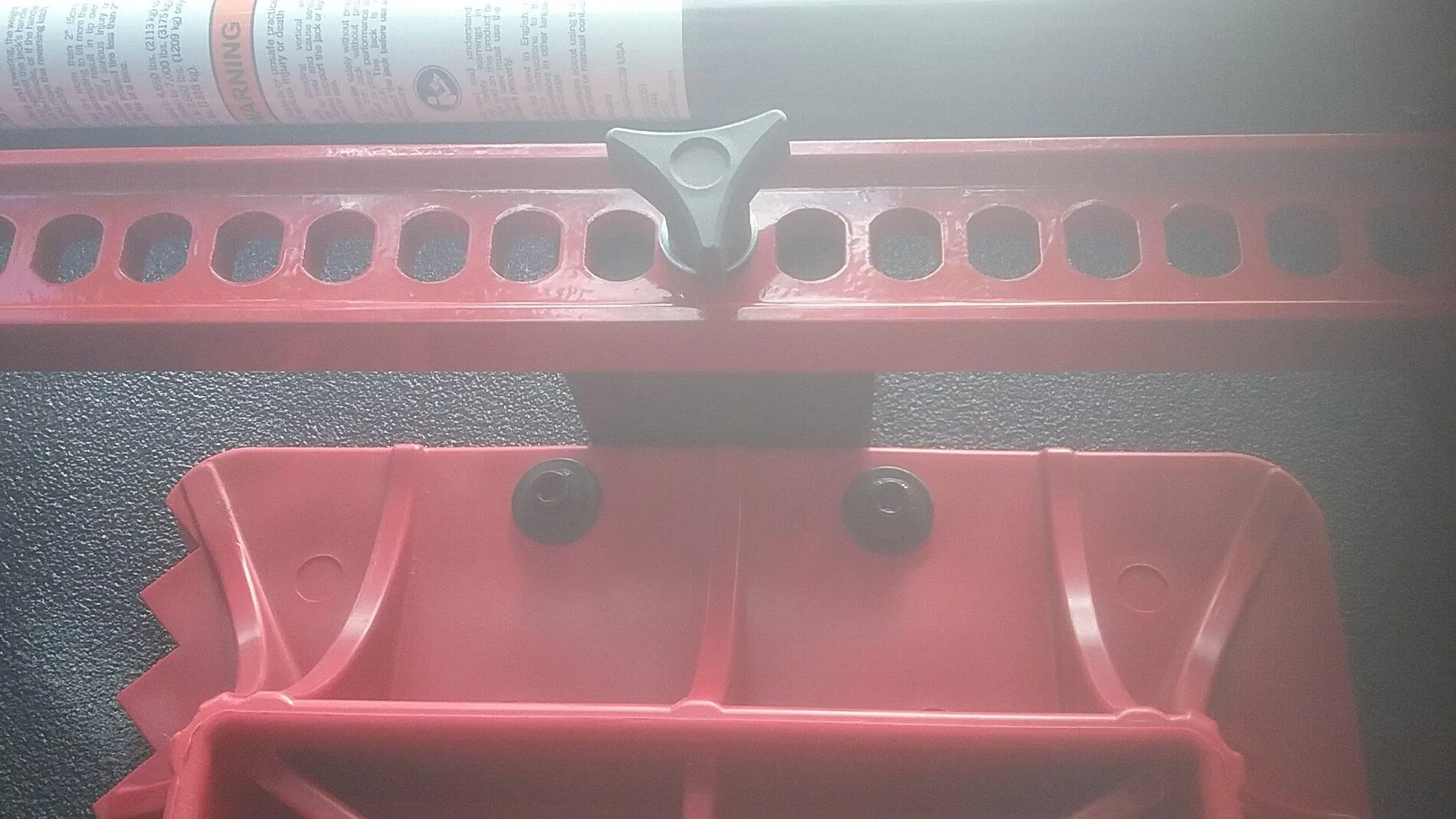

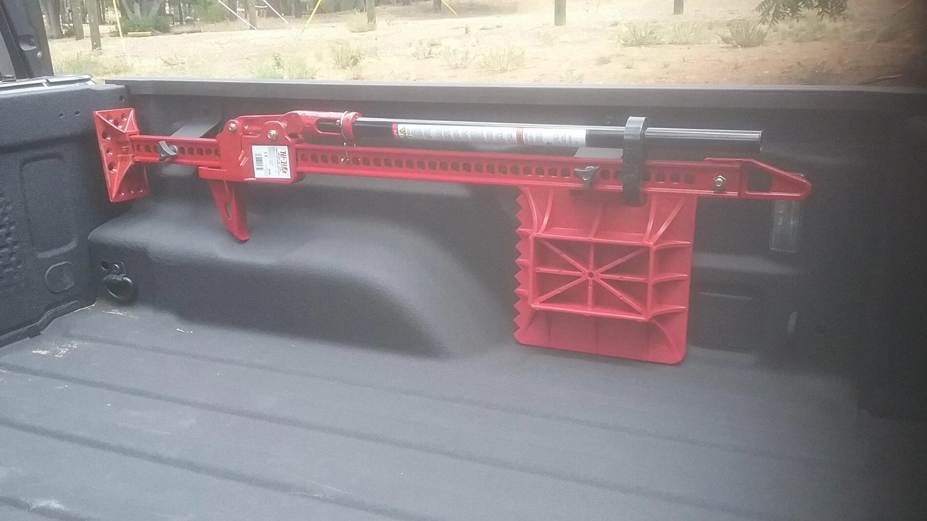

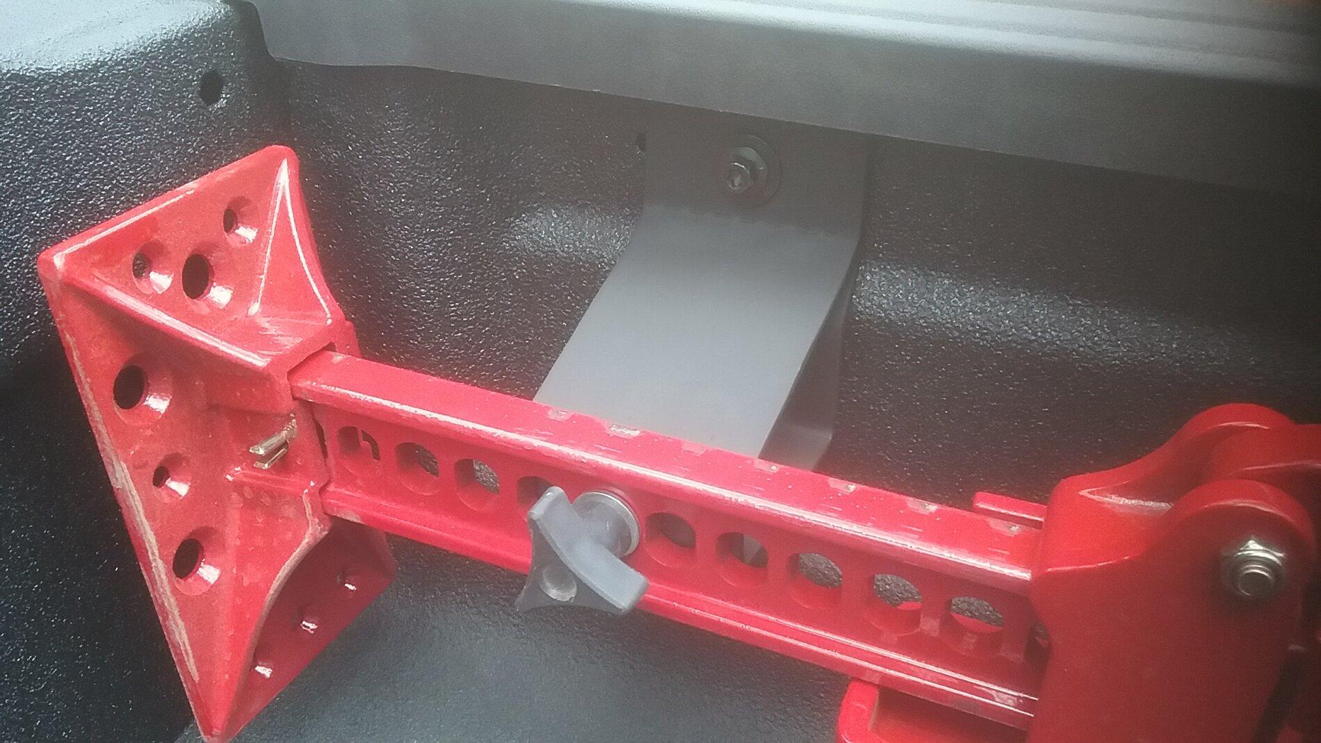

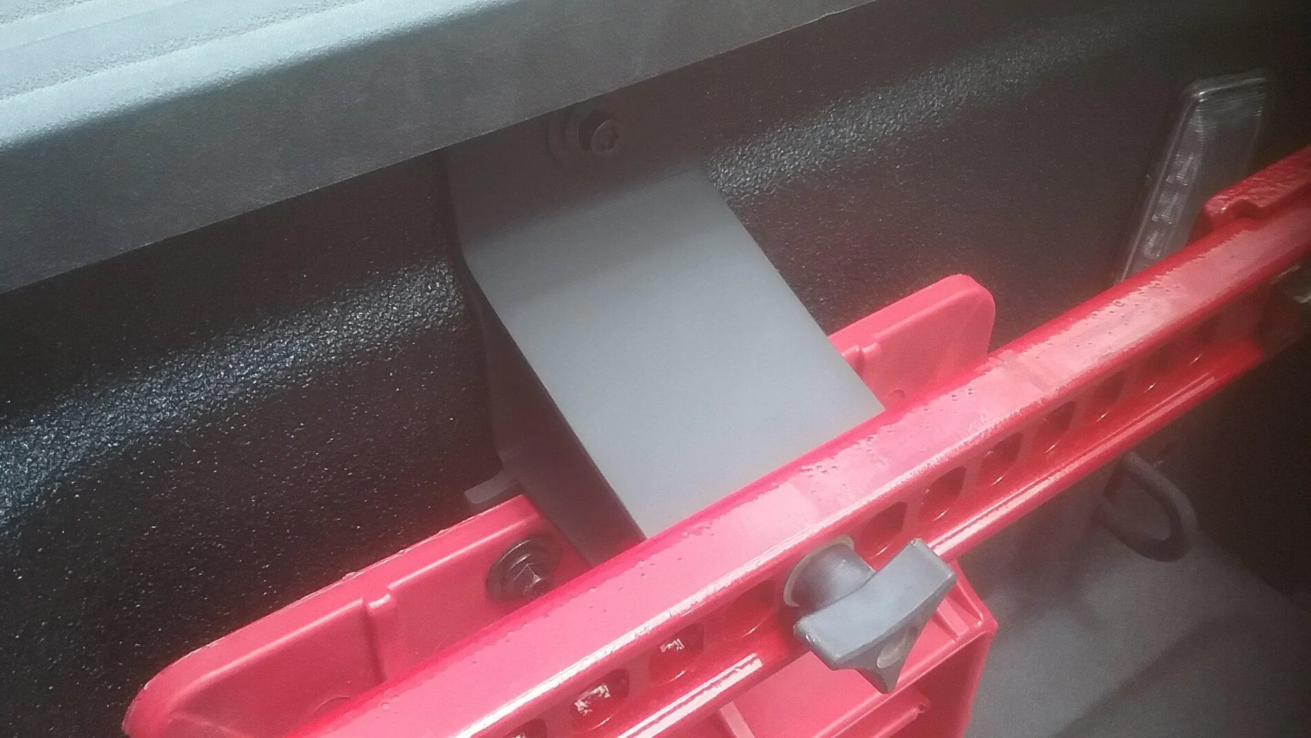

Fabbed up some simple mounts for a Hi-Lift and a Bigfoot. Don't really need the Trail Rail system and every mount I see fits them. They also orient the climber to cover up the bed light, which seems kinda dumb to me. So, vice and hammer time! And a bit of welding. Aaaand the four bolts I removed from that silly tray under the rear seats. Aaaaaaand a pair of handle clamping bolts off a mount for a long since destroyed workstation for an equally deceased miter saw at work. Total cost = $0.00. But if you want to get technical, I did pay 47 something thousand for the truck; so, those four bolts are a bit pricey from that perspective. ?

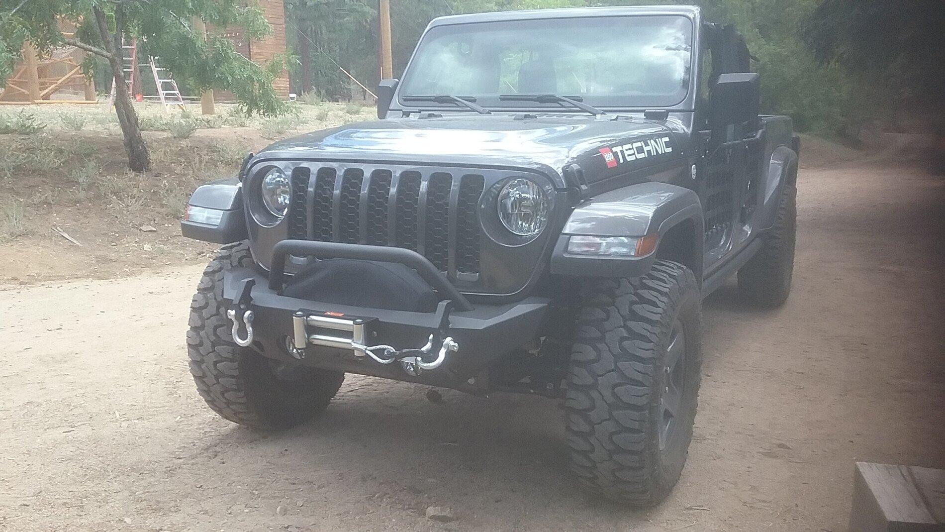

ALSO, added Rugged Ridge HD stubby bumper and a Quadratec winch. Outstanding craftsmanship on that bumper, kudos to RR. Highly recommended if you want a trouble free install. Went direct connect for now on the winch, I'll toss in a single pole soleniod later with a fun switch on the dash. Gotta let the coffers build up a bit first. Damn you, Amazon Prime Day! Choke on it, Bezos!
