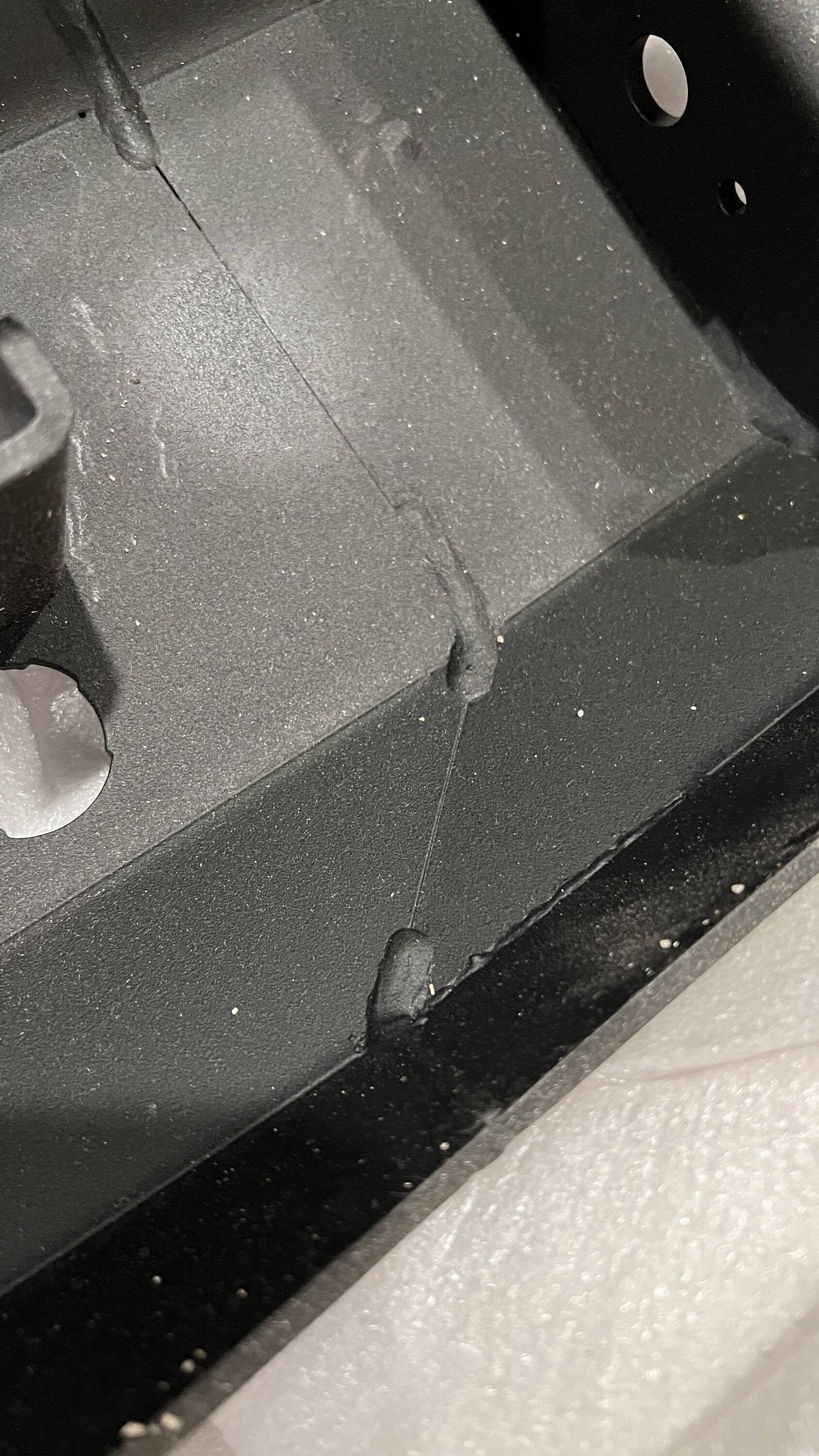

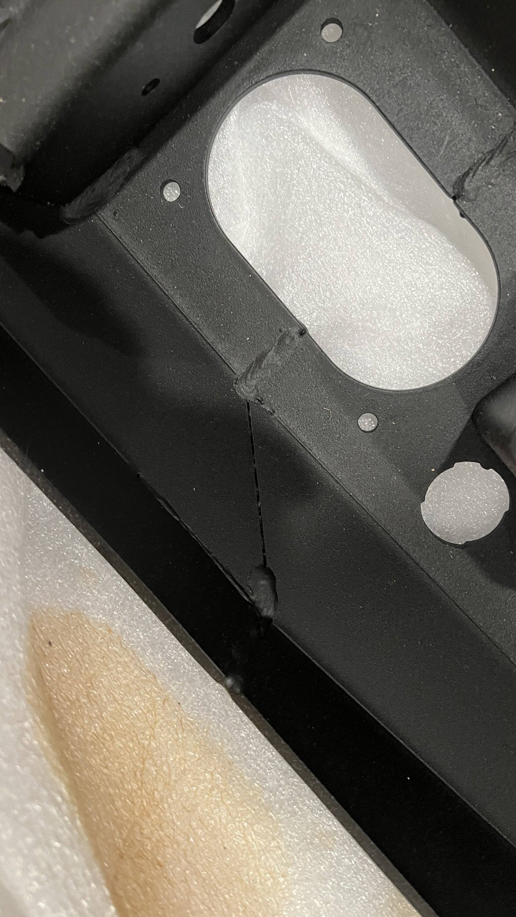

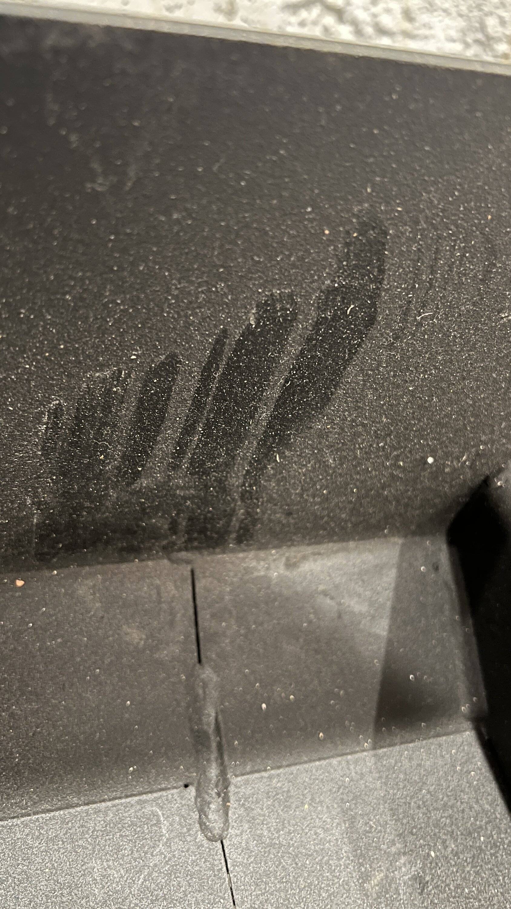

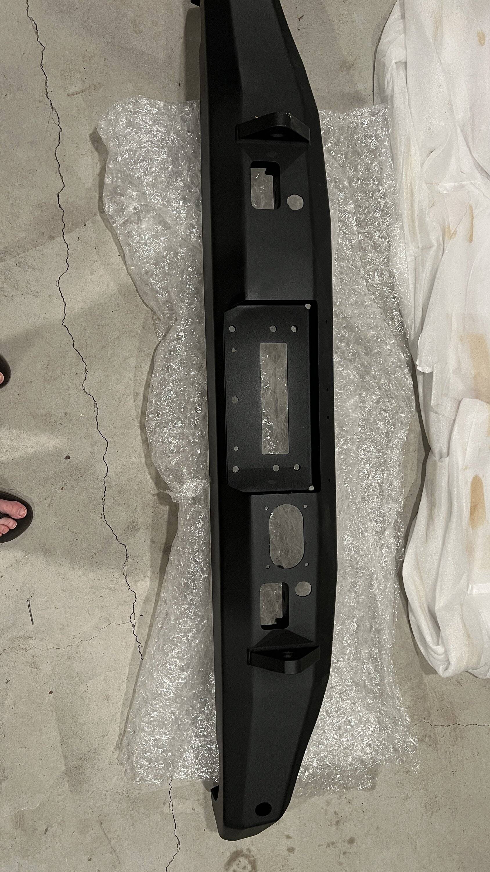

Ordered a road armor stealth winch bumper a while ago. Just haven't put it on yet because I dont want it to get dinged and rusted before summer even hits. I hate with a passion this mag-chloride they spray all over the roads here. https://www.quadratec.com/p/road-ar...NmKDl5zZYSVxmgM19Lc-Fdl_vYYXeTS8aAvB_EALw_wcB Quadratec had them at nearly 50% off at 800 bucks for some reason, and I was eyeballing them since I first started looking at bumpers. Honestly a little concerned for the quality of the welds with how it is bolted up to the jeep - but I called them the other day and they actually claimed it was good up to a 9.5K winch. I can't tell what these weird welds are on either side of the center portion.... Maybe it was from a fold or something? It almost appears to be a modular welded together bumper, but the front of the bumper is totally flat, so unless they pieced It together and grinned it down super smooth then I have no clue..... But I'm going to take the risk I suppose, because there's nothing else on market right now and that is far beyond my fab abilities.

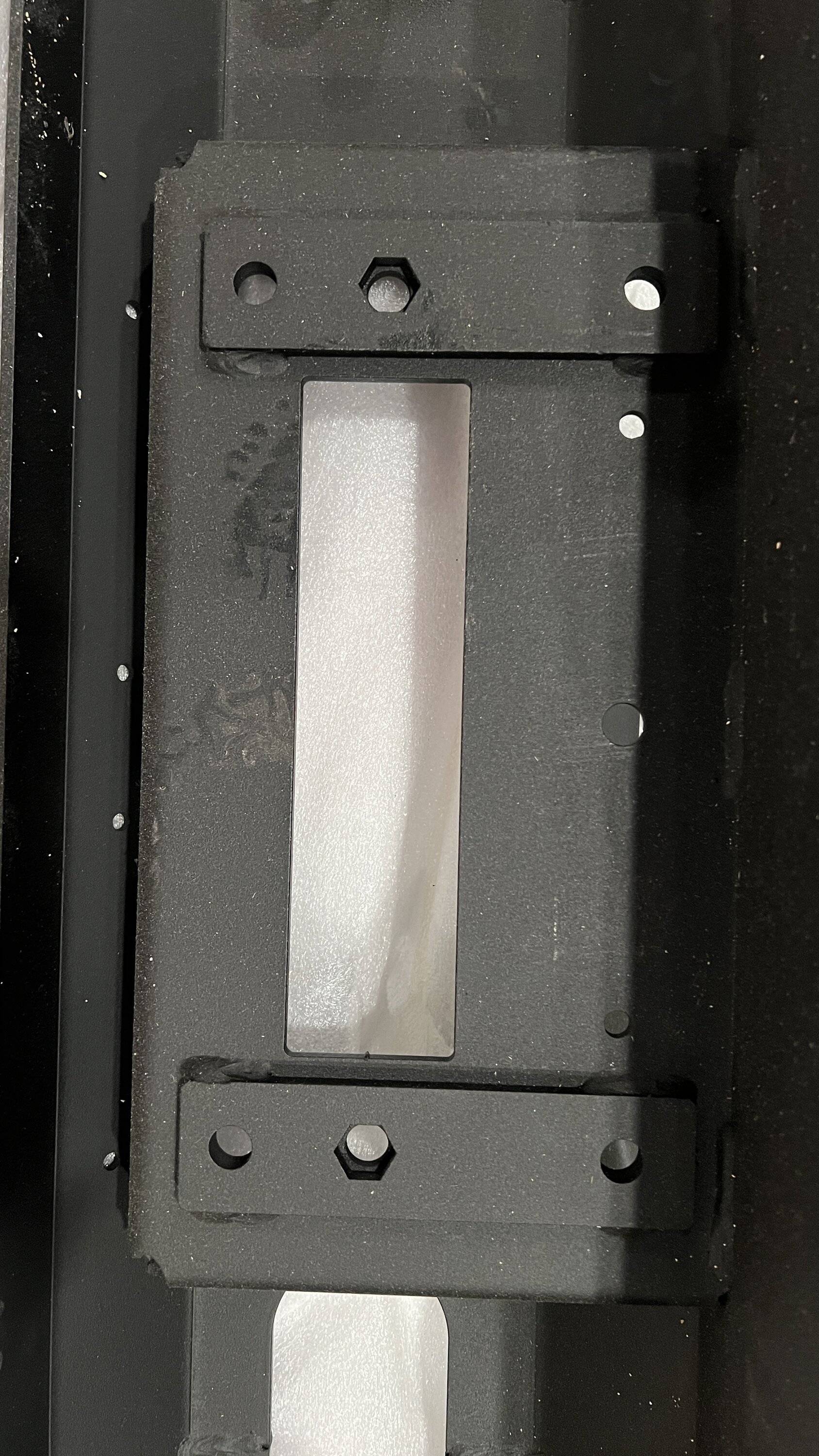

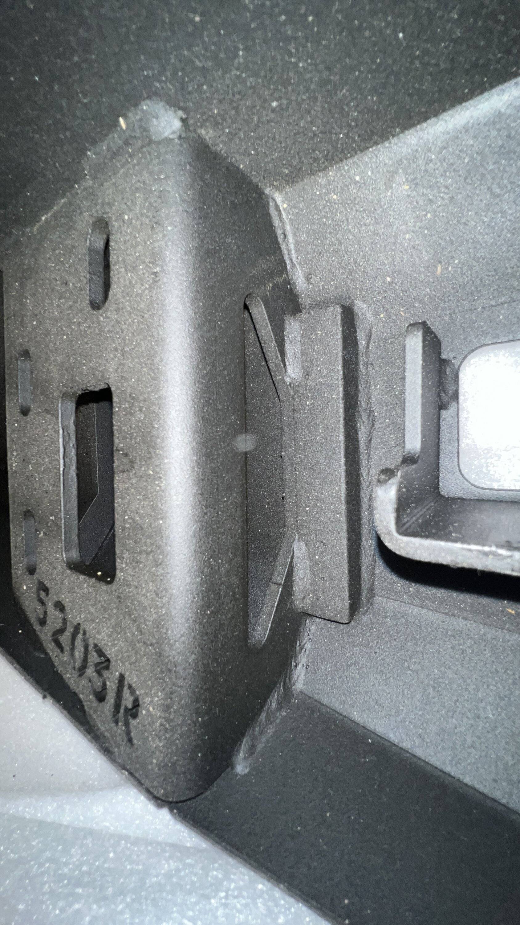

Here is a few more now just due to my own curiosity. The top steel is solid. so it appears to be stamped in one single sheet, then bent to form, and welded together. but the top portion is solid so I dont see how it can fail under reasonable use - but I"m also not a metallurgy guy either.

I see your point. I’d question those as well, but I’m only a novice welder, so don’t know good from bad usually. That’s a rear winch bumper, correct?
