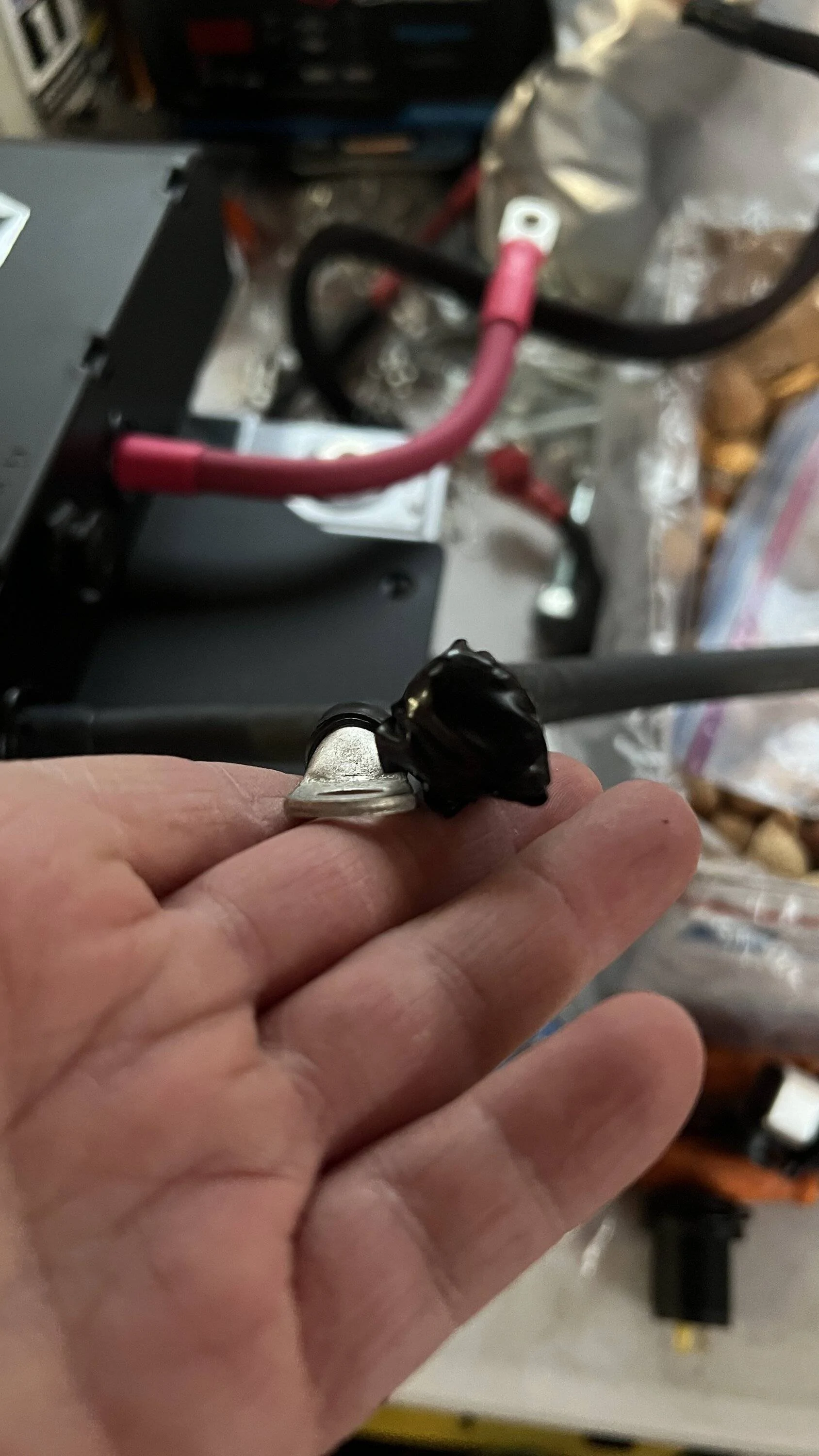

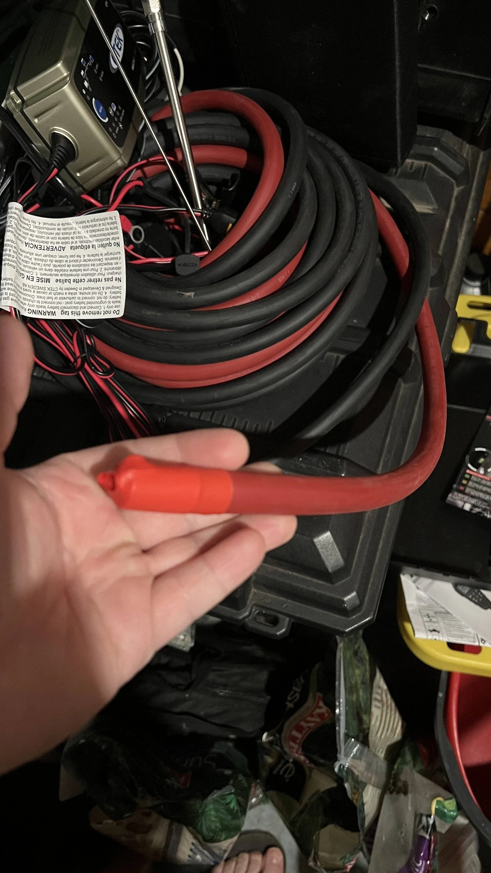

I remember crunching the numbers at one point and I think I was leaning towards 2/0 minimum. Preferably 3/0. Roughly 40ft of cable run (pos+neg), pulling up to 350 max amps, requires some serious gauge. I'd rather do it once, correctly and safely, than skimp on the size and end up melting something.
I don't have any pictures handy, but I recall measuring just over 10 inches of depth from the winch mounting face on the rear bumper, to the tread of my stowed spare 35" Ridge Grappler. My winch is ~10.1" tall with the solenoid installed, which is why I suspected I may have to go with a remote mount.
Sweet! Well I certainly appreciate your chiming in!! It's always good to hear from those who have done so before.
I actually happen to have some 2/0 lying around and let me tell ya thats some big (and very heavy) wire. Personally I plan on getting some 1ga and using that seeing as how Warn uses 2ga for a 25' run and says it's ok. I do agree that doing it right once is best though.
But if you're running a line to a power distribution block and running other things off of that then thats not a bad idea. I have some 4ga going to the bed to run all my 'house' items including future expansion for a dc/dc which is a consistent 30a pull. But the winch will get its own dedicated wire.
Here is some 2AWG (left) standard battery cable, next to 2/0 (right). It's just a tad more than twice the size
