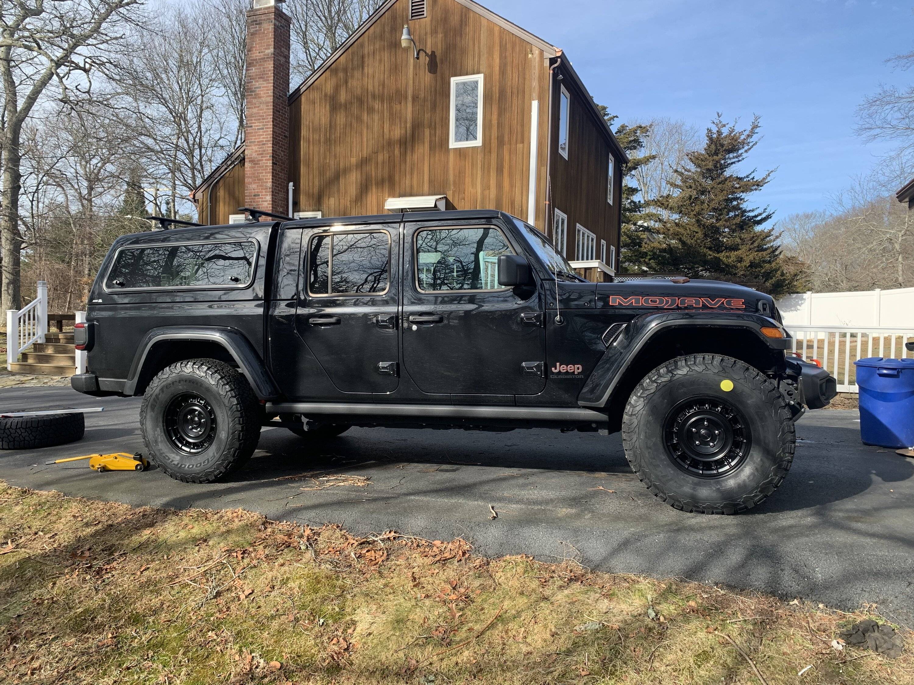

Ended up getting the 37s on a week before the lift and couldn’t be happier. Definitely lost a bit of the top end but not by any means unbearable. Probably will regear eventually just to get that 75-85mph range back.
