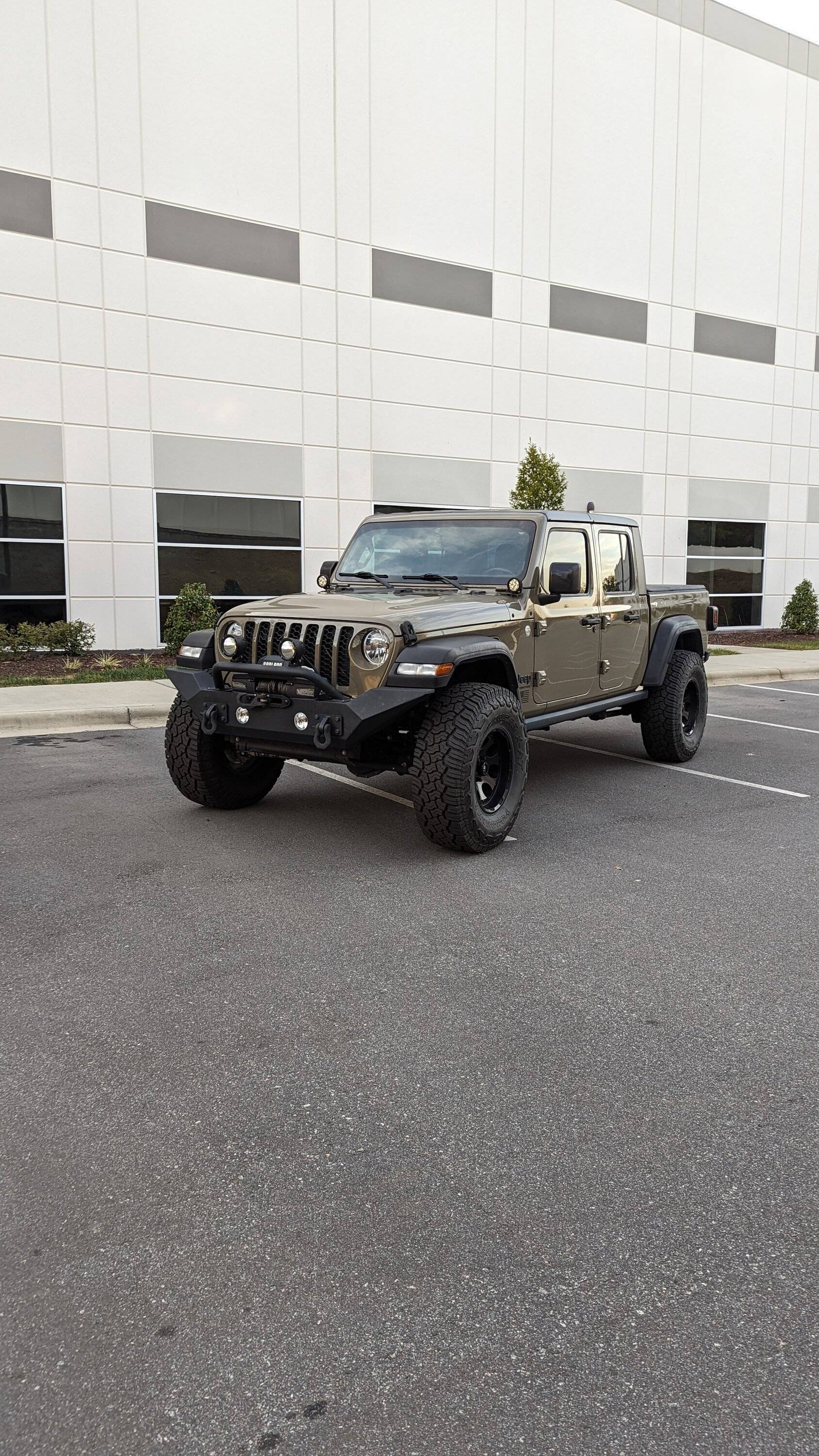

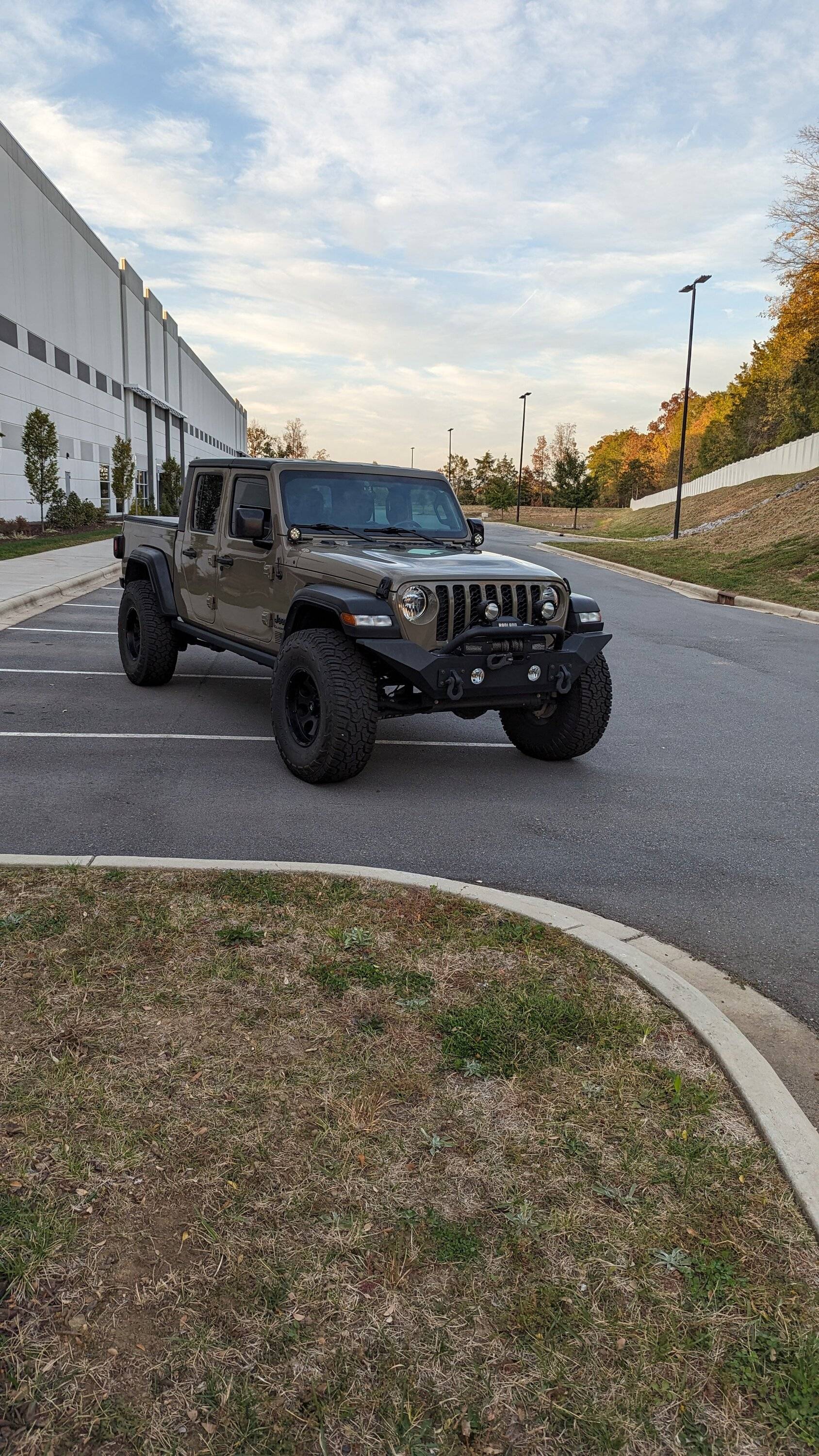

I did a 2.5" Readylift 3 days after I bought. I e but put 35's on first. A year later I was on 37's and haven't looked back. Currently almost 4 years after buying it still running the same lift and 37 12.5 17 Geolander X-AT's. I see plenty of 8th and average 17 mpgs to 18.5 mpgs depending on how far I drive, 50/50 city and Hwy. 2020 Max Tow Sport

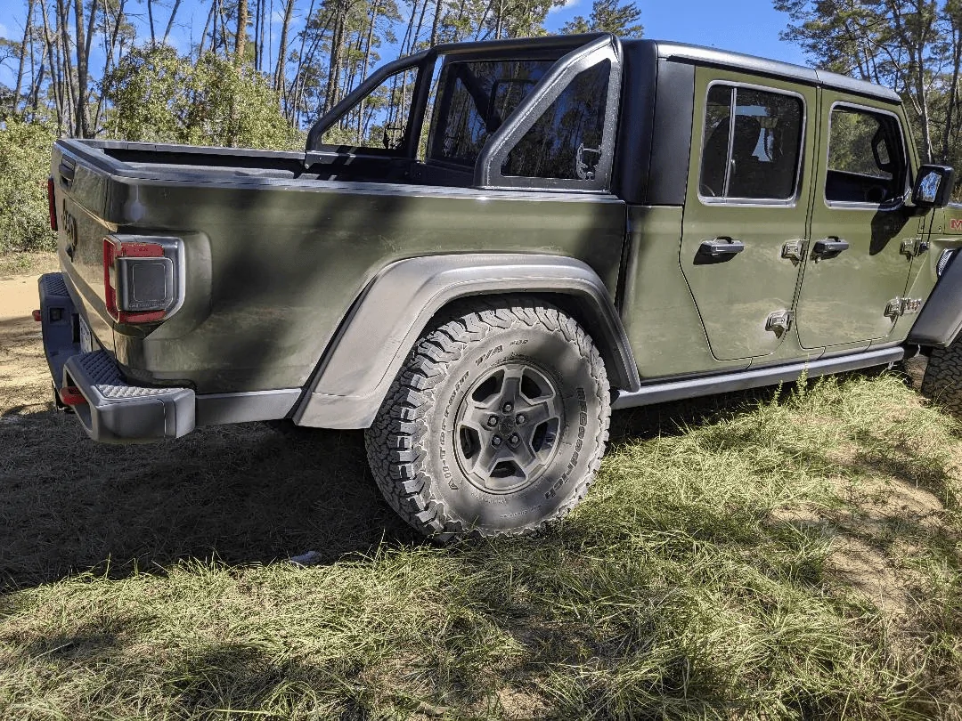

37x12.50x17 BFG KO2 on stock Wheels. 2023 Mojave. No lift.
I put one washer in the steering stop both sides
I trimmed a little from the inner fender liner
I flexed it as much as I possibly could off road and have zero rubbing or other issues.
I maintained a low center of gravity, which should be the ultimate goal for everyone that off roads. Only lift a vehicle as necessary to clear your tires.

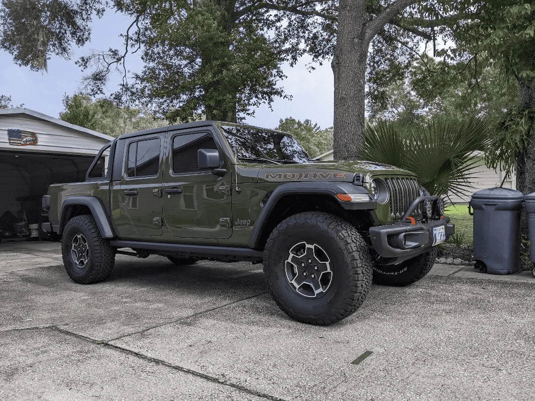

You won't lose the ability to cruise 80mph even with the 4.10s and 37s. 37s went on yesterday and even though I haven't recalibrated yet it cruises along at 85mph according to the GPS at 2100 rpms in 8th gear. I'd say tires 1st as it makes the biggest difference in looks and function but I did both at the same time. Very happy with the AEV 2" kit and 37s although the procal needing a wiring harness is lame.

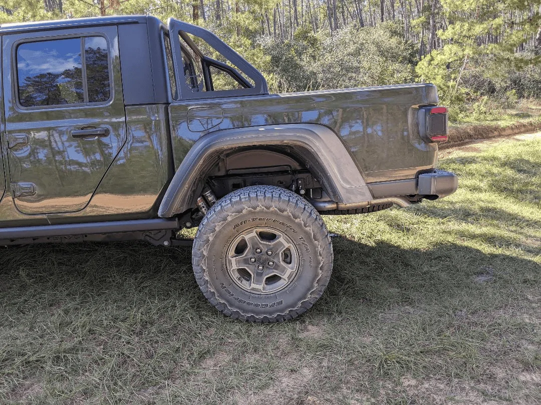

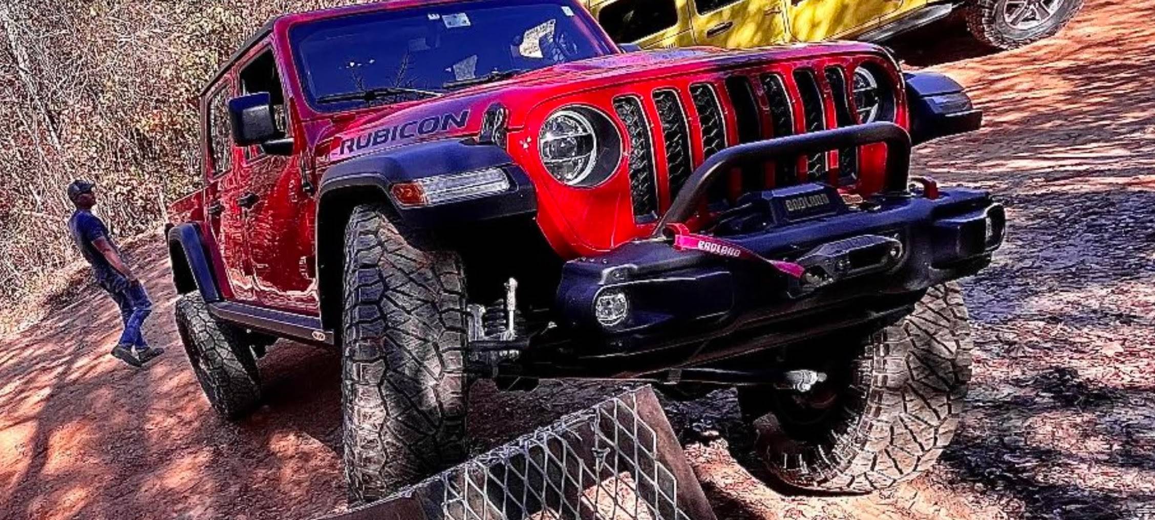

I have the Clayton Overland+ 2.5" lift this picture I wasn't totally flexed (wasn't on the bump stops) and the 37's were quite stuffed with swaybar disconnected. Still had an inch or two between the tire and fender liner.
