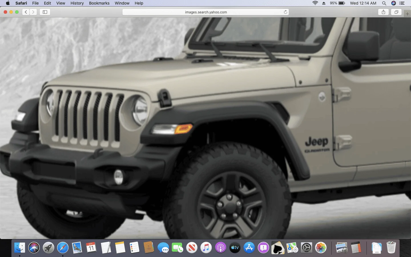

Does anyone know the name and part number of the plastic part that connects the front fender flare to the bumper closing the gap as shown it Photo

It's called a "Closure Panel". Last time I looked it up, they were around $11 bucks I think.

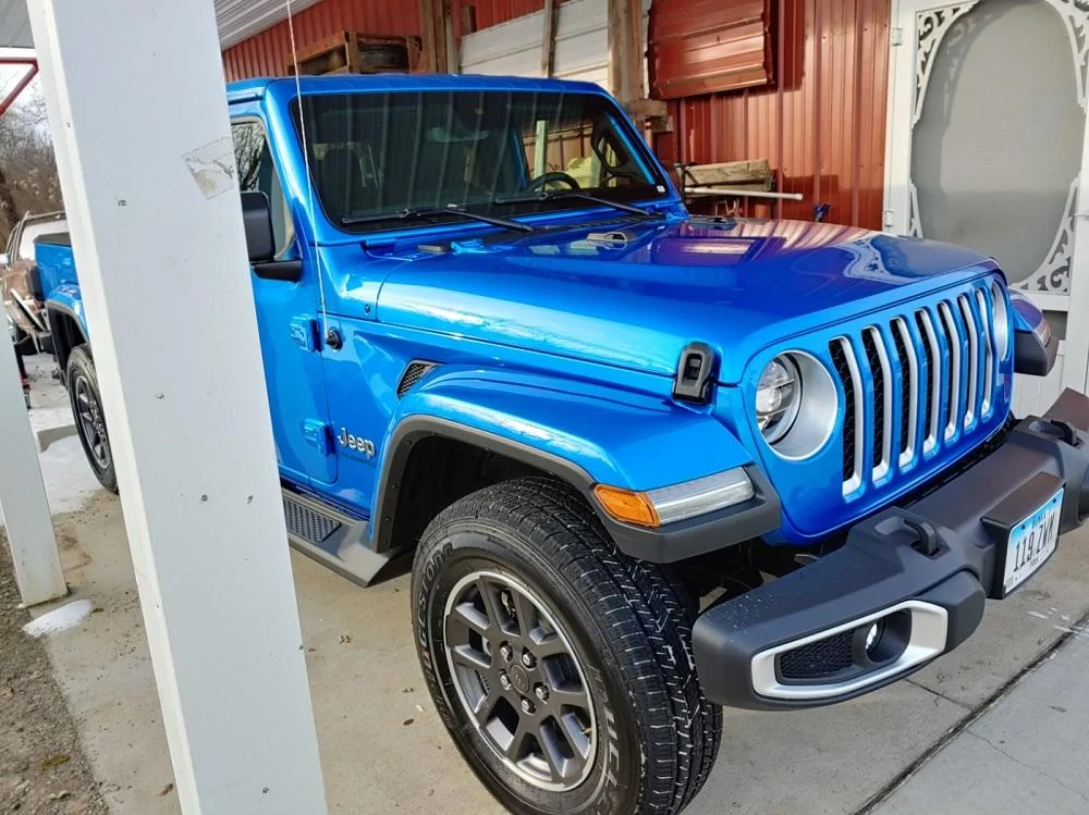

I need those - where can a person get them? Dealers?? After-market? I drove home on slightly icy roads with some random snow and a bit of sand and slush and just on the drive home from picking it up - well, look at the top of the bumper...... and that was on not bad roads. We're expecting a nasty spell of snow, crud, ice. They love to slime up the roads here - don't need that all over the bumper on street driving.

It'll surprise you how much efficiency those closure panels and the lower bumper scoop add. When I put my aftermarket bumper on, I had to obviously remove those pieces. The aftermarket bumper is shaped very similarly to the stock one, except it doesn't have any aero pieces on the outside to deflect wind around the tires. Nor does it have a lower scoop to deflect wind around the suspension linkages and axle (though I made one of those at home later). The aero changes immediately destroyed my fuel economy. I'm talking a hand calculated 11% loss or so. Those plastic aero pieces DO work.
In fact, if I hadn't spent so much $$$ on this aftermarket bumper and winch, I'd probably put my factory stuff back on. I'm going to give it a year and if I don't end up using the winch much I'll likely go back to stock anyhow.

I'm still hoping to find a pair - and see if they can be installed on the Overland. I'm really surprised that since the Overland level is the one for MPG and making nice that they don't have those on them. Why the Sport and not Overland? I'd expect the sport to NOT have those since the Sport is more for - well, sport LOL

I had to cut mine off because they are part of the bumper, they cover the back of the fog lights. You may need the whole bumper. Well, Happy Thanksgiving to you at any rate. Good luck
