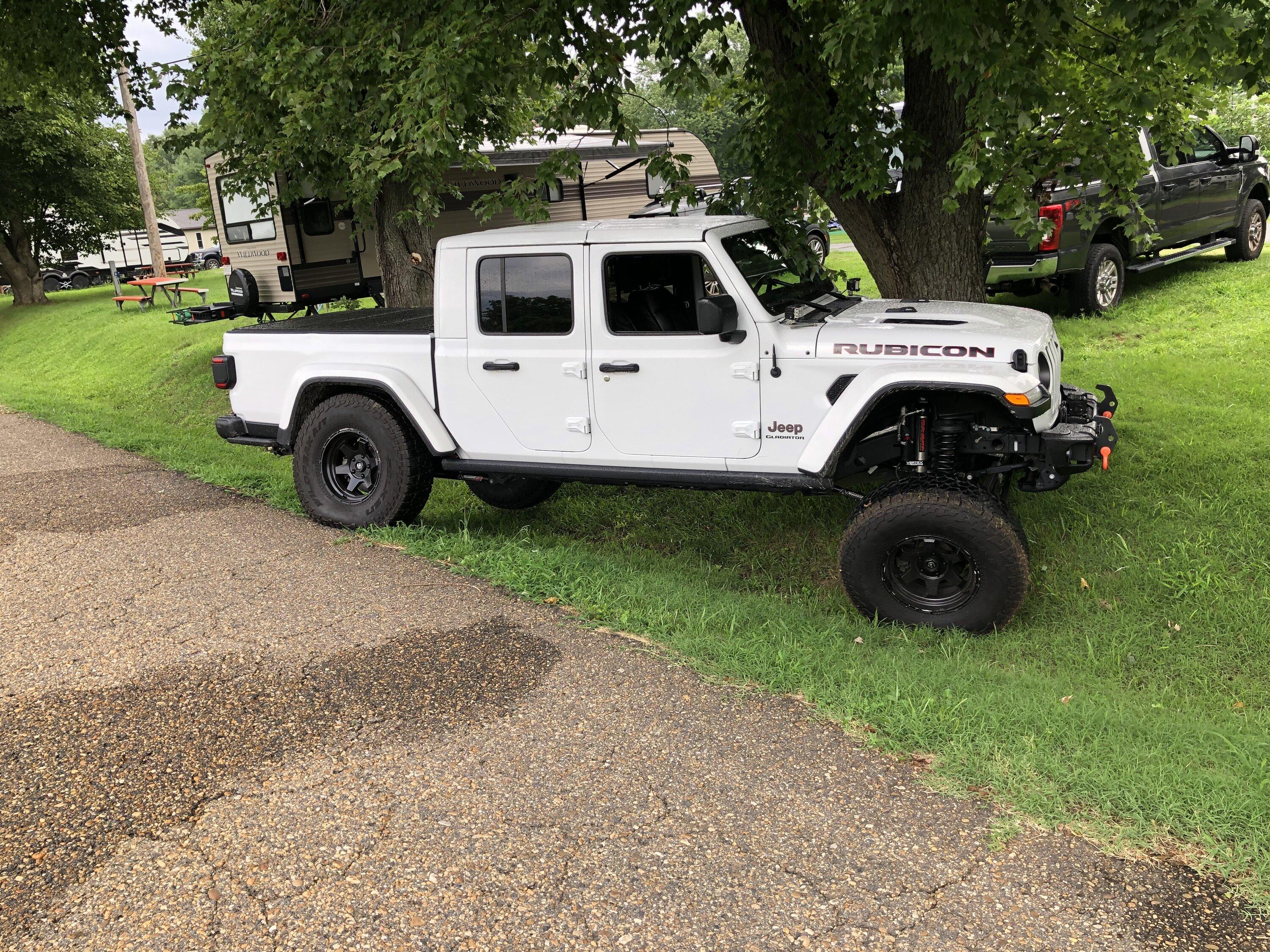

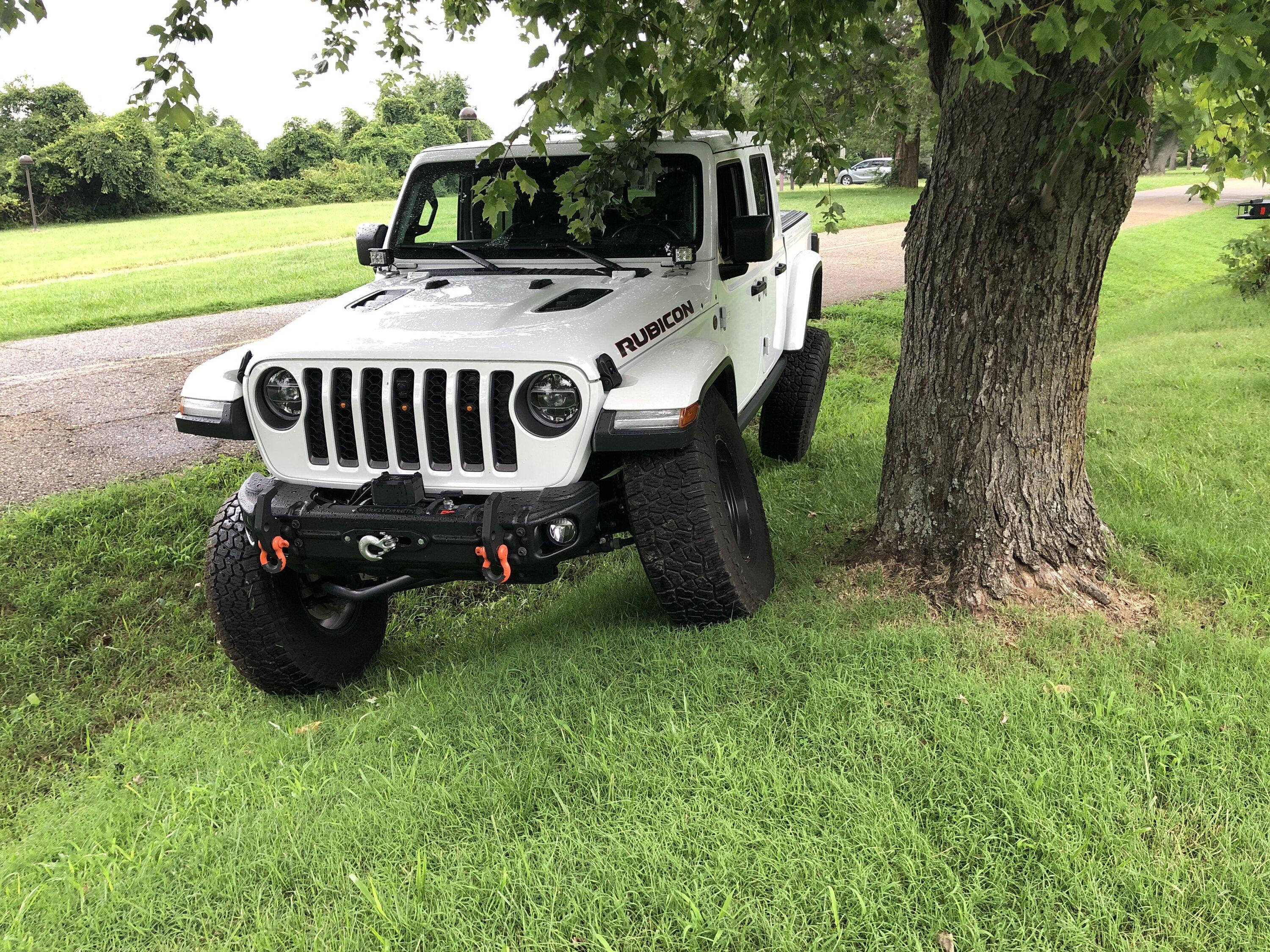

I have the evo 2.5"springs and ended up around 3.5"-3.75" of lift. I ran the extensions for a while to see if they would settle before I bought shocks. Did that for about 16 months, and they didn't settle much and have stayed true to that height. For reference, I only have a winch hanging off the front and some light aluminum skids under the oil pan / trans, so not a ton of extra weight. I went with the "3-5"-4.5" lift" length shocks and they are matched perfectly with the bump-stops provided with the 2.5" Evo Enforcer Lift. Only about 1-2" of shock shaft showing at full compression. I wish I had a photo of that for you, but for reference, the attached photos were taken right after shock install and there were no obvious issues with over or under extension of the shocks. Did a few wheeling trips after that and no issues to report either. Good luck mon ami!
