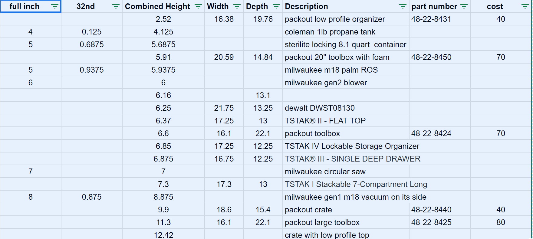

So i started making a table of anything around 5-7" that I might want to carry in the drawers of the bed. There are a lot of smaller toolboxes from milwaukee packout and dewalt tstak/toughsystem that are near the 6-7" height.
Any other items that you would suggest measuring to get into the drawers?
at 7", i get 6.25" usable
7.875" and I get 7.125" usable. I'm thinking of going this height so I can get any of the milwaukee dewalt boxes in there, except the really large tstak 7 compartment thingy. Might also be able to fit my circular saw in there, though that doesn't need to fit in there. I'm usually not worried about space when i'm needing a circular saw.
I can also fit a fire extinguisher in the drawer. I think mine is only 5.5" tall

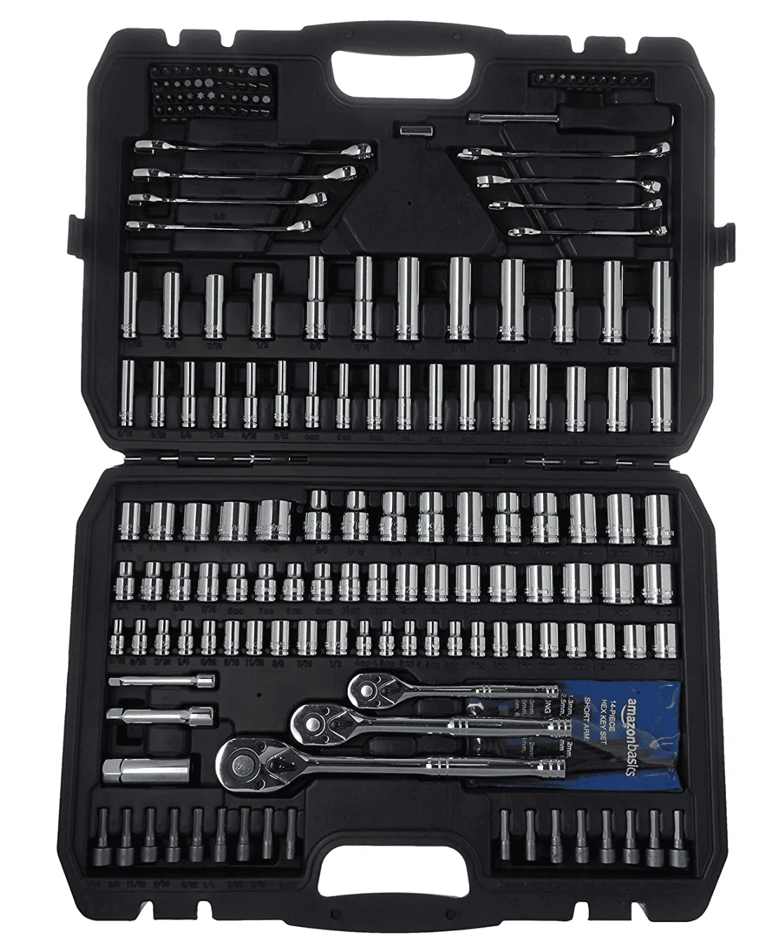

i also need to find a couple travel tool sets like this

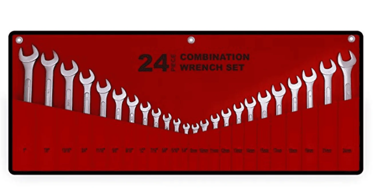

and something like this.

I've already got all of those tools, but i don't want to have to think about all the sockets, wrenches, ect. I might need while overlanding. I just want the majority of the tools to already be in the truck. Throw in my impact and be good to go.
I'm just wondering if any "kit" will be complete enough.....I might have to just piece together another set of tools and store em in something not as compact as a blow molded case....
OR.....
Buy new tools for home and put the old craftsman mechanic tools in the JT?

I guess the first thing you have to decide, as you’ve alluded to, is exactly what you want to put inside your drawers (so to speak!). It sounds like you’re planning on bringing a complete mechanic shop with you!!! In my other rig that I’m taking on a 3 month trip this summer I have two tool rolls with wrenches, pliers, screwdrivers etc. for nuts that are actually on that truck. To me there is no reason to have a 5mm wrench in my tool roll if I don’t have a nut that size on my truck. I think you have to keep an eye on the weight of what you’re putting in your truck or before you know it you literally have a ton of stuff on there...
totally agree, but I dont' know what the common sizes are that I would need, either need to poke around or ........somebody help!? :involve:
