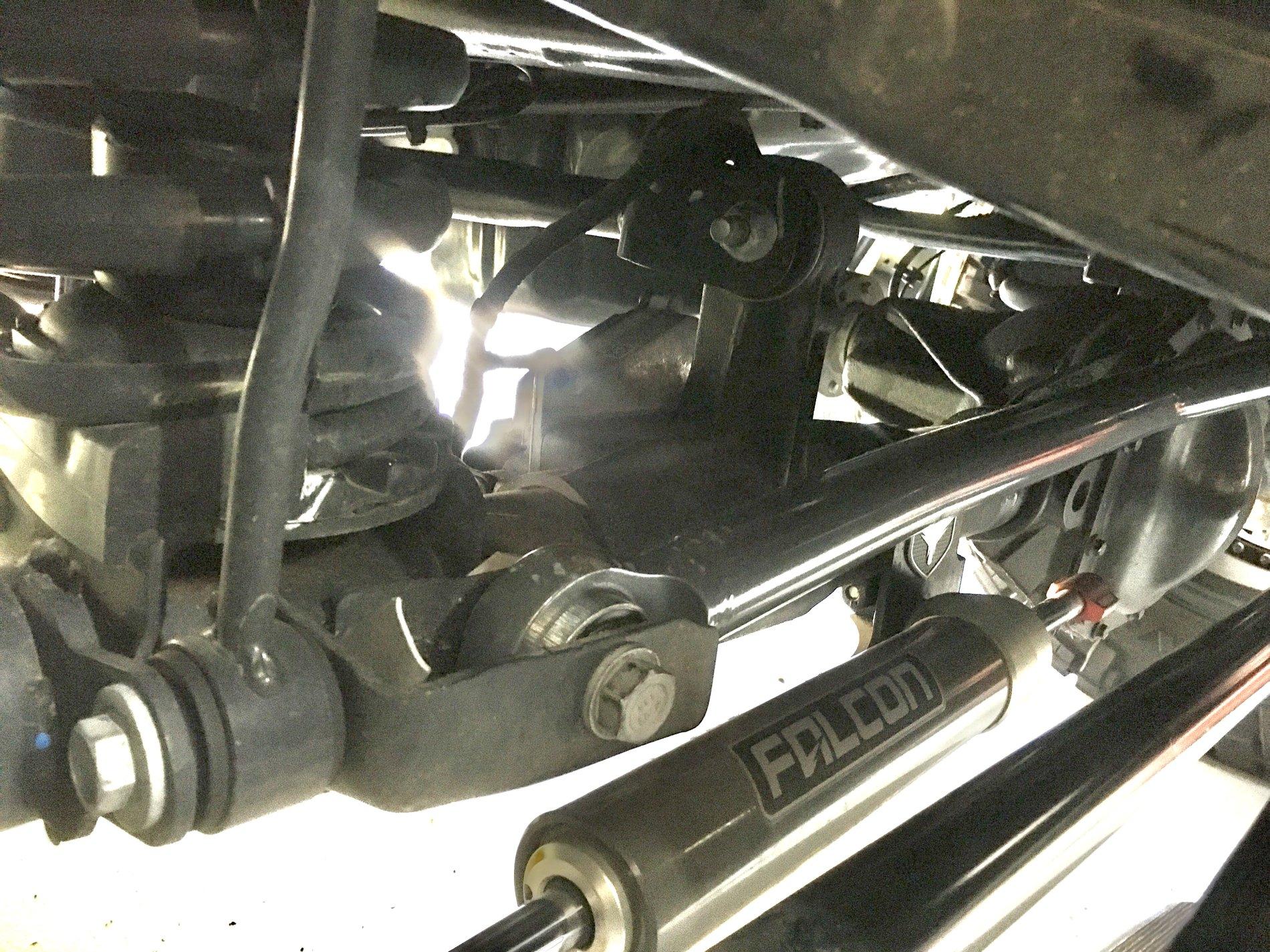

Synergy track bar, Falcon 2.2 stabilizer.
Jeep Gladiator What track bar and stabilizer with Mopar lift? 0142346A-638E-47AF-86EB-7B2AAE89AEA4
