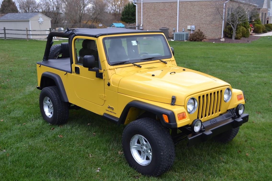

On a 2012 JKU in your profile or a JT? If the 2012 JKU and the hubs were not cleaned perfect and a precise install was done then maybe.
If a 2020 brand new JKU, probably not the spacer causing issue.
You will always get a 50/50 response to spacer questions. Some are for and some are against. Hopefully you used SpiderTrax or a brand name. There is junk outhere, otherwise. Another poster may be right on with it being more an issue with new track width.
SpiderTrax with factory 2005 Ravine wheels helped 32X11.5 run on Old Man Emu 2 inch lift very very well for 65K miles before I sold it. Installs lift at 85 K miles, sold at 150. Damn great ride and steer.[/QUOTE]
