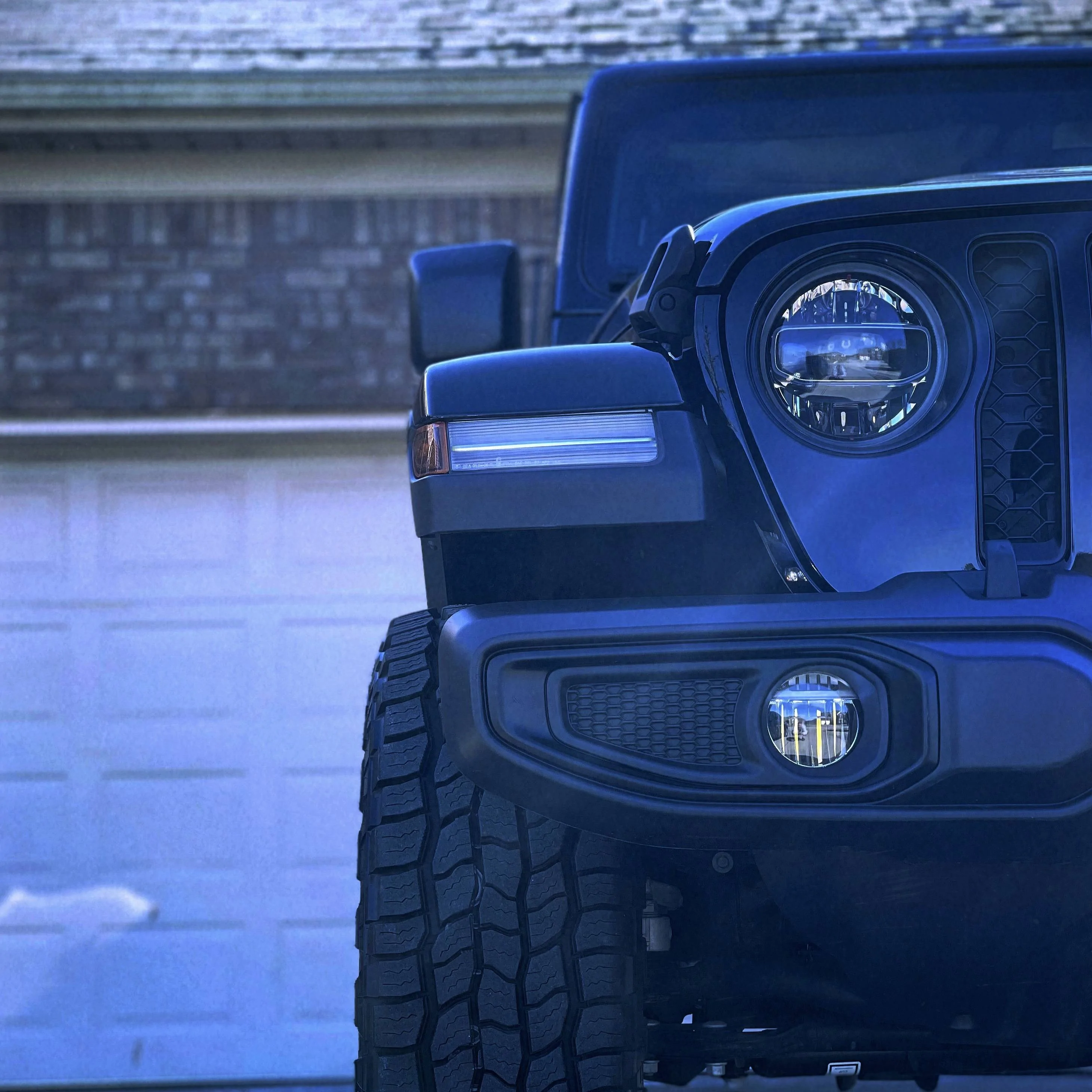

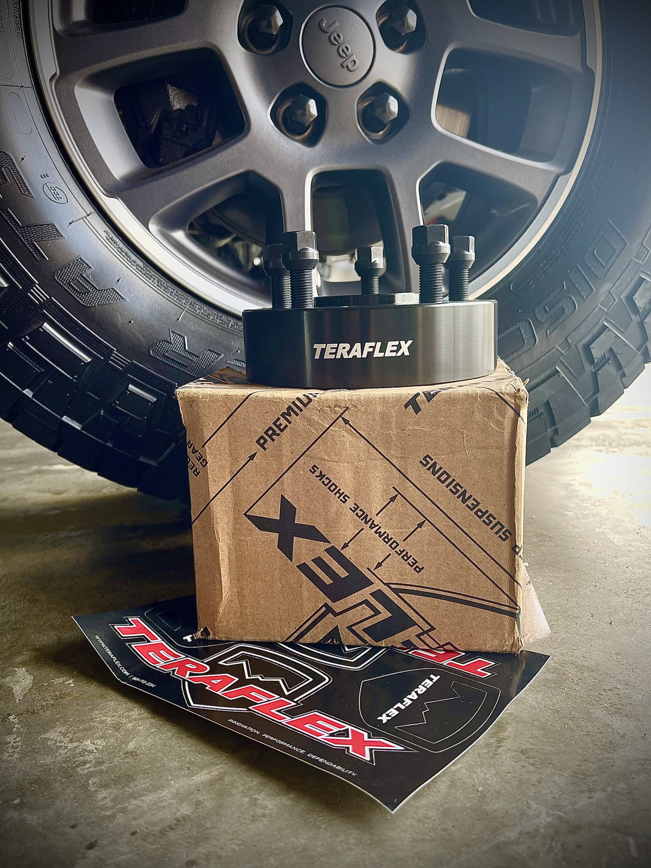

I went with 1.75 inch Teraflex spacers and love them thus far. I knew they would only be temporary. However it's taken me longer than expected to buy my aftermarket wheels. But these have been great for my stock wheels. Poke amount is just right. I'm even basing the offset of whatever new wheels I do get off the same amount/effect. To echo @bleda2002 above, My new wheels I'm trying to stay around a 0 offset for the same effect. Once I get the new wheels of course I'll ditch the Teraflex spacers but I highly recommend them.
I've been wheeling with them numerous times. Nothing against Spidertrax but I've got other Teraflex products and know they're reputable. Plus I try to keep as many of the same brands that I can.
How do you like your Cooper tires? Are they quiet?
Absolutely love them and yes that's actually one of the main reasons I went with them among other reasons. Obviously any AT is going to naturally be quieter than a MT. I believe the Cooper AT3 XLT is quieter than any other AT. I did heavy research on brands before pulling the trigger too.

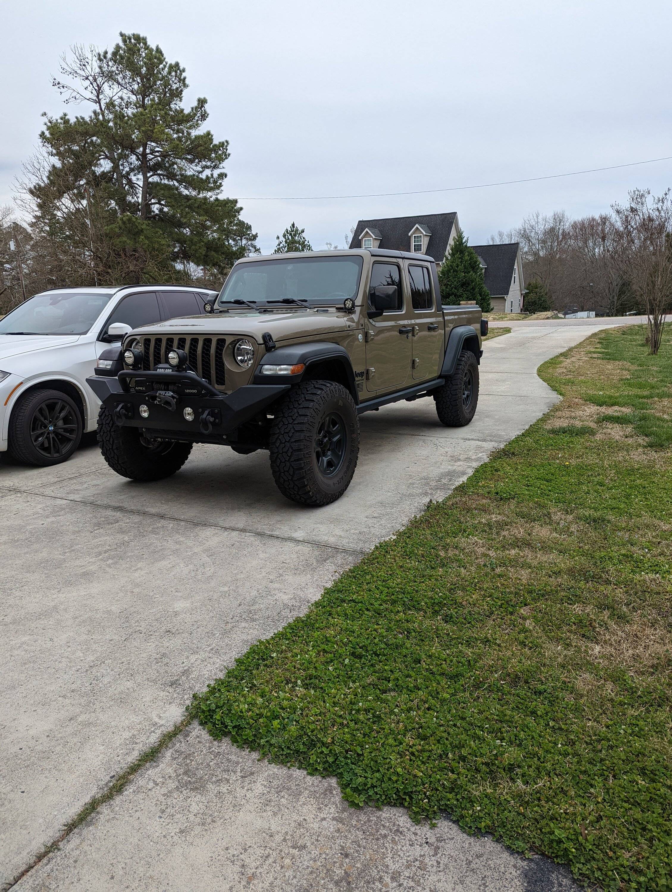

Depends on how wide, a 37 12.5 17 Kanati Trail Hog with no spacers didn't rub on my Max Tow and it didn't rub with 315 70 17 BFG KO2's with no spacers, both on stock wheels full turn both sides.
37's no spacers stock wheels,Ran them like this until I got my new wheels in June, so roughly 4 months
It depends on how you use them though. Full articulation with disconnected sway bar on the trail, and they would very likely rub a lot. I have Mickey Thomson Baja Boss AT’s in 37x12.5x17 on a Rubicon with a 3” lift in front, 4.5 in the rear. Stock fenders and liners. On the road you’d probably be fine.
