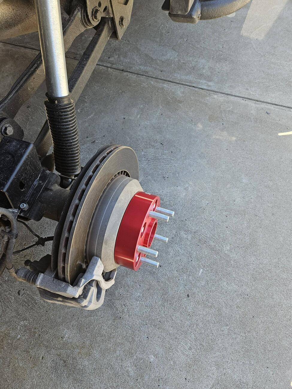

I have a set of Synergy 1.75" spacers for sale. $100 plus shipping. Bottom picture is oem Rubi rims and tires.
Jeep Gladiator Wheel spacers? 1737246289450-4t
Jeep Gladiator Wheel spacers? 1737246356467-k0
