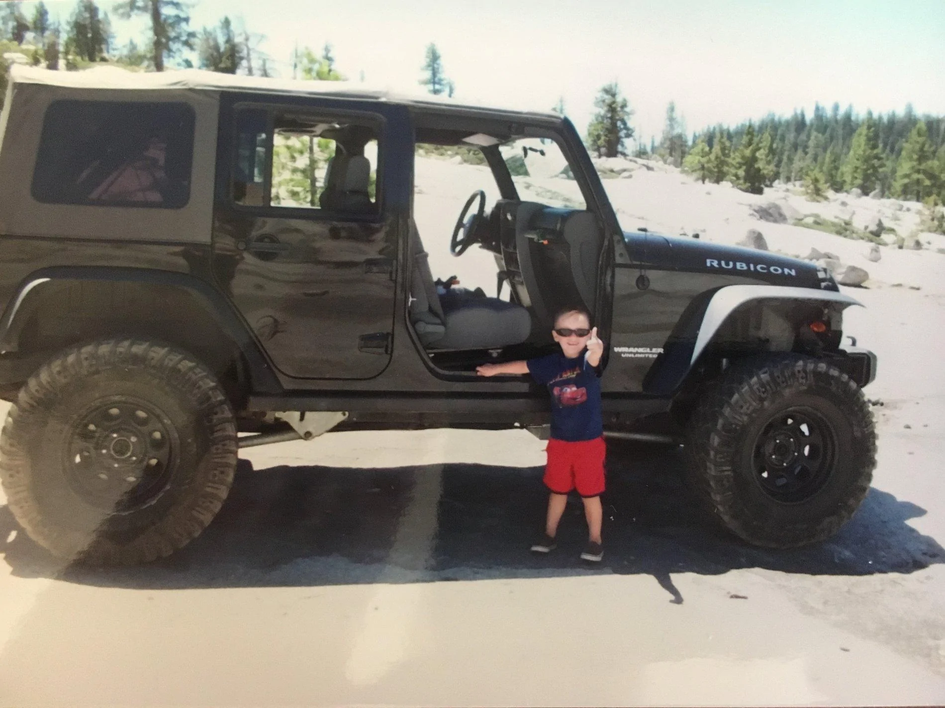

I ran spacers on 35s and on 37s with stock and aftermarket wheels. I’ve always run a narrower wheel, like stock up to 9 inch wide wheels, because it acts like a beadlock to keep the wheels seated at low air pressures off road. I also like low weight because that’s the key to not breaking or premature wear of parts.
I’ve wheeled extreme from coast to coast with spacers with no trouble at all.
As far as brand, I always used Spidertrax but it’s better to get 4 spacers, instead of just 2, at the same price. Everyone can make aluminum spacers with anodized coatings now. It’s nothing special.
Here’s my ‘07 JK on steel wheels with spacers. That was on the Rubicon Trail before they blew up the rocks to make it easier.
