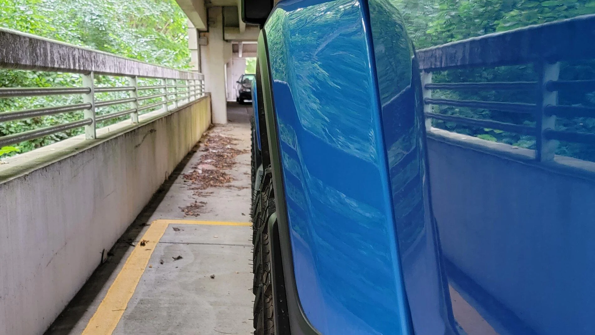

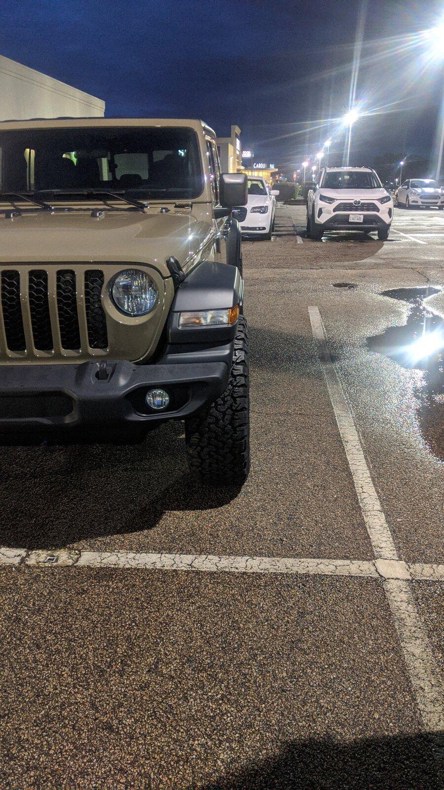

Here's mine. Overland EcoDiesel. No spacers. Stock wheels. 295/70 Yokohama M/T. The sidewall tread sticks out just a little bit from the fender. If you put a 2" tape measure against the sidewall you'll see just how far wheel spacers would poke the tire out. It's actually a big difference. That's why I stayed stock. I might do a 1" spacer one day.

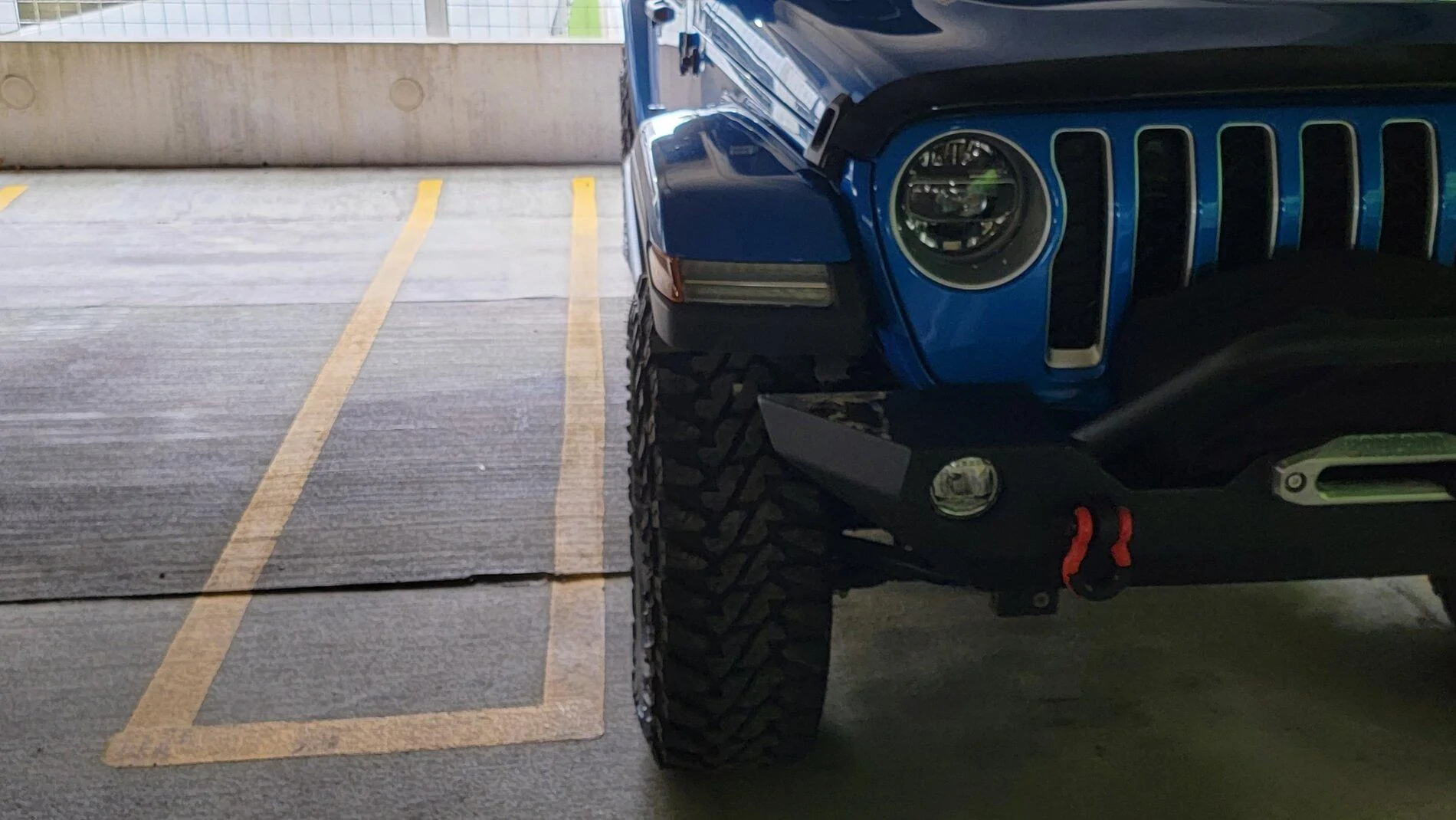

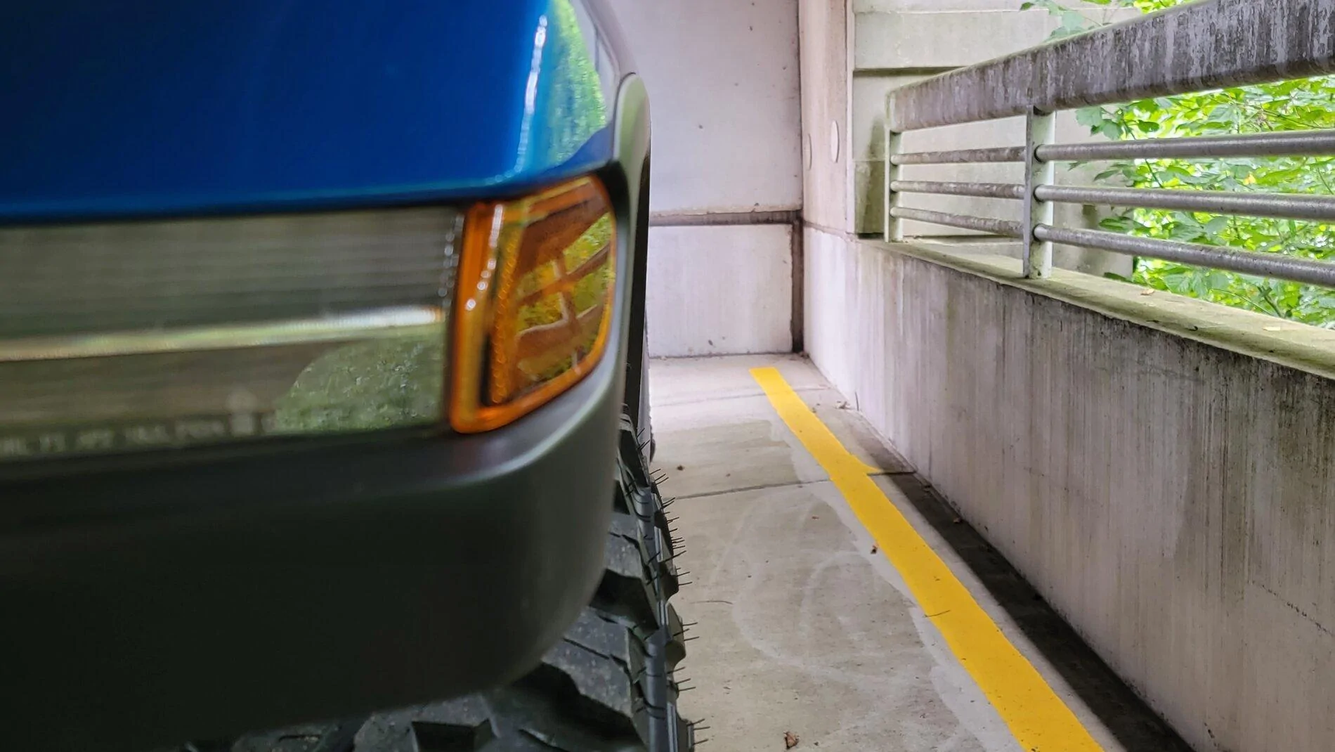

I have 33X12.5 Tires and went with the 1.5" Spacer with the stock overland rims. So far everything is fine maybe a bit too much poke but I love the look without dropping the $$ right now on wheels

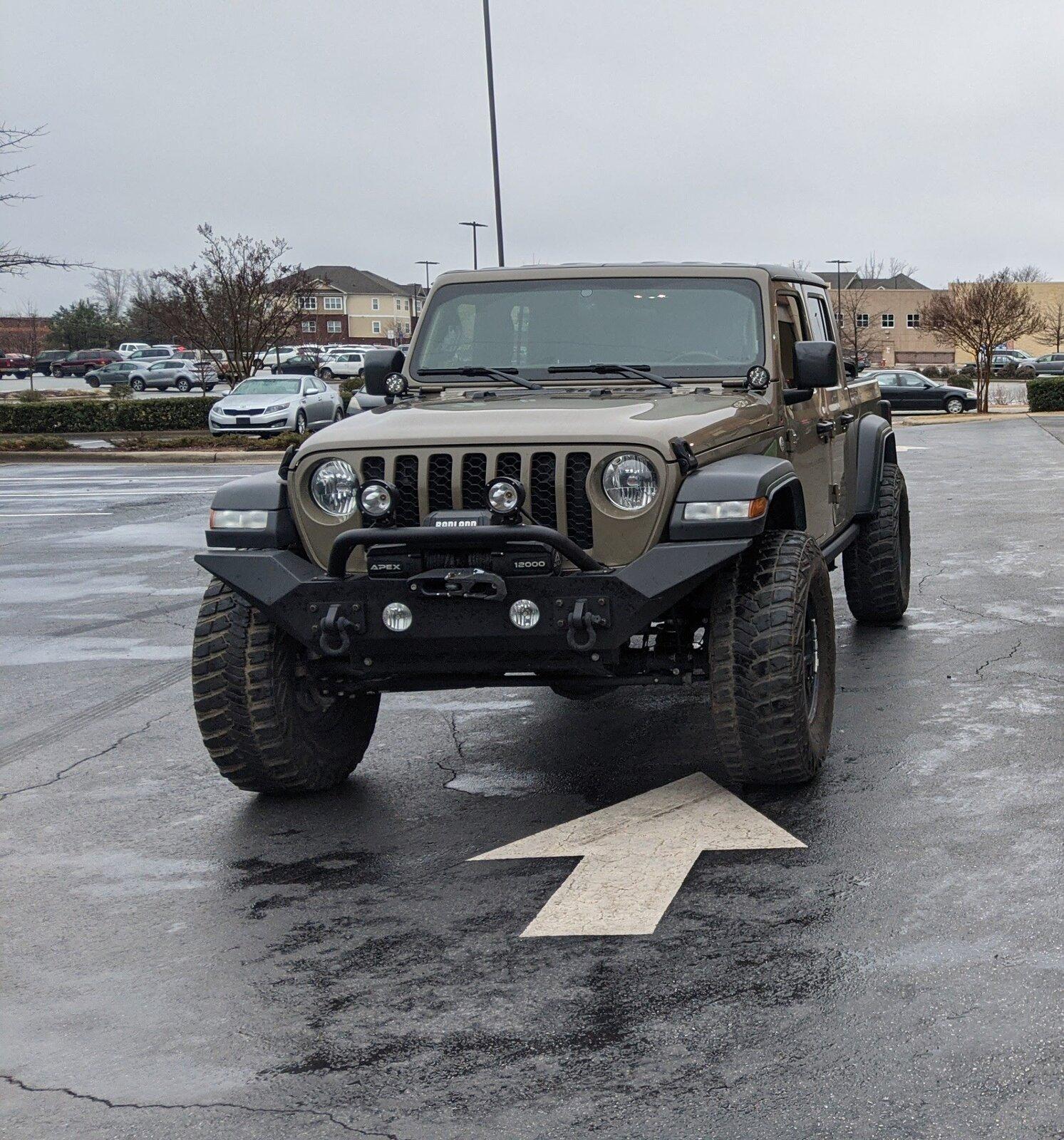

I'll leave this right here, this is the spec sheet for Discount tire. I have 37 12.5 17 tires on 17x7.5 stock steel wheels. Ran 315 70 17 tires before I had these mounted.
Jeep Gladiator Wheel Spacers 86A3DFDC-1A67-4168-BCC1-AB07ADD83F87
37 12.5 17 Goodyear MTRs on 17x7.5 wheels
Jeep Gladiator Wheel Spacers PXL_20210218_222120823~3
Jeep Gladiator Wheel Spacers PXL_20210219_121913843
315 70 17 BFG KO2's on 17x7.5 stock steel wheels
Jeep Gladiator Wheel Spacers PXL_20200913_201537030

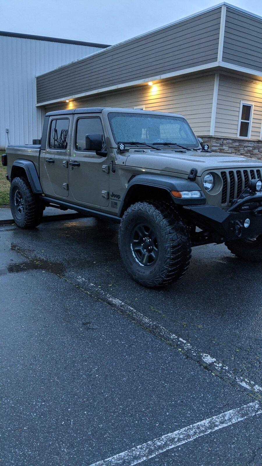

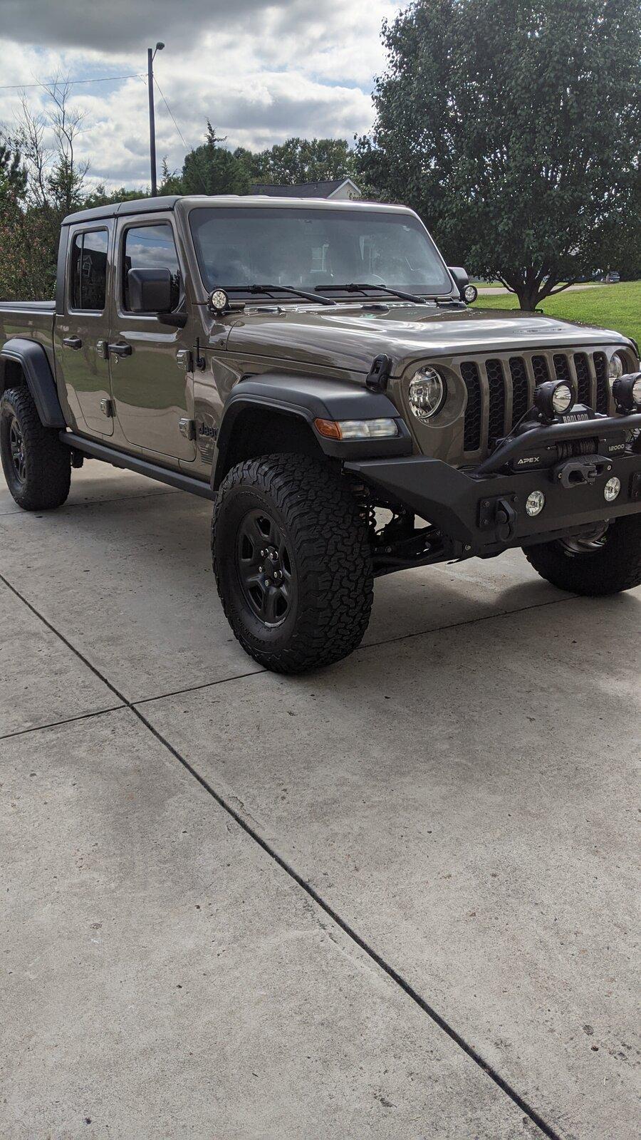

I ran the 315 70 17 for a few days with no lift. On a Rubicon and Max tow and Mojave you can get away with 35's with no lift. Overlands and regular sports you will hi the lower control arms at full lock. I now have Rubicon Takeoff front springs with a 2.5" Readylift SST lift kit that gives you 2.5 in the front and 2 in the rear. I kept the Max Tow springs I'm the rear for towing purposes and to almost level it out. I got about a 1/4" of rake front to back. This is the 315 70 17 with no lift or wheel spacers. On your Rubicon you should be able to do it with no wheel spacers as well and no lift.
