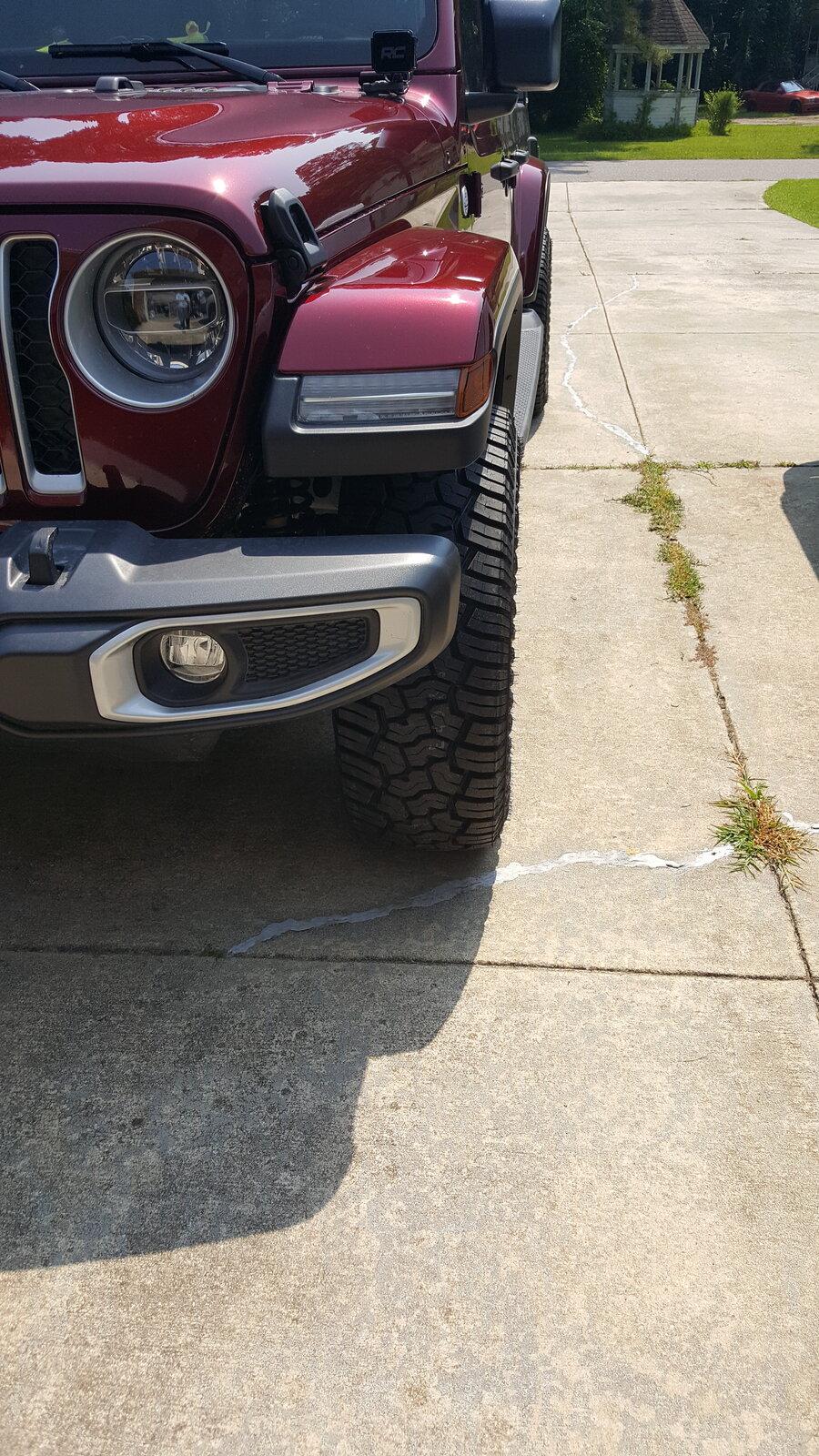

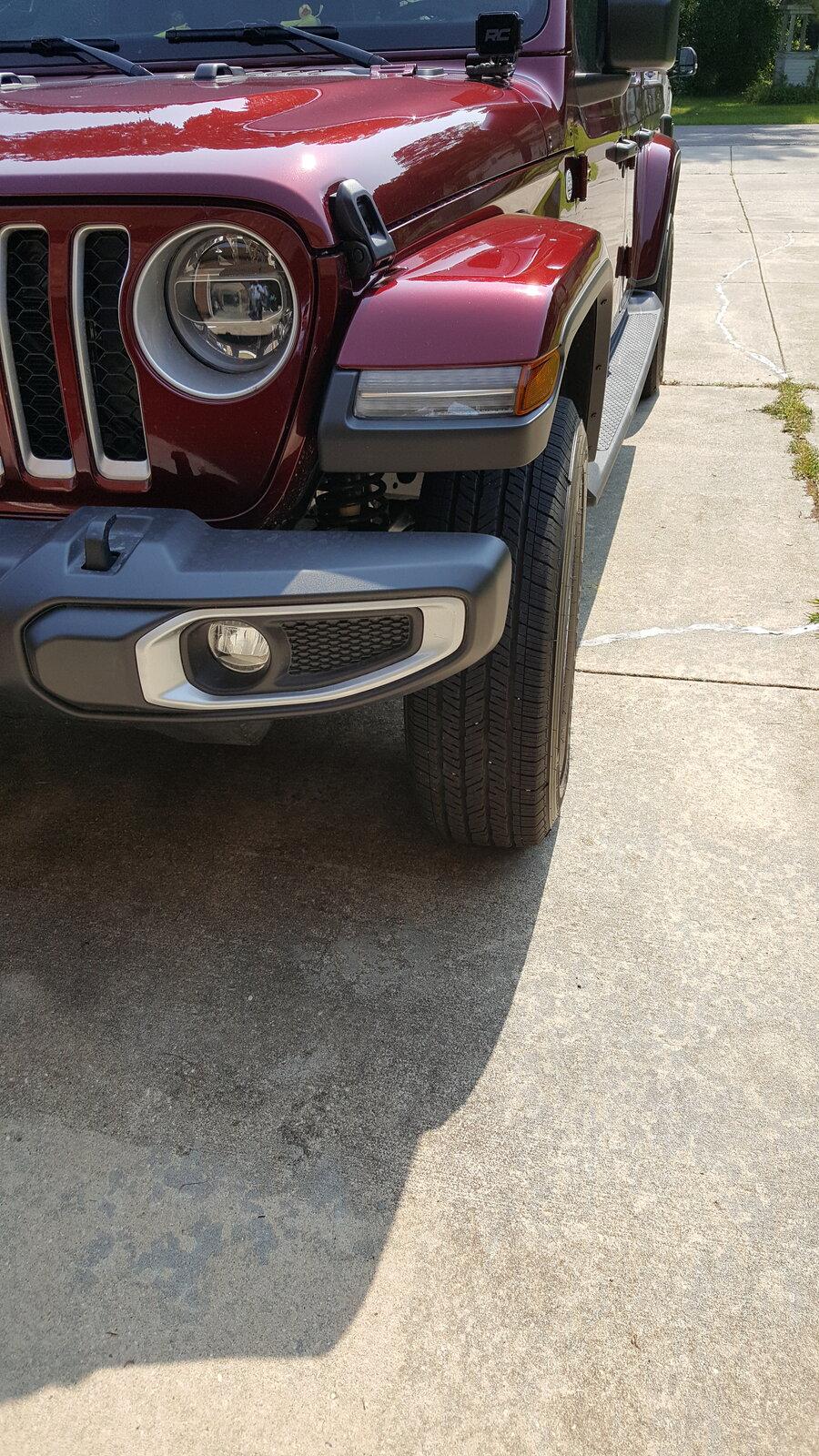

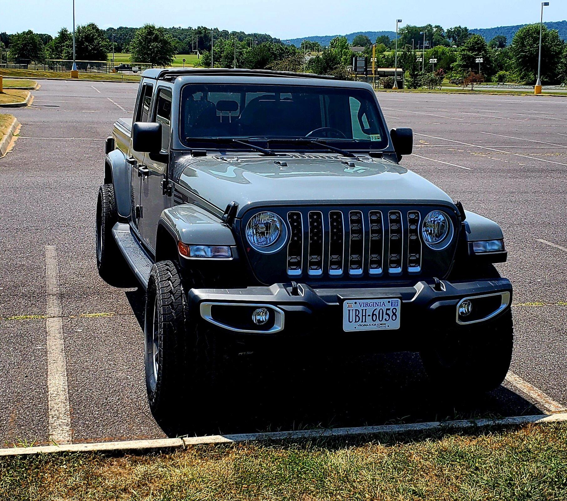

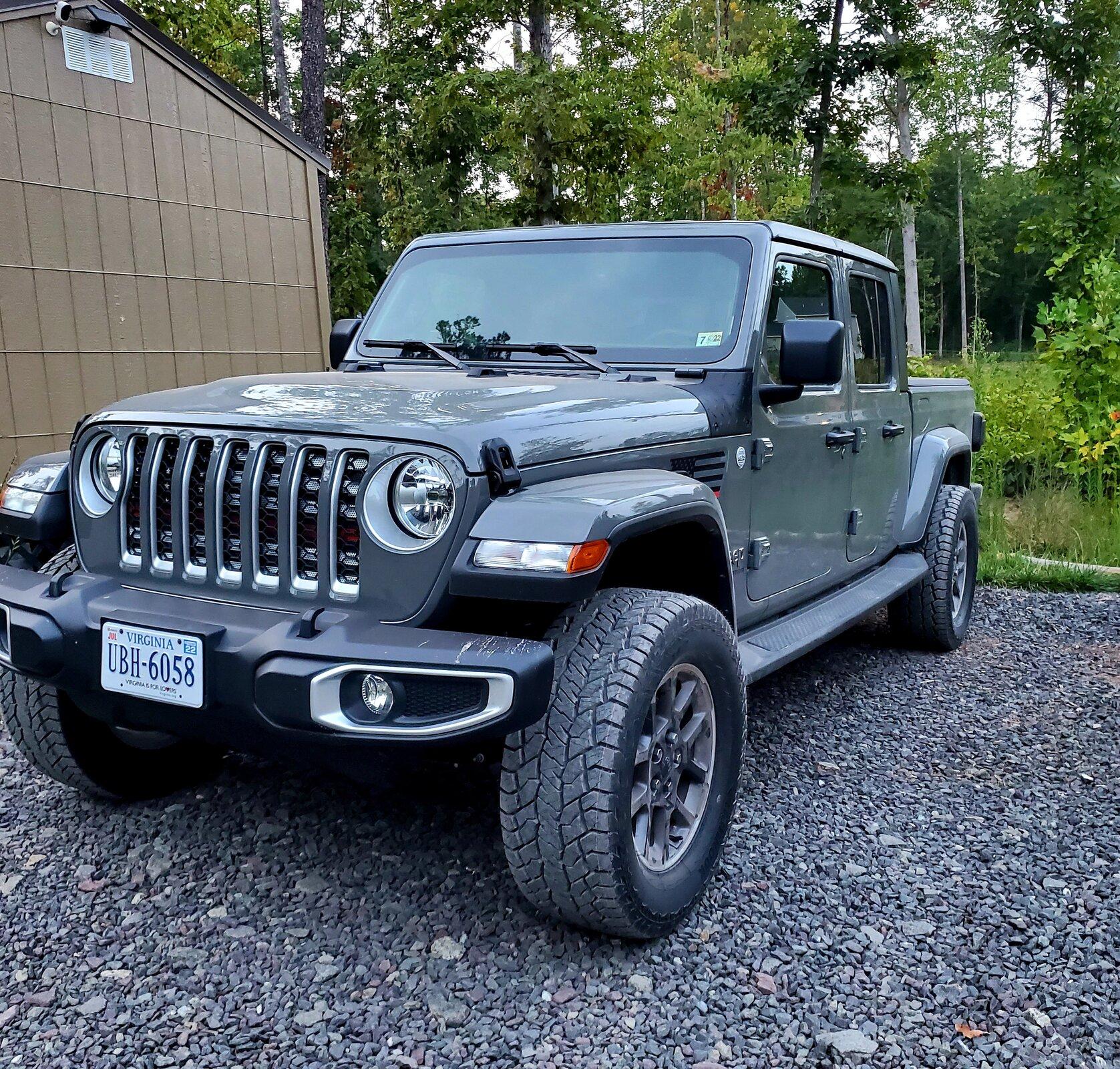

A little before/after with the stock tires vs Yokohama Geolander X-ATs in 33/12.5/18 on stock Overland wheels. No scrubbing, 1.5 leveling kit. I've thought about using a 1" spacer to push them out a bit, too.?
Jeep Gladiator Wheel Spacers 20210724_110803
Jeep Gladiator Wheel Spacers 20210724_102629

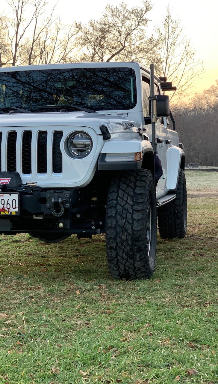

Im the same with most of you on this thread, tend to like the oem wheels or mopar wheels. Reason why I did the mopar slotted wheels on our rubicon with 5.2 backspacing. I really like the the Overland wheels and wished Quadratec would come out with a knockoff like they do the others. I was really concerned though about the 5.2" backspacing with an aftermarket lift which I was definitely doing. My chosen lift recommended a 3.5" backspacing which I definitely didn't want to do. So trying to learn something on the way decided to run 1.75" spacers. Ive been running 295s on our Overland for about 17k miles now and possibly stay with this size or maybe 35s when these wear out. As mentioned before they do sit pretty much flush.

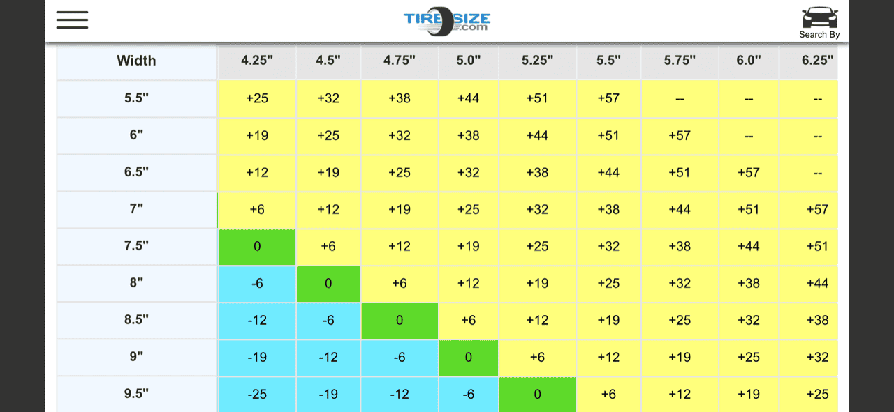

Essentially we have a 6" BS on our oem wheels +44. Adding a 1.75" somewhat gives it a 4.25" functional backspace( O offset) for oem wheel, so that's what I went with. I will post up a couple images of before the spacer and after. with an Overland wheel. And another if anyone is curious if they will clear the fender with a spacer, fully stuffed 295 tire with approx 1" of clearance of the lip. So for sake of info I think I can run easily an 8.5"-9" wheel with a 4.5 BS and possibly do a 35" tire and still clear. Unlike the recommendation from lift manufacturer of the 3.5" Backspacing for Overland/Sport
