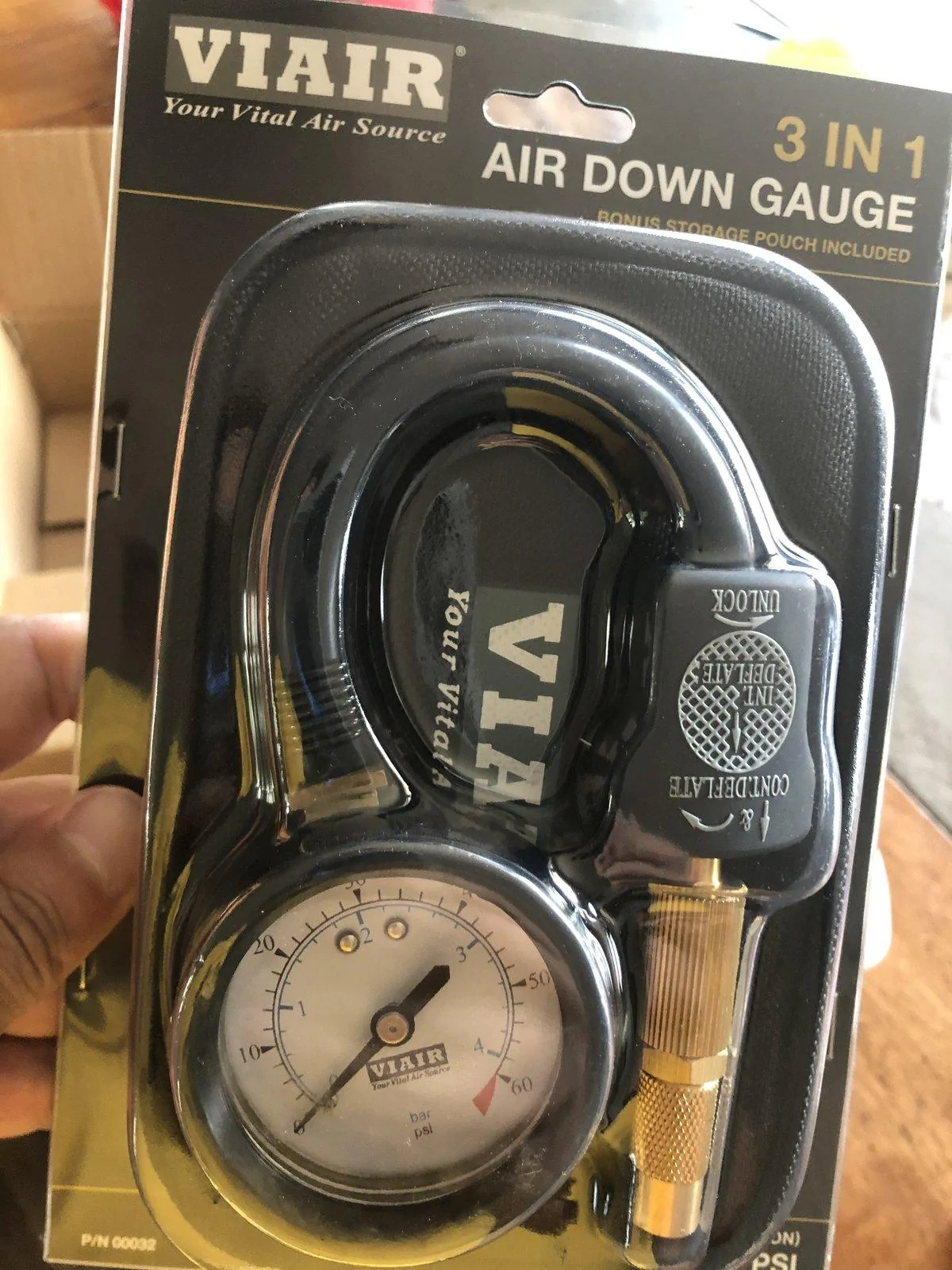

I just picked this up. Figure it will make it easy to set PSI.
Jeep Gladiator When to Air Down, Preferences, Opinions, and Discussion 44734017-2D47-45B5-AD3C-5DF687BC05F4
