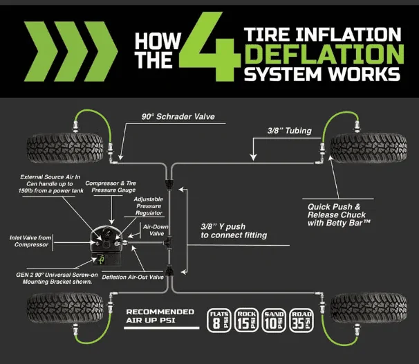

I have been looking at various inflation set ups. Planning on getting the ARB twin ( I know others are cheaper but I have had ARB in the past and never had any issues). I really would be fine with doing 2 tires at a time but am looking at 4 as well. I have seen Thor's Lightning and EZ flate have manifold and line kits. Does anyone have any thoughts on if there is any significant difference between brands? Is there another brand to look at?

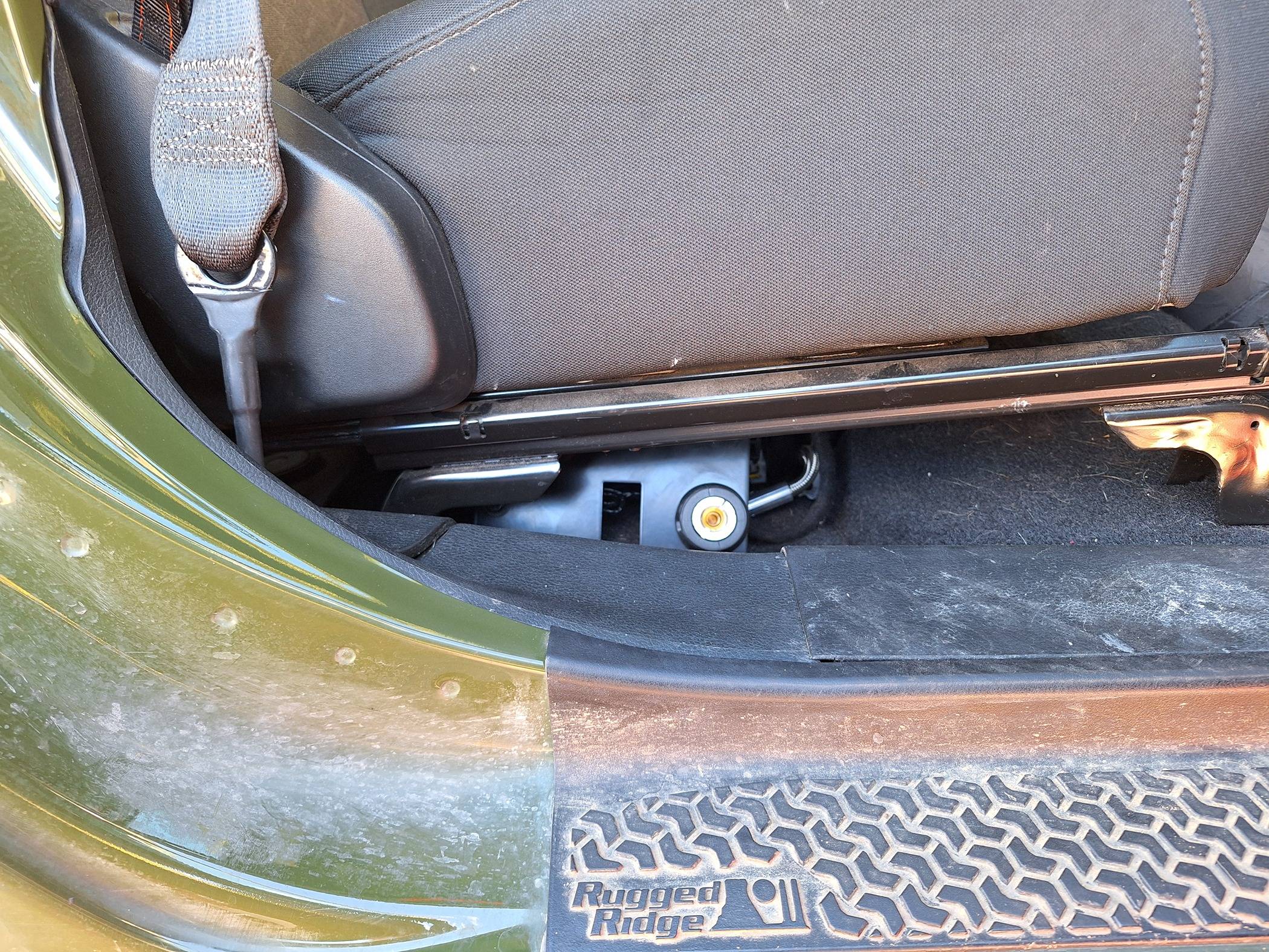

They are all about the same, I use Thor's Lightning and carry their set in both my Jeeps. I went with Thors mostly because they are here in Colorado and they are big supporters of the 4x4 community here. In my Gladiator I have my ARB twin mounted under the front passenger seat and wired to my Aux switches on the dash and added the ARB locker manifold so if I had a front locker to my Mojave down the road I just need to run the airline.

I didn’t feel like typing it all out again so here is the link to a previous post about my inflate/deflate setup.
https://www.jeepgladiatorforum.com/forum/threads/new-jeeper-airup-air-down.71349/post-1167327
Take a minute and read the whole post. Most people don’t realize the physics working against them with these multi-hose systems.
Just need to find and air compressor with the capability to feed a 1/2" outlet into a proper manifold. That's assuming most are running 1/4" feed lines to each tire.
Exactly, that’s where the real benefit will be seen.

Thanks everyone for the feedback. It seems the manifolds and hoses don't have a lot of difference between them. I also appreciate the physics. Wide variety of people on here and never hurts to drop a little knowledge. I think I will go with a 2 tire system for starters and see how I like that. I bought an 813 fabrication bed rail mount second hand, so will be mounting the ARB there. I will post the end result.

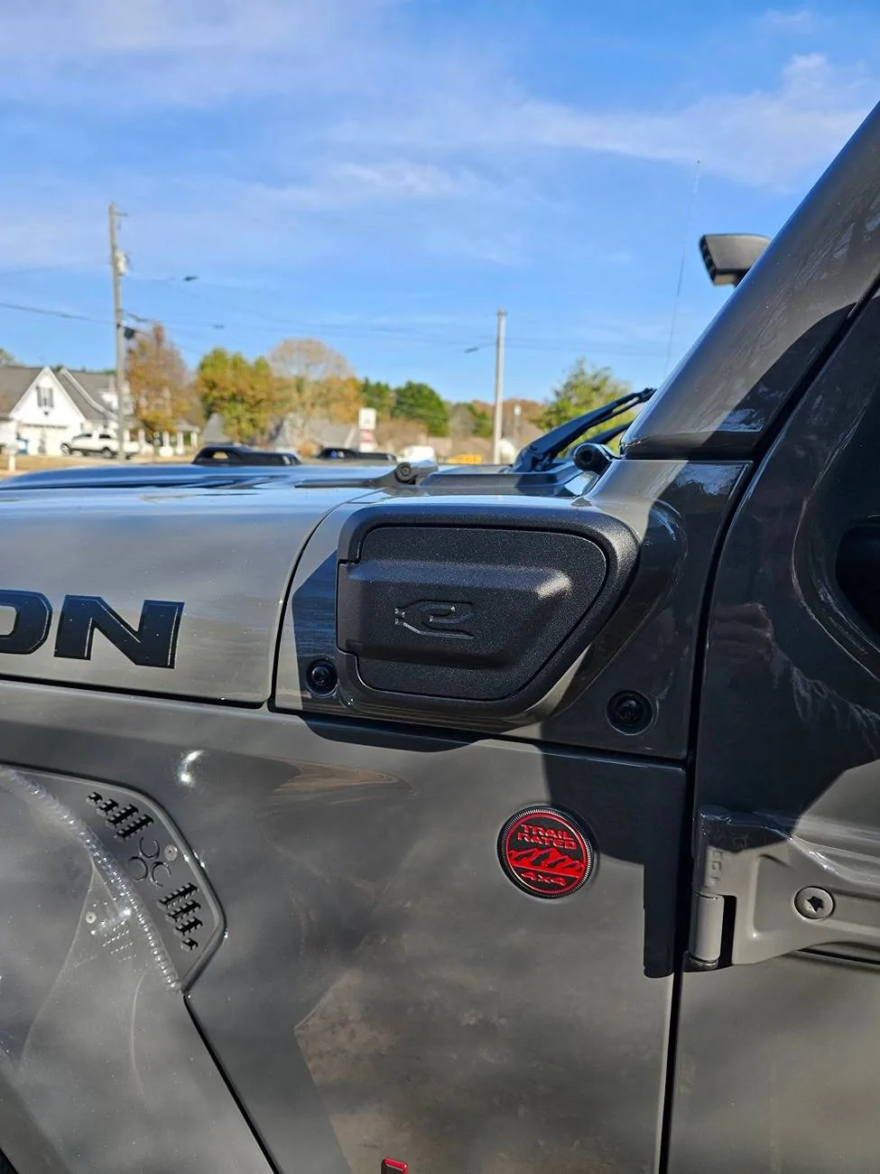

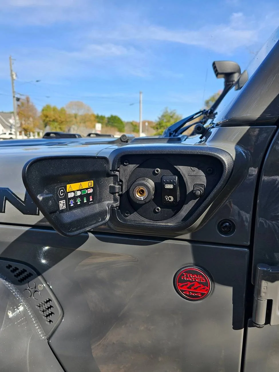

@Cptcoob Only the compressor - My shop mounted the arb twin behind the rear seat (driver's side) using this mount from 813 Fabrication. https://813fabrication.com/products...drivers-seat-arb-twin-single-compressor-mount. Uusally, it's just me and a couple buddies - during air up / down we're outside the Jeep.. so yeah, it'd be a little loud if you were to remain inside.. but it's not horrible. For the air hose connection and on / off switch they used the Grim Offroad 4XE charge port cowl conversion kit. Which I absolutely love - Don't even have to pop the hood.
Jeep Gladiator Multi tire air up/down manifold and lines 20231119_125005
Jeep Gladiator Multi tire air up/down manifold and lines 20231119_124951
