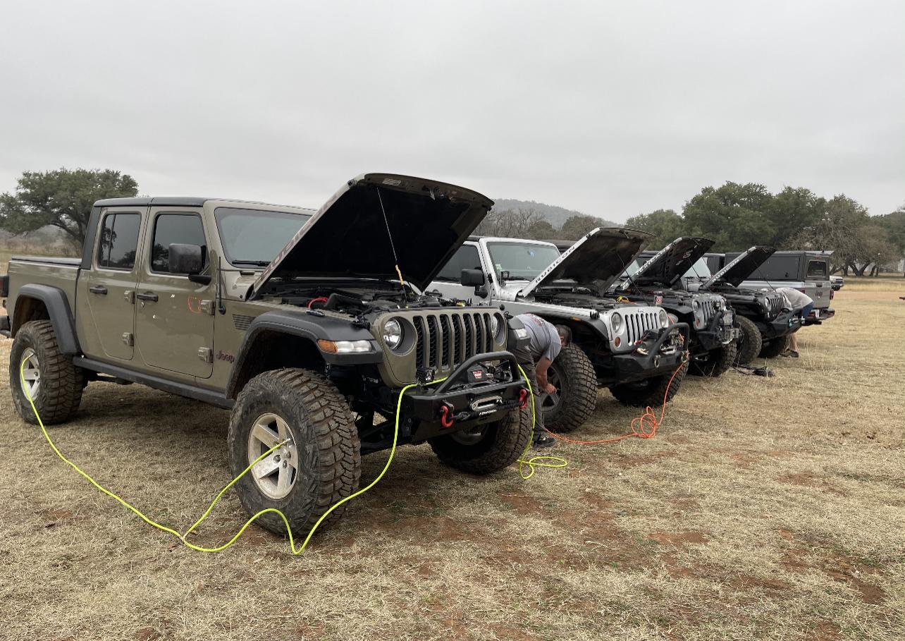

So I didn’t test my new 4 line MORRFLATE hoses on my JT (background) because it doesn’t have the air hooked up yet (this week tho) but figured I’d share. The company was super cool to work with. The lines and kit and bag are all very quality. Zero leaks, easily rolled hoses and stout hardware. Took less than 5min to air my 37s up from varying PSIs. Fronts were both below 5 and above 3. Backs were 8 and 10psi. They all aired up to the same number. I run a dual ARB on this rig.

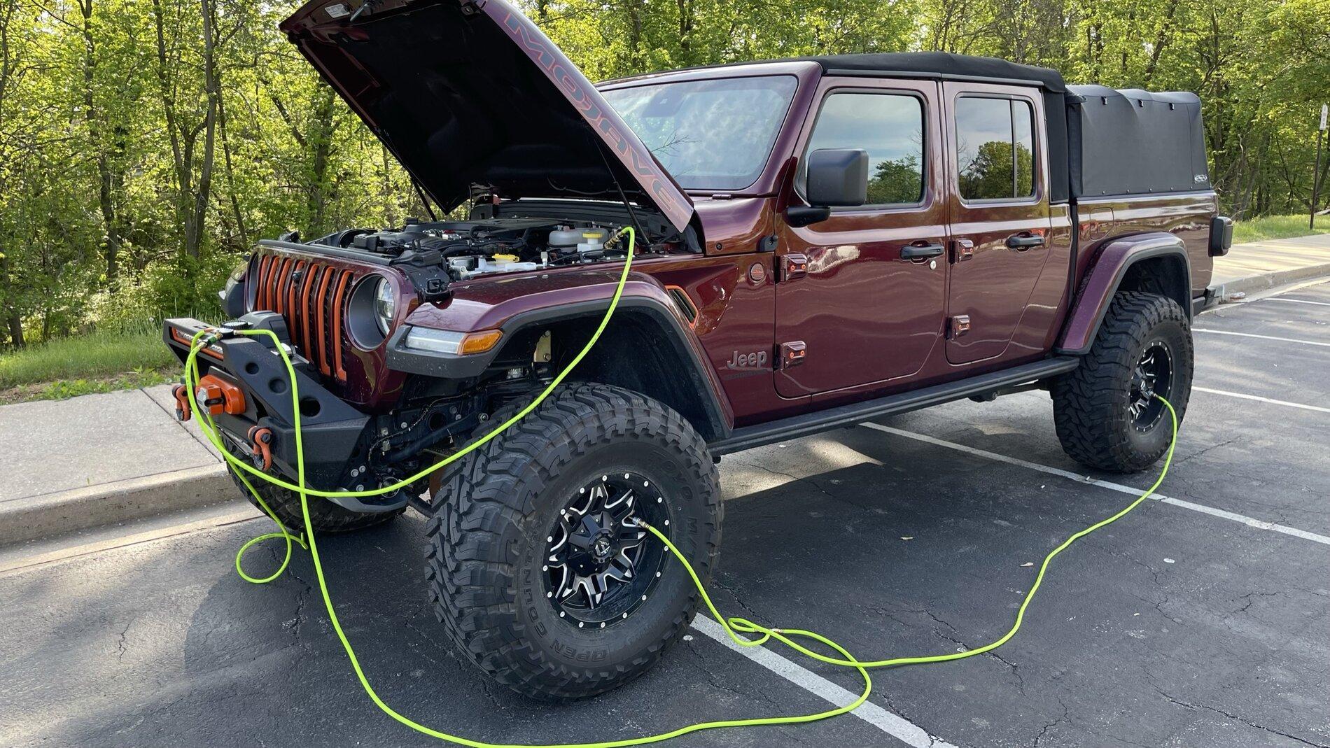

I use it on my JT too.
Jeep Gladiator MORRFLATE air lines 0F4CED0F-2053-4004-AD8F-7556D467B6A6
