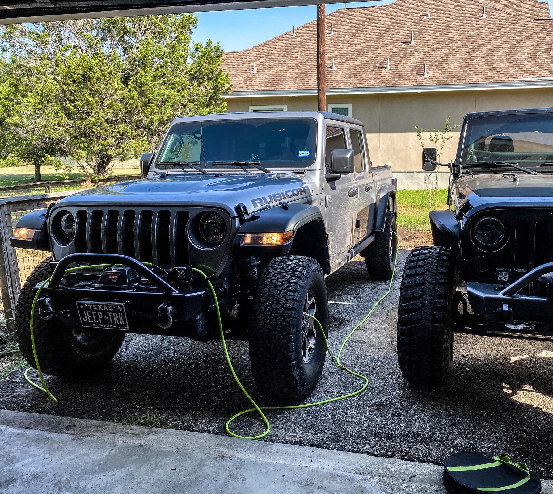

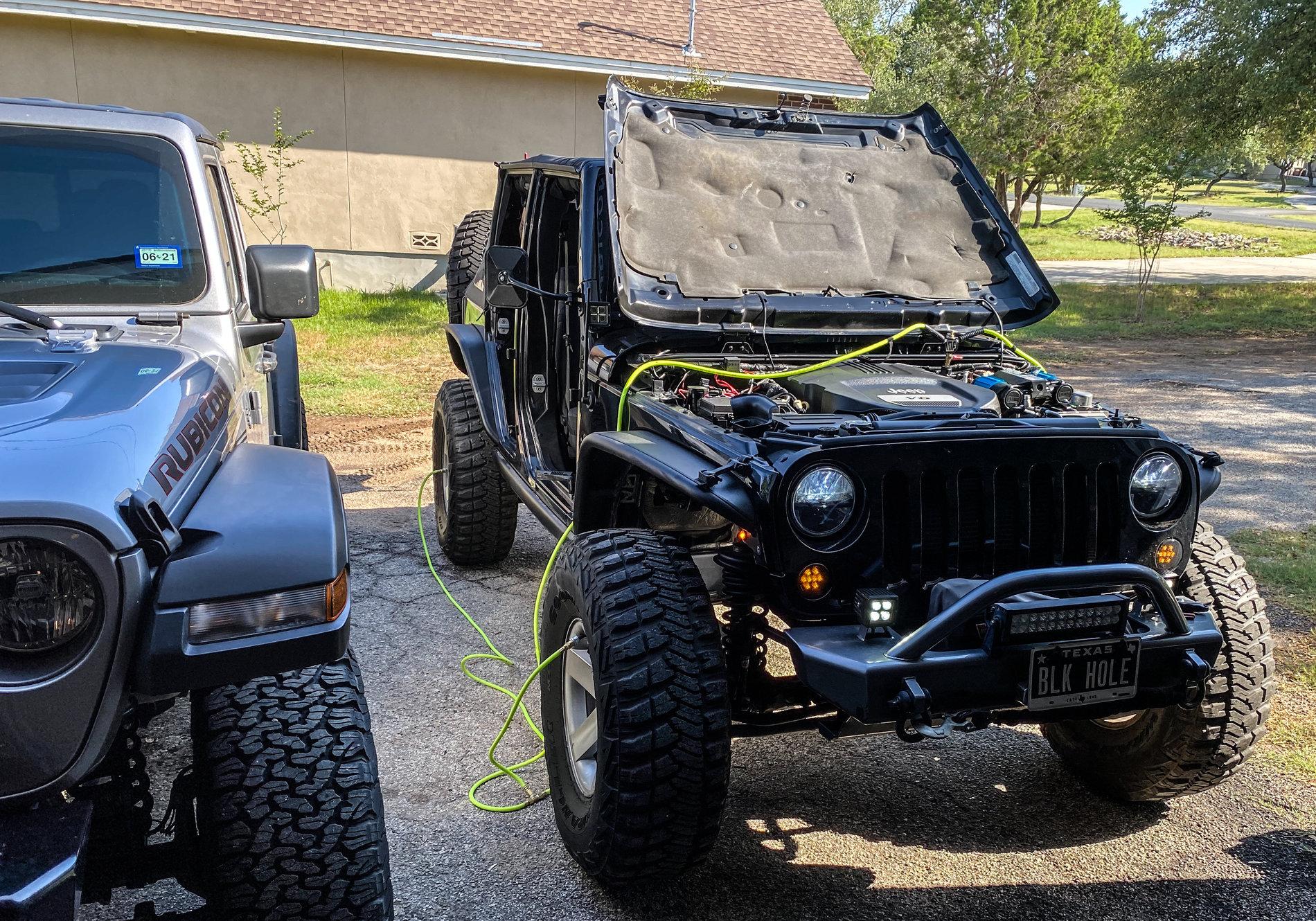

Little testing on my jeeps. Both with 37s, MTr’s are larger 37s however.
Setting up 4-way lines - 1.31min.
Using just the manifold at the coupling. I removed the single valve stem at the air manifold for air down and aired up at the same single location.
JKUR: dual ARB (slightly larger 37s)
Airing down 27-15 - 2:38min
Airing up to 27 - 4:18min
JTR: single ARB
Airing down - 2.52min (weird huh?)
Airing up (actually went to 28 by mistake) - 10:15min.
