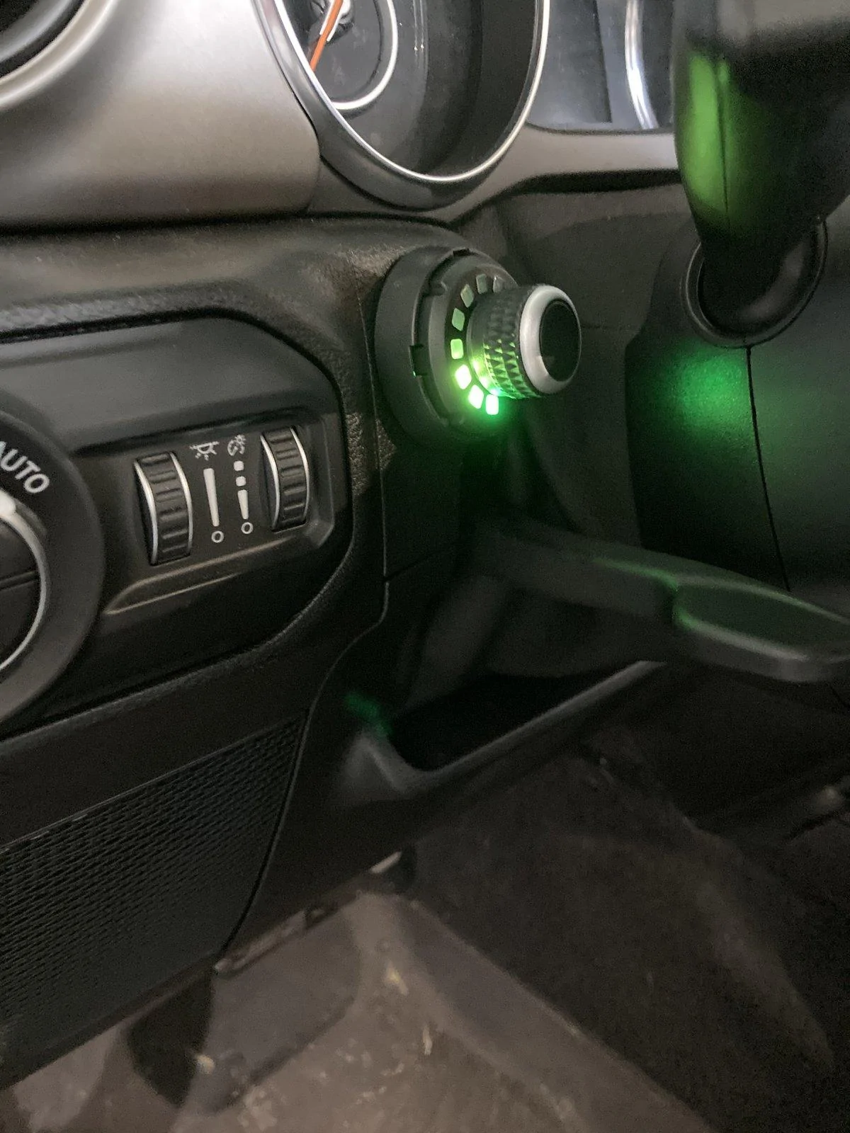

Curt Spectrum here. Control knob mounted just left of steering column, like Odds showed in pix. My controller box is mounted drivers footwell left wall, zip tied to metal strut under there. Very sturdy, out of the way. Factory wiring harness adapter connects up there too, above the ODB2 connector.
So, no cut, no drill, looks nice, works great.

Curt Spectrum as well. To the left of the steering wheel. No holes. Pretty straightforward install.
