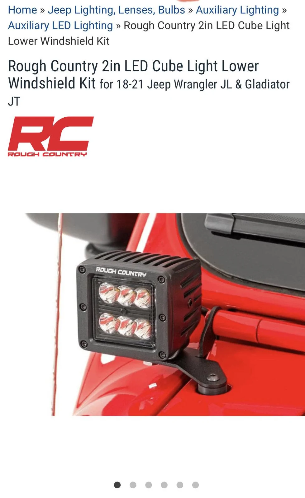

So I just installed the Mopar Aux switches. My first addition is these Rough Country cube lights.
Jeep Gladiator Which fuse? 525F6EBB-9E75-40F8-9C6F-967C611538CF
I feel that using the 15amp fused circuit should be plenty. My only concern is the relay that comes with the lights (which will be cut out) says 40 amp.
Am I missing something?
Thanks

Yes, 15 amp switch is plenty. You are probably pulling less than 5 amps with those LED lights. I am using both the 15 amp switches for my front and back LED spot lights. LEDs do not use much juice at all.

Awesome. Thank you!
