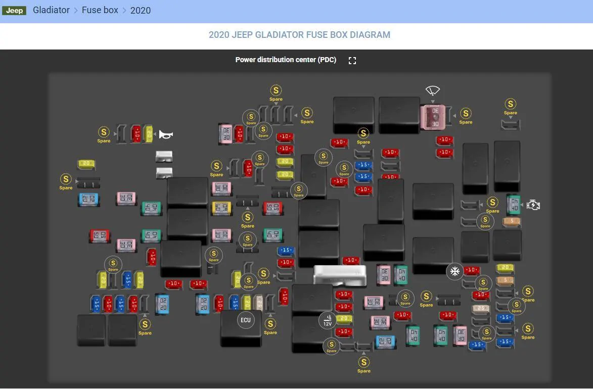

Hello all,
I need help. I have a 21 gladiator and need to know what # the passenger low beam headlight is. All I can find are F26 an F29. Neither indicate what light they operate.

The headlights don't have separate fuses. You have fuse 26(40A) and 46(10A) that supply power to the BCM, which in turn sends power via internal relays to the headlights when commanded by inputs from the headlight switch.
The BCM circuitry will detect and report any circuit faults with the headlights, so check for codes.
