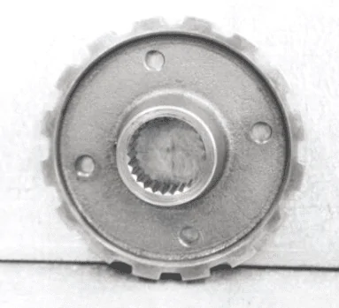

You may think you're parked on flat, level ground. But if the JT rolls forward or rearward after you put it in park, then the parking pawl is not fully engaged.
Then when you start the JT it can lurch until it hits the parking pawl.
The parking pawl is actually the weakest link in the whole safety part of starting an automatic transmission and they can and will fail.
I was taught eons ago, come to a complete stop, with vehicle still in gear apply parking brake, then put vehicle in P. This locks everything in place for when you start, plus if the pawl does break, the vehicle will still be there when you get back.
But to not engage every time?
I can see once in a while, especially if the driver is the sort that touches the brake only long enough for it to crank, then lets off, but the odds of park failing to engage every time is pretty slim. There's nothing to make it want to move other than the viscous action of fluid between the shafts in old-skool transmissions, likely eve less in these. No clutch packs, no bands, engaged to make it want to move.
I am wondering about a true fault with the transmission.
