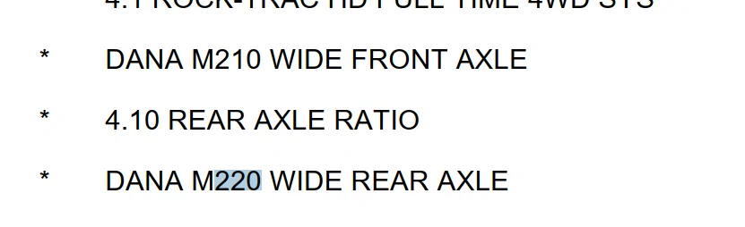

This is from my build sheet - an Overland which does not have the "wide axles".
All rears under these are M220
Jeep Gladiator Wider axle Q's ?? 1693787874908
The build sheet would say "wide" if they were wide.
This is from our JLU Rubicon - note it has the same axle numbers but says "wide".
The 220 and 210 are ring gear diameter.
Jeep Gladiator Wider axle Q's ?? 1693787951436
