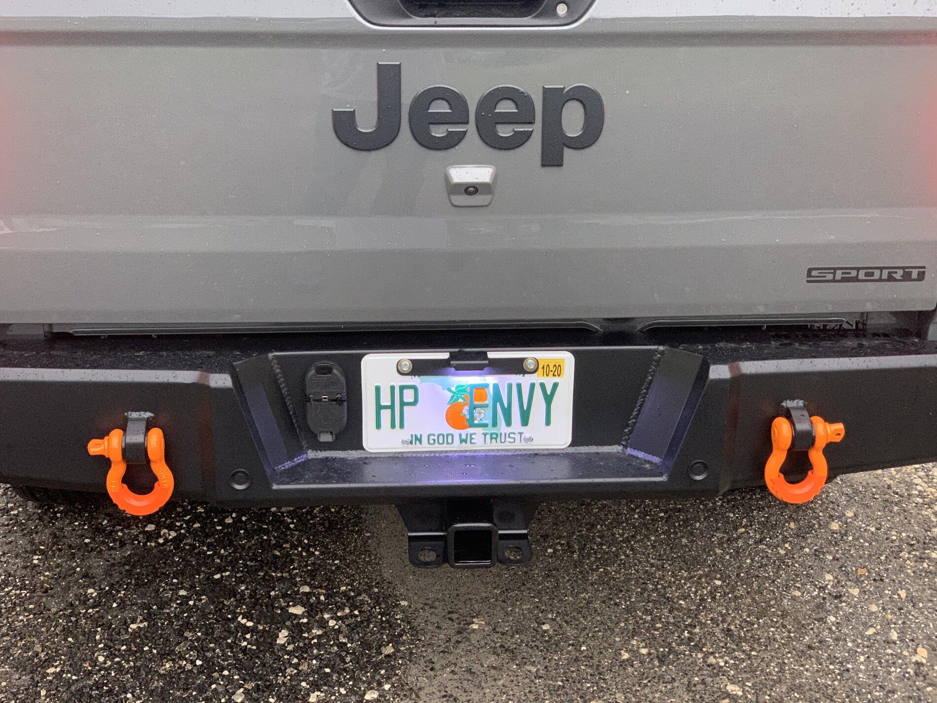

I’m sorry I can’t say 100% one way or the other, but I don’t think it’s going to work. I replaced my OEM hitch and added the Magnum rear bumper after being rear-ended.
It looks like the Kurt hitch bolts will hit the Magnum bumper step. It’s close to the same shape as the OEM plastic bumper but not the same. I posted a pic in case that helps.
Jeep Gladiator Will Curt hitch receiver work on aftermarket rear bumpers? AA0FFFD0-6526-4277-A003-E022E601E969
Deleted member 30519
So you have the oem receiver on with the magnum bumper in the picture? I guess that's my only option then. I wanted to save some money vs the Mopar one but If nobody knows for sure then I don't really wanna deal with the hassle. Thanks
