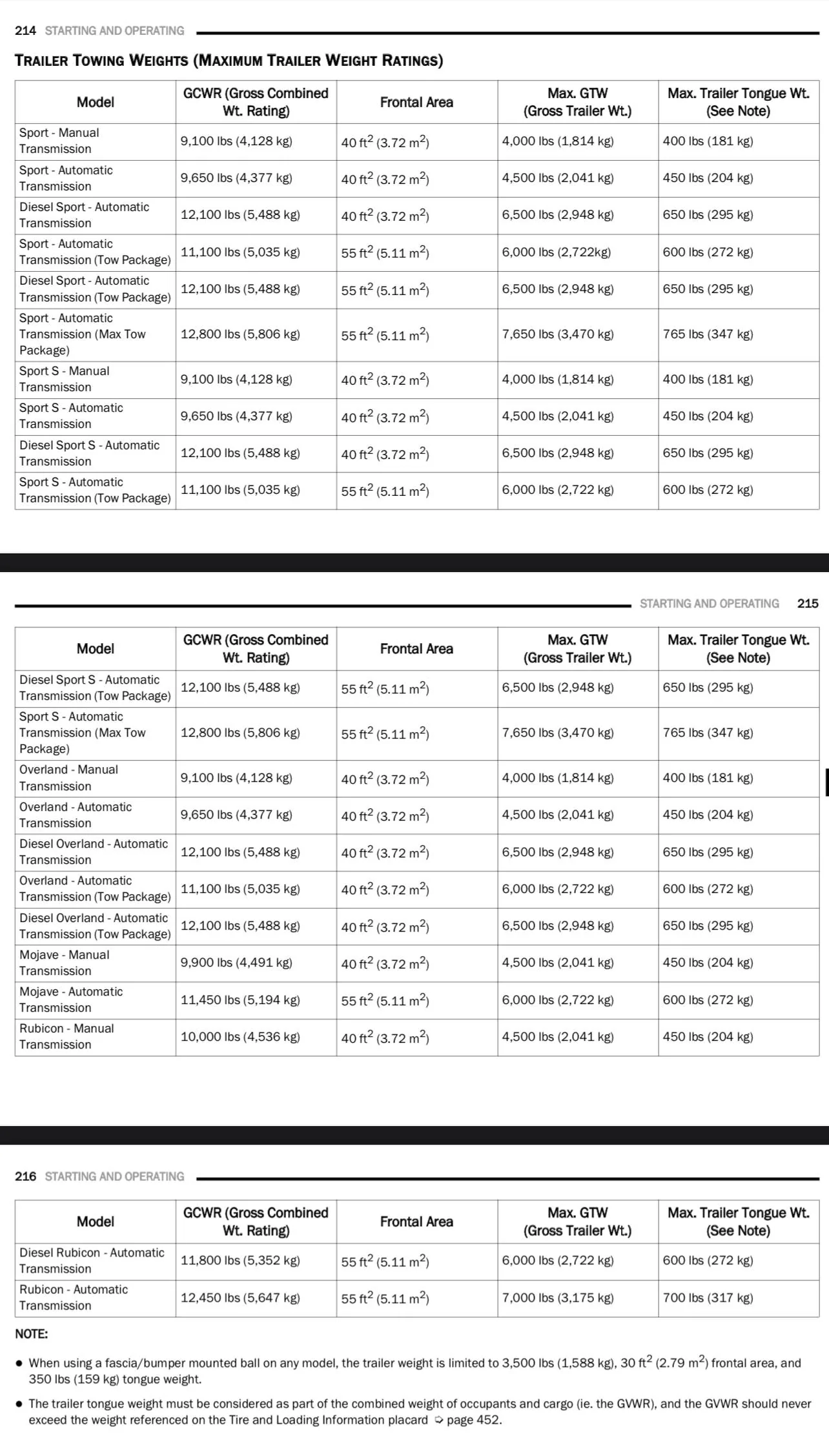

And then some future owner puts 6,000 pounds with 600 pound tongue weight and..........
I'd not use a WDH on the curt, Why limit yourself?
I pull 5,000 pounds fine - but I'd not do it with a Curt vs. the factory hitch.

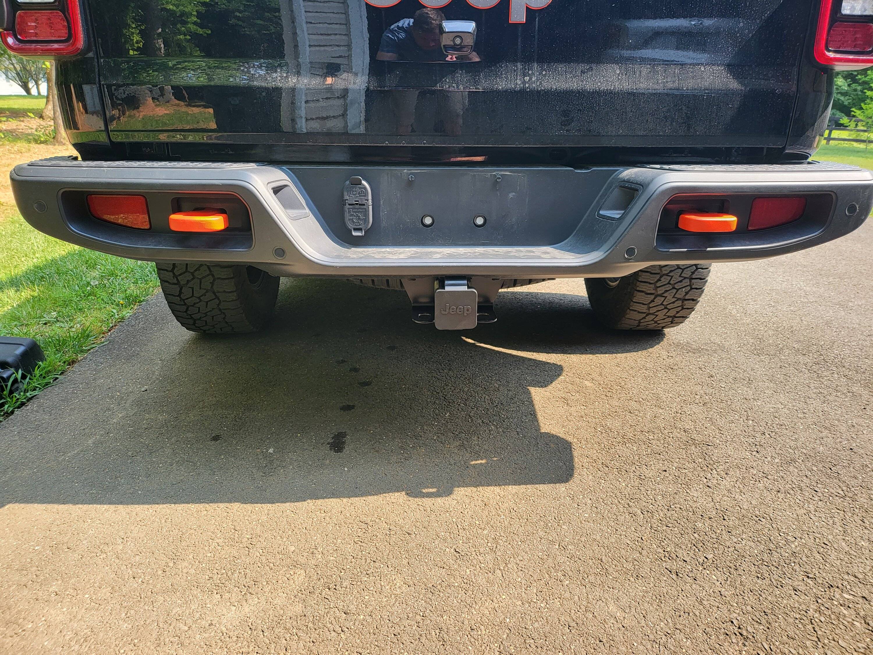

So after reading the comments here and some more research I went ahead and ordered the OEM hitch. Got it installed today and overall really easy! For the extra 130 bucks I feel I got a better setup and probably easier than the Curt since I didn't have to deal with the higher torque specs on the hex bolt.
