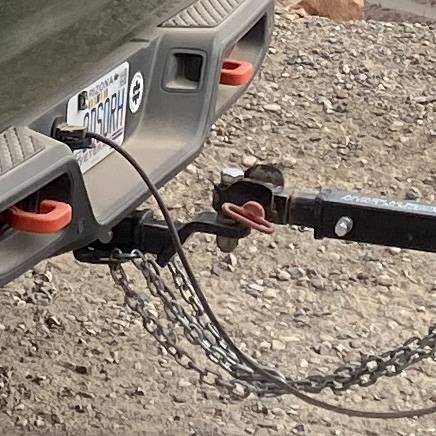

On my JK I had the hitch flipped down but I had to flip it up for the JT. You’ll have to get a hitch with an open hole so you can bolt on the coupler. The trailer end slides into the coupler and a pin secures it. Here’s what mine looks like.
Simple enough. Do you swap back to the 2” ball coupler when you get back to the road?

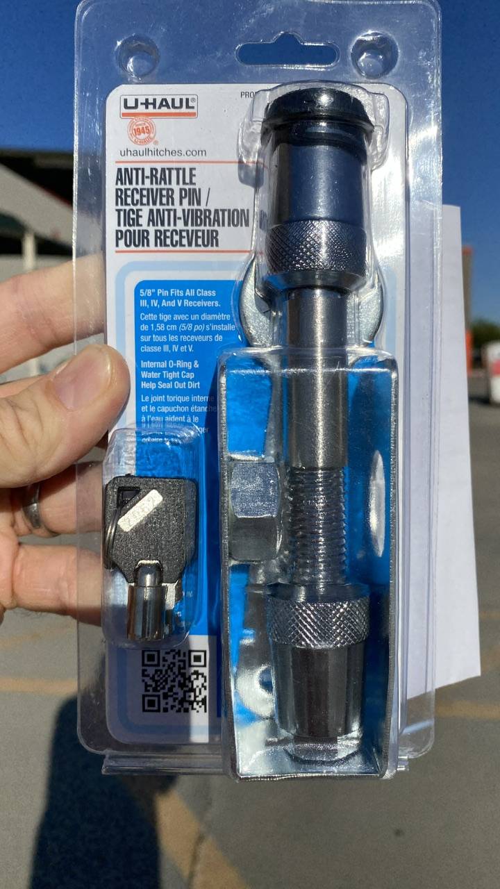

Nope. This is all I use. There’s no play in it so it tows great. I also use these to keep the connections tight. I get them at my local Uhaul.
I use the bolt lock system on everything, so it would be tough to switch, but I don’t have much of a play problem thankfully.
