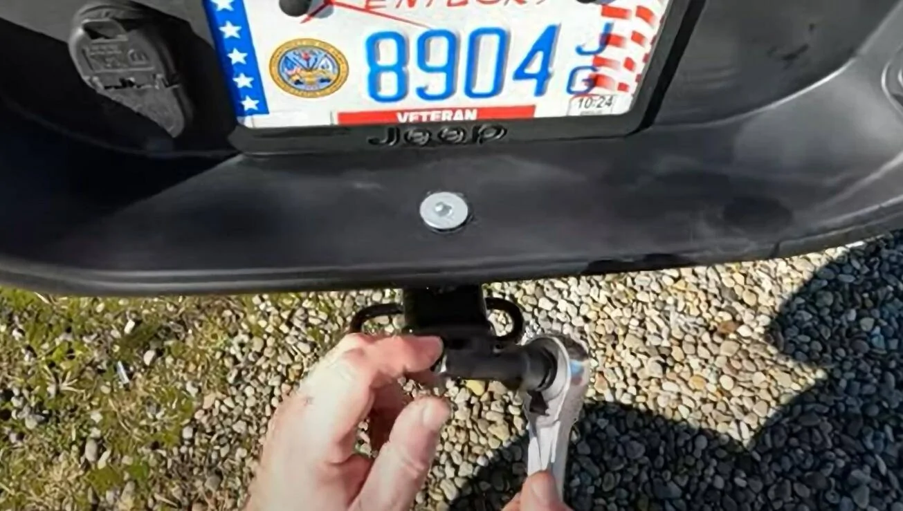

Far as I recall, that hole Curt has one drill through the bumper is just the plastic covering to get to that cross member hole. There is nothing extra structurally with the Curt instructions. Even the guys at Etrailer.com talk about in their install video for the Curt video mention both methods of either drilling the hole through the bumper cover or removing the bumper for install with the latter being their method.
https://www.etrailer.com/tv-Install-Curt-Trailer-Hitch-Receiver-2020-Jeep-Gladiator-CU74FR.aspx
Yes you are right again. That hole is a short cut to access the main bolt that mounts to the cross member. The hole is ugly, fills with dirt snow and ice.
One thing I do NOT know is..... the curt is rated for 5000 tow and 500# tongue weights. What is the class 4 or the one piece (best way) rated at???????
I do not tow with the gladiator. I got this for cargo, flags and small trailer so it's all i need. Not to mention heavy frequent towing will kill or gladiators pre maturely. At least that is what the service manager told me. I live in a very hilly stop and go terrain so towing is work here.

I'd suggest some critical thinking - and thinking beyond this single receiver device..........
The BUMPER and the CROSS MEMBER are made in such a way you can use a hole saw to cut through the plastic cover, and insert a TYPICAL 2" trailer ball - which has a 3/4" shank (pulling from memory and decades of towing)
You can use that hole saw, cut the plastic cover, slip the shank of a 1 7/8" or 2" ball through the hole in the STEEL of the bumper and the cross member.
When you install the ball, it's attached to the bumper and the cross member.
This receiver does the same thing - unless you are Hootbro ;) - uh, I mean, Red Green, and ignore the directions and do it your own way (sounds like a song there)
The head of the bolt that Curt furnishes DOES clamp down against the steel of the bumper.
The hole in the bumper steel is NOT large enough for the head of a 3/4" bolt as Curt supplies to GO THROUGH.
It clamps the bumper steel and cross member into a sandwich. Thus, some people talking about needing an extra washer.
The sandwich is:
Bolt head/bumper steel/cross member/Curt receiver.
The receiver is threaded so you literally clamp the bumper and cross member together as a UNIT - if you follow Curt's directions.
if you do not follow their instructions/directions and instead you remove the bumper, then it's bolted only to the cross member.
All one has to do is keep in mind these are designed to use a BALL on the bumper and the rest explains itself if one is capable of critical thinking.
There's no way in hell the head of that bolt Curt furnishes will go through the small hole in the steel of the bumper. Think on it for a bit.
The ball creates a sandwich as well -
the base of the ball/bumper steel/cross member, lock washer and nut on the 3/4" ball shank.
The Curt receiver does the exact same thing in a sense, thus their use of a 3/4" bolt.
It's a perfect fit for the 3/4" hole in the steel part of the bumper!

You can take your bumper off because you didn't follow Curt directions. It's that simple. That's why you and Hootbro can pull the bumper.
If you bothered to read the Curt instructions and look at one installed according to those directions, there's no way to pull that bumper off.
You can install according to Curt - who made the bloody damned thing, or according to third party vendors.
According to Curt - it DOES bolt to the bumper. I will bet anything you've never bothered to look at a by the book installation.
So I guess you are lacking critical thinking abilities. And you ignored the photos of a Curt install I posted. Bet you didn't even READ the PDF file.
I'll take my fabrication skills and towing experience up against yours any day - come on over.
Installed using the PDF instructions - no way in hell to remove that bumper.

Wow, beginner just can't think through how that thing bolts together or see the bolt head clamped down against the steel of the bumper. it's pretty obvious.
Yes, if you use the youtube videos, you remove the bumper and thus can remove the bumper. DUH! Geesh.
But if you use OTHER youtube videos and the INSTRUCTIONS, it's bolted TO the bumper.
Tell me that guy can pull that bumper off right now.
I'll bet you have not read the instructions or even looked at the photos as you are convinced and refuse to see another possible side - Curt's installation method.

I did point out there are two ways, that's why he can take the bumper off and THEN it's not bolted to the bumper.
The other way, by the PDF, it IS bolted to the bumper.
I clearly said one way it is not, the other way it is, but he still said no it's not, period. His way, no it's not. Curt's way, it is. So I was saying both.
(there are as many videos showing cutting that plastic as there are showing bumper removal)
You can pull the bumper off and the receiver isn't bolted to it.
That's one method.
His isn't the only way but he basically said it was.
HERE is exactly what I said (you can have it both ways) ->
t does if you follow Curt's directions, posted here.
It doesn't if you use youtube videos.
Some of us are going by the directions from Curt - some follow QT as they don't read paper directions. Some make their own choices and don't need instructions or videos at all.
But the technical reality is - according to CURT, it does indeed bolt to the bumper AND cross member.
If you don't follow their directions, it doesn't.
There - now you can have it both ways.
Some prefer not to bother removing a bumper, and make it simple and follow this PDF, and then put a plug over the bolt so you don't see it.
You can have it both ways.
