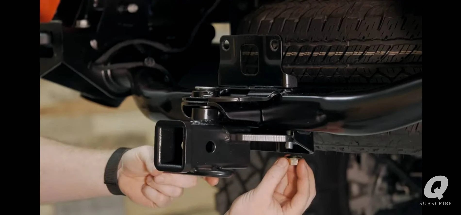

Bolts to cross member not bumper itself.

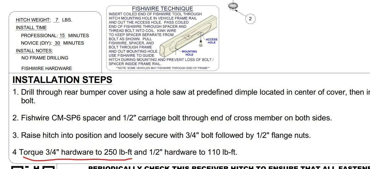

Look at this picture and tell me that bolt isn't secured to the bumper - this is the CORRECT way, not your Quadratec messed up method.

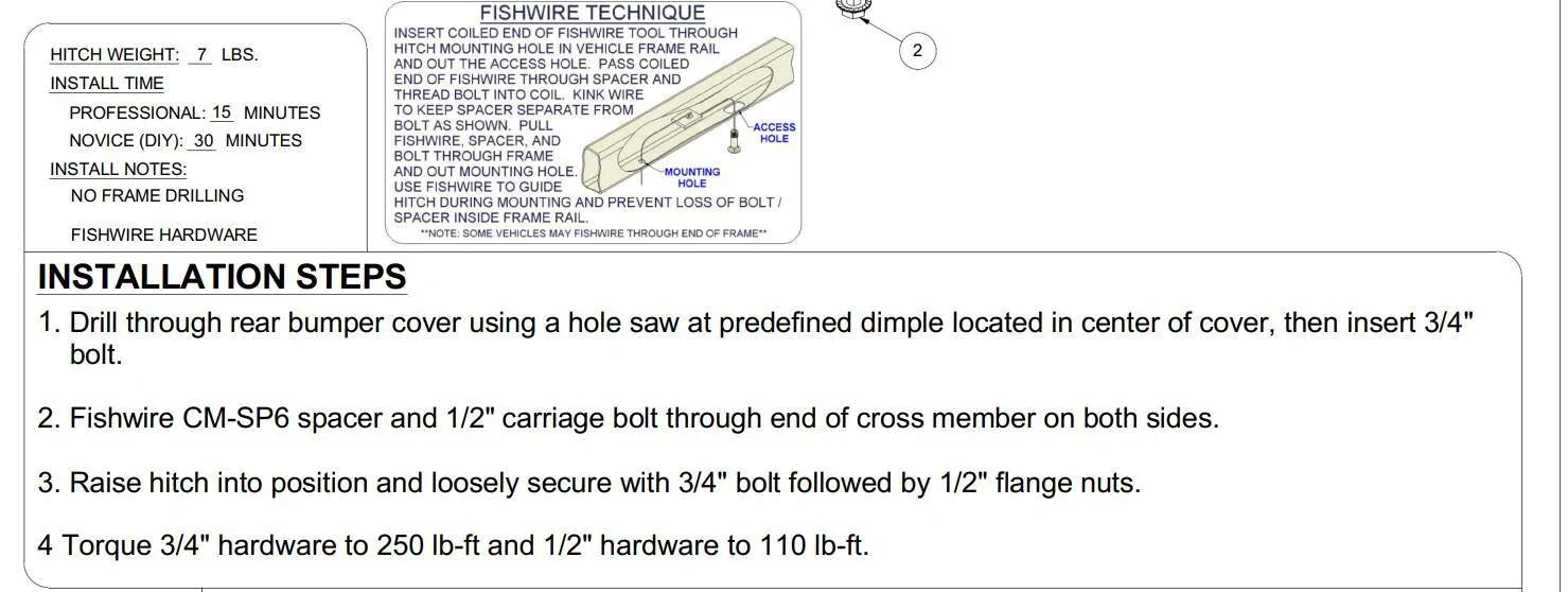

The whole idea of drilling through the plastic cover with a hole saw is so that you insert the bolt down through the bumper, through the cross member plate, and into the receiver threads.
Quadratec is doing it wrong! They didn't bother reading the directions!
That's where you are seeing your problem - you do NOT remove the bumper!
You use a hole saw to cut through the plastic - a 2" hole to allow for the HEAD of the bolt to be ABOVE the bumper step, counter-sunk into it.
Go back and get the REAL directions - not Quadratec - as they are screwing up the installation.

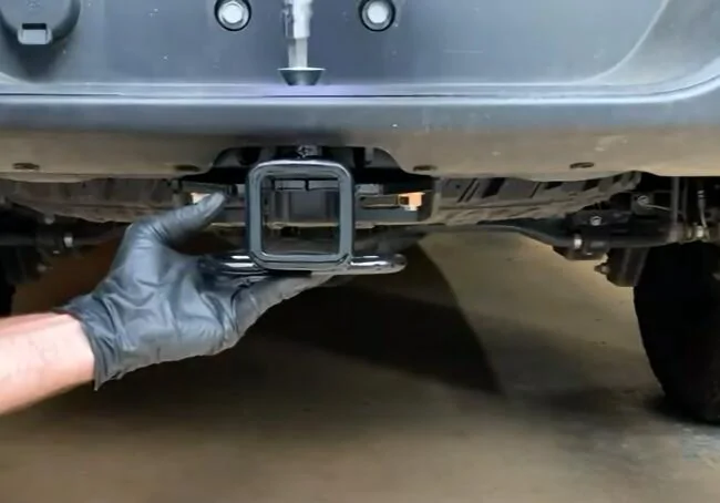

Jeep Gladiator Recommended Aftermarket Hitch Receiver for new 24 Gladiator Sport S 1745854045094-jg
SOME take the bumper off - but that's not how the actual real instructions from Curt say to do it. Some take the bumper off because they don't want to cut into the plastic cover and see that bolt.
Go read the REAR instructions from Curt - it bolts to the bumper and cross member.
You don't remove the bumper - bold goes through the bumper and the head of that bolt rests against the bumper itself. Thus - some people talking about needing to fill the gap with washers (gap between cross member and bumper bottom.
Here's the REAL directions - ignore Quadratec (quite a few people do, anyway)
If they are removing the bumper they are doing it wrong.

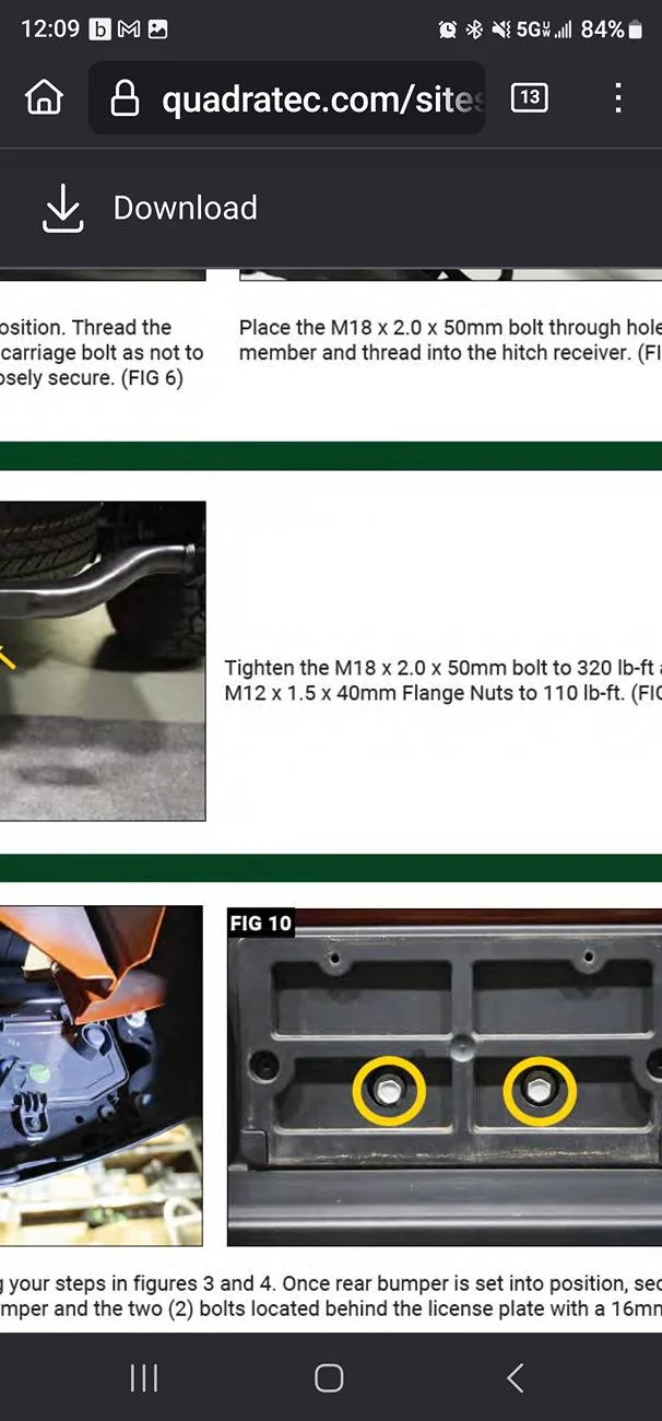

I regurgitate what I said in post #7. I installed the Quadratec hitch per their instructions which has you taking off the bumper for install with the main through bolt torqued to 320 ft-lbs. No extra washers needed. That bitch is not going no where and am confident of the 5000 lbs rating they provide regardless of any internet dick sword fight to the contrary
If that conflict with Curt, who cares? Is a frame rail Class IV hitch better, yep.

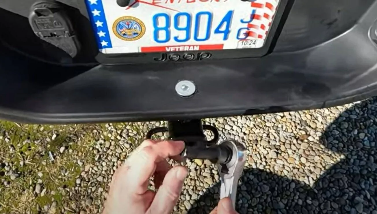

Jeep Gladiator Recommended Aftermarket Hitch Receiver for new 24 Gladiator Sport S 1745856017559-ll
The professor did it right, even though he didn't follow Curt's plainly worded directions?
Naw, he did it HIS way, he ignored the directions. So if you are like Red Green and toss the directions away into the garbage, then you have bypassed the bumper, which I'd bet Curt is relying on for additional strength.
Did you know that you can cover that hole with a 2" flat plug from Amazon and not see that bolt head?

I regurgitate what I said in post #7. I installed the Quadratec hitch per their instructions which had taking off the bumper for install with the main through bolt torqued to 320 ft-lbs. No extra washers needed. That bitch is not going no where and am confident of the 5000 lbs rating they provide regardless of any internet dick sword fight to the contrary
320??
Where's that come from?

It does if you follow Curt's directions, posted here.
It doesn't if you use youtube videos.
Some of us are going by the directions from Curt - some follow QT as they don't read paper directions. Some make their own choices and don't need instructions or videos at all.
But the technical reality is - according to CURT, it does indeed bolt to the bumper AND cross member.
If you don't follow their directions, it doesn't.
There - now you can have it both ways.
Some prefer not to bother removing a bumper, and make it simple and follow this PDF, and then put a plug over the bolt so you don't see it.
You can have it both ways.

320??
Well one thing we finally agree on. That is reading comprehension is extremely important. He clearly stated that he used Quadratec NOT Curt. Therefore different specs. I know you will argue so here is the pic from that product. NOW DROP IT. YOU ARE JUST WRONG.

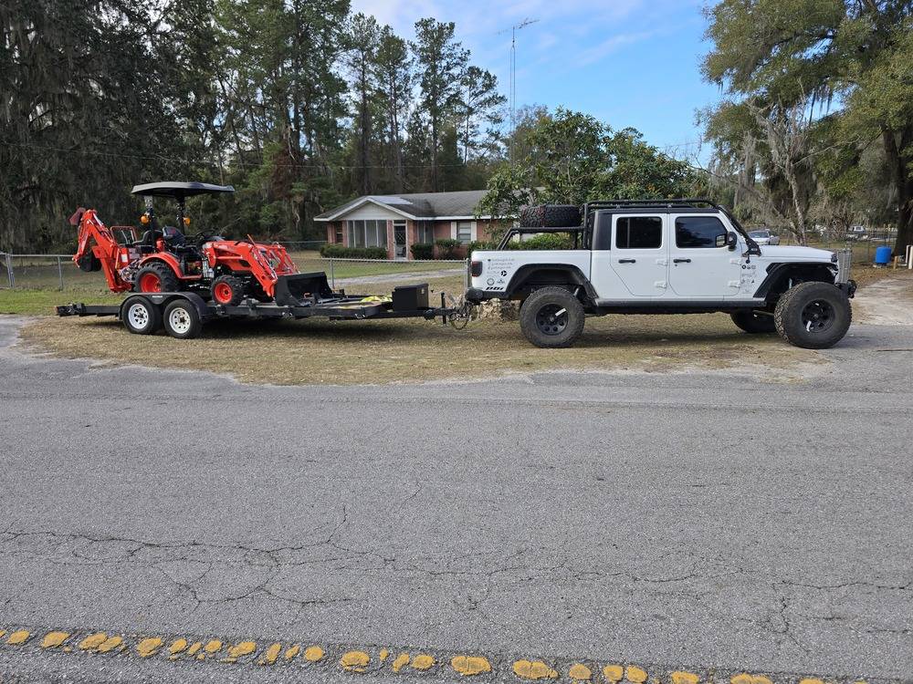

Oh, I'm right there with ya. I tow pretty much everyday. Got 4 trailers and a boat. Sometimes I tow with the Ram, but I mostly tow with my JT. Why? Hell.... cause I like it.🤣🤣
BTW, That's a nice trailer you got. I don't want to spend the money on a brand new one, but If I can find a used aluminum (at least 20ft) trailer on marketplace for the right price, I might have to spend money. Right price being almost free!🤦🏾‍♂️🤣🤣
Jeep Gladiator Recommended Aftermarket Hitch Receiver for new 24 Gladiator Sport S 20250201 Tyson Truck & Tractor - Flemington, FL (1)B

Far as I recall, that hole Curt has one drill through the bumper is just the plastic covering to get to that cross member hole. There is nothing extra structurally with the Curt instructions. Even the guys at Etrailer.com talk about in their install video for the Curt video mention both methods of either drilling the hole through the bumper cover or removing the bumper for install with the latter being their method.
https://www.etrailer.com/tv-Install-Curt-Trailer-Hitch-Receiver-2020-Jeep-Gladiator-CU74FR.aspx
