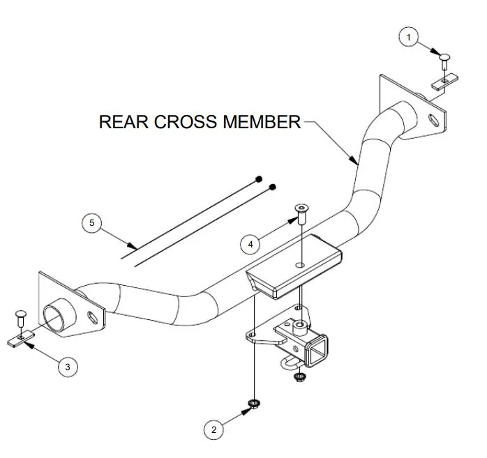

Anyway, here's a pic.
I can't get the site to upload the photos.
I run into that now and then. I was just messing around - figured it didn't upload for some reason.
If you use a ball on the bumper, you are actually not attaching the ball ONLY to the bumper, it's also attached to the rear cross member.
So people know what I was talking about - and to show what I mean in that the piece is a cross member and that yes, the #2 "receiver" bolts to a cross member AND to the bumper.
Even CURT calls that rear piece a CROSS MEMBER. It is a cross member.
I knew I was otherwise correct but had no proof someone would believe - here it is, out of the mouth of Curt, the company that makes the cheap bumper/cross member mount receiver ->

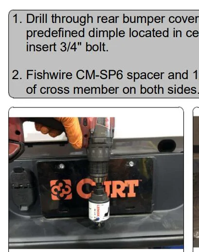

it also does attach to the bumper - There's a hole in the bumper itself for a BALL, you drill through the plastic bumper cover and the small receiver (#2) is bolted to the bumper using the BALL hole.
So it's really not that much stronger than a ball in the bumper type setup. Why? Because it mounts the same as a ball would.
These are not rated for bike racks and so on.

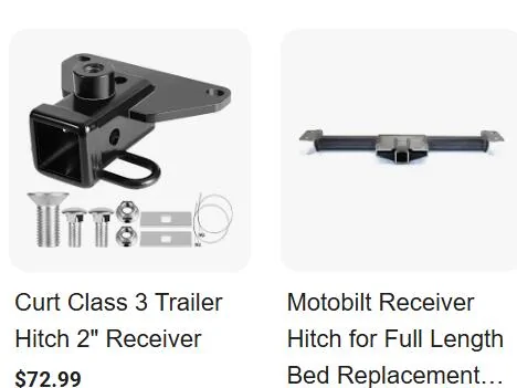

Hey All,
I am rather excited to be bringing home my first Jeep and a substantial upgrade from my 09 Ranger. Only problem being that I need to add a hitch to the new truck. If I am understanding it all correctly, I have essentially 3 options.
(1) The classic ball on the bumper:
(2) This thing that I suspect is also attached to the bumper:
(3) And the more expensive MOPAR version that has the best capacity:
I am not inclined to go with the bumper ball, but If there isn't a lot of difference between options 2 and 3 then what am I actually choosing between?
Thanks!
