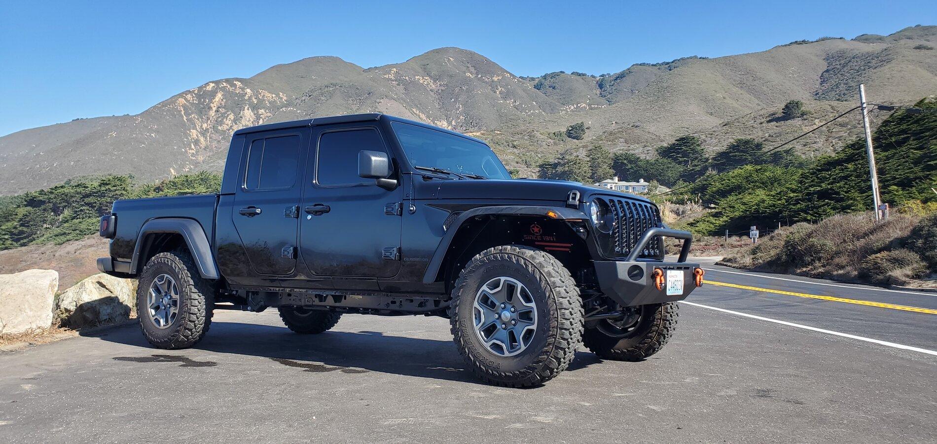

Yes, JK wheels will fit on a Gladiator. Also, just use your factory lug nuts and you are good to go. I had mine switched over at the dealership when I bought it and have had zero problems.
Jeep Gladiator Will the JK wheels fit on the Gladiator ? 20201031_122354
