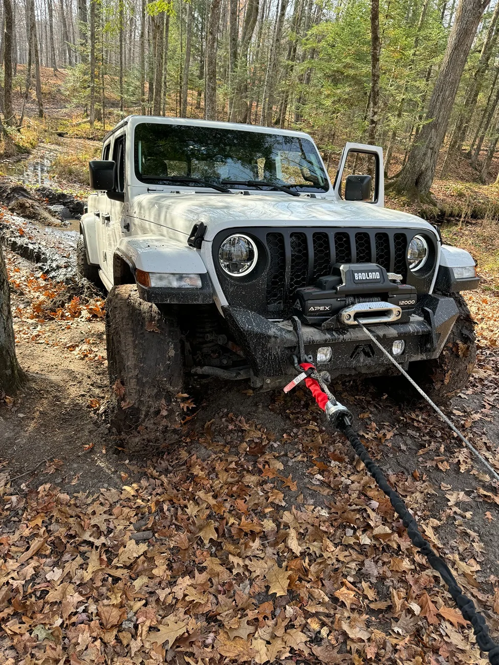

brsnow2585
Bryan
Jan 16, 2025
309
312
Illinois
22 JT Rubicon diesel
I've got an Apex with synthetic line, it's pulled me up and over plenty of times, and a fair bit of stumping. The 'oh shit' moment hit after all that, but fearing the worst, I popped the cover on the relay box on top and found that all of the nuts on the heavy contacts had wiggled off and exited. I put nylock nuts back on and back in business. Rubicon steel bumper, Warn plate
