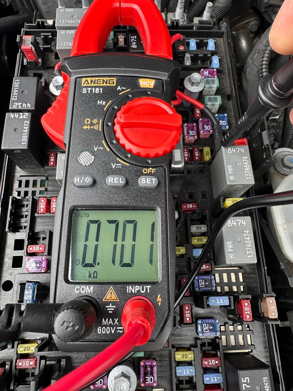

0.7 K ohms = 700 ohms?

That is 700 ohms which is high. That tells me you have a broken ground plane within the PDC fuse box and is why the RUN/ACC 1 relay will not latch.
Proper fix is a new PDC. Other options is someone with componet level electronic experience could possible repair the circuit board. Another option is to scab an external relay.

I just curious, can you remove the relay and check just the socket side on the PDC for PIN 85 to ground? I am just wanting to see if it is true open (infinity) and not just that 700 ohms which I suspect is back feeding through the relay coil to the BCM power output PIN 86. Either way, still think the PDC ground plane internal is messed up for that leg.
I think when you originally poked through the GN/BU wire on the firewall and the first time you went to ACC or RUN, the BCM sent the 12vdc for the relay turn on and was shorted without a fuse and the circuit board ground plane trace in the PDC was the weak link and is what blew
You lost me here. Check socket 85 for continuity to ground?
Makes sense.
Are RUN 1 and RUN/ ACC 1 connected? Maybe they share a common ground on circuit board?
I'll reach out to Benny to see what a new one costs and will probably pull the board at some point to see if there us any visible damage. There are few places nearby that should be able to repair it, if possible. In might just scab in some relays for now.
Take the relay RUN/ACC 1 out of the PDC. Where PIN 85 of the removed relay goes into that PDC, stick one meter lead on the socket hole terminal of the PDC and the other meter lead on a ground point like on the fender or even the battery negative side terminal. With the meter on ohms scale, what does it read?

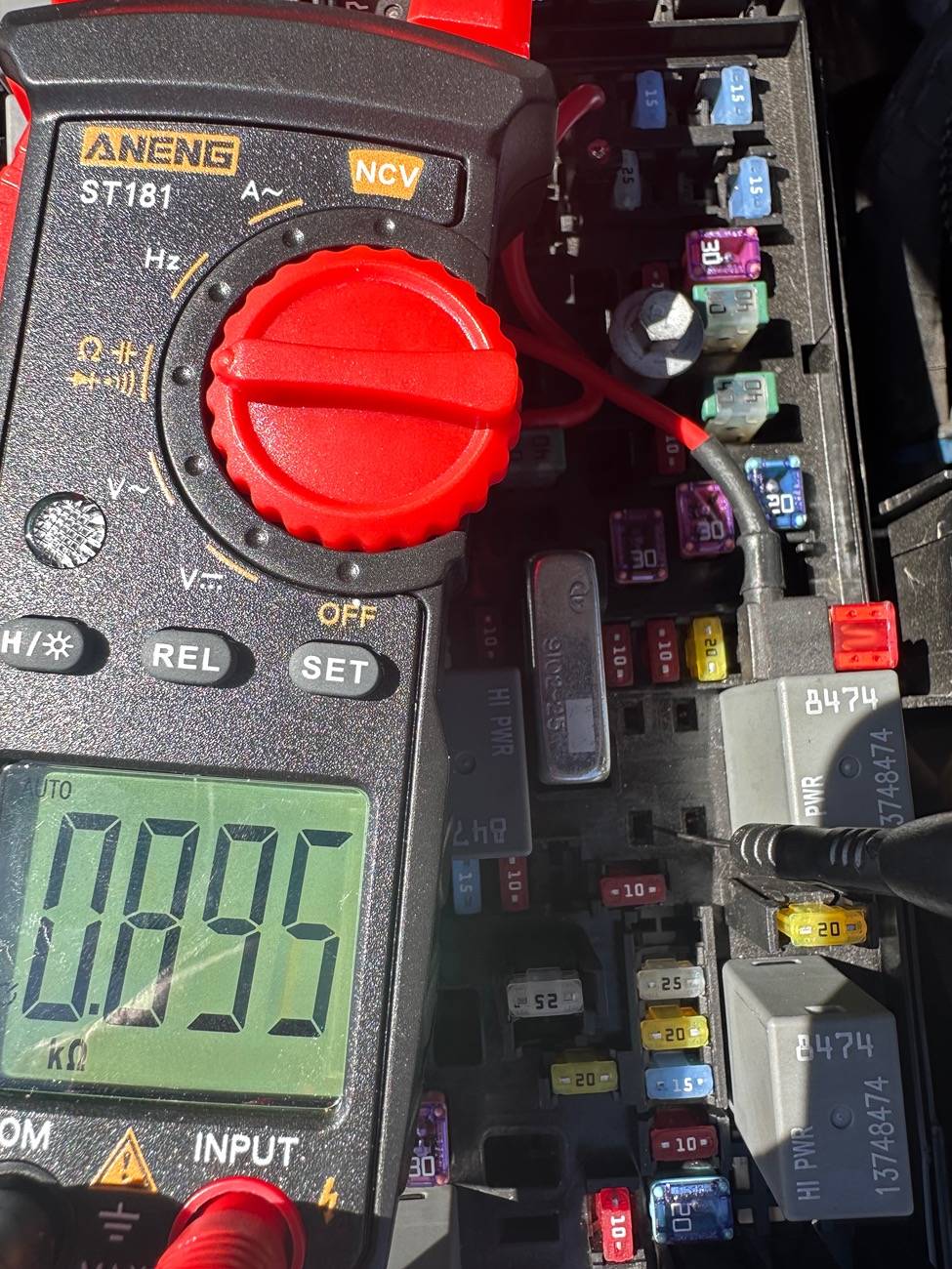

Jeep Gladiator Windows Won't Roll Down IMG_8547

I scabbed up the Run/ Acc relay with pin 85 connected to an external ground and the respective accessories seem to work just fine. So I think you were spot on as far as blowing the PDC ground on the Run 1 and Run/ Acc 1 relay leg.
Sent Benny a message and now just waiting to hear back on a new PDC. Still need to call a few circuit board shops to see if what it would cost/ and if it’s repairable. Not sure that’s something I would try to tackle myself.
If you buy a new one, send me the old (I'll pay shipping) and I'll see about fixing it.
