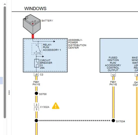

Ok, power windows are on relay K12, run/acc #1 which is controlled by the Body control Module. The trigger wires for those relays are very thin gauge and my guess is the wire for that relay is damaged. Idk what else is on that relay I bet everything that isn’t working is on it.
Power window diagram

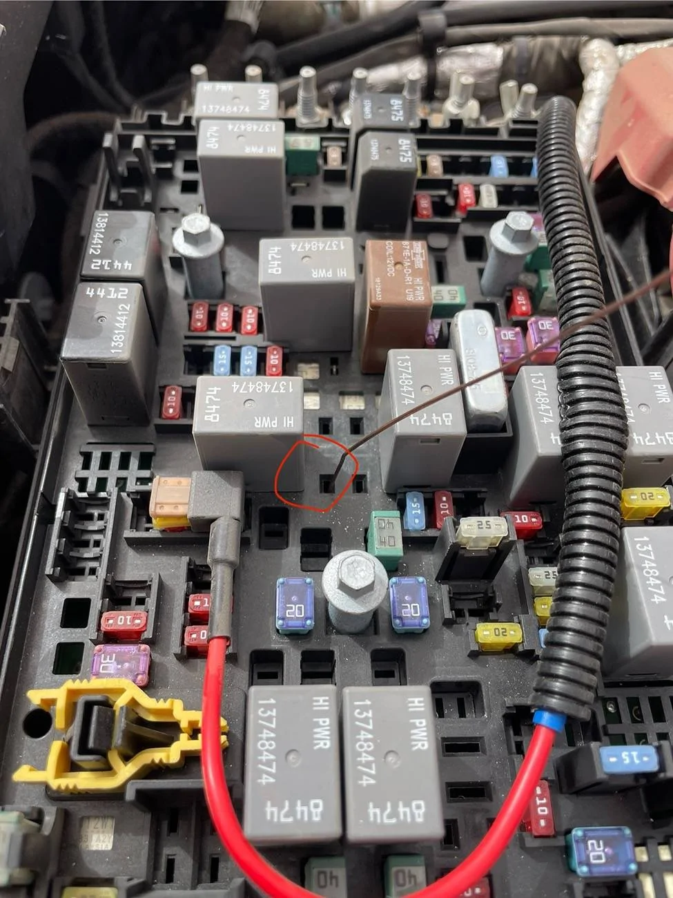

Spliced wire into pink/yellow power at the back of the front window control module and all windows work with power in the rear media. I figured as much, but glad to know for sure. Now to work backwards...

Ok, did some checking on my Jeep. The relay is powered by the BCM.
Pull K12 relay at the fuse box and use a multi meter to check for voltage at this socket.
Jeep Gladiator Windows Won't Roll Down IMG_9065
with the key off, there should be no voltage, with the key on there should be voltage. If there is no change key on/key off the trigger wire from the BCM is broken.

Thanks for taking the time to check that out! I didn't see your message come in as I working on the jeep but eventually made it to the same idea. I did find that if I hot wire these two connections everything works. I have the ecoD so it looks like the fusebox is a little different but it seems like its the signal wire from the BCM to the relay socket pin 85. Now I just need to identify the wire and see which connector it goes to which is arguably the hardest part.

Hi,
I cant get an internal schematic of the PDC but I can see the circuits incoming and outgoing. Granted the schematics we have are accurate connector C2 pin J5 delivers power to the window switches
Jeep Gladiator Windows Won't Roll Down 1745883611967-i8
I attached a PDF of C2 so that you can see where J5 is located. It should be a Pink with Yellow Tracer.
Let me know if you need any more info
- Benny

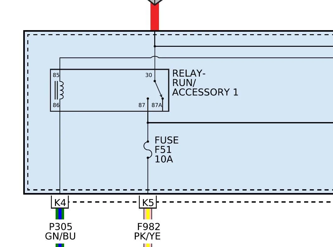

I've tested all the fuses, gray relays (1,3,7,8,9,10,11,12,13,14,15,16,17,18,19) and the high amp fuse array. Wasn't sure how to test the circuit breaker but it seemed to have continuity. To the best of my knowledge they are all working like they are supposed to.
I am wondering if maybe there is something wrong with the Power Distribution Center motherboard? or the Circuit Board (non-serviceable) illustrated in the FUSES/ RELAY - RUN ACC Schematic.
I attached a couple schematics and think I have a pretty good understanding of them but maybe someone with some true knowledge reading these can let me know if I am missing something!
Any help would be sincerely appreciated. I am stuck.

When you say "hotwire" on pins 30 and 87 on the RUN/ACC 1 Relay, I assume you mean that you jumper the two socket contacts on the PDC with the relay removed? If so, that leaves either a relay control side on pins 85 and 86 or a bad relay but I assume you probably have already swapped the relay?
On the PDC with the RUN/ACC 1 Relay removed, I would make sure socket pin 85 has low continuity to vehicle ground. With the start button in ACC or RUN, I would make sure you have 12vdc going to socket pin 86 that is being sent by the BCM.
If no 12vd voltage at socket pin 86 on the PDC, I would continuity check that GN/BU wire between the BCM and PDC. If that checks out good and still not getting voltage out of the BCM, may have fried that leg of the BCM.

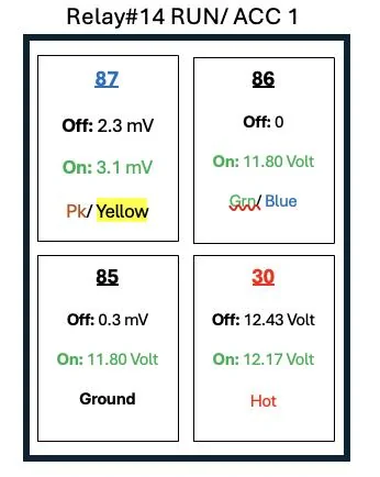

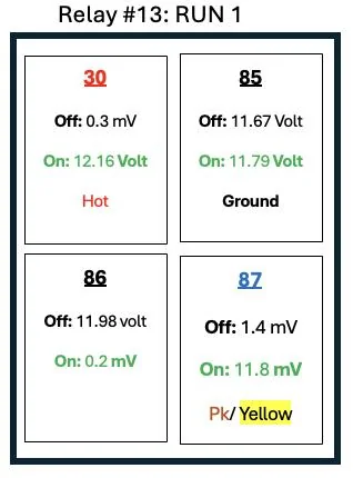

That's what I was thinking. I have tested all the relays and swapped them with each other.
Jeep Gladiator Windows Won't Roll Down 1747584492463-xi
Jeep Gladiator Windows Won't Roll Down 1747584520549-ta
Here's what I got

Need to put your meter on the ohm scale and check the RUN/ACC 1 relay and read PIN 85 to a vehicle ground. Should be low ohms like 10 ohms or under.
