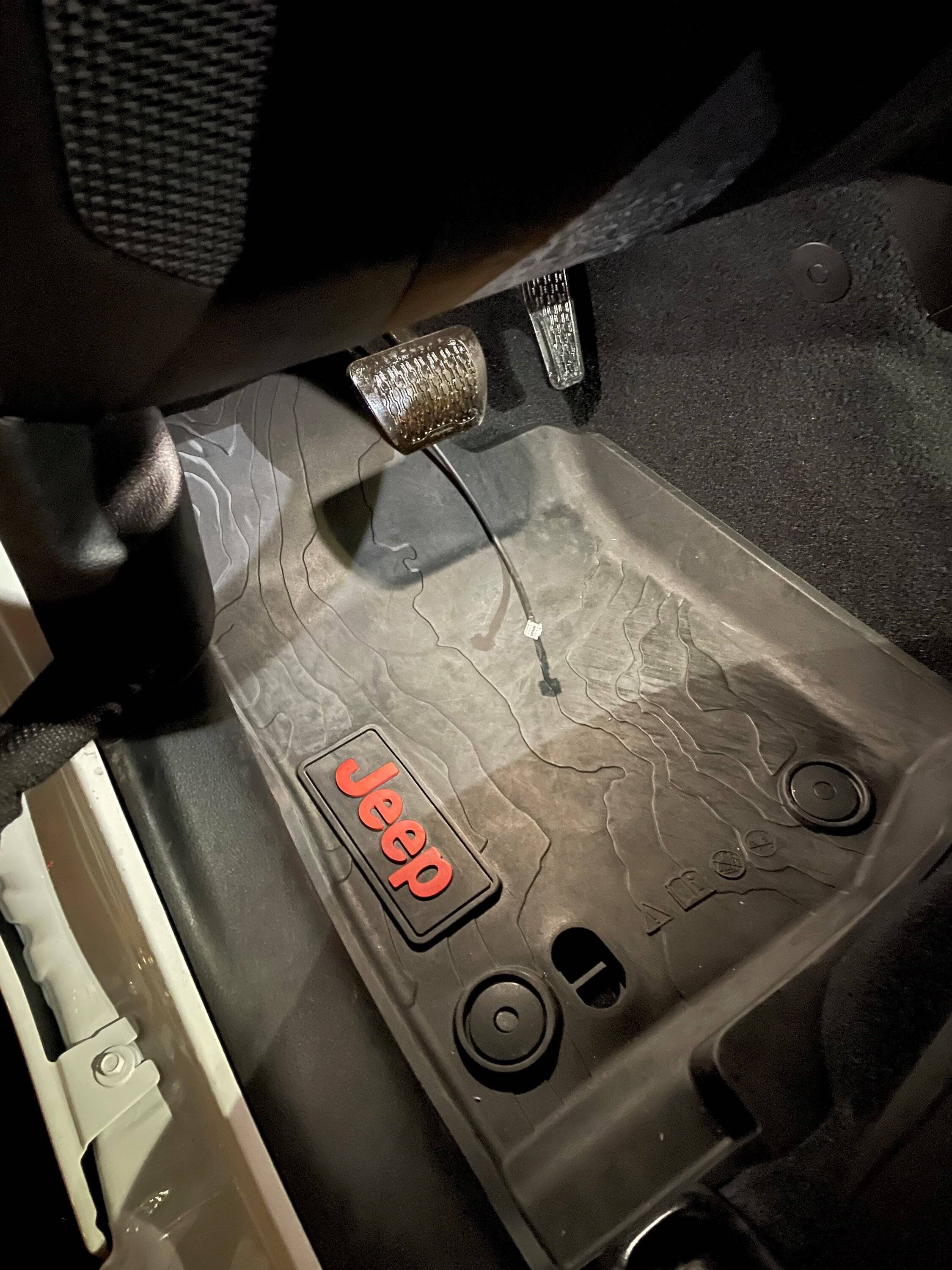

What that looks like is the cable to the control head, which is typically mounted where the cigar lighter would be. Was the actual controller not there? It would have been mounted somewhere under the dash. Was that part missing?

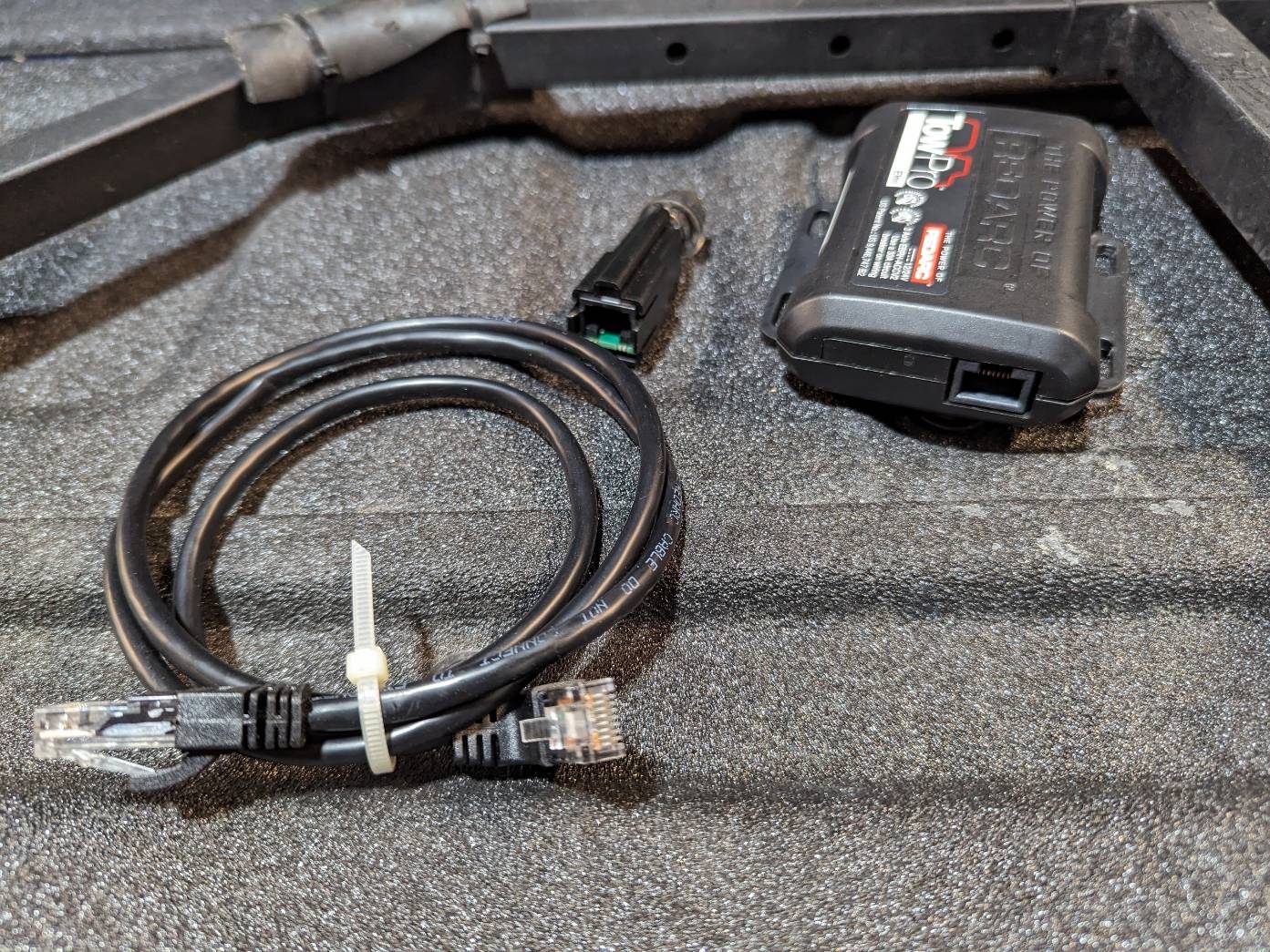

The Redarc I had used a CAT5 network cable type of cable. In fact, I didn't like how their cable fit and routed so i grabbed a CAT5 cable out of a box of network stuff I have and used it. RJ45 ends.

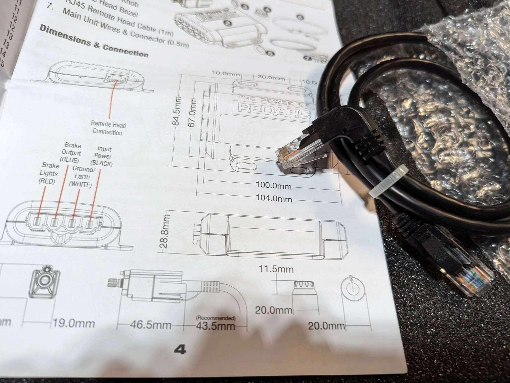

I was looking at this picture on their website:
Jeep Gladiator Wire Identification. Screen Shot 2023-12-06 at 1.31.46 PM
And this one in the on-line manual:
Jeep Gladiator Wire Identification. Screen Shot 2023-12-06 at 1.35.29 PM

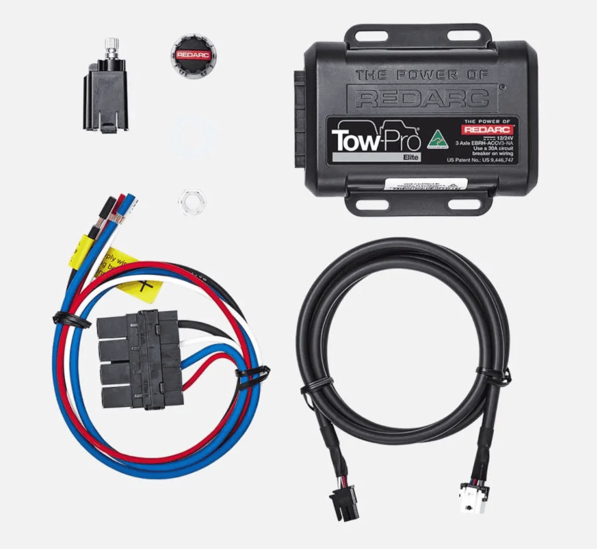

Then they have changed things.......
Jeep Gladiator Wire Identification. PXL_20231206_195924527
Jeep Gladiator Wire Identification. PXL_20231206_200056521

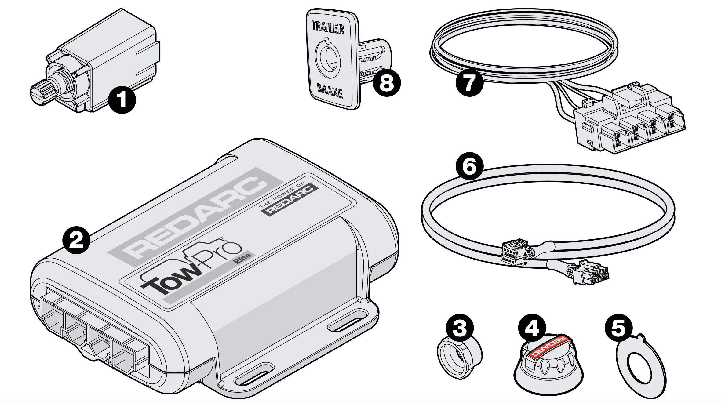

Not Cat5 and I have everything except part 1 in the above illistration.
