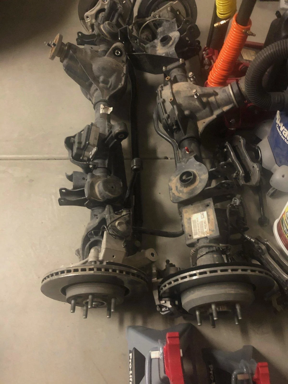

Does anyone know from these axle numbers if this is a rubicon axle from a JT ?
TTOAR1409C3015
M220
P68382
823AG
DANA# 10087066
Im about to pick up a set but i have searched all over and cant find any info online that says what they are.

Does it have locker electronics plugs on the housing? If it's the rear and has JT suspension brackets, that's the easiest way to tell. I think the Rubicon fronts are the same between JT and JL. I hope so, because I'm about to swap some JL shafts into mine after breaking one...

It does have the brackets for the rear i just want to make they are jt axles because the tubes supposed to be thicker. The guy said they are 72 inches from wheel stud to wheel stud. Anyone have a info on this ?

JL and JT rear bracketry is not the same. The shock mounts are the most obvious difference. If they match your JT, you’re good to go.

JL rear shocks are behind the axle. JT shocks are in front of the rear axle. I think I see them on the front side of the one in your pic. It also looks like there might be an aftermarket track bar bracket on there?

Thank you for picking on those things ! Im heading to pick the up this weekend then!
