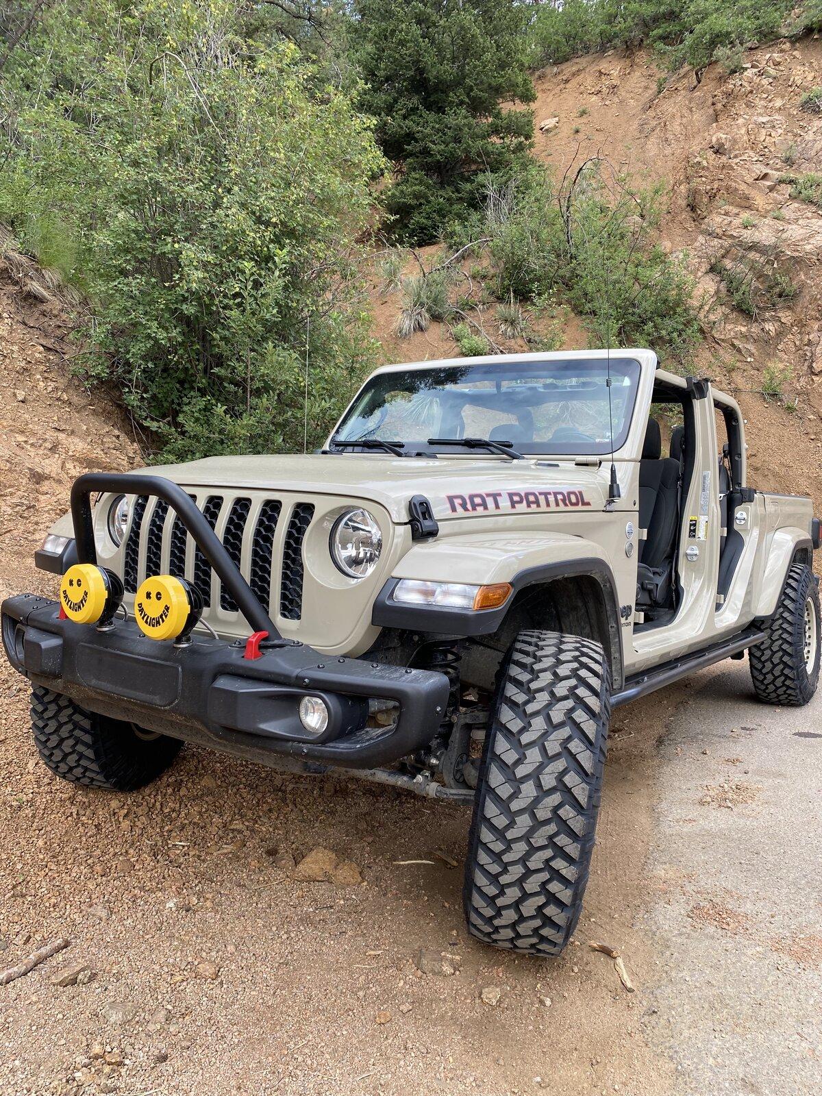

Thanks for the help with the fenders and axle question. I think I am among the minority when it comes to tires protruding past the fenders. My current tires and wheels are fuel 701 Ammo 17/9 / -12 w/ 4.52 BS. , with Nitto terra Grappler G2. They stick out about 2.5-3 inches beyond the fenders on my Gladiator Sport. I am in the process of researching new wheel to try and give me the look I am looking for. If anyone has suggestions please send them my way.

Dig the Rat Patrol tan theme going on. Loved that show back in the late 60's (although I had to watch re-runs in the early 70's)
